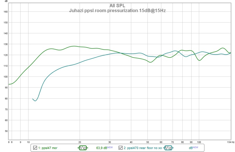

It's not different. As you know, sound is just pressure fluctuations. Below the room fundamental the pressure variation just ceases to be that due to propagation of waves from the driver to the listeners and the excitation of resonant modes. As the wave length of the sound becomes large relative the room dimensions the pressure in the room basically varies homogeneously and is only a function of changes in volume of the enclosed area (room + woofer). So below the room fundamental there are no modes or standing waves. The sound pressure everywhere in the room is the same. In cars the call it's cabin gain.
While I understand the physics of an open baffle speaker not pressurizing a room, I have to say that once you get to a sufficient woofer cone area, it sure seems like it! I dunno, maybe there is a momentary imbalance in pressure that feels like room pressurization.
Once you get to two 18" woofers, four 15s or better yet four 18s in a typical domestic room it can get to a pretty good illusion of pressurization. 🙂

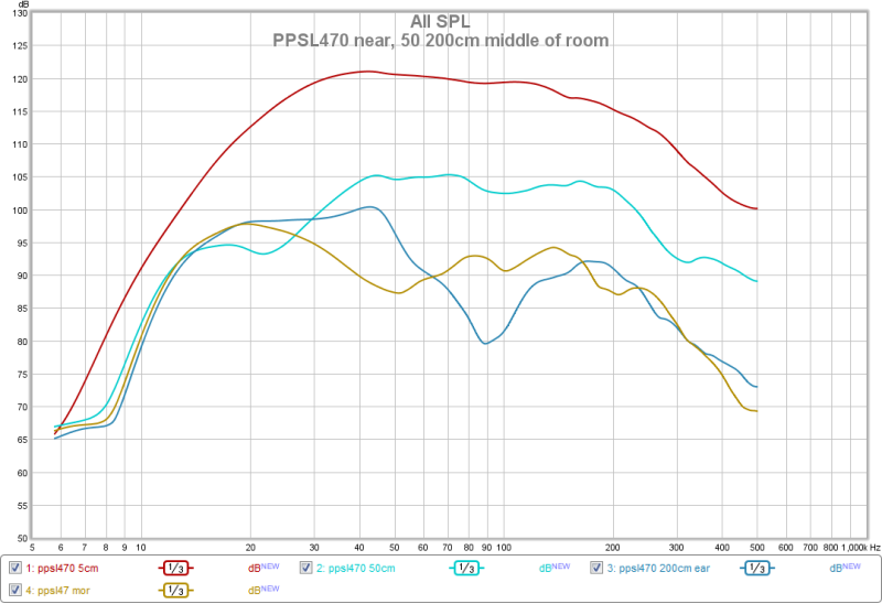

Well, it is very difficult to hear sinewave below 30Hz! With high spl we start to hear distortion and resonances of it first. Low F pressure waves can be felt with facial skin, some say...

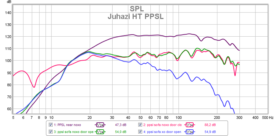

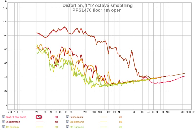

I forgot to say, that those are of a closed box 2x15" subwoofer in a 3x4m room. A friend has now 2x18" IB in a large leaky 6x7m room and 15-30Hz doesn't feel so intense! Perhaps it's just the lower distortion, I don't have saved measurements from there.
