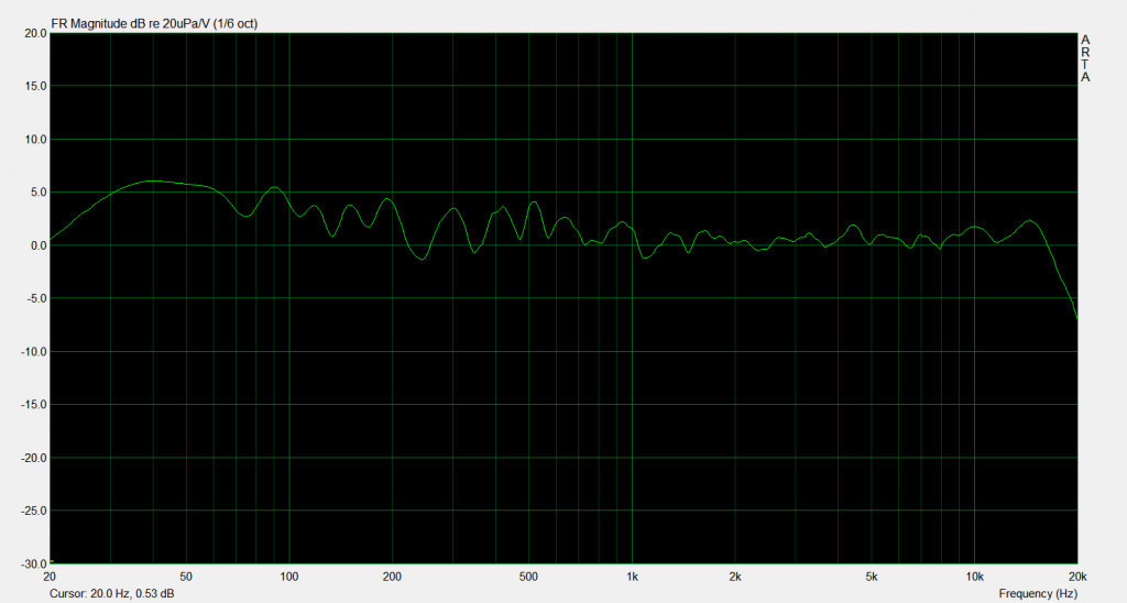

This thread had been dormant for awhile, but I wanted to post that I have finally completed the first system that follows my "20-20k dipole" paradigm. I just returned from demoing these at a DIY event in Grand Rapids hosted by Meniscus Audio and CSS. The speakers were generally well received, and sounded good in the large conference room listening space where they had room to breathe.
I was so busy during the event that I didn't have time to take a picture of my speakers when they were set up, and I had to quickly take them apart to make room for other speakers.
For now I can provide the frequency response measurement of the system in the attached pic. I made this in my basement listening space before the event, at about 20 degrees off axis, at about 2m, with a long gating window (resulting in about 20Hz resolution) and 1/6th octave smoothing. I also have a distortion measurement that was taken at about 90dB@1m that I will post later when I can find it.

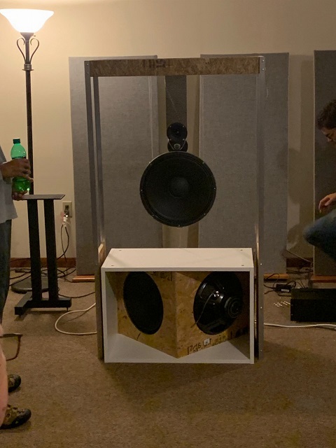

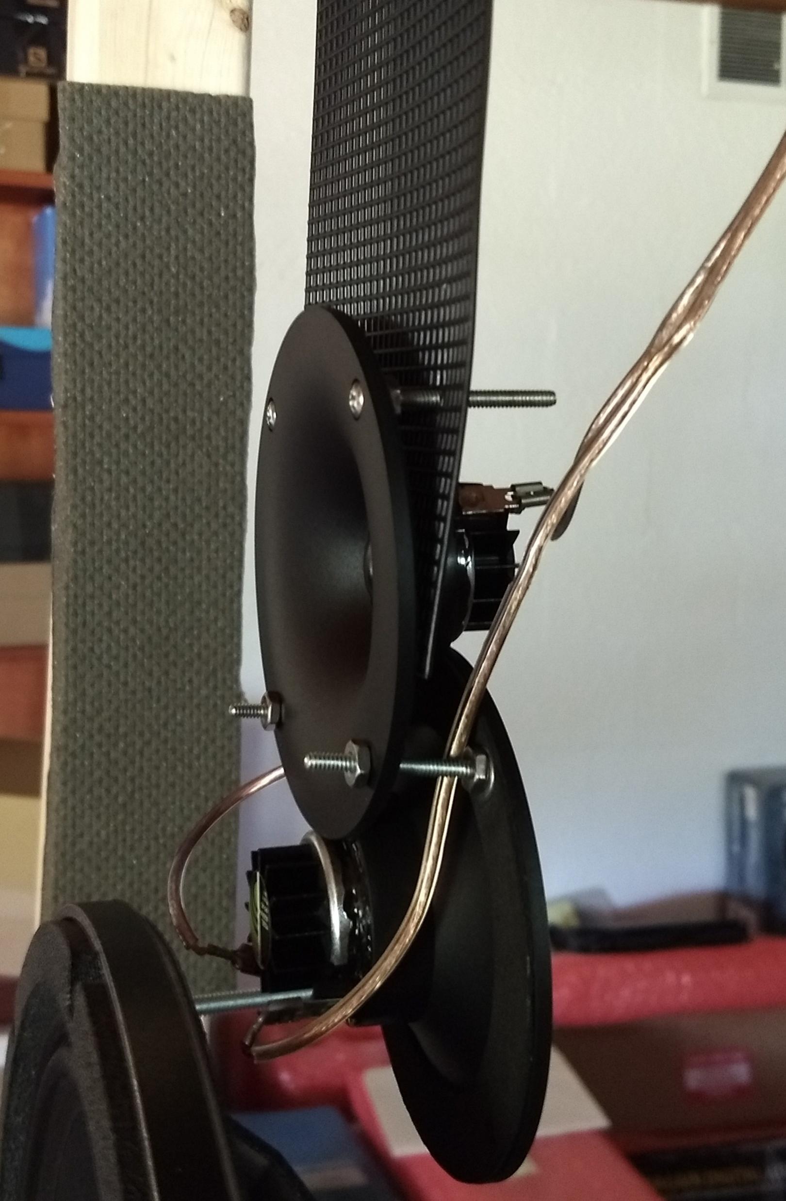

Here is some info and a couple of pics (will try to find some better ones).
This is a test platform for developing nude open baffle speakers using a variety of drivers. Drivers are freely suspended within the frame using wires or other means. There are several 1/4" OD aluminum rods running front-to-back in the top wood section. This provides a spot to hang the drivers and allows me to easily reposition them in the front-back direction by sliding the loop of wire back and forth along the rod. I do this so that I can physically align the acoustic centers of the drivers.
In this system I have chosen the drivers to be (A) as small in number as possible (e.g. a 3-way system) yet still cover 20-20k Hz as much as possible and (B) to have identical forward and rearward radiation, frequency response, etc. Careful outdoor measurements of individual drivers was used to screen them for this purpose.
This is a fully active system and uses a DSP crossover. The crossover is implemented in software on a laptop using Gstreamer and LADSPA plugins. Only IIR filtering is used. A pro-audio interface (Behringer UMC1820) provides analog and digital input, and 10 analog outputs. Amplification was an Adcom GFA-2535 (4-channels @ 60w/ch into 8R) and an ATI1502 (125Wch into 8R).
The drivers used included two Eminence Alpha 15A in an M-frame, an Eminence Deltalite II 2515, and a back-to-back pair of Dayton ND25FW-4 tweeters. The crossover frequencies are at approximately 250Hz and between 1600-1800Hz.

Hello Charlie. Congratulations. The design looks deceptively simple, do you use the M-frame for a degree of force cancellation and slightly smaller cabinet, or does it have any other benefits over an H-frame? I'm intrigued to know what kind of EQ was used to get down to 20 Hz.
