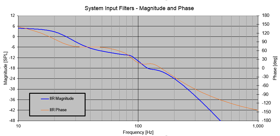

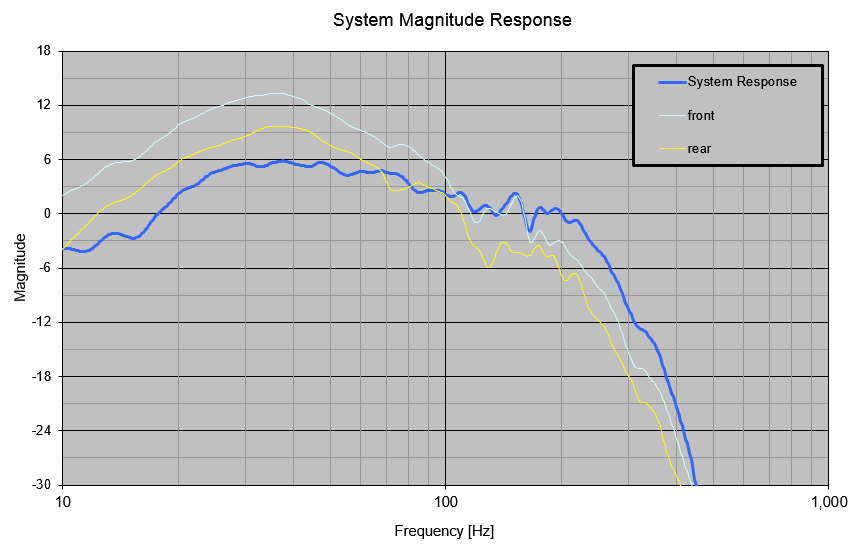

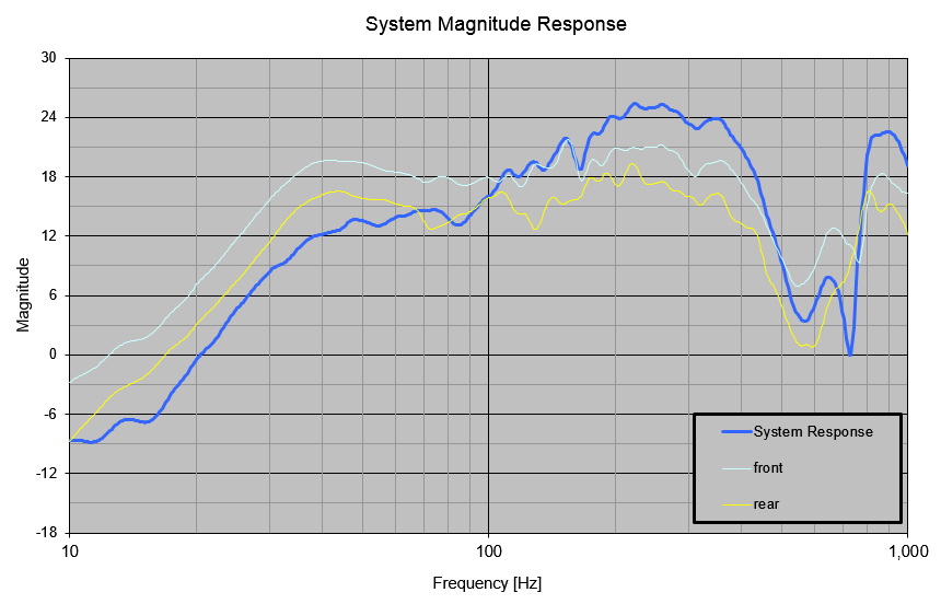

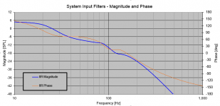

Regarding the DSP used on the M-frame, I have attached a couple of screen shots (from left to right):
* M-frame response without filters (SPL is arbitrary)
* the EQ/filter curve I applied
* the response with the EQ+filters (SPL is arbitrary)
Thanks to the high Qts of the drivers I only apply about 6dB of boost to extend the low end a bit. This allows me to get a response that has an F3 of about 20Hz. One attractive aspect of this kind of subwoofer is that the driver's resonance frequency when installed in the M-frame is about the same or a little less than its free air Fs, and Qts is about the same or a little higher (depending on the depth of the 'frame).
Also, here is my best guesstimate on the sensitivity of the system:
Each Alpha 15A has about 94dB/W sensitivity at around 200Hz (see MFG data sheet). The M-frame uses two of these drivers in parallel, which elevates the sensitivity by +6dB for an effective sensitivity of around 100dB/W.
In the M-frame, both a resonance and the dipole response peak give rise to a peak in the response of around +6dB on axis SPL compared to the SPL that would be obtained if the driver was mounted in an infinite baffle. This occurs between 200 and 300 Hz in the first (leftmost) plot in the post above, so in this region the on-axis SPL level of the M-frame is around 106dB/W (on axis). There is about a 12dB difference between the level between 250Hz and 40Hz, so at 40Hz the native SPL is around 92dB/W. That's pretty good for this kind of system and modest amplification is all that is needed.
Also, by looking at the unfiltered response you can see that even without any low frequency boost you could obtain an F3 of around 35Hz just by attenuating the response above 100Hz or so. It might be possible to implement such a correction using a passive filter, but it would require one or more pretty large inductors since the response rises at about 12dB/oct beginning at about 90Hz.

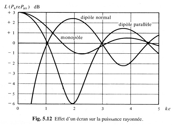

Dipole Power Radiation transition from half to full space
Loudspeakers are often placed on the floor, which forms a large wall. Unlike in monopoles, the radiated acoustic power of dipoles behave quite critical in theirs frequency and distance dependent transition from halfspace to fullspace.
An acoustically large wall near a point source alter it’s radiation impedance, making the radiated acoustic power dependent from the distance (e) to the wall and from the frequency, here as the term k.
k=2pi/lambda.
One of the nearest large walls for a loudspeaker is the floor. So, what does that mean? Have a look at the graph.
As a first and simple example, look at the monopole’s radiated power along ke.
Pa=Pam[1+(sin2ke/2ke)] Pam is the power radiated by the driver in free space.
A monopole’s power radtiation gently swings from Pa=2*Pam at ke=0 to Pa=Pam at a very large ke within a sine and an attenuation mode. In other words: Close to the wall it has a double power radiation than far away from this wall. The tranistion between these two extremes is uniformly oscillating in a damped mode.
A dipole’s radiated power is quite a different and more complex stuff. Have a look at the graph again. Unfortunately I don’t have the exact formulas – can anyone provide them? Would be great.
A dipole standing on the floor forms a parallel dipole related to the floor. It’s power radiation swings like mad compared to the monopole. Have a look at the corresponding curve – the radiated power starts at Pa=2Pam at ke=0, begins to dive, reaches Pa=Pam at ke=1.05 (approx), and dives to Pa=0.25 at ke=1.95 (approx). At the extremes, very close and far away from the wall, a parallel dipole behaves like a monopole.
A dipole standing in front of a wall forms a normal dipole. It’s power radiation characteristic is somewhere complementary/symmetric to the one of the parallel dipole: 0 at ke=0, 1 at ke=1.05, and a first maximum at ke=1.95. Unlike the monopole and the parallel dipole, the normal dipole has a power radiation of null very close to the wall.
So, compared to a monopole driver, the placement of a dipole driver in relation to a wall is much more critical. But nevertheless, the complementary symmetry nature of radiated power for a parallel and a normal dipole offers some workaround, and shows why it is a good advice in an listening environment to toe in dipole speaker to some 45° related to the front wall. This manoever brings the otherwise normal dipole into a more mixed normal-parallel radiation mode. And this ttranslates into an approached complementary mix of cancellation and augmentation of the radiated power.
Toeing in a parallel dipole (related to the floor) is also possible, but certainly less practical. So, what does this mean now for the construction of a fullrange dipole speaker array? Let’s look e.g. at a typical construction with a lower-mid driver at an elevation of 50cm from the floor.
k=2pi/lambda
tranlates to a value of ke=1.95 for a floor-distance of 50cm and a frequency of 214Hz. This driver will have it’s 0.25 acoustic-power-notch right there, where it should shine. What a mismatch! Similarly at 40cm the notch will be at 267Hz, at 60cm at 178Hz (these values are close approximates - who, please, has the exact formula for the parallel dipole?).
Therefore, construction a dipole fullrange some care has to be taken in regard of the vertical array – you will have to match the height of a driver above floor along with the frequency band to be radiated by this driver. As a rule of thumb, drivers should be placed in the range for ke<1.2 and ke>2.7.
And be aware that you cannot match the smoothness of a monopole’s power radiation with a dipole setup. Encountering ke’s>1.2 … ke<4.2 won’t let it happen.
