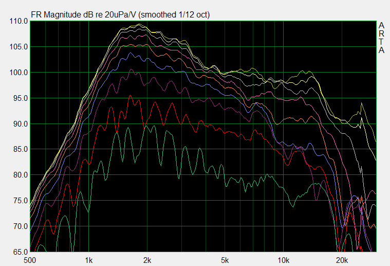

Nice HD%, clocking in around -40 dB (1%). Pretty good for cones (ESL come in around -50 dB).
But you might already be bumping against the lower limits of your measuring system and the real figures are even lower.

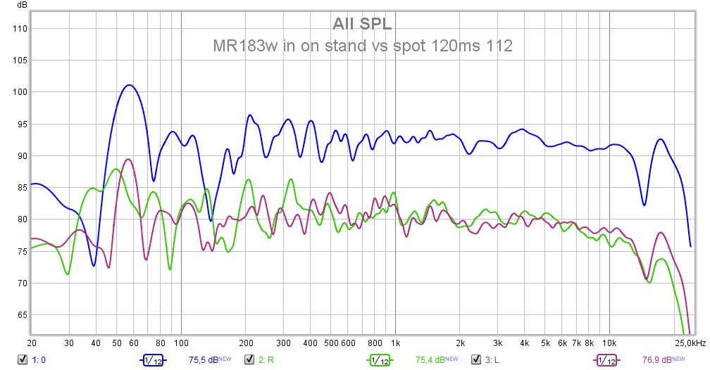

- indoor measuring is ok when one learns to identify the specific issues (reflections) in response. These happen mostly at f below 400Hz when speaker is in the middle of the room
- backside reflections in listening setup happen at higher f, because walls are closer

- high distortion around 100Hz is mostl likely stressing of the woofer and the amp, both!
- 90dB/1m only just starts to show midrange and tweeter distortion, 95dB is better, but 100dB/1m must be tested too! NRC publishes big speakers' distortion 95dB/2m.

Yes, that's true but I am not sure about what you are trying to say about reflections. I do not try to compensate the loudspeaker for the room. What you see with a microphone, e.g. a null from a reflection off a specific wall (e.g. rear wall) is not necessarily a good representation of what you will hear from the loudspeaker because a microphone is not the same as ears+brain=hearing. The rear wall reflection will be folded in with other "early arrivals" by the brain and, as I understand it, as long as you keep the tonal balance of the reflected sound as similar as the first arrival (direct sound) the brain just adds it to the total perceived loudness. If the tonal balance of the reflection is not the same it will influence the perceived timbre. For this reason, a dipole in a relatively live (but not echo-y) room can sound very good, probably better than in a relatively damped room. As evidence for this, I previously prototyped a system in a practically bare room with a hard wood floor and it sounded very "spatious", IMO due to the boundary reflections adding to the overall soundfield perceived by the brain via input from the ears over time.Some comments
Hmmm, not sure I follow. For example in this plot I do not see what you are talking about. Looks all dipole to me:- off-axis behaviour of the double tweeter shows low directivity (dipole action lost) around 4kHz, but modestly because of waveguide effect is masking it.
Maybe you were thinking about a different plot or plot feature when forming that opinion? Please let me know.
If I want to do higher SPL distortion testing I will need to move from the onboard sound to an outboard unit with higher output voltage capability. The onboard one can barely do 1Vrms... and the distortion performance of the codec is not stellar, although still well below the loudspeaker itself. It was more for the convenience of it. It's probably best saved for a later stage and not the prototype.

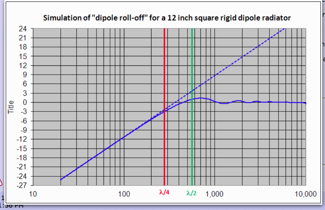

Since Bolserst posted it (post #5), nobody would dispute it:
Dipole phase-cancellation in ESL speakers
Turn the diagram upside-down and it should look like a Linkwitz Transform.
That's the theory - the one I sometimes call "wave arithmetic". Now I'd like to see how a dipole works in a real room. There are all kinds of ways to explore this question. Maybe the best test is simply out of doors (where the wave arithmetic ought to hold precisely) versus indoors.
B.
Basics to Ben et al.
Dipole cancellation causes 6dB/ot roll-off in spl blelow certain frequency that is determined by baffle width. This roll-off must be compensated of course, typically by attenuating higher frequencies respectedly. (boosting lows will lead to high distortion too easily). This is the reason for low efficiency and need for large bass membrane area.
In a small room, placed near front-wall behind the loudspeaker, a dipole naturally "splashes" the front-wall with same energy and spectrum as frontside radiation. This splash gets reflectec back and gets summed to frontside radiation with certain delay causing aberrations in summed response. This happens with monopoles too, but they send less energy bacwards and at low freq phase remains same despite of delay.
Summed response has aberrations that depend on separation distance, frequency and absortion of the front-wall. These aberrations are inevitable and an elemental feature and factor of why dipoles sound different from monopoles. A single measurement is always limited to it's parameters (gating, resolution, smoothing) - we must see the big picture!

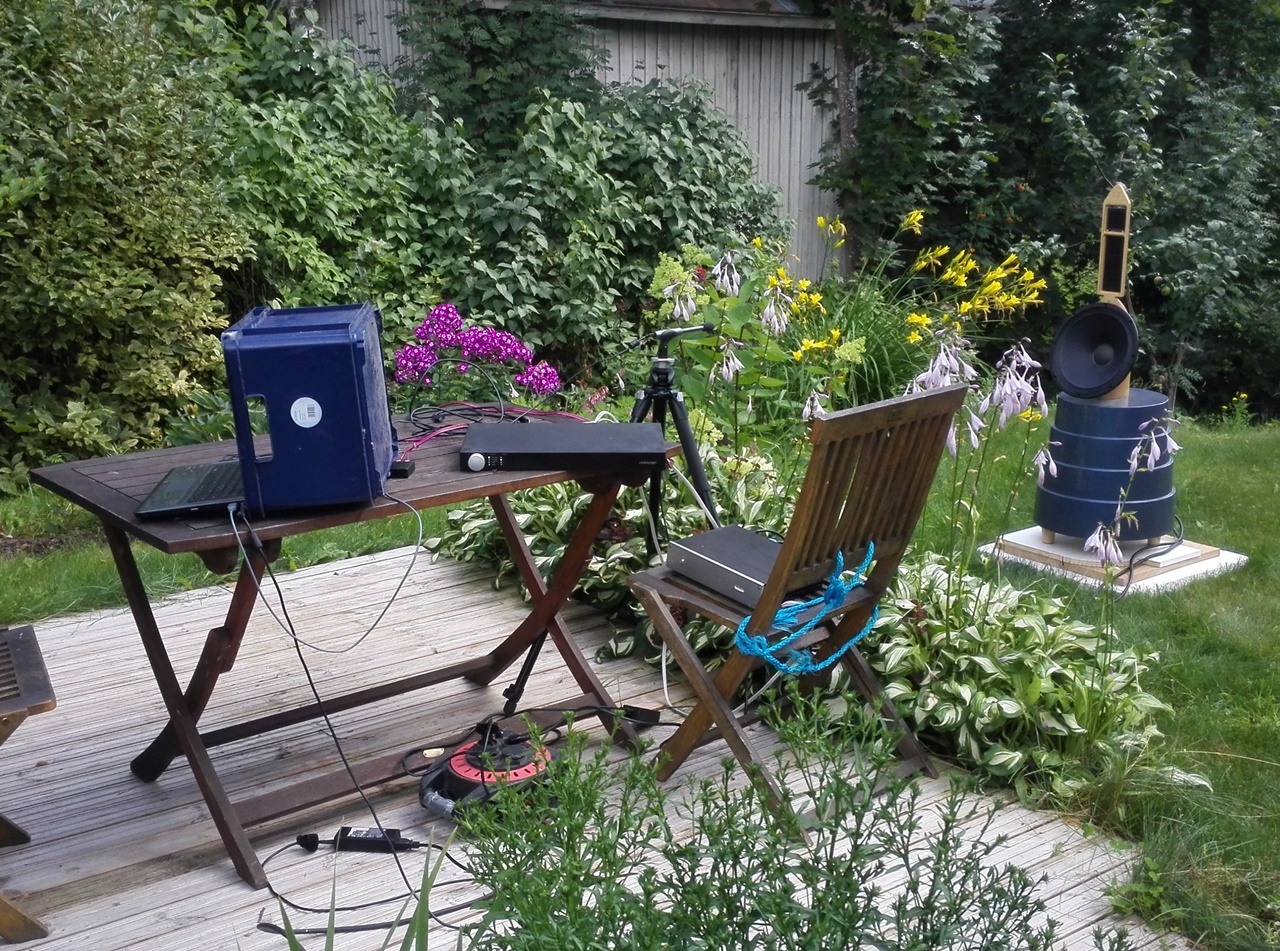

Ben wants to see real world measurements. I have lots of them in my signature thread, but here I picked some. My AINOgradient has monopole bass crossed LR2 around 150Hz (depending on xo version). The diy MR183w is all-monopole, but unfortunately I don't have outdoor measurements of it. IR windowing of the sweep is here 120ms in all. More analytical study of reasons for all deviations/reflections is not appropriate in this thread.

6dB/8ve is hardly "rear waves sneaking around and annihilating the front wave" 😱Since Bolserst posted it (post #5), nobody would dispute it:

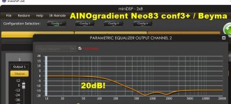

Actuallly and basically you are right. I was thinking of modern dsp-controlled systems, when the user is fascinated to apply boost to straighten up low end response. This will easily lead to clipping in digital signal and even in analog amplifier.
The challenge is to balance a multiway dipole loudspeaker's driver construction and amplifier gain&power so that low end distortion won't be a problem with high (hifi) spl, 100+dB. This requires large membrane area, high excursion and high power.
This is the eq curve that I must use with my nude 12" midrange, to get straight farfield response. Then I apply LR2 highpass curve around 170Hz.
... I don't have outdoor measurements of it.....
Kind of risky of you to have such authoritarian views of how the room influences dipoles without seeing how they perform outside the room.
