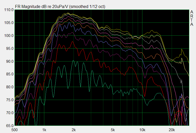

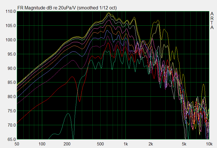

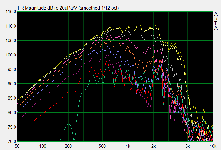

I thought I would show the responses I measured previously with the driver hanging by wires and away from boundaries, for the drivers that I plan to use in my 3-way dipole system (e.g. a stereo SWT arrangement, with S=Subwoofer, W=Woofer and T=Tweeter). Using only a 3-way with nude drivers requires some wide bandwidth and careful selection of driver size, but I think I have a set of drivers that will work well in this application.
Attached are multi-axis measurements in the horizontal plane. For the "W" driver there are two plots - these are data that was taken separately at the front and rear sides of the driver. As you can see, very similar responses. The main difference is in the rear response, where there is a dip in the output around 1.3-2kHz in the near-on-axis responses. Note that all SPL levels are only relative, not absolute.

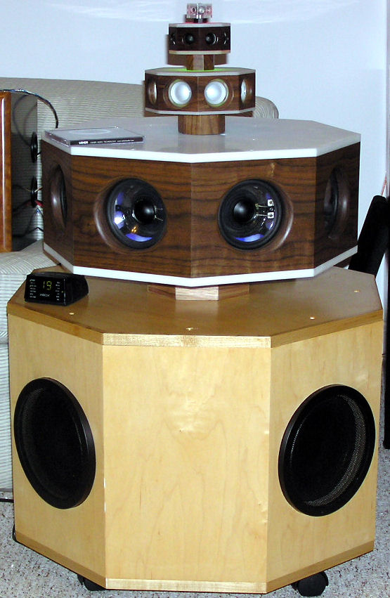

I also demoed and measured a 4-way SWMT design last year (since disassembled) that uses a 6" midwoofer to span about 750Hz- 2.5kHz, but I have decided try the 3-way system first. It would be an easy matter to add the midwoofer, however, it takes up some vertical space and I could not easily accommodate the subs below because the tweeter would be located too high. Instead of stereo subs I would use a separate, large H-frame that I have built around a high-Xmax 18" pro driver as a central mono sub, with the remaining 3-way stereo pair flanking it.
The "T" driver measurement is for a back-to-back dome tweeter setup that I came up with and which I am still developing.
I hope to cross over from M to T just under 2kHz with a steep slope using IIR DSP filtering. This is mainly determined by the distortion profile of the tweeter, and I would go even lower if I could. I may try to do some group delay EQ using FIR filtering later, to see if flattening the group delay (there will be a peak around the crossover point) will result in any audible effect.
I see 9 curves in each of your 3 measurement pics. Are these at 10 degree intervals from on-axis to 90 degrees?
Are these measured in a room? If so, could you post a diagram of the room dimensions (including height) and exactly where the dipole & mike were place? Did you rotate the speaker?
What software are you using?

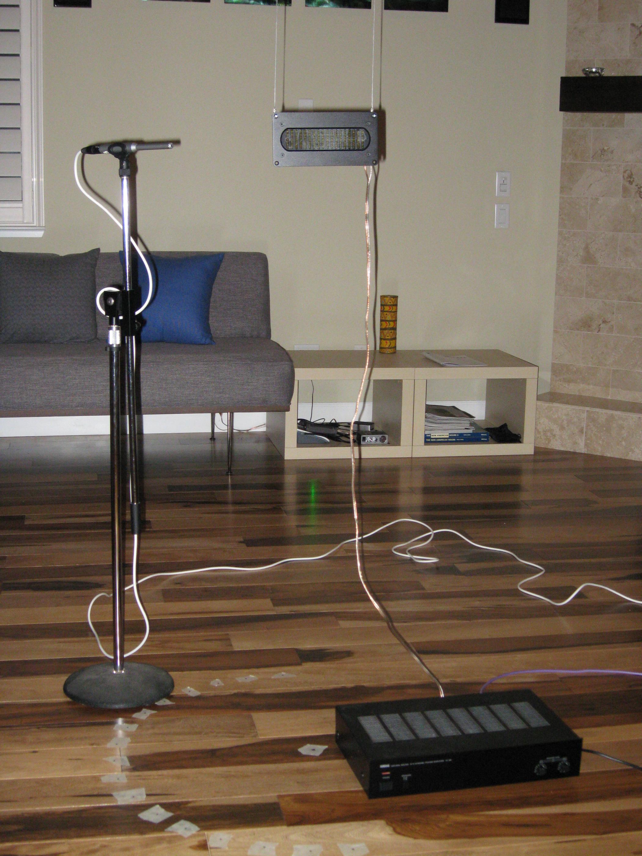

This was a large, 2 story high room in my previous home. So it might be 30x30 and 20 feet high. I was able to get about 50Hz resolution on my measurements. It helps that dipoles do not radiate much energy down towards the floor, so the floor reflection is minimal.
I set up the drivers between a couple of PA speaker posts, between which I ran a piece of wood. The drivers were hung by wires from the piece of wood. Then I marked out angles on the floor using tape. I use a rudimentary system where I can easily mark out 0-45-90 and then I fill in between those at 22, 66 and then in between those at 11, 33, 57, etc. I don't find a need to be any more precise.
If you hover over each image you should be able to see the filename in the browser at bottom and that is descriptive regarding angle and so on.
