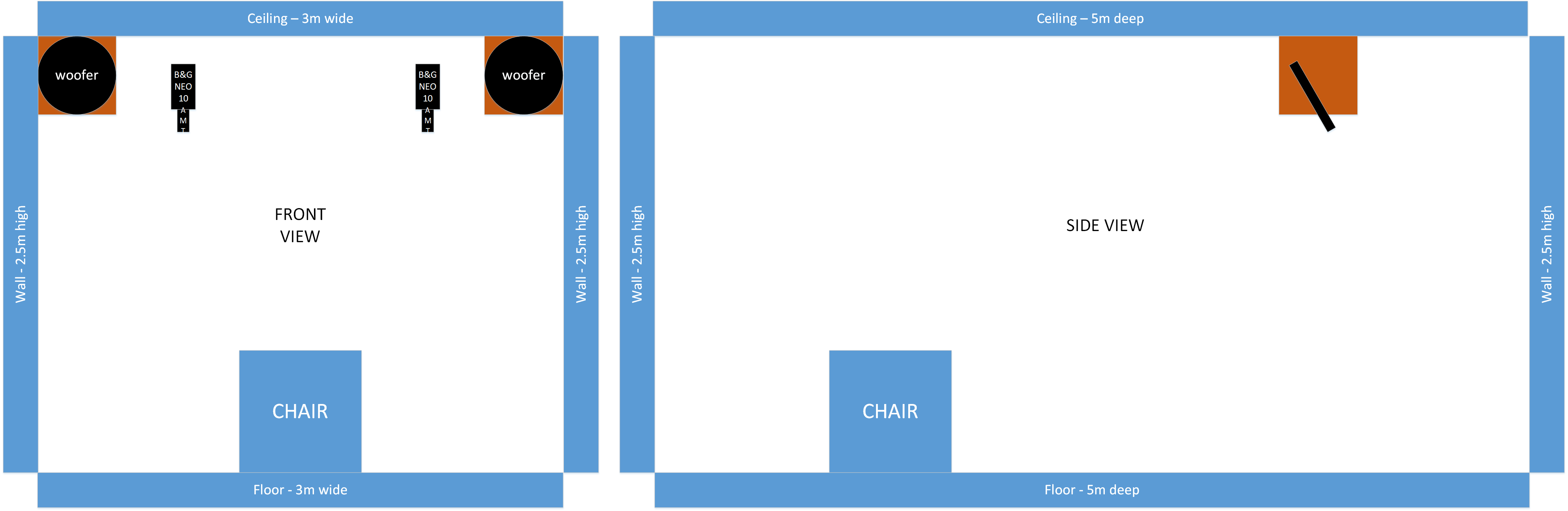

for our 3x5m hobby/office room I am considering some dipole CD speakers as well - but I would like to keep the speakers out of the way: kids are running around, we want the workbenches and closets to be acessible, etc. So I though about hanging the speakers on the 2.5m high ceiling.
I thought about placing the woofers, going up to maybe 200Hz in the corners, to have reinforcement of both ceiling and walls. The layout of these would look like the picture in the attachment. What do you think? I am not yet sure what I would use for mid and high frequencies, so I put in the NEO10s and AMTs again, which are very nice units indeed.
I want to experiment with tilting the mid/hi units. I drew a chair in there, which is the position where we are sitting doing our office work, but it would be great if the "sweet spot" would be larger, as during hobbying we walk around the room, do some work on the floor, etc.

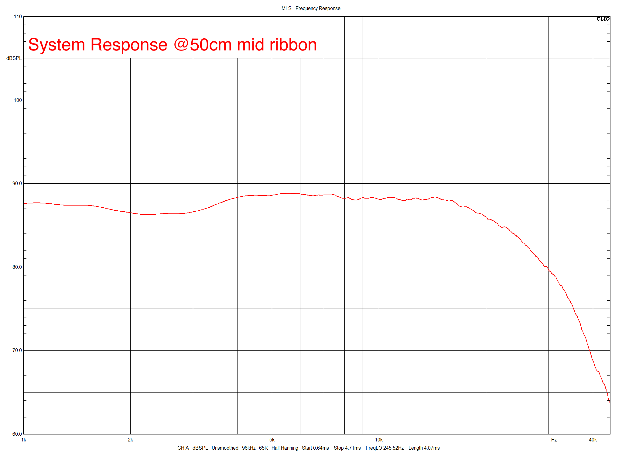

The response curves are measured quasi-anechoic without any smoothing applied 🙂 The resolution is of course limited by the measurement length. The parameters are shown in the legend with the measurements.
Here's the response measured with 96kHz sample rate to show how the ribbon drops off above 20kHz:
The step at 2.5kHz is because the response is measured mid-ribbon @ 50cm, at a greater distance the curve is flat. Again, no smoothing applied (length= 4.07ms ~ 250Hz resolution).
I use a Hypex DLCP for the filtering, asymmetric shelves are used to correct for the dipole drop off and create part of the high-pass filter, see the thread for details.

I used the Audiomatica Clio 11 measurement system and imported the results in the Hypex software to design the filters. The Hypex software is only geared towards filter design and does not have functions required for driver design. During the development of the ribbon I used frequency response, distortion analysis (to 5th harmonic), CSD and of course directivity to evaluate the performance. Because of the required dipole correction is is very important to measure the distortion of a driver with the correction applied.
