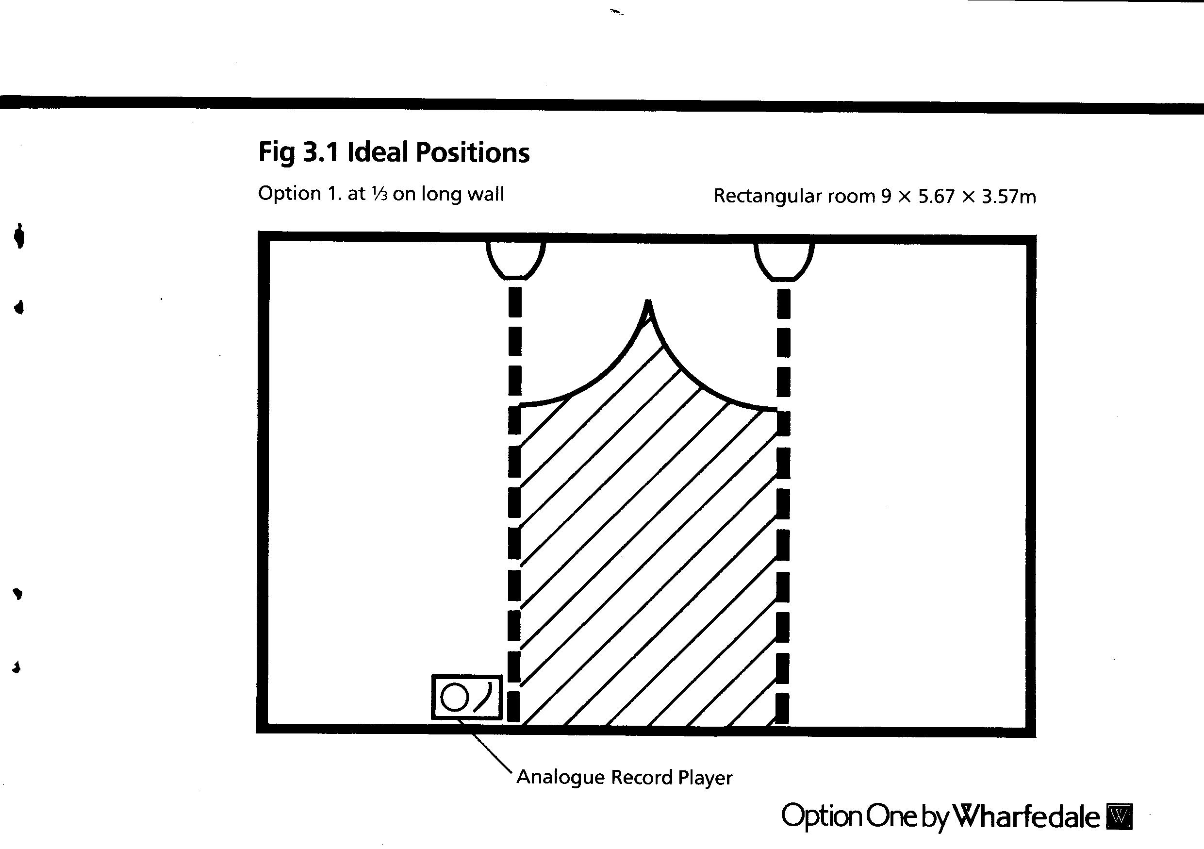

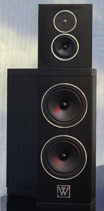

Here's an idea of what size dipole would be needed not to have loadsa bass boost.
This is an active dipole, 1.35m high 0.768m wide to be positioned against the back wall.
With floor & back wall images, the effective baffle is 4x the area; 2.7m high and 1.536m wide.
You listen to it well off-axis as in the 2nd pic. The 1/3 locations are ideal.
The bass dipole goes down to 35Hz in the room. There is some electronic EQ but nothing that I would call bass boost.
To go below that, you would need more drivers. Instead, the back part of the 'baffle' is a 90ltr ported subwoofer covering only 25-40Hz. It's switched off most of the time to have 100% dipole bass. The sound is usually unchanged but instruments like cellos & double basses seem to move if the sub is on.
The last pic is Option 2 about 3/4 the height of Option 1 but about the same width. This needed 10dB (IIRC) bass boost for flat in-room response to 35 or 40Hz.
I'm somewhat hesistant to post this as the speaker is heretical on so many fronts. But it represents (among other things) one elegant & successful, if expensive integration of speaker and room. Here, I present it as data on the size of baffle required for a given in room LF response without bass boost.

No. MIT points his dipole at the back wall. I fire my dipole parallel to the back wall. He has all the yucky stuff you describe and gets no boost from the wall ... only yucky cancellation.---

My arrangement gets this 🙂 MIT doesn't.The sound projected against the wall gets huge boost and wins the fronside radiation.
This is some of the yucky stuff MIT's arrangement gets. This doesn't happen with my arrangement.In measurements we could notice it's reversed polarity and group delay. Semi-nearfield measurement would most propably show nulling on-axis like on cardioid's backside.
Option 1 was really designed to astound & amaze at shows ... which it did very well. We sold 12 and just broke even .. which surprised me. I thought we would make a huge loss. 😱This system was obviously presented by Wharfedale in '80s, but got forgotten very rapidly - no wonder.
Option 2 was the domestic version. We didn't go ahead cos our real bread & butter was small speakers. We made & sold the most successful & the 2nd most successful speakers in Europe for more than 7 yrs .. which was the period when FBA members revealed their sales figures to other members.
I wouldn't do another speaker like this unless you twisted my arm. It's quite expensive & you need a large room. But it presented stereo better than anything before or since and it integrated nicely with the room if used as recommended.

A dipole works when standing on the floor. The back wall is just another 'floor'. Remember my dipole isn't firing AT the back wall. It fires PARALLEL to the back wall. The floor & back images makes the effective baffle 4x the size of the original.
If you have a flat panel speaker like an ESL63, why don't you try it for yourself? It's easy to check a dipole's Fig-8 directivity on pink noise.
