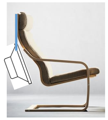

No, that would be too close and too low. The speaker was hung from a seperate stand, a heavy mic stand. The armrests for the Poang could be extended to behind the stool and connected with a cross-bar from where the driver hangs down, if you want to go for an "integrated solution" ;-) Might need an added front weight so the Poang doesn't fall over when not occupied...
For sweet-spot-only duty in a small room a near-field OB mono-bass (15"...21" nude is nice for this) mounted behind the seat is also an option and if you couple it to the chair mechanically it doubles up as a shaker (but then maybe better float the chair on dampers). Should give serious impression of very deep bass even down below 20Hz.

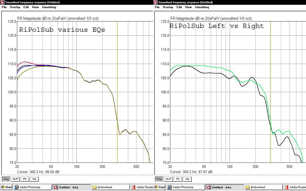

Following up on my post #163; Images of the cabinet are posted there.

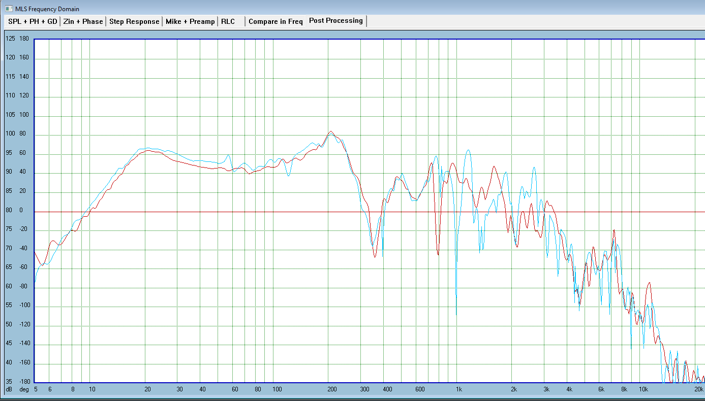

I have made nearfield measurements from both sides of the cabinet. The two slots on the front were added together. The front and back are pretty similar save for two sharp resonances.

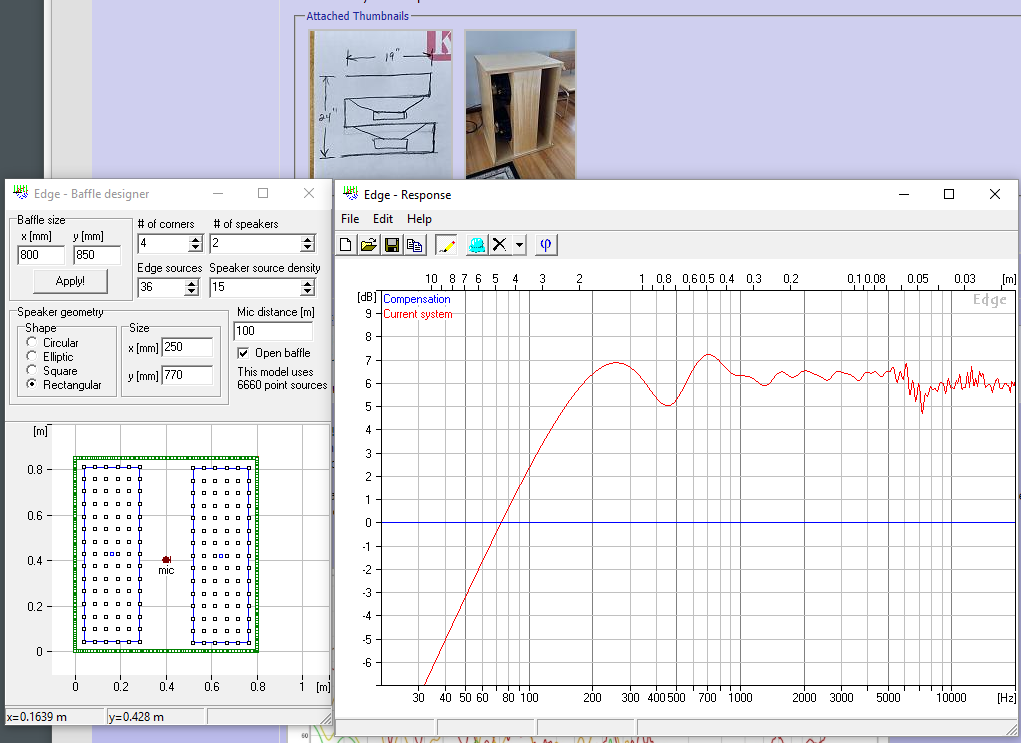

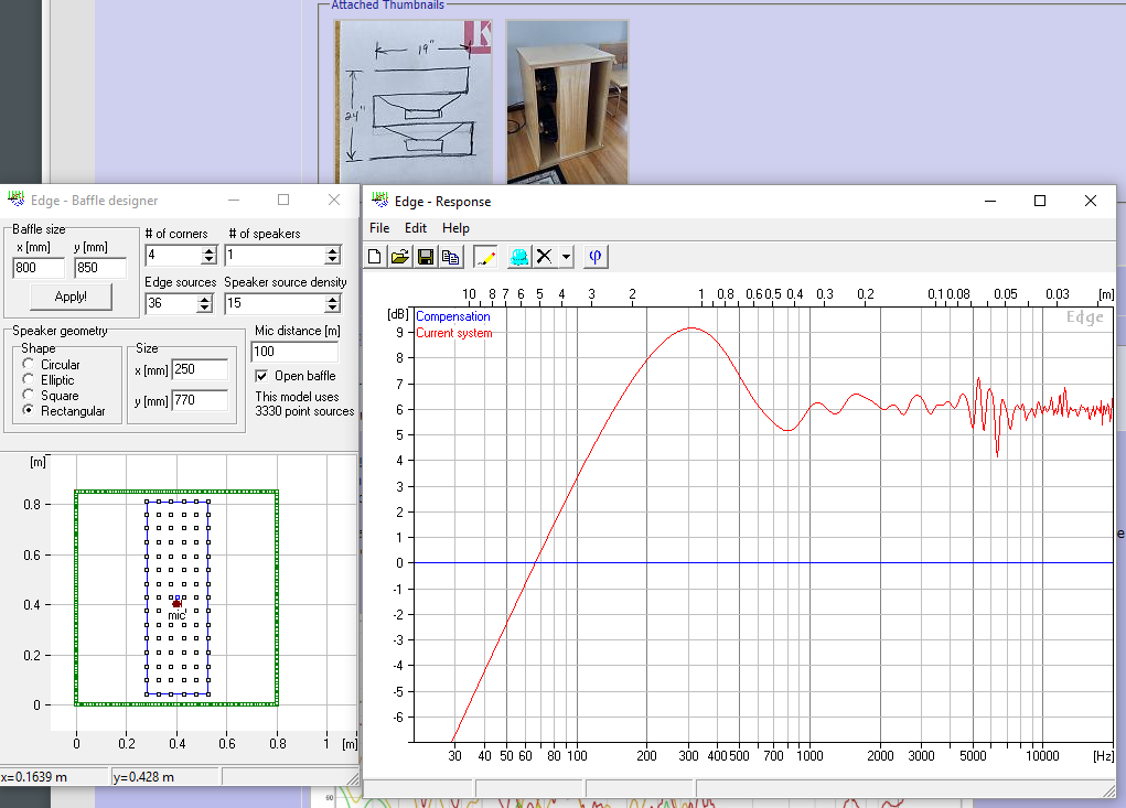

I've done simulations using "Edge". Tried several driver sizes and arrangements. The choice of driver size makes a big difference. I've not found a way to export the response as a text fie from Edge. If anybody knows a way please let me know. The pics attached I think show the closest approximation of this cabinet. Probably an average of these two would be closest to reality.

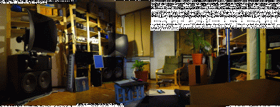

here is my all time favorite forum thread
frankensteins monitors - Page 13
the guy is using ripole subs to complement his JBL 4435 cabinets
Thanks for posting your measurements. Real data is gold. It looks very good to me. Is it a "ripole" type dipole sub you made with four 18" drivers?
Im not sure Edge can model such a complex fold. I tied an estimate with four round drivers on an unfolded ripole but even with my inevitable mistakes I think its a waste of time to be honest. I attached the file by adding .txt. To open it chop off the .txt and use Edge. To save an Edge project go to the window with the plot "Edge Response" > File > Save as.
I think Hornresp would be much better for modelling a ripole - can anyone model it and post up the txt file?
In the meantime it really is real world measurements that matter so thanks so thanks to the tip off
in the frankenstein twin ripoles measured at the listening seat:

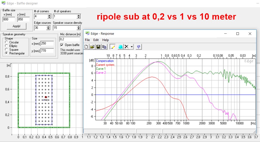

This is the very nature of large dipoles. In the post above there is simulation at 4m and measurement indoor at roughly 1m and we have seen many measurements at the mouth. Indoor measurements are very tricky with all the modes seen with long IR gating required to see low frequencies in the first place.
These a basics that one must comprehend to be able to interprete measurements and statements. Many web pages are full of amazing results with dipole or ripole subwoofers, but I very rarely see descripitons how measurements were done, what size the room was etc. essential info.

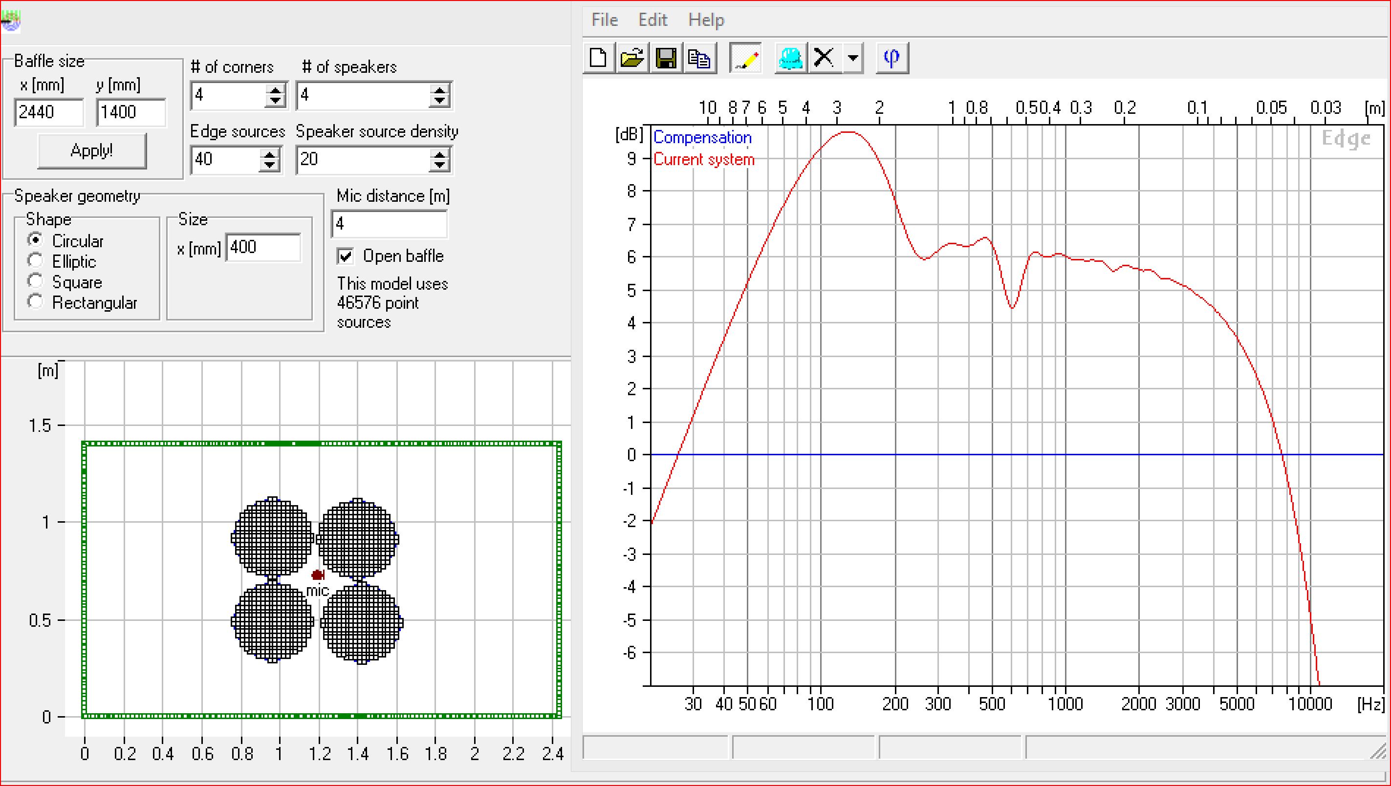

Here is pixelpusher's simulation at 10 vs. 1m vs. 20cm distance. His first one had 100m distance (300') Edge has anechoic conditions always.
