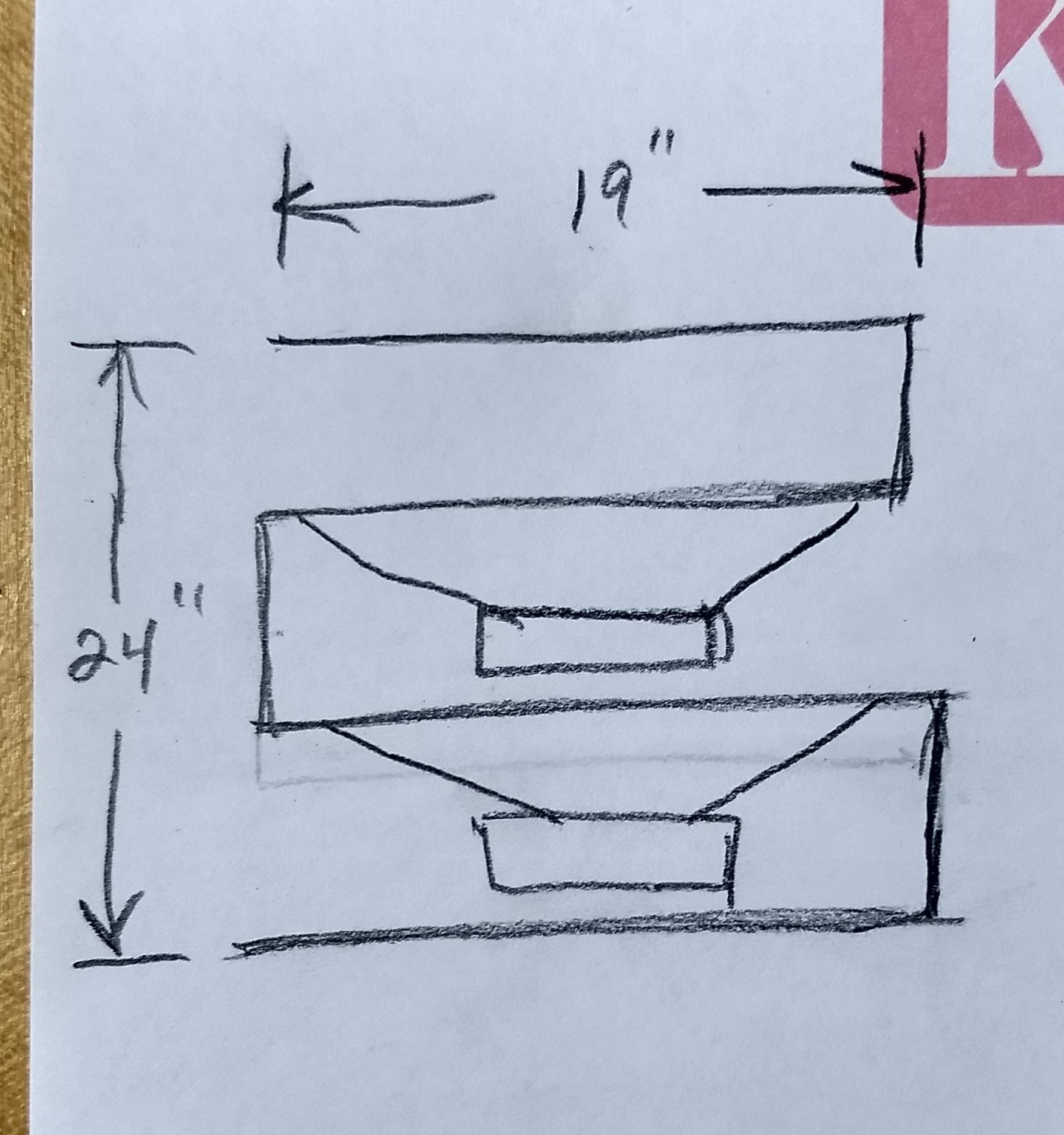

Question for you Dipole experts:

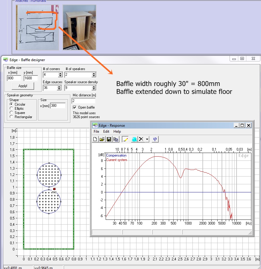

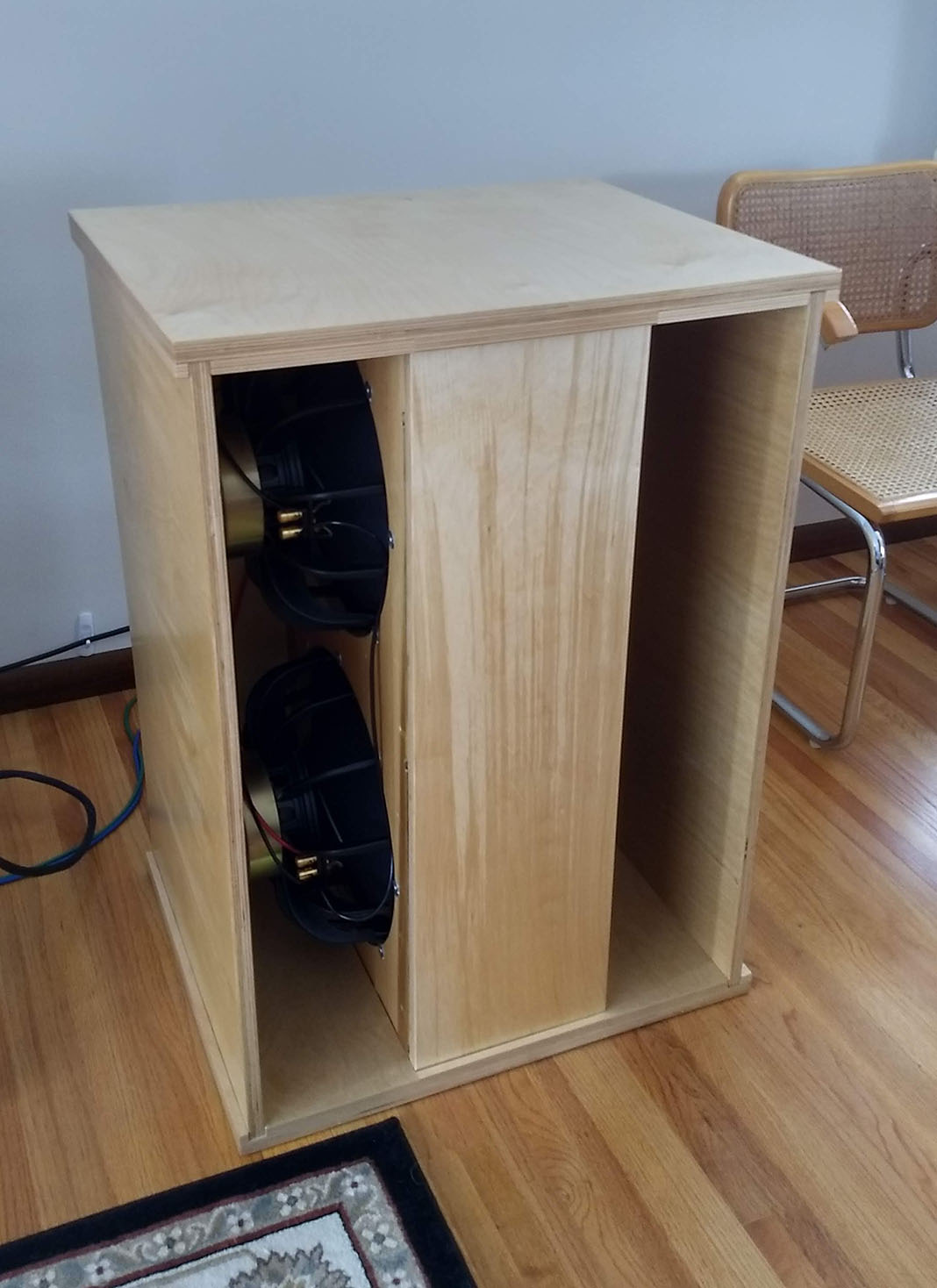

I recently built a Dipole Sub based on Linkwitz's Pheonix design. It is 19" X 24" wide. I wonder what baffle width to use in simulations such as "Edge program".
See the attached pictures. I am not sure if this is a simple "H Baffle".
Thanks for your help.

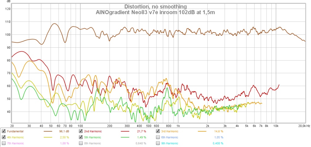

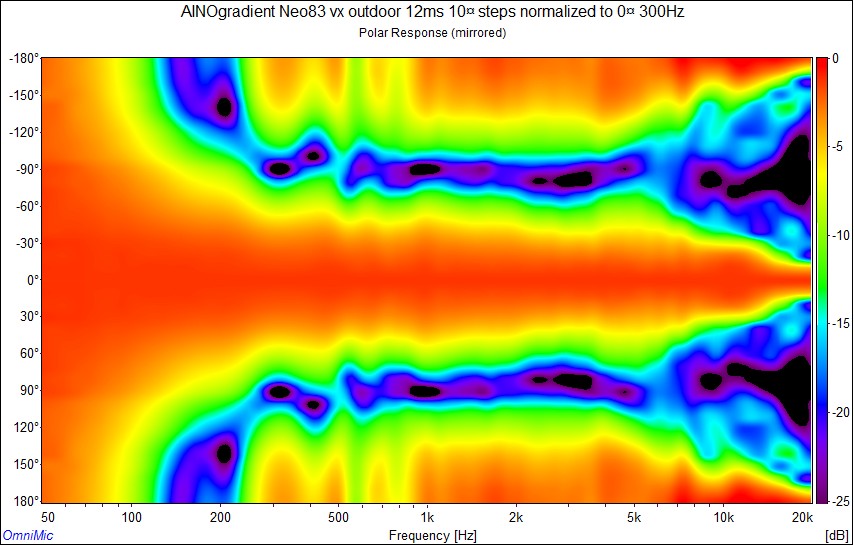

My practical choice is monopole 10" 25liter closed sub up to almost 200Hz, LR2 xo to dipole nude 12" makes cardioid response 100-200Hz. Minidsp. Room response almost flat from 15Hz up and low GD. Moderate distortion below 40Hz because monopole gets boost from boundaries. Me happy.
I would do it like this:

^when I look at it again, perhaps virtual baffle width is much smalller. These are like cardioids, simulations might go wrong for may reasons
- unequal distance to edge front-back and up-down
- boundary effect of the floor
- boundary effect of the wall on the backside
- what else...
And, measuring at opening "mouth" and calculations -like Linkwitz and Nelson Pass, most likely are wrong too. A thread Nelson Pass: The Slot Loaded Open Baffle Project

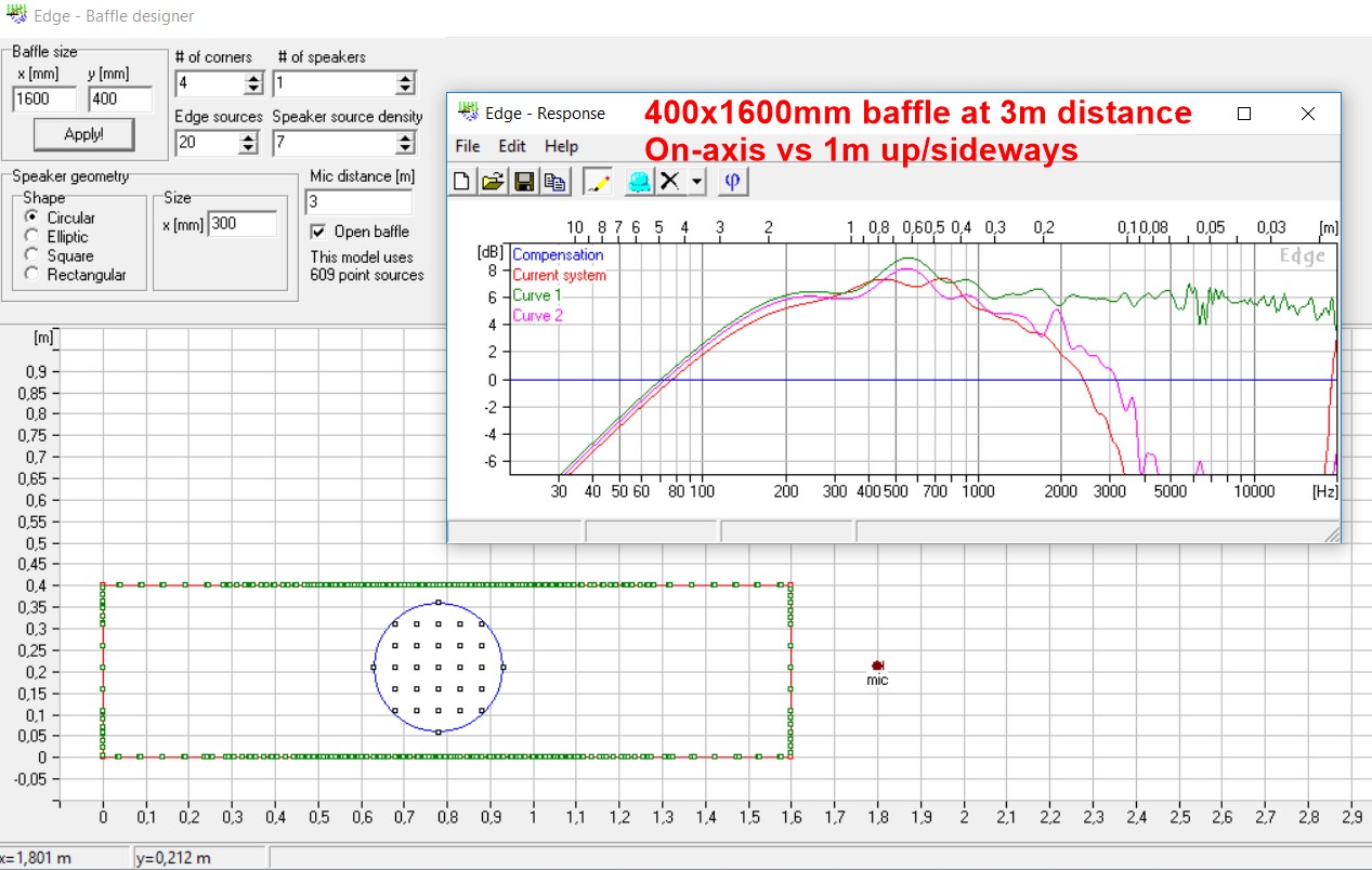

I Edged the response of asymmetric dipole baffles, standard height.
Low end gets better and peak widens.
Off-axis stays surprisingly symmetric.

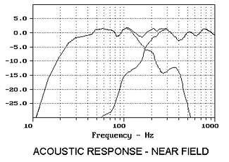

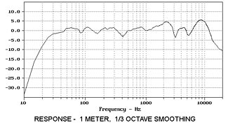

Here linked pics of Nelson Pass's SLOB 2-way. Huge, lots of eq and 20Hz -10dB at 1m (still nearfield of this baffle)
The Slot Loaded Open Baffle Project Article By Nelson Pass
I would do this:
1. measure the response at both the front and the back openings, in the plane of the opening. This will capture the output (like a nearfield measurement) of only the driver, in the box, plus the resonance(s) of the tunnel of the H-frame, but not the dipole (far-field) response
2. Model the dipole response in the Edge by using a square baffle. For the length of each edge, use the front-to-back lenth of the H-frame plus about 1/3rd of the height. The driver should be in the center of the square baffle.
Add the two responses to get a rough model of the far-field response.
If you do not measure the front and back response as in (1) you will not capture the resonances, which cannot easily be modeled.

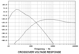

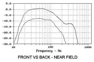

You can glean some info on the un EQ'd response from this plot:
The upper curve is the front and the lower the rear. I know this because the "slot" has a resonances, and that is the 'bump" around 350Hz in the upper curve. Without EQ this would stick up quite severely I think.
The SLOB has some practically useful traits, but this one is really huge. It would be better for it to be away from the back wall, but that is not so practical, and the large baffle is in the way acoustically speaking. On the plus side you can use a large number of opposed drivers up and down the length of it. That adds up to a lot of displacement. The front-to-back pathlength is large, which translates to very little dipole cancellation until you get to very low frequencies.
You need to use smaller (e.g. 8" would be perfect, 10" OK, but not larger) drivers to keep the resonance frequency high enough. NP used 8" drivers. The resonance frequency of the slot is primarily determined by the depth of the slot and the deeper it is the lower the resonance frequency and you don't want this in the passband. Also, like a U-frame, the resonance only happens on one side of the thing so you cannot EQ it out very well and keeping it high and out of the passband is the best approach.
