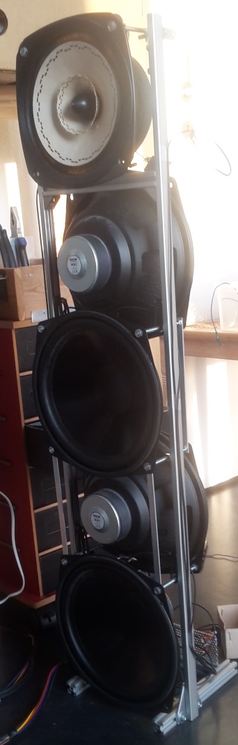

I use reversed drivers in my other speaker: 4x WS25e per side (a high QTS 10" woofer with 5.5mm xmax). I did it mostly because:
- I wanted to keep a narrow baffle (Gerrit Boers thread explains why) but have as much cone surface as possible below the Fostex widerange at eir height. This way I was able to fit 4 instead of 3.
- I am also lazy, so attaching them with some bolts and alu strips is faster than woodworking;
- And indeed, maybe the distortion is also less and the dipole figure more constant - I have not measured.

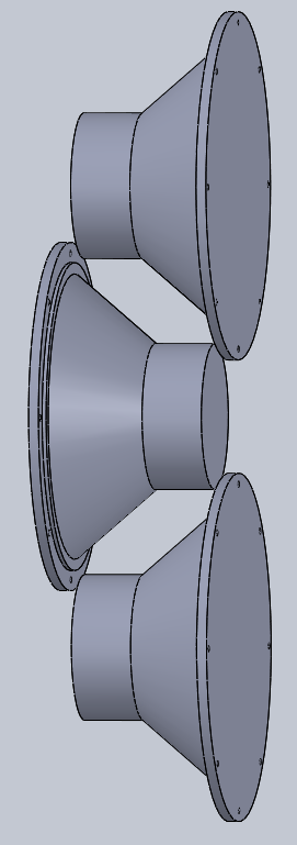

I am still thinking about doing something similar with the new speakers using the SB34NRX75-16: I could fit three below the midrange and tweeter. The sketch shows it, the total height would be 80cm, so still enough space on top for mid and tweeter. Thinking further, this could turn into a 4 way, add some wings, the two lowest SB12s playing up to 100Hz, the top another 2 octaves... and a new project is born :)
