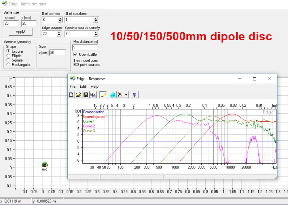

Edge simulation of radiating pistonic discs of various size. In my previous post only baffle diameter was changed. But as we can see, it is almost the same. When baffle is larger than radiator, dipole peak gets wider.
In real life and specially with cone/coil+magnet drivers, both front- and backside radiation are far from these ideals, even more above dipole peak.
p.s. Count me in fans of closed box bass sound! My first hifi-speakers had those, but I spoiled 35 years of my life without them!

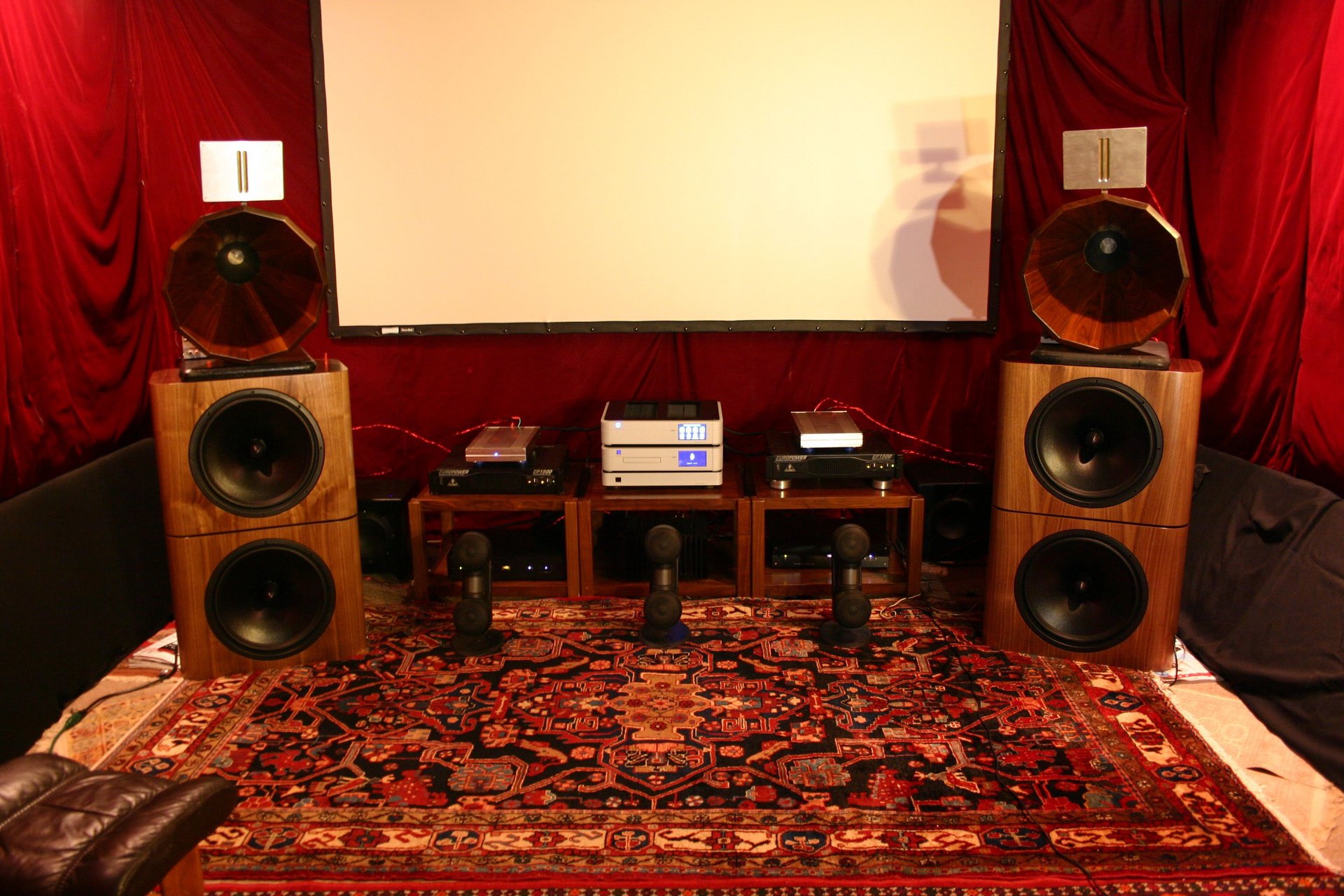

Gentlemen: I appreciate the kind words. A U-shaped enclosure is something of an interest for me. Is the rear/open portion handled in a similar fashion as the Hartley "Boffle"" ? Please see the attached pic for an interesting way of doing things. It's called a UB-151 subwoofer.
https://www.diyaudio.com/forums/mul...b151-modular-baffle-design-2.html#post4322866
He promised to show measurements in a bigger room, but then the thread ends... Subs/woofers are deep in corners with walls that look like concrete.

To me that just looks like a box with no back. I suppose that's technically a U baffle, but it's not what comes to mind when I hear the term.Is the rear/open portion handled in a similar fashion as the Hartley "Boffle"" ?
Gary Pimm in Oregon uses a similar shape for his midrange. But Gary uses carefully chosen stuffing inside to attenuate the back wave and create a cardioid pattern
I tend to think of (and build) a U baffle as a flat baffle with short wings and little or no top. The surface area of both wings is less than that of the baffle. The bottom is often the floor. As we know, the longer you make the wings, the more likely are cavity resonances. Those aren't something you want in your OB. Cavity resonances can be avoided in several easy ways.
- Keep the wings short
- Flare the wings out
- Make the wings asymmetrical
- Taper one of the wings top to bottom
