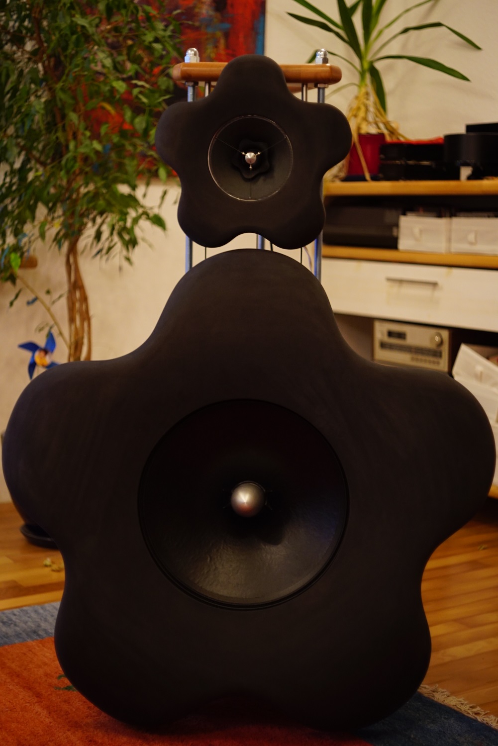

Dear All,
yes, this is quite an interesting thread, and I respect Charlie´s pursuit a lot, as I myself will never accomplish this goal with an 18-inch woofer and an 8-inch wideband driver...
So of course I ask myself if I have done it wrong?
It would be very interesting to judge pros and cons of one approach versus the other, but difficult to do.
I might add some personal experience with low OB bass in my room, and yes, I´m one of those 1919 guys who still use passive filters, have the loudspeakers well out into the room, and use only one amplifier per channel...
Deep OB bass is certainly possible, and even without DSP, even nude driver, but then efficiency is gone.
I arrived at a baffle of effectively 930 mm path length. The pair of AE Dipole 18-8 will move nearly 3 liters of air in each direction, and that accounts for an in-room respone down to 25 Hz, with an efficiency of around 90 dB/2.8 Volts (coils in parallel, of course).
Maximum level is high, I measured up to 110 dB at listening position while enjoying Jonas Hellborgs "Silent life" with tap fully opened, loud enough for me. And no, I have no neighbours...
All the best
Mattes

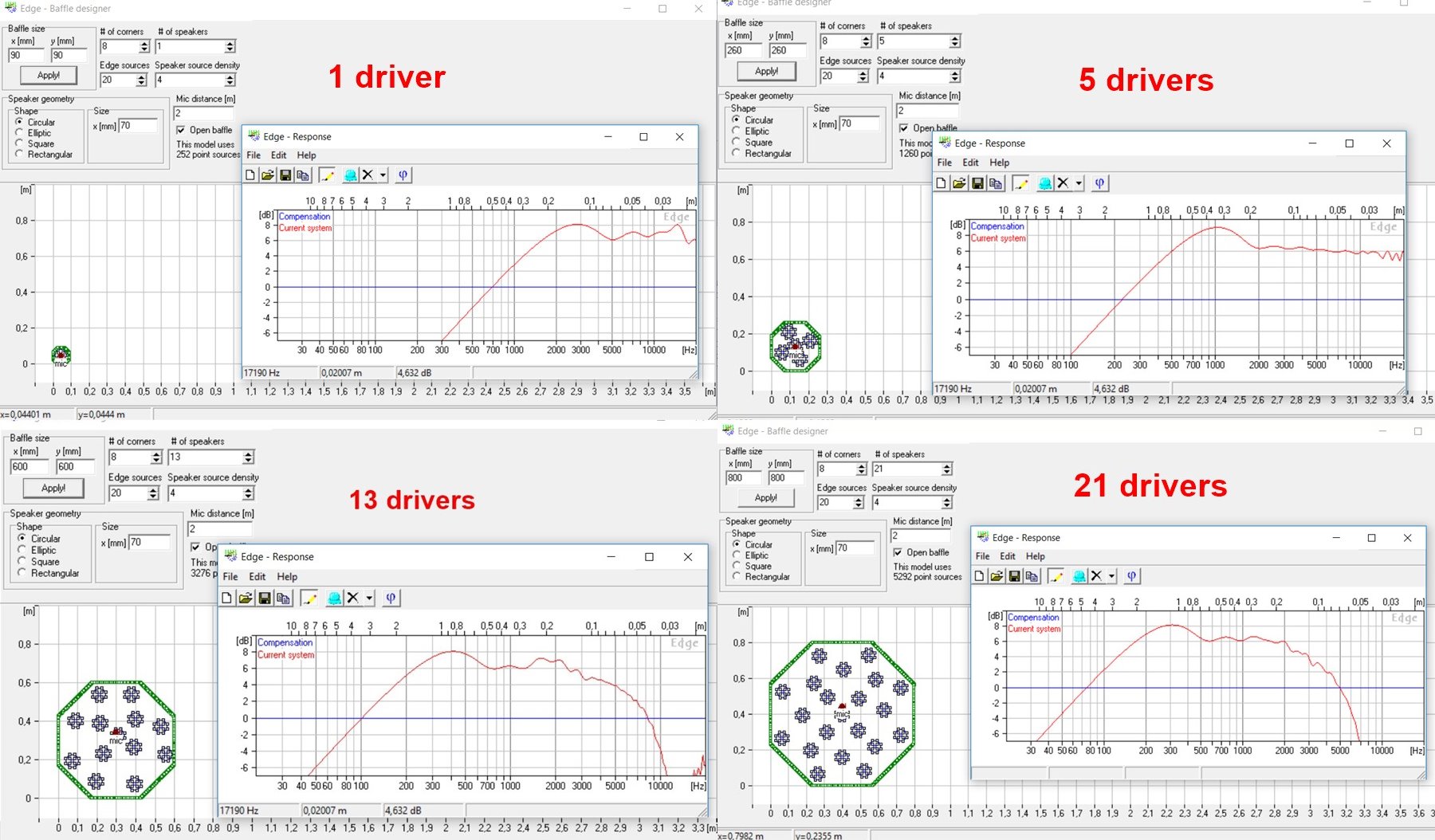

An Edge excercise with KSTR's idea. The program didn't behave right without a baffle but I varied it's size. All 21 full-range drivers should be connected to a metal grid/web which is acoustcally transparent. A 4-way crossover with just lowpass at different frequencies would do. Center unit might benefit of having highpass too.
Still in real life we are in trouble below 50Hz and above 5kHz. Even B&G Neo3PDR has frame of 7x6cm, so dipole summation doesn't work above 5-6kHz.
