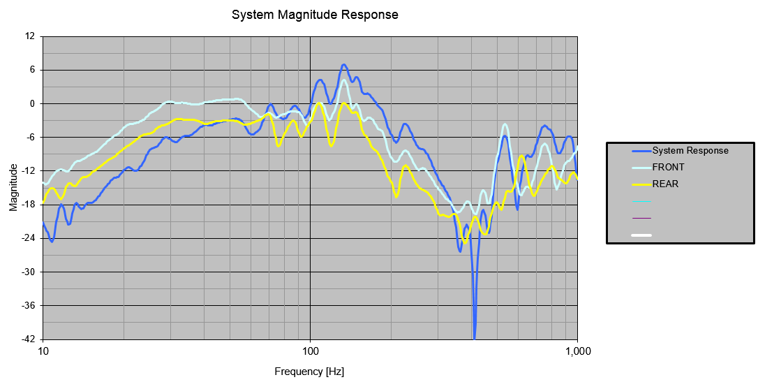

Let me give you an example of an H-frame that I built and measured as a test bed early last year (currently disassembled). This used an 18" 90dB/W high-Xmax subwoofer in an H-frame dimensioned 24"W, 24"H and 30"D.
I measured the response at the front and rear openings, in the plane of the opening, in the middle of the opening. From that I can create a model of the dipole without having try and measure it directly. This is because at low frequencies wavelengths are long and you can model the front and rear as two monopoles, the rear one reversed in polarity, and separated by D=30". The first plot shows the SPLs of front (cyan) rear (yellow) and the dipole response (dark blue) at a distance of 2m in front of the H-frame. The levels have been normalized so that the front SPL is 0dB in the region of 30-50Hz. I also compensated for the extra distance the rear wave must travel to the listening position in its SPL, and this results in about a 3dB lower level for it at the listening position as shown in the plot. To make the blue (system) curve I take the FRD files and apply an inversion and delay, plus the -3dB SPL distance correction, to the rear data before summing them.
The CYAN curve is the measured response at the front opening.
The YELLOW curve is the measured response at the rear opening.
The BLUE curve is the synthesized H-frame response (its dipole response) at the listening position, 2m distant and in front of the front opening.
Looking at the plot above, we can observe the following features:
- The driver response, e.g. at the front opening of the H-frame, is relatively flat to 30Hz.
- There are some resonances in the front and rear response between 70Hz and 150Hz.
- The 1/4 wavelength transmission line resonance of the H-frame creates a null around 375Hz and the response starts falling into this around 150Hz.
- The H-frame response has a dipole peak around 140Hz, and this is +6dB WRT the 0dB level
- Below the dipole peak there is a region with a 6dB/oct slope from about 40Hz to 120Hz
- Below 40Hz the rolloff resulting from the driver's fundamental resonance kicks in and the response falls more quickly but only approaching 12dB/oct from 10Hz-40Hz
- At 40Hz the sensitivity of the dipole is only 3dB less than the response at the front, which is essential the 90dB/W free air sensitivity of the driver, so 87dB/W@1m

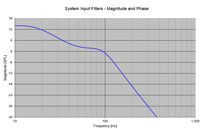

In the above curve for the correction filter I am applying 3dB of boost at 40Hz. Boost increases below 40Hz to lift the response and only a LP filter type rolloff is used to both compensate for the dipole peak and create a LP crossover filter. This is possible because the Q of the dipole peak is not too high and the necessary correction is simple. It is a similar approach to the one that Martin King used in his paper comparing an OB, U-frame, and H-frame.

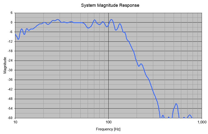

Below is the resulting H-frame dipole subwoofer frequency response, at the listening position:
The response is flat to 20Hz. Even though the correction filter applies up to 12dB of boost, this happens at low frequencies and the relative program level near 20Hz is not as high as above 100Hz so this much boost is not so difficult to manage. Less boost can be used at the cost of some low frequency extension. The H-frame dimension D and tunnel cross section vs Sd has been chosen so that the dipole peak is about where you want to cross over to the next higher band, and the Q of the peak is not too high.
I did build this subwoofer and I knew the first time I ran an impulse sweep on it that it had some impressive bass. Even if you did not use boost (eg. a passive filter only) the response extends to 40Hz before rolling off. I took the data and did the modeling, and this is what I had planned to create but I had to disassemble the system. I hope to build it again soon with some nice, heavy materials to keep the H-frame in place and resist the cone movement.
CharlieLaub, this is an amazing outcome. I'm curious how big your room is, and distance between the wall - sub - listening position.
The room was about 20x15 feet. I just tested the sub (made measurements on it) out in the middle of the room. It was never really set up for listening.
Also, keep in mind that I did not measure the response in room, I only predicted it from a model. It should be accurate, but the model did not include the room boundaries, room reflections, relative location in the room, and so on. But I did listen to the un EQd sub during testing and was impressed.
