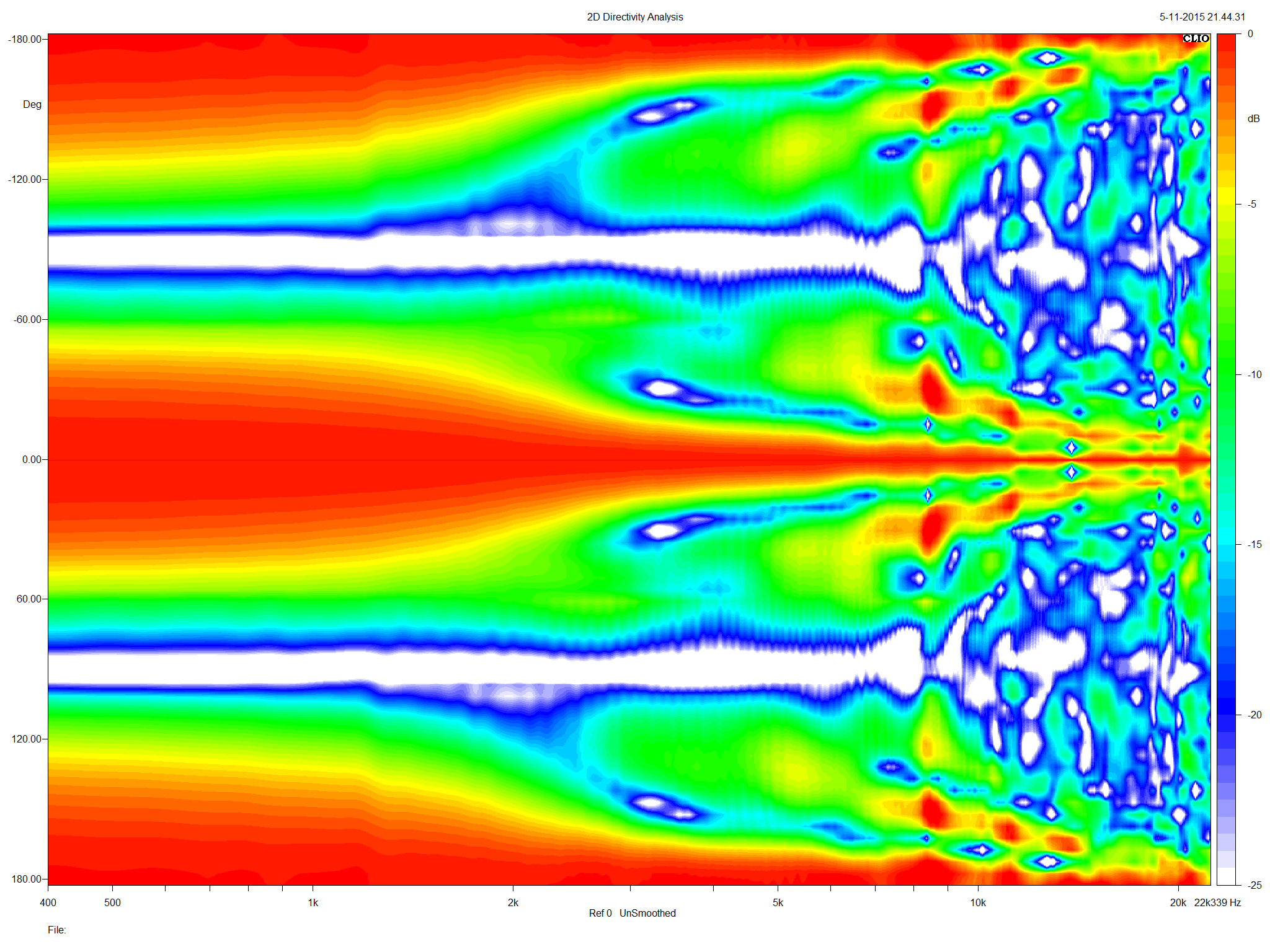

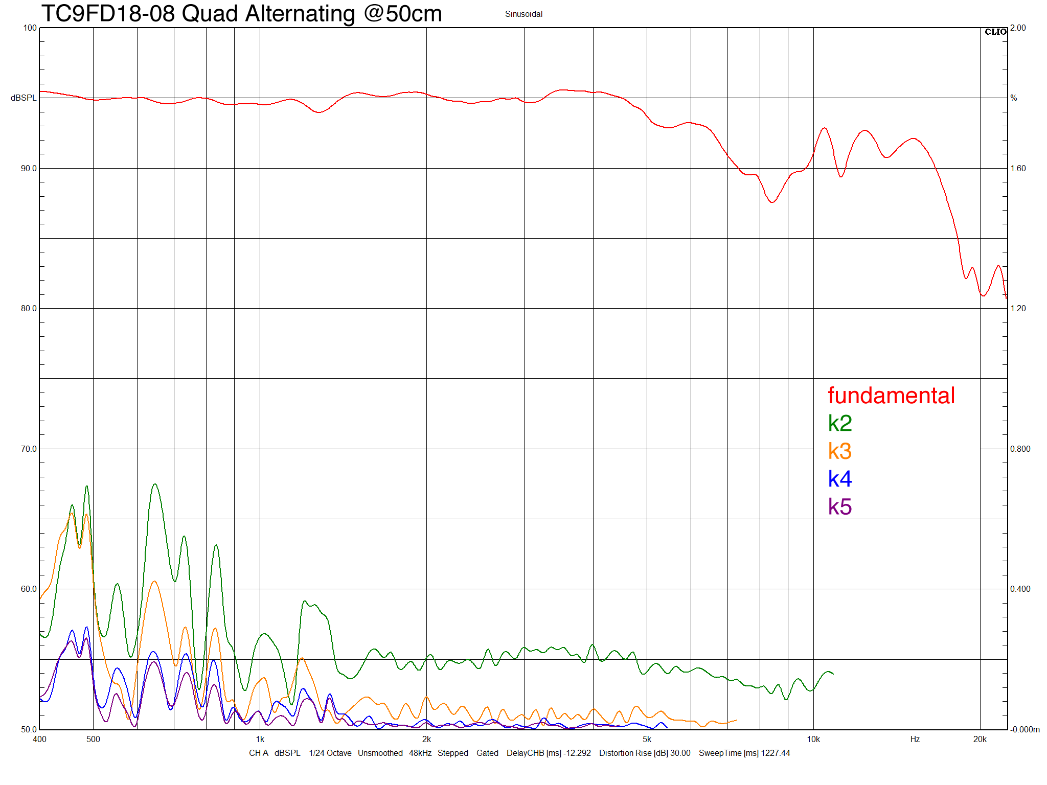

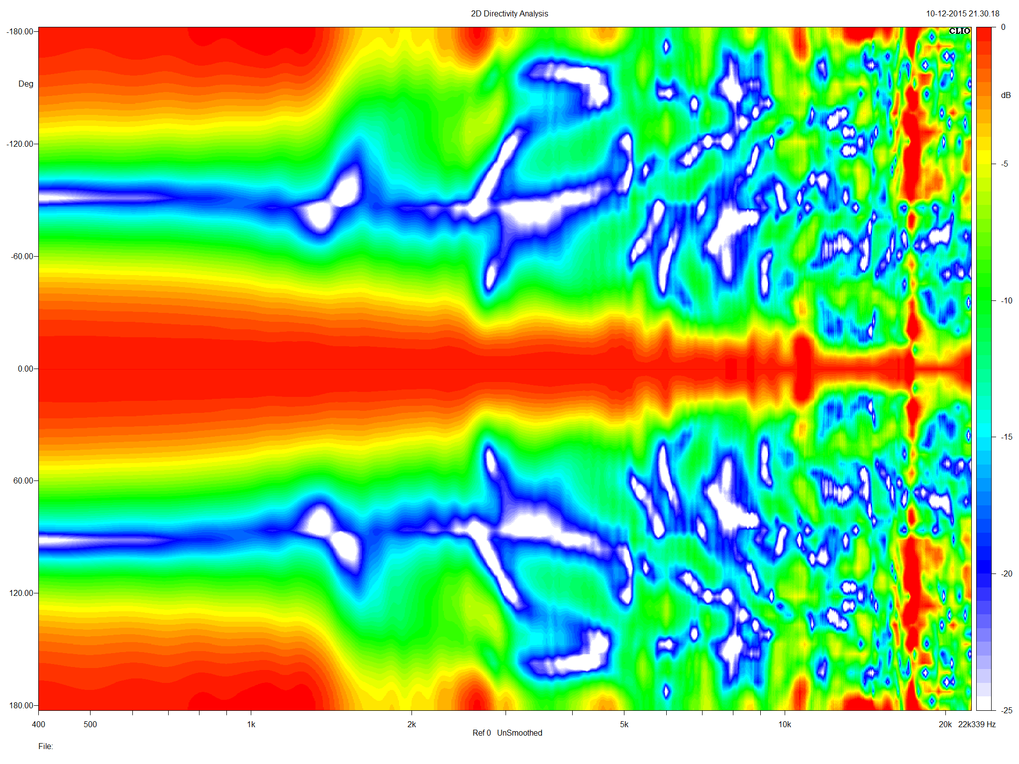

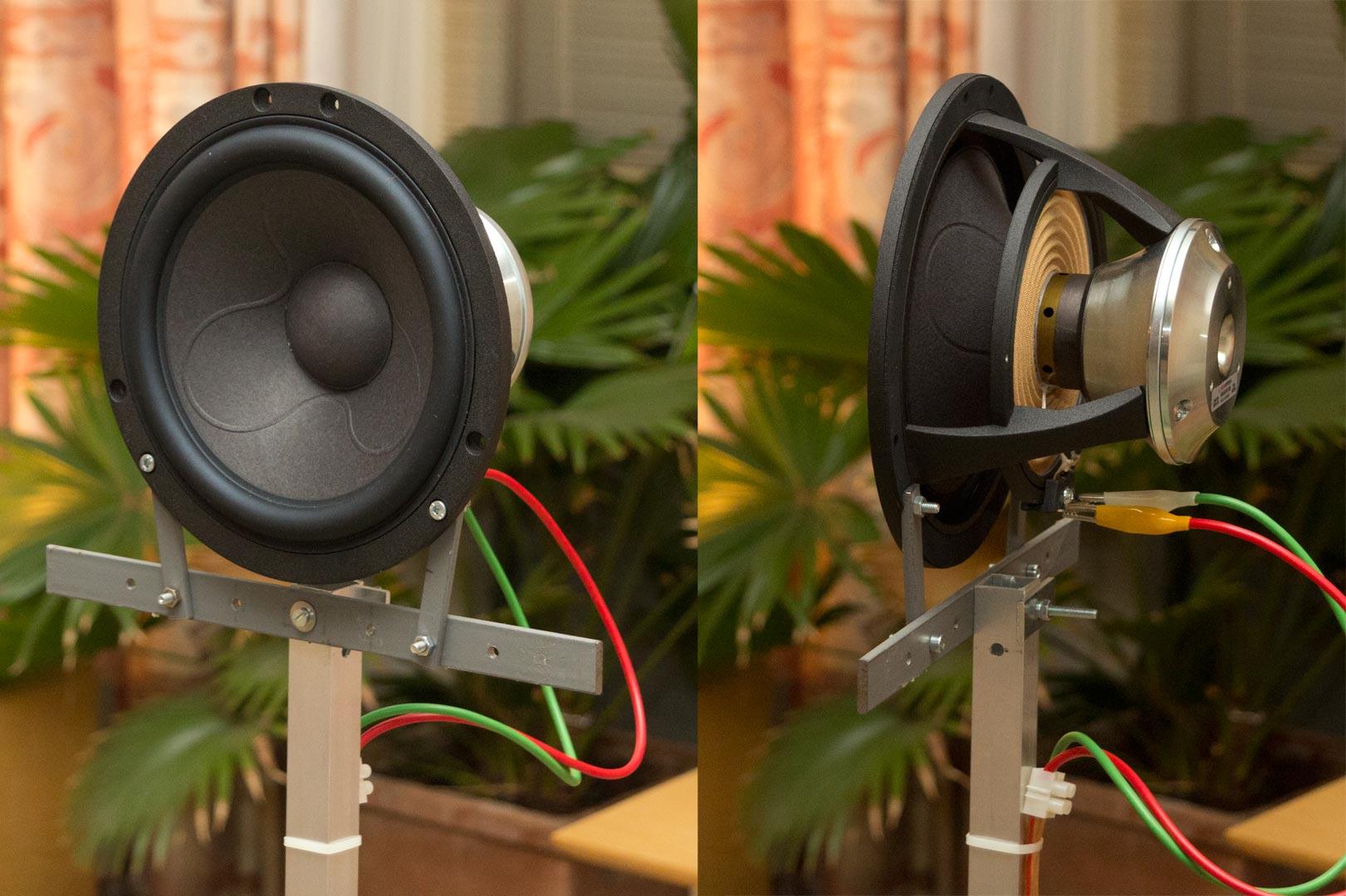

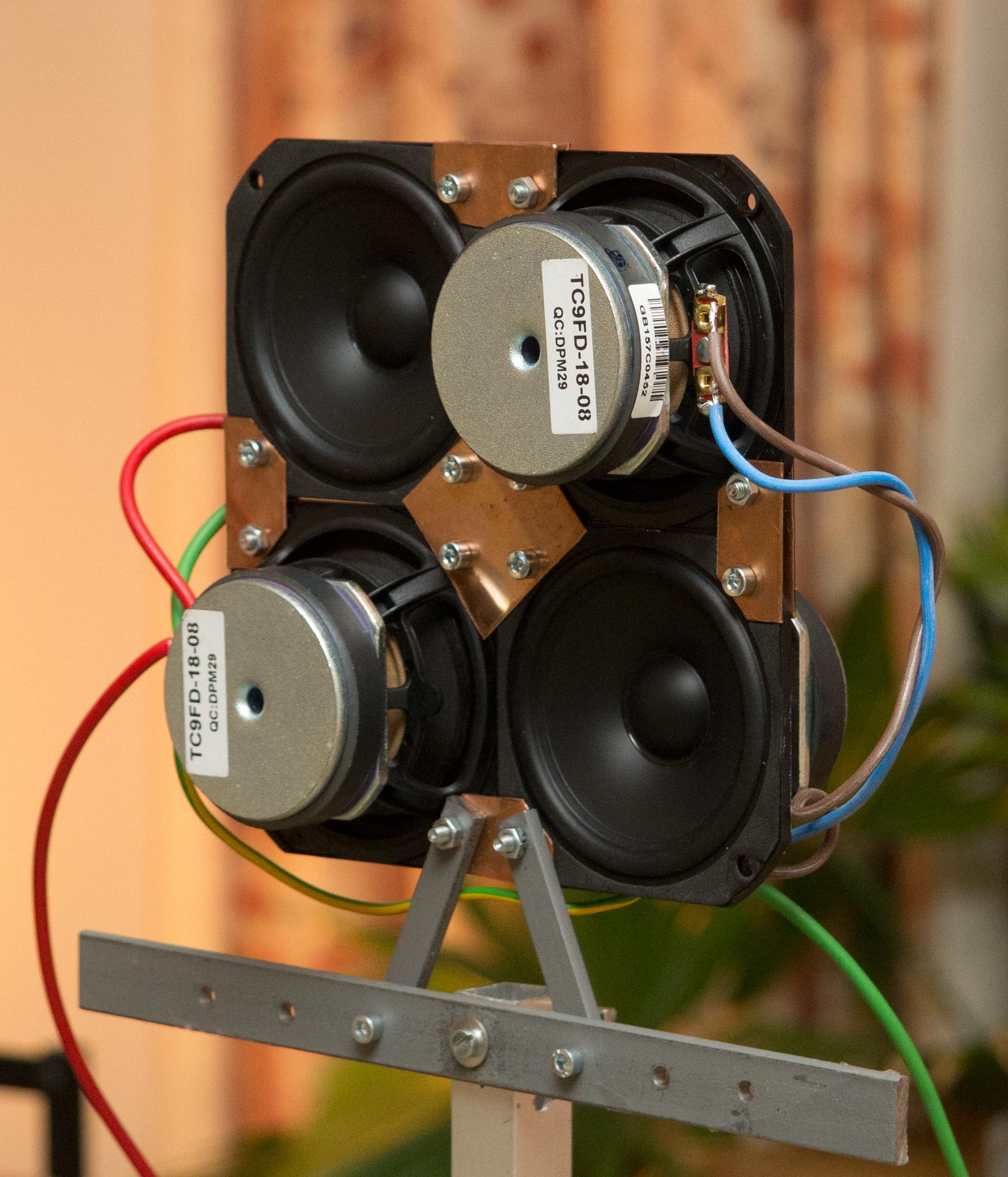

A while ago I made some measurements of naked drivers to evaluate the usability as dipole drivers. The response was eq'd to flat as much as possible without overdoing it with regards to filter use. The reason for this is to see the effect of compensating for the dipole losses on the harmonic distortion.
Four Vifa TC9 in an alternating arrangement:
The normalised directivity measured in 5 degree steps from full front to back (37 measurements) and mirrored for a 360 degree view:
The harmonic distortion measured at 50cm and 95dBSPL:
A Scan-Speak 18WU/8741T00:
And the measurements:
The harmonics are in % with the scale on the right.
As this was measured in room I don't know what the validity is of the harmonics below ~800Hz.
I was pleasantly surprised by the performance of the Vifa and somewhat disappointed by the Scan Speak. The response of the Scan speak is quite irregular and the the open frame with the beautifully shaped magnet does not live up to expectations, the front-back symmetry is not going beyond 1.5kHz.

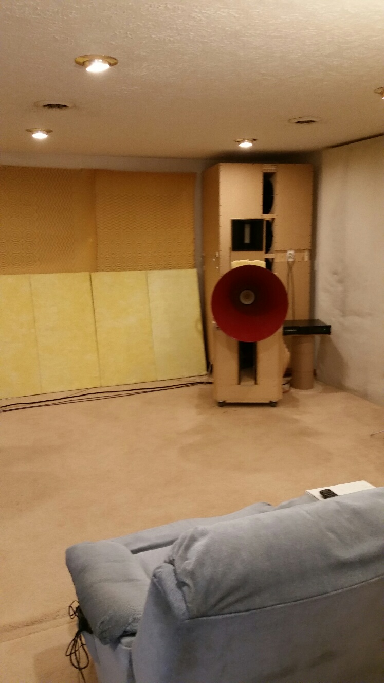

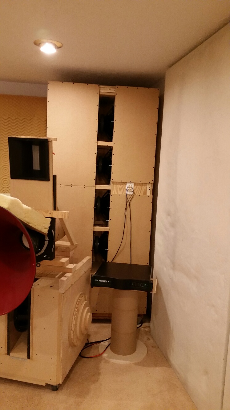

I've never had a problem with any of my fellow DIY'ers having a preference for open baffle bass. To each their own, for sure. It's all a matter of taste. It's only when the soapbox mount takes place with outrageous claims of 25Hz bass from an 18inch wide baffle, and the usually Clayton Shaw type of sales pitch that all boxes sound like resonant boxes, that gets my fur to stand up.
If I had another room, I would look into designing some open baffle bass. If for nothing more than to exhibit the design. One of my best audio buddies is a HUGE open baffle fan. It took many years, but he is now convinced that adding sealed box bass to his system is a wise choice. He has ported box phobia; a really bad case. He used to have crossover phobia too, but since listening to my superb 4-way active system, said phobia has now been quelled.
Attached photo is of right hand side only. It's boxed bass. The left side is infinite baffle bass, it can not bee seen in this picture. There is not even the slightest hint of boxiness/boominess in my sound system. It only plays music that sounds as close to live, as any you might encounter.

@ Gerrit Boers. Nice, hard to beat the reversed drivers for symmetry. Large spider and shaped magnet
of the Scan-Speak are bound to make a mess

I had a similar experience to what you measured with the Scan-Speak mdiwoofer, except using a 5" SB Acoustics Satori midwoofer. It's an excellent driver, but not for dipole use! That sexy neo magnet and basket, which look like they would be perfect for dipole use, don't result in a very usable response overall. Very disappointing!
Apart from having a more open basket and not too large a magnet, I find it challenging to determine whether a home audio driver (e.g. 5"-10" diameter) is a good dipole candidate just by looking at it. I have definitely been unpleasantly surprised on several occasions.
Thanks for sharing your plots by the way.
