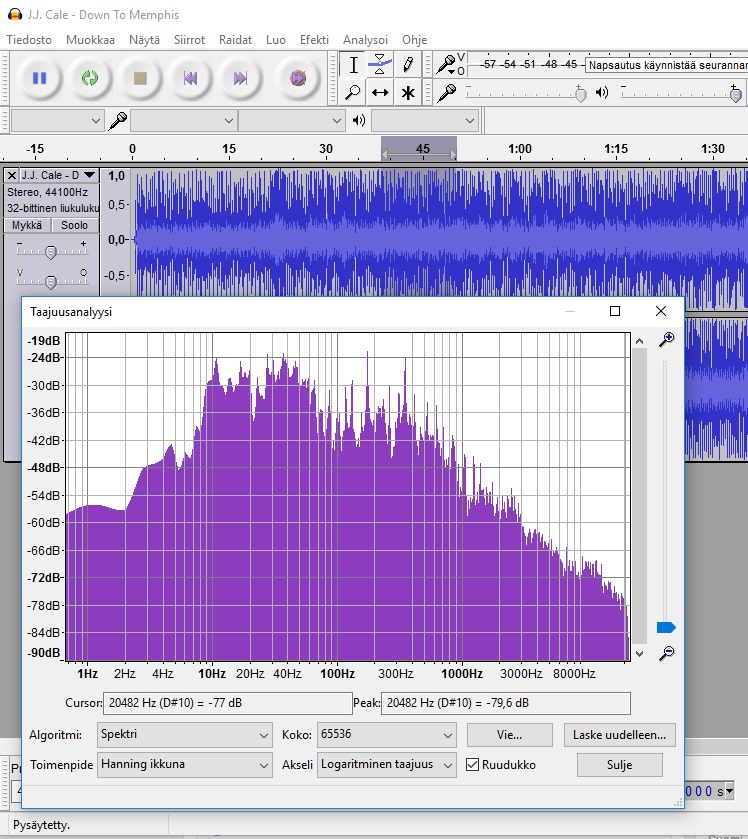

I just listened to Diana Krall's wonderful hifi-recordings, double bass is in big role. Even with modest neighbor-friendly spl bass sounds astonishingly right with just a 10"sealed+dsp, be upper parts dipole or not. Still, my partly dipole speakers sounded much better and natural than 3-way monopoles with similar 10" downfire bass. Of course one could use bigger speakers and nearfield etc. for dipole bass, but why make it so difficult? Room response, positioning is perhaps most important factor if the speaker is capable of going lower than 40Hz.
I understand and identify that certain amount of perfectionism is built-in in diy-hifi, like in mountain-climbing. No offense to Charlie, Nelson et.al. ! Now I try to keep sordino plugged in for a while.
ps. Synthetic bass like from Yello or Laurie Anderson are too easy to reproduce, you don't have reference to how it should sound! And I don't like them either. This is a nice pick for acid test, lots of power below 40Hz, even down to 10 (at least on European CD) - The Road To Escondido (U.S. Version) by J.J. Cale on Spotify

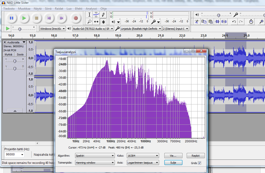

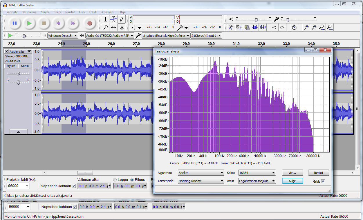

Still, one funny thing about bass. I have digitized many of my old vinyl LPs with EAC and Audacity. Sadly my gear is not high-end and has lots of rumble and cartridge resonance - I use highpass filters to cut it out, like 24dB/oct at 30Hz. But that easily removes the "vinyl sound" too, there is lots of ambience in low bass, even it is artefact for the most! That much low bass would be dangerous for typical BR 2-way hifi-speakers, but in old days most people had closed box speakers and all amplifiers had low-cut (rumble) filters.
Modern digital recording-producing process is often misused and bass below 40Hz is rare species. With speakers capable of sub-40Hz and without reflex will reveal these huge differences in distributed recodings easily.

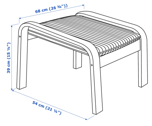

Just adding: I very much appreciate the idea of the sub behind the chair and any further information is very welcome! With the Poang footstool I am just thinking about combining it with an existing - and valuable 🙂 - piece of furniture.
Some of that would be filtered out be the upholstery 🙂80Hz LR4 makes a sub behind the listening position difficult to localise as long as it is low in distortion and spurious noises.
IIRC I used 100Hz linear phase 1st order Neville-Thiele as provided by the Acourate Toolbox for DSP XOver and room correction package. I actually happened to have an IKEA Poang and the 18" 30cm behind the stool was located at chest-height firing 20° or so upwards as simply established by suspending the driver from two adjacent mounting holes with ropes. From that angle our sensitivity to noise etc is lowest, it seems.
