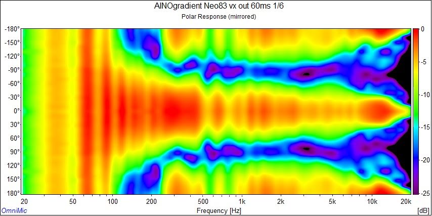

As you see, all share a minimal baffle to achieve constant directivity pattern over a wide frequency range. Achieving a more equal front and rear radiation is not done equally in these designs. Back to back units is done for the LX521 tweeter, the AMTs in the daudio speakers and the planar drivers in the “totem of tone”. Gerrit Boers, author of the totem of tone, showed some measurements with single ad back-to-back units in this thread, and their outcomes were far from the excellent results of the B&G NEO10 planar and his own tweeter (results in his thread) – reason he used these units.
Therefore, there is recent effort in achieving equal radiation and some excellent results, which were probably not possible 30 years ago.

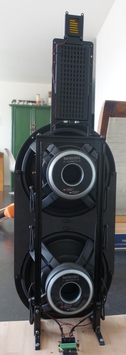

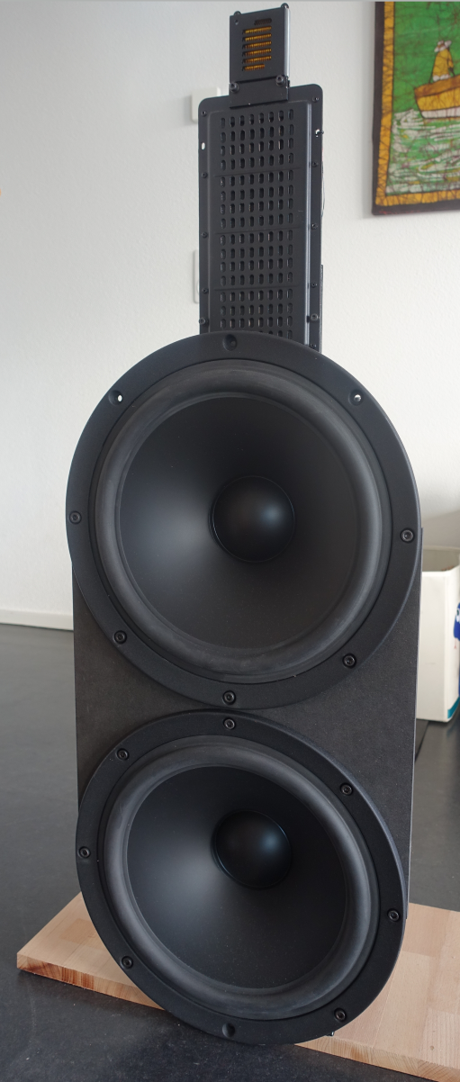

Two pictures of my own attempt. It looks a lot like the totem of tone but with cheaper units and electronics.
best regards, Erik
