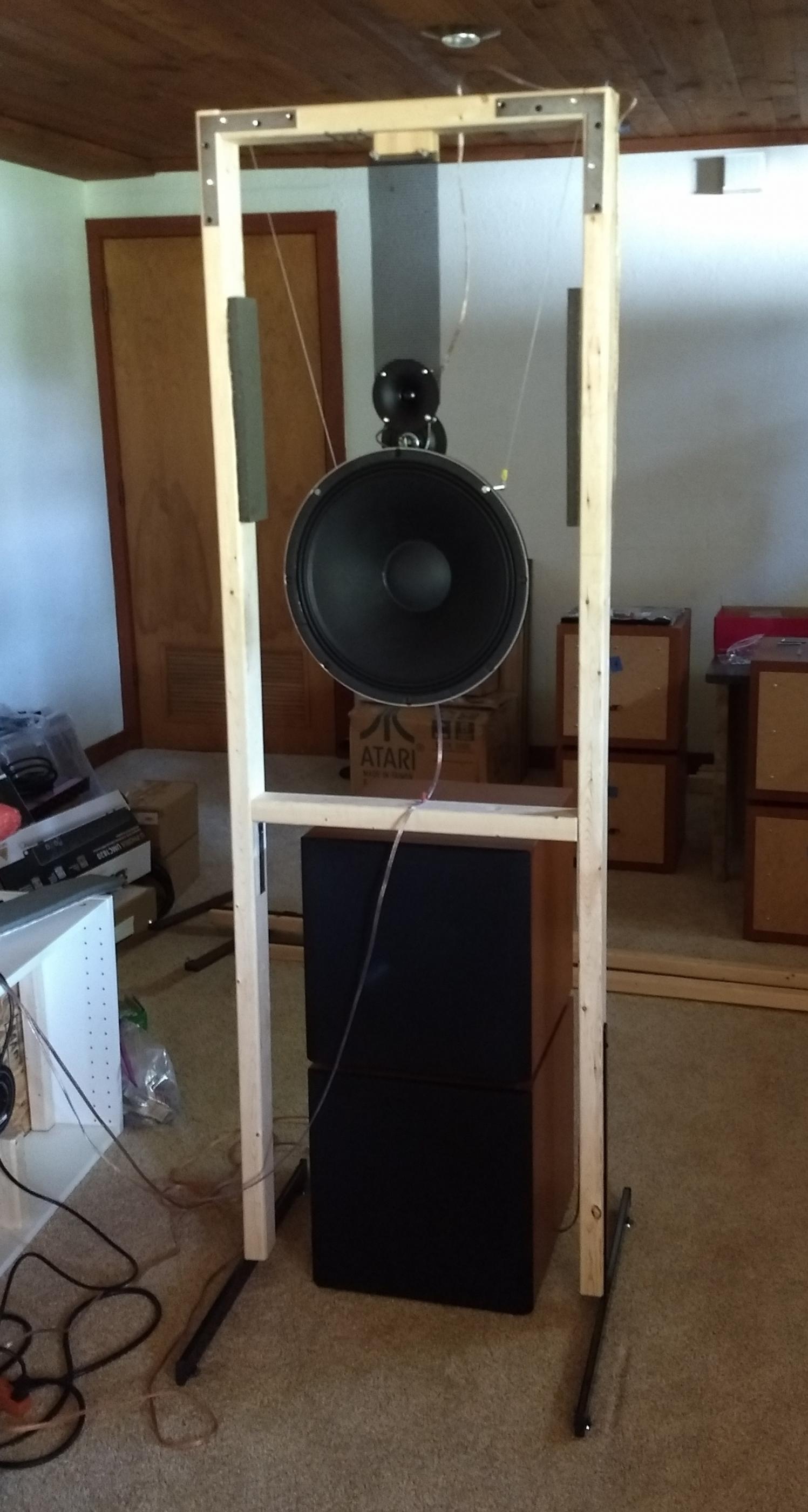

Well, I finally had the time to get the speaker set up, a crossover developed, add a subwoofer (closed box) and do some listening and tweaking. All in mono, which is both more revealing than stereo and easier to build (only one speaker needed).
This particular prototype was in the guise of "can this work?" because it uses a 15" pro audio driver as midwoofer plus a back-to-back 1" dome tweeter as dipole. I would never in a million years suggest to anyone that they try to mate drivers of such disparate sizes, but I thought I would try it anyway. The measurements I had taken on each (FR+distoriton) showed that it just might work. If not, I have a plan B,C, and E waiting in the wings.
So, actually it's not bad! I created a crossover based on on-axis measurements only (although I did know what was going on off axis with each driver individually). The speaker is a nude open baffle, so the drivers are hung from a frame and their acoustic centers aligned physically. I checked this and it was only a couple of millimeters off on the first try, which was pure luck. Also, I knew that both to the front and rear the driver radiation should be the same, or almost exactly the same, for both drivers. I can listen on either side and the tonal balance of the speaker sounds the same. This also means that on other axes, the tonal balance should remain the same or similar. Off-axis listening supports this concept. I can also listen in the null (you hear primarily the room sound, it's not a perfect null but at least -20dB WRT the on-axis SPL) and the tonal balance there is also very similar to what I hear in front of the speaker. This is exactly what I have wanted to create with such a speaker build.
After some extended listening, there are (no surprises) some minor artifacts that creep in on some program material beause the tweeter is crossed too low and the woofer too high. But really they are not all that serious and about what I anticipated. I plan to keep tweaking the crossover to see if this can be improved.
The low end is being handled by two boxed 12" subs of modest design. I used a traditional crossover where each band has the same crossover point. I tried to overlap the subs and the woofer to create a region of cardioid from about 80-160Hz, but this was not anything to write home about so I reverted to crossing both over at 100Hz.
If I decide to keep experimenting with this prorotype I will replace the closed box subs with a pair of H-frame dipole subs that use an Eminence Alpha 15A in the mold of Martin King's investigations on OB, U-, and H-frames. For now I will do some more short listening sessions and continue to play with the crossover in my ACD design program after some feedback from the sessions.

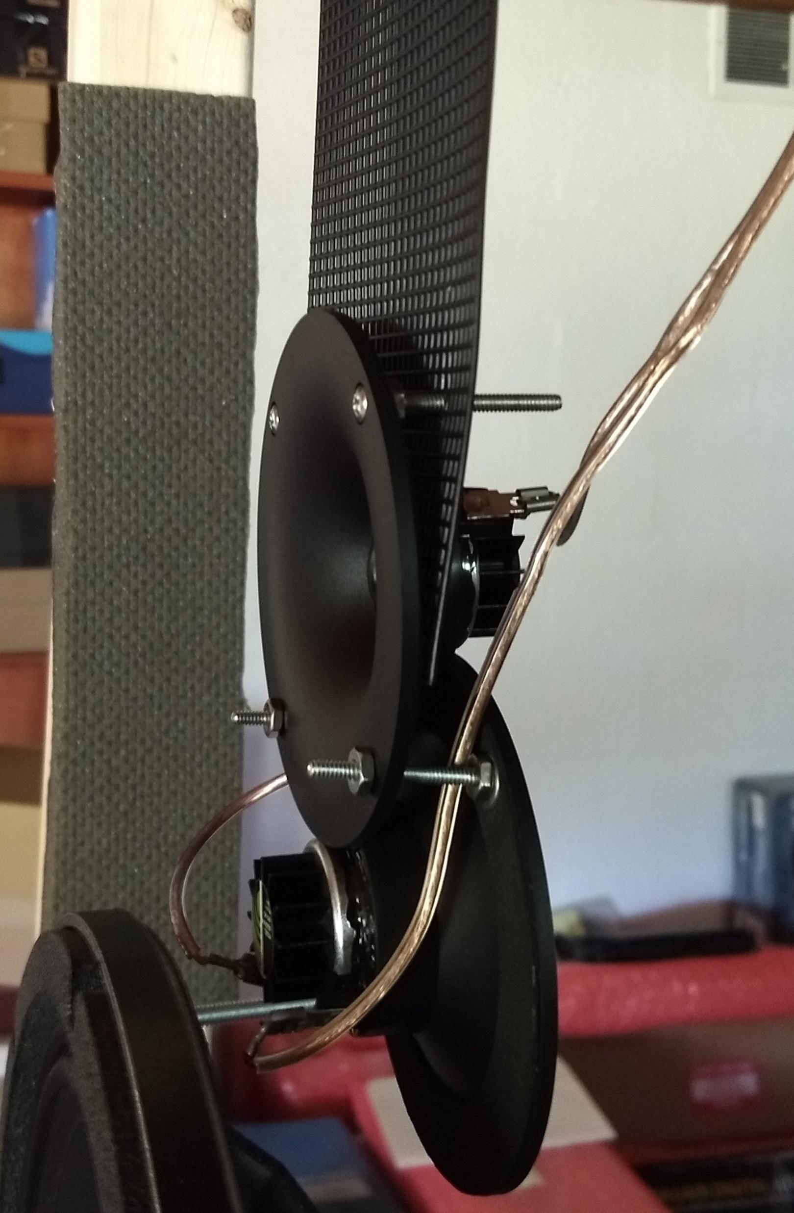

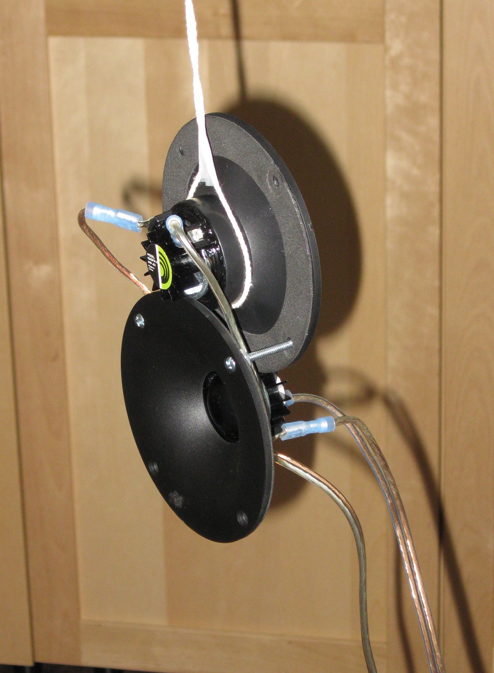

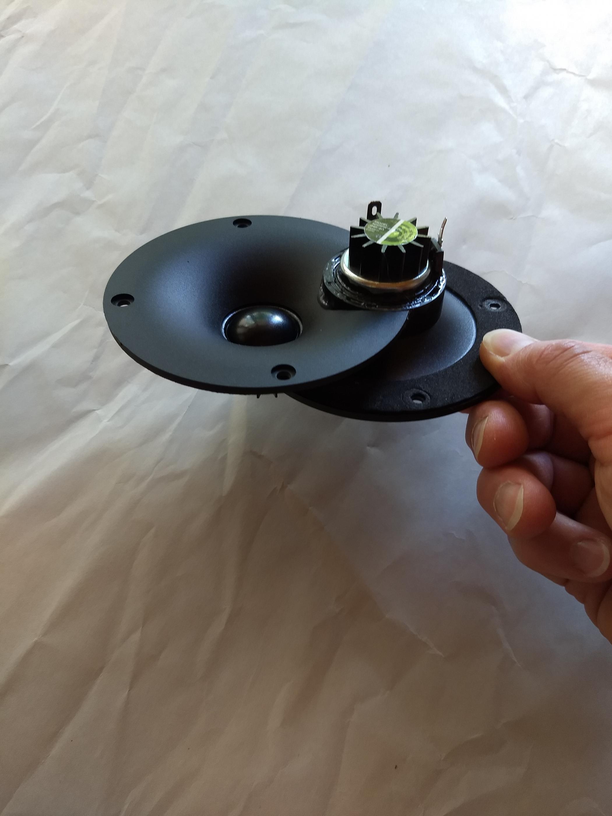

Here are some pics and details of my back-to-back dome dipole tweeter, and the prototype nude dipole system in which it is currently serving. I included one pic of the latest more compact version, but no measurements are available yet.
Note, to figure out what a particular photo is, hover over (but do not open) the thumbnail and look in the bottom browser bar for the filename, which should contain info about angles, whether the mic was in the front or back, etc.
The tweeter is the Dayton ND25FW-4. It's an inexpensive (<$20 each) 1" neo dome in a plastic waveguide. I have attached measurements taken on the dipole pair in the horizontal plane, separately from the front and back, plus a distortion measurement. Distortion is low except for a bump in 2nd order around 1.5k. At higher levels things remain relatively similar, with the average level coming up a bit but staying below 1% until you go below 2kHz. Not bad for $20, eh? Keep in mind that the down-sloping response is flattened by bringing down the lower portion of the response to match the middle part, and the distortion should be quite low in actual use.
As I explained in the last post, I found that I could position these back to back relatively close together with the waveguides overlapped just by using long machine screws thru the mounting holes. When assembled this way, the distance in-between the waveguide mounting flanges is about 25mm, and the dome is recessed into the guide so the two acoustic centers are probably closely aligned in the front-to-back orientation. Not sure if this is critical or not, however, I initially had them spaced about 35mm apart and the dipole pattern was not as good.
In order to bring the two waveguides even closer together, material that interferes must be removed. The tweeter itself it mounted into the back of the waveguide in a short cylindrical extrusion and this bumps against the rear surface of the waveguide of the mating tweeter unit. I used a hole saw of about the same diameter to carefully cut out the round interfering section of each waveguide. I was then able to mount the two waveguides with the cylindrical mounting extrusions sticking thru the other waveguide and butting up against each other. This brings the back-to-back separation of the waveguides down to about 16mm and also brings the up-and-down offset of the two domes down from about 62mm to about 42mm. Until I measure the responses I won't know whether the fact that there is now a partial cylinder sticking thru each waveguide will or will not create problems with the responses.
Please see the attached pic of this new and more compact arrangement.
Also, I have attached a couple of pics showing the current prototype system, and how I mount the back-to-back dipole. Keep in mind that I just threw this together from some cheap 2x3 lumber... As I have mentioned elsewhere, it's difficult to freely hang the tweeters in free space and connect wires to them because they weigh very little. My solution is to use this plastic mesh - it's intended for embroidery work. The hole spacing is just about right for the mounting holes of the tweeter, and the mesh is semi-rigid, or enough so that it hangs without much twist, etc. It does not seem to affect the performance, at least from the measurements I have made on it, as mounted. The woofer should really be lower, e.g. just above the crossbar that is above the subwoofers, and the tweeters should hover just above the woofer. This means I can lower the top crossbar by about 10" (it's 6 feet tall now) and still accommodate everything, but the tweeter axis is a bit higher than usual. On the back side the tweeter is actually below the level of the woofer flange. Since its all acoustically aligned and there is lots of radiating surface from the large 15" woofer this doesn't seem to be a problem. It might even sound better from the rear than the front. It's a strange feeling to be looking at a woofer magnet but the sound is great... That shows that acoustically front = rear, which is a goal of this dipole system.

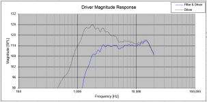

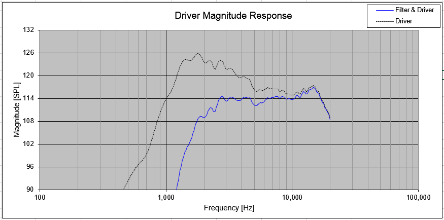

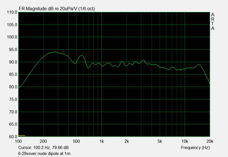

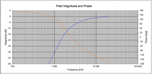

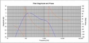

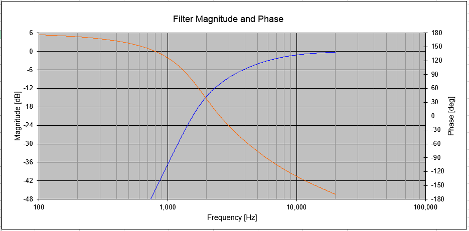

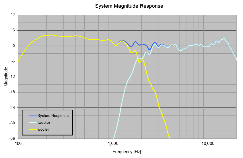

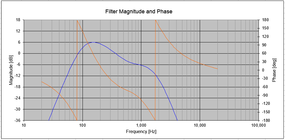

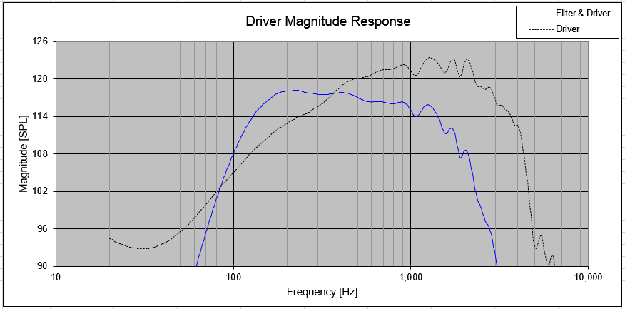

I did 50Hz resolution measurements on the drivers previously, which I think I posted earlier. I also took some quick multi-axis measurements only in the front as mounted in the current "frame" to confirm that the frame does not impact the response off axis. Those seemed to look fine.
I used only on-axis measurement when developing the crossover. I also did an interference type measurement to check the acoustic center offset. At this point I have not done complete measurements of the "system". My primarily goal was to get the system up and running and do some listening to see if it could work.
I have attached plots of the drivers (including as-measured and with the crossover filters active), the response of the filters, plus the system response for the current crossover from my ACD crossover development software.

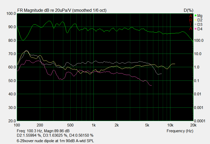

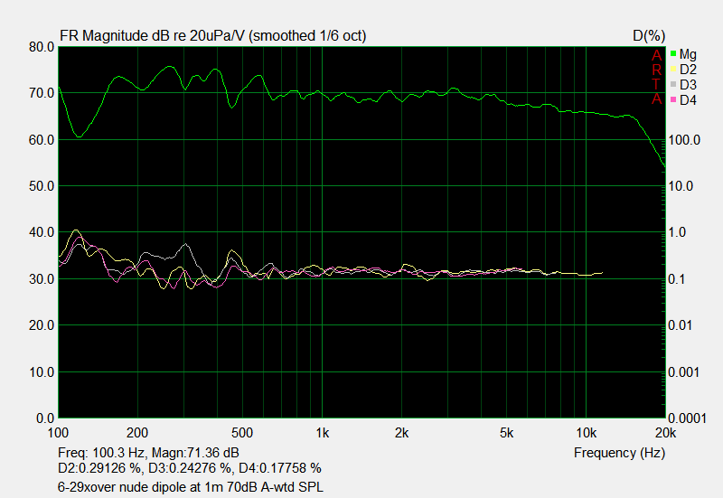

Thanks for measurements. Looks quite good.
Plots 2, 4, and 5 are centre-line, near-field, no EQ, with 1/6 smoothing????*
Nice if you could post the harmonic distortion plots too; tested at ordinary uncalibrated listening level is as meaningful to see as pushing for the peak loudness or bothering with calibration.
B.
* if I made the rules, I'd ask speaker forums to standardize on 1/12 for FRs unless other smoothing was more revealing.

The data in those plots was taken outdoors with the mic elevation putting the capsule about halfway between center of woofer and tweeter. The mic was about about 1.5-2m away from the drivers. The resolution was around 100Hz IIRC. I checked and found I used 1/12th octave smoothing. You can see this at the top of some of the earlier response plots (the text at the top).Plots 2, 4, and 5 are centre-line, near-field, no EQ, with 1/6 smoothing????
The dashed lines are the raw (as recorded) data, and the solid lines is the same driver but with its crossover filters active.

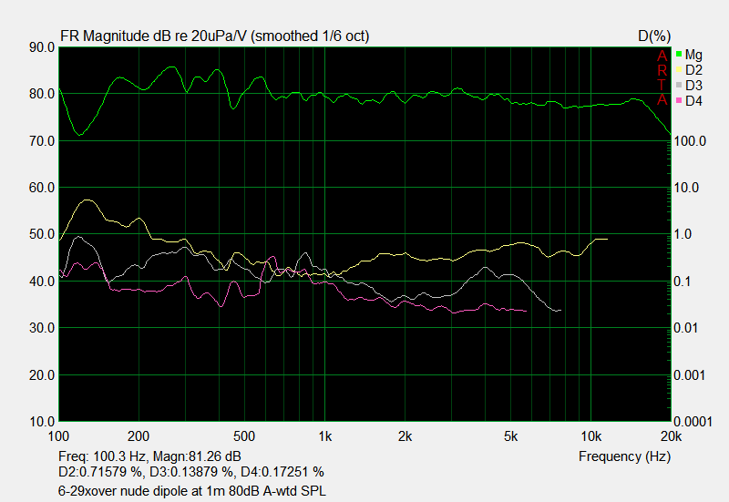

Nice to see the harmonic distortion plots too; ordinary uncalibrated listening level is as meaningful to see as pushing for the peak loudness.
B.
If I measure the system response again outdoors I will try to remember to record SPL and then take distortion measurements at a couple of different levels. You are correct - that would be useful info.
Thanks for efforts to explain. Yes, out of doors makes 1/12 look as smooth as 1/6 indoors.

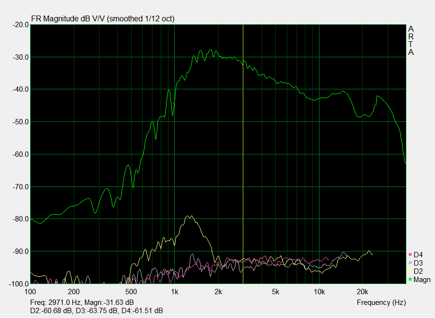

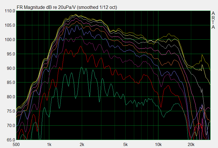

Thanks to Ben's gentle prodding I decided to just give it the good ol college try and see if I could take some indoor measurements. The system is set up in my basement in a long room and more or less in the middle of the room. The ceiling is only 7' tall, so I was not really expecting to be able to get any useful data because (I thought) I would need to shorten the gating window a lot. Well I was very surprised to see that I could get a resolution of 150Hz or so. Whaaaa? My guess is that the dipole null means the speaker is just not illuminating the ceiling, floor, or walls perpendicular to the speaker. We are left with reflections from far away walls only. I think. Anyway, the impulse did not show strong signs of a reflection up until where I gated it off so mark me down as pleasantly surprised.
With that preliminary check out of the way, I set up trying to calibrate the SPL level. I have a calibrated mic, but it passes through a pro audio DA/AD box that has gain for both the mic and the output level via knobs with no useful markings. Luckily I have an SPL meter, so I did an A-weighted reading at the mic, which I positioned at 1m exactly from the woofer frame in front of the speaker at about halfway in between the woofer and tweeter center axes. After much fiddling about I managed to figure out the levels, so what you see is the real 1m SPL. Man, 90dB@1m is rather louder than I realized!
So, attached I have attachments of the frequency response and distortion at 70dB, 80dB, and 90dB at 1m levels.

The system used:
Behringer ECM8000 calibrated by Spectrum Labs
Focusrite Scarlett Solo interface
computer doing DSP, signal routed in/out via ALC892 codec running at 96k/32bits
Nice HD%, clocking in around -40 dB (1%). Pretty good for cones (ESL can come in around -50 dB, ahem, ahem).
But you might already be bumping against the lower limits of your measuring system and the real figures are even lower.
But apropos the earlier dust-up about dipole rear waves sneaking around and annihilating the front wave - at least in textbook illustrations - how to evaluate?
First, there is your own modelling based on the size of the baffle and the arithmetic expectations given wave lengths.
Second might be altering the space behind an OB by moving further from wall or some serious absorbent back there, angling the panel, relation to side walls, etc. and seeing the consequences in the FR.
While nobody has a straw-man image that all the theoretical cancellation would occur, it would be interesting to see how much or how little is cancelled as you go down the freq scale into the relevant range.... and how much LT is needed.
B.
B.
