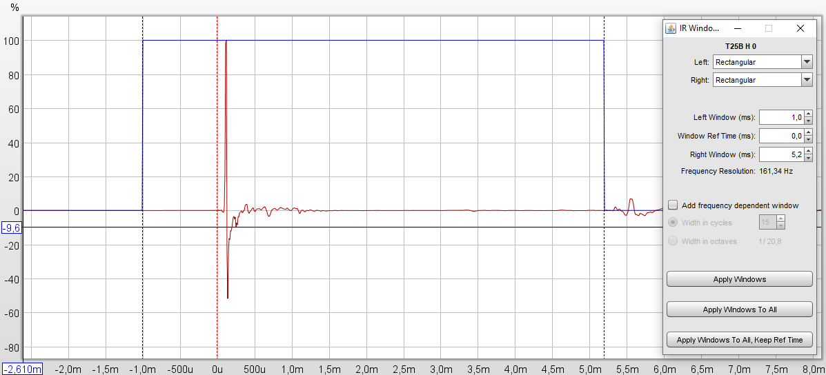

I can see a very clear reflection at about 3ms in that graph. that seems typical for an in room measurement. its probably either the floor or the back wall. Gate before the reflection. You can trust the data above probably ~400hz
you might also take a number of measurements at slightly different angles and then gate them all, then average. will give you a clearer idea of what is happening.
EDIT: maybe post the SPL graph of the truncated measurement, looks like there is a MASSIVE boost at 2-3 k and a loss in the top octave. this is pretty likely to explain why you arn't liking the sound on anything expect jazz

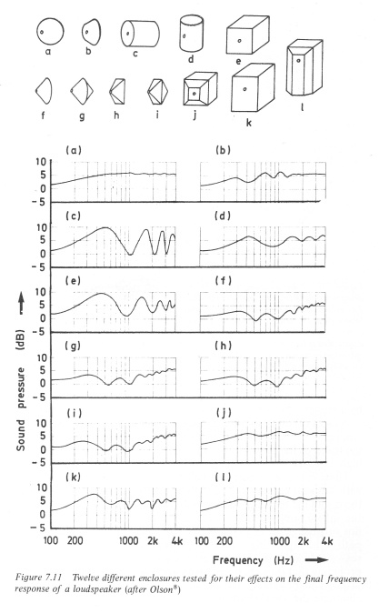

We were also talking about mechanical/acoustic design. That shape looks quite bad. Close to maximum diffraction effects due to sharp edge and constant distance from the center of tweeter to edge on the top. Everything cannot be fixed with crossover though decent sound balance is possible. Dependence on listening distance, direction and environment still remains in addition to possibly fragmented sound stage.
The gating as shown in post #71 is still not right. You are missing a big part of the initial pulse response this way. Small wonder you are missing some of the high frequencies on your graph. And you shouldn't go further than 3 ms after the pulse.

For the purpose of this discussion, the gate time starts when the direct sound first arrives, and is ended when the reflection first arrives.Then I still don't understand why I have to substract the speaker-mic distance.. I'm trying to filter out the first reflections. So then the gate must be set right befor the reflections arrive?

charles, I dont think you can see the left gate? its offscreen. so it should have everything I think?
I created the picture below to show correct placement of the impulse on timeline. This way whole impulse is on the right from T=0, this is important to get the phase right, which is important when doing dual chanel measurement for crossover design. It also shows correct setting of the gate, and the first strong reflection is clearly identifiable.
Originaly the impulse is placed in T= ~3ms when one measures from 1m. In my case, I shifted the impulse by ~2.9ms to the left, to compensate travel delay and phase wraps in the graphs, which makes work on phase tracking easier.
Yes, it looks good but the acoustic results now seem a lot worse than I expected. I will change the round top for a square top as I already showed to get less equalbdistances from the tweeter to the edge.
The edge is chamfered, only very little, about 1 cm. I was planning on chamfering it 2,5 cm but the woodwork shop I got my wood done didn't have a 2,5 cm radius mill. When I'm building the next pair I will do whatever it takes to get the 2,5 cm chamfering. I'll contact a friend of mine who is a woodworker. He has a 2,5 cm mill for shure. The square top and larger chamfering shouldbdefinately improve FR.

Yes, I like the shape and the constant distance to the edge. A roundover would be prudent, and better than using the squared shape.I'd be tempted to attack them with a flap disk on an angle grinder ( using a templet ) then making a wooden block with the right radius to use with sandpaper to finish them. This is how I got the radius on my box in a box speakers. It'd save you making another pair.
I'd think a square top with bigger chamfering would make for a more even FR?

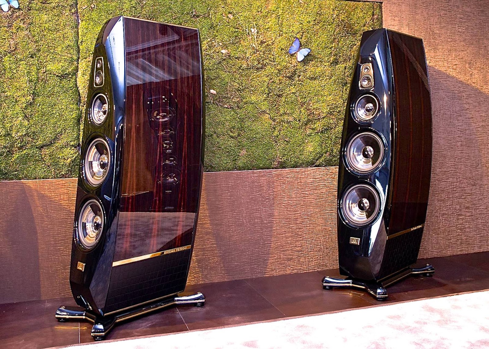

That way the Baffle would actually have the same shape as the design like that of a Tidal or Rockport speaker. Except because those boxes are rectangular and mine gets narrower to the top, the corners are cut off. But the baffle in effect has the same shape. And I think baffles of the shape like that of a Tidal or Rockport are the best designs. Which I have seen reviewed in a study about baffle design and resulting FR.

Only if you don't fix the diffraction with a roundover. Using the square shape instead can give problems on other axes.I'd think a square top with bigger chamfering would make for a more even FR?
I would round over/chamfer the edges on the new square box, with a much bigger radius than on the current enclosures. Her is the study about enclosure shape and resulting frequency response. With the square top and chamfered edges my speaker would be the closest to the "L". Which has one of the smoothest frequency responses.
