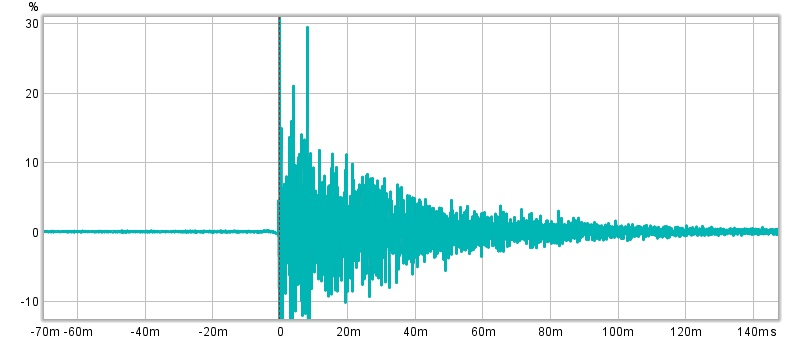

Well I'll be honest with you. I was quite lazy when doing measurments. I wasn't really trying to do them anechoically. Now I did. With a blanked around the speaker. As a sort anechoic tunnel to the microphone.
you should do a bit more reading on how to get your measurements... should be gating the the measurement in the impulse window based on when you see the first reflection from the roof/floor/wall. this is an anechoic measurement.
your blanket is likely reflecting some proportion of sound back towards the microphone ruining the measurement!!!

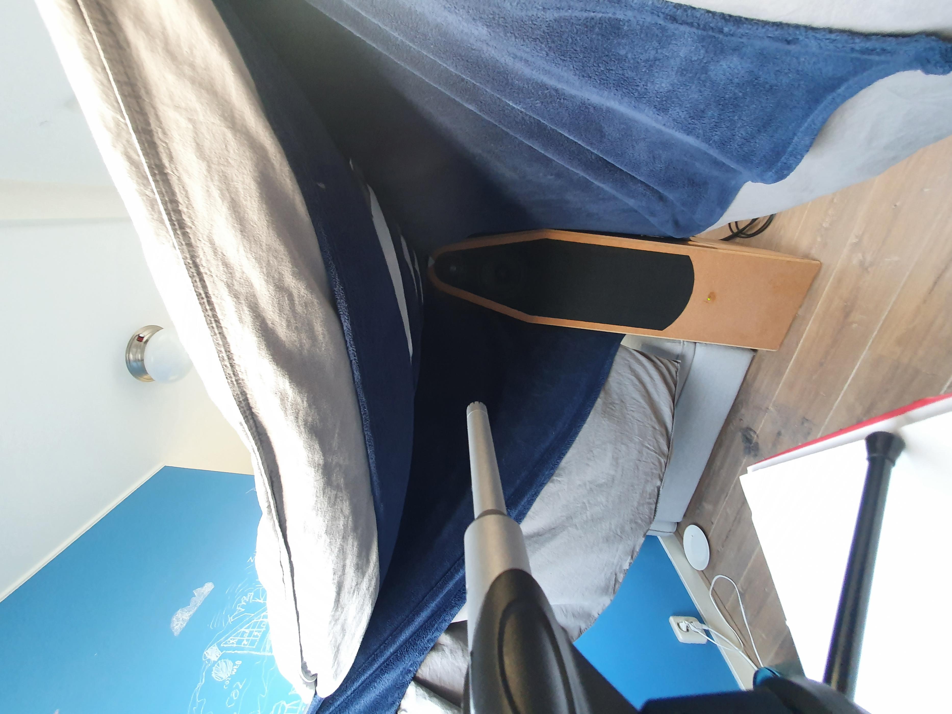

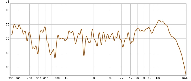

So I tried it with the blanket anyway. This is what the setup looks like. And the measured response so far. I've put a second blanket on the inside which is a more wooly blanket, I thought that would be effective against further minimizing the higher frequency reflections of the blanket.
Aren't there drawbacks to gated measurments? And my room is super small so the time until the first reflection will be very short. I will look in to how to do gated measurments.

Yes gated measurements have a reduced frequency resolution. 5 ms gate means 200 Hz resolution. That is acceptable when checking for obvious tonal errors > 1000 Hz.
I see your microphone is mounted near a box. The box will reflect sound towards the microphone. Try using a full size microphone stand.
