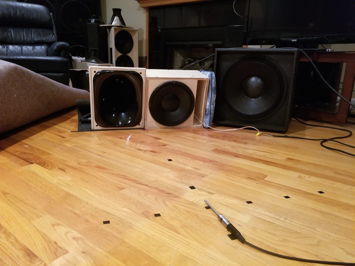

Try making a measurement with the speaker lying on its side on the floor.
Put the mic about 1m away on the floor, where it's centered between tweeter and mid.
Block up the back of the speaker to tilt it where it aims perpendicularly to the mic.
Here's a pict to give you an idea. Was working on a modular PA build, and it was too cold to measure outside.
Put blankets on nearby objects that might reflect into the mic, but get them away from the speaker (both objects and blankets).

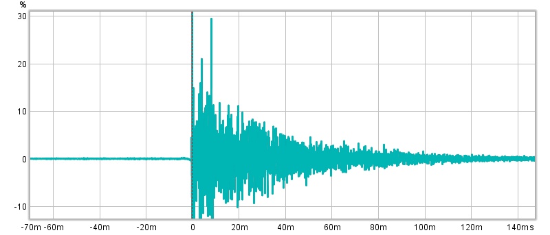

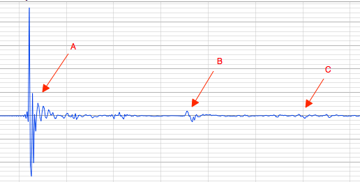

I'm trying to understand what I have to do now. I want to setup REW to do a gated measurment. But then I've got to determine the time window to the first reflection. The impuls graph should look something like the first picture. But I have this huge never ending smear. What am I doing wrong?
That is not good because side position changes diffraction behavior. Significance depends on radiators and shape of enclosure. Another disadvantage is that off-axis/directivity measurements are not possible so it's driving as blind as with other design methods with on-axis response only.
Could be okay for quick QC measurement with long time window, but not a change for design phase.

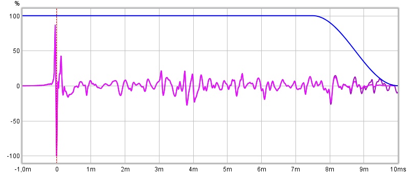

I know there is a dB and %. I've got it on the % graph, just like they do on the MiniDSP website. I've also scaled it down, but it still shows this never ending mess.
Could it be that my room is just too small to even make gated measurments because the reflections come so early? In that case I'm screwed.

I've found it works much better than expected for making a decent on-axis response. Probably works considerably better for basic tuning, than the majority of in-room gated measurements made at listening position.
I know this through comparisons of this technique to outdoor measurements.
Outdoors, I use both a spinorama and multiple mics on a rotating boom, off a fairly open deck. So i do have an experienced basis for comparison.
I learned this speaker-on-floor, mic-on-floor technique, from an accomplished transducer designer...it's not something i made up....

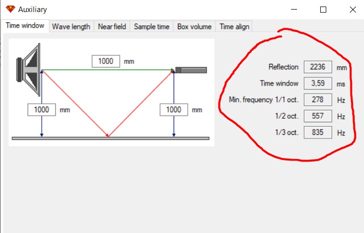

1 millisecond is about a 30cm in distance, 3 millisecond makes a meter. The gated signal must be shorter than any reflected sound paths from the room boundaries or other objects in the room. Measure without the blankets/tunnel, one meter away and gate the measurement before first reflection which should be easier to spot now that you don't have reflections from the blanket. Around ~2-4ms after the highest peak could be reasonable estimate where the first reflection comes in. You can measure /calculate using simple trigonometry what is the path length from nearest boundary to the mic. VituixCad has an auxiliary tool for this. There is also good documentation how to do measurements at home, with REW, in the VituixCAD documentation. If might feel overwhelming at first but thats about the easiest way to get proper results.

I measured everything and the first reflection is about 230 cm distance (from speaker to reflection point to microphone) so it should be at about 6,7 ms. But it shows nothing on the graph. Probably because the graph for some reason looks like a fricking mountainscap. And that's what I'm not getting. WHY THE F DOES THE IMPULS GRAPH LOOK LIKE A FRICKING MOUNTAINSCAPE WHILE IT'S SUPPOSED TO BE FLAT.
Anyways, even though it's not visible on the graph, I'll just gate at 6 ms. Then by the way, how close to the wall do they have to be doing the measurments on the MiniDSP website if it's only 4,4 ms and already 6,7 ms in my room. Weird, probably a tiny office room.
