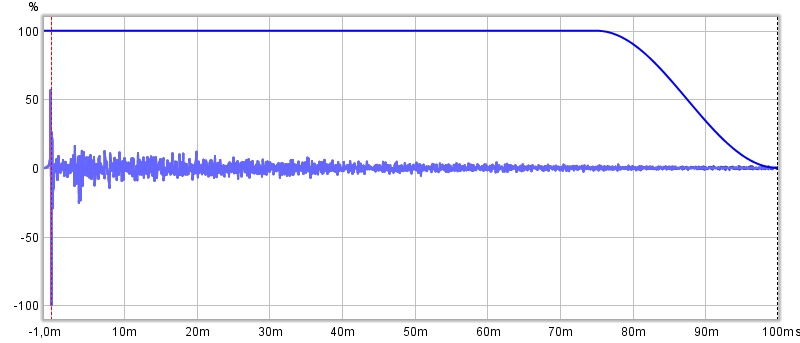

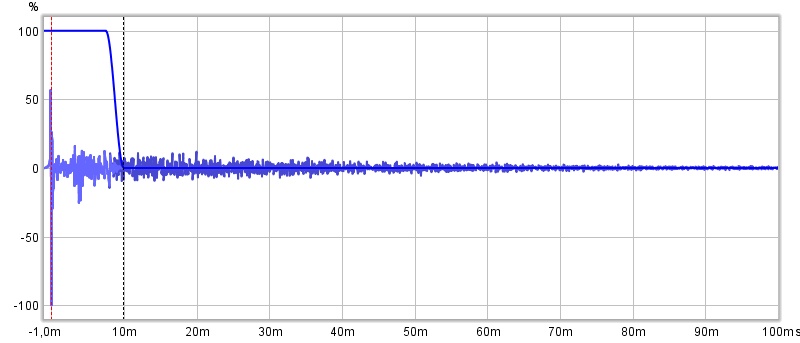

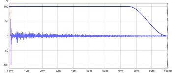

The gating truncates the impulse response where the the room starts to ruin the response. But you have to APPLY it. Your impulse response is definitley not gated at all.
Edit: Just saw your response. There must be a function where you can set another cursor or line and subsequently showing only the part within those two marks.

Sure, but measuring at final listening distance indoors for crossover design is impossible probably in 99.9 % cases. That is usually called as "in-room response".
So gated is way to go, but of course travel distance of reflections must be maximized to enable as long time window as possible.

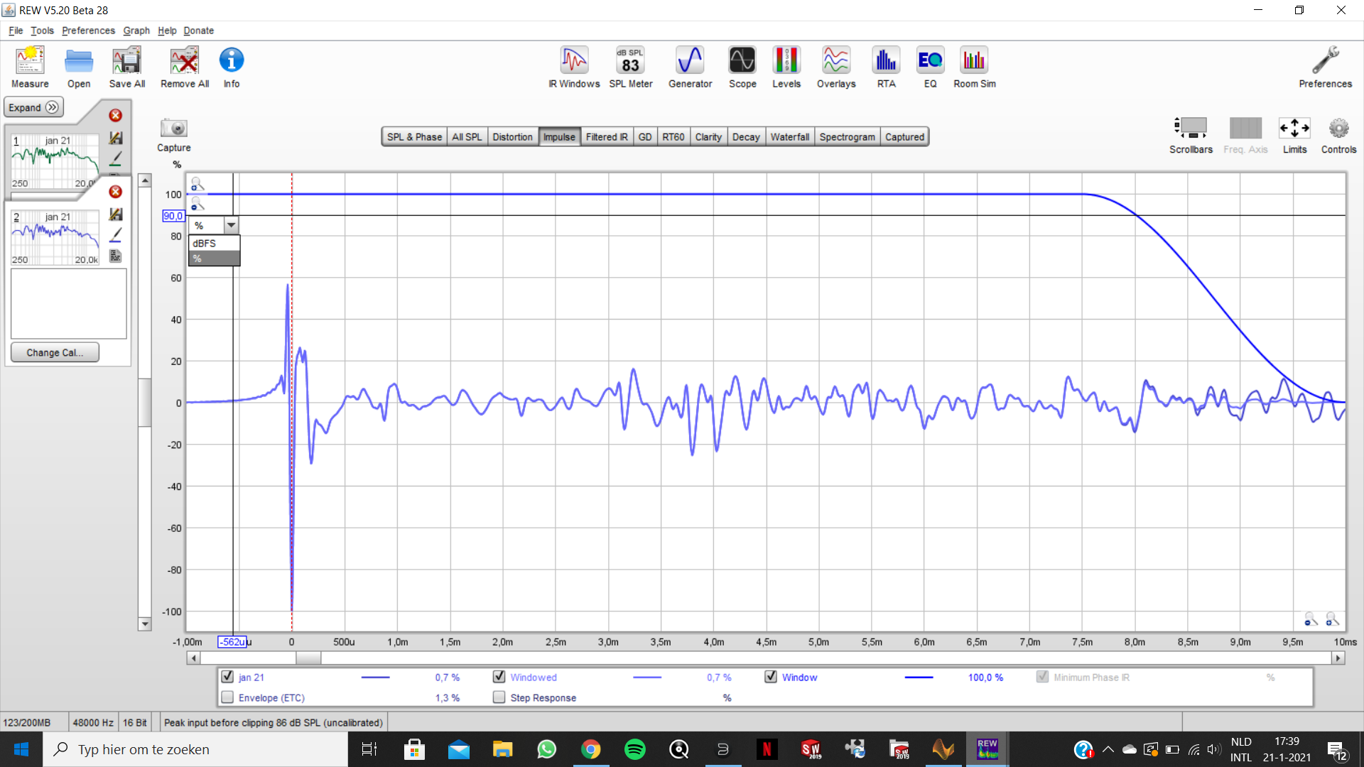

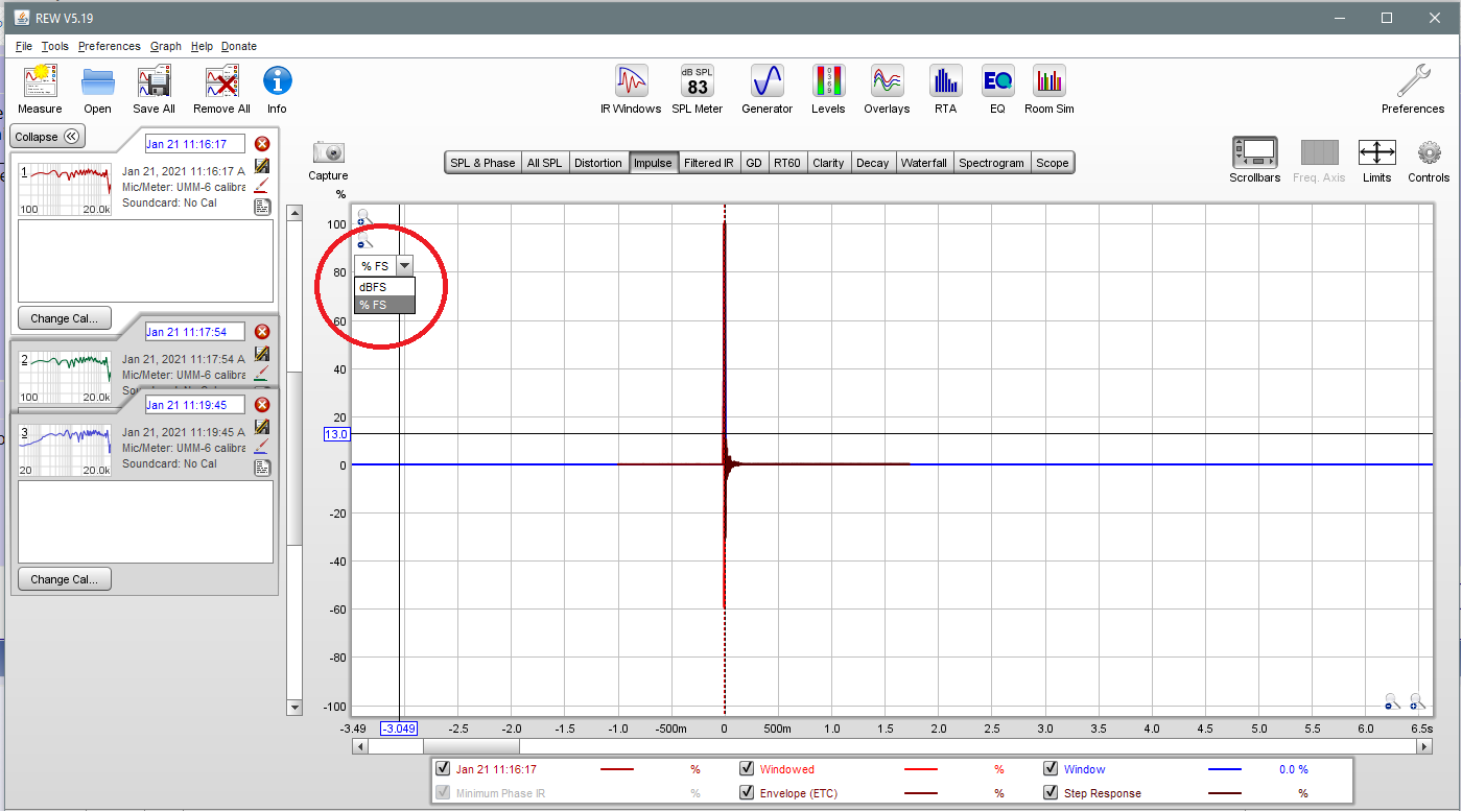

In REW, move your curser anywhere into the Impulse window. You will see a drop down box appear in the left upper corner. Select "% FS". See pic below.

Why and what do you mean exactly? Distance of first reflection - distance from speaker to mic?
What does the gating doe exactly? Because the graphs look very weird.
"clean" direct signal is the same as the dirty reflected one, they both depart from the speaker at the same time, it is the same signal front. If your mic is one meter away, the direct signal arrives to the mic in about 3 milliseconds. Now the part of the signal that is going to cause the reflection has already travelled the same one meter, or three milliseconds, and is that much closer. So, subtract the speaker<>mic distance from the reflective path lenght. Hope it helps. You should spend some time on this to get your speaker right. It won't happen in one evening 🙂 Don't get frustrated, you can figure it out!
Then I still don't understand why I have to substract the speaker-mic distance.. I'm trying to filter out the first reflections. So then the gate must be set right befor the reflections arrive?

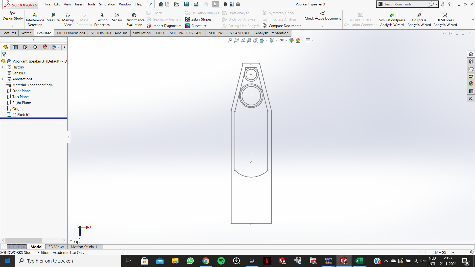

Even though the measurments I made I think weren't accurate at all. They different settings/measurment setups at least gave a similair impression that the treble was quite jagged. I will building a new pair of enclosures which will be finished (veneered and polished by Bush, dutch company who renovate, maintain and also refinish Riva's). I immediately changed the round top of the enclosure for a square top to hopefully achieve a flatter natural FR.
