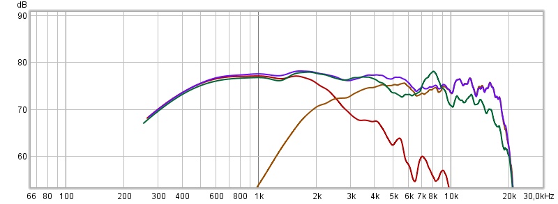

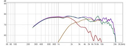

Purple is an on axis measurment. Green is 30 degrees off axis. So I seem to have the 8 kHz bump off axis. What do I do about this?

I measured the off axis response of the tweeter on it's own. The spike also shows up there. So that's just the off-axis response of the tweeter. Nothing I can do about it now without changing the on axis response.
You know the round top of the speakers? The radius of that is 8,3 cm. 34300 / 8,3 * 2 (1/2 wavelength) = 8265 Hz. So it's probably the round top that is amplifying and causing that spike. So it's a good thing the new pair will have an angular top. Then this spike shouldn't show up.

8KHz = 4.2cm wavelength. At that distance from the tweeter centre, it's unlikely to be a surface / edge induced artefact (about the only thing there will be mounting screws and unless these protrude significantly... or your tweeter has a 8.4cm diameter faceplate and you have not flushmounted your tweeter or have a large gap in the countersink...)
If we were going with soft dome breakup (can't remember what membrane your tweeter has) then you usually see this in the 6KHz and up region. Problem though is this should not be axis dependent.
Thus it leads me back to some baffle / edge / faceplate induced bump and dip.
Oh yeah, miscalculation. Then it's 2 wavelengths at ~8 kHz.
The it's a beryllium tweeter so it shouldn't show any peaks because of dome breakup. But the tweeter right now isn't mounted flush. But it sticks out only ~1 mm. Would that be enough to cause a problem? If so this will be fixed with the new cabinets since they will obviously be flush mounted.

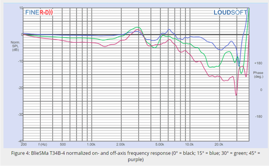

Have a look at the normalized response of the T34-B as measured by Vance Dickason in Audioexpress.
You can see that if you make the on axis flat (black line) then there will be peaks in the off axis just due to the the tweeter's size and shape itself. The baffle it is mounted in will modify that from what is seen here but the trend is obvious. If you want even on and off axis from a large tweeter over a large bandwidth then it will most likely need a waveguide of some sort.

Good info fluid!
Although that Audioxpress measurements done with the tweeter mounted on a typical speaker baffle. The off-axis peaks and dips depends on the baffle and box shape as you say.
Below is an infinite baffle measurements of the same tweeter, we can see the almost omnidirectional behaviour in the low to mid-range (and the rapidly increasing directionality going up in frequency).
Personally I don't get why manufacturers produce brilliant and very expensive (or cheap) dome tweeters and sell those without any significant waveguide attached to it or not sell waveguides separately to their tweeters if someone wants to use it. Instead, they let the tweeter response (mainly the lower part) be swamped by the speaker baffle.
Furthermore it's almost impossible to match a bare dome directivity to the midrange driver without a waveguide. Of course, a waveguide need further development, maybe that's the reason, idk.
But thanks to the sacrificial work of some people, free waveguide plans are being made for popular dome tweeters.
