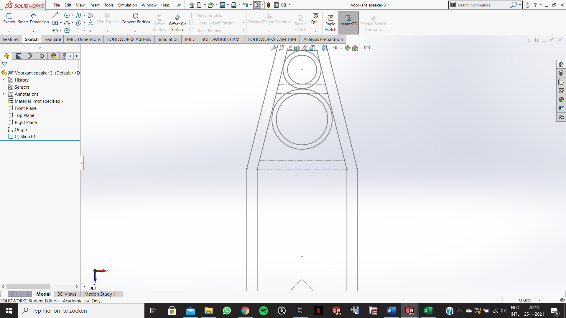

Design update.
I was watching an interview with Lawrence Dickie about the Vivid Audio Giya G1 Spirit. Very inspiring. And I got inspired to place the midrange and tweeter closer together. I already knew placing the tweeter and mid as close as possible is beneficial. But hearing him saying it made me do it.
So as I was redesigning the top of the loudspeaker and wanted to put the top midrange and tweeter as close together as possible. So that the cutout holes are right against the baffle that seperates the midrange and tweeter chamber.
But I also have felt on the front baffle, which is sunk in. But the midrange frame and the tweeter faceplate were only 1 mm apart and I wouldn't be able to cut the felt that shallow. The same was the case between the midrange frame and the edge of the deepening for the felt. So what I decided to do is sink in the drivers flush with the surface on which the felt will be stuck. So that the felt will go over the tweeter faceplate and the midrange frame. Then the distance between the midrange surround and tweeter and the edge of the deepening is wide enough so I would be able to cut it. It actually also has some advantages. Because the tweeter faceplate and the midrange frame will be covered in felt there will be even less reflective surface on the baffle.
And covering the midrange frame with felt has a second advantage. The vibrations of the motor travel through the basket to the outer frame of the midrange. And much faster than through the other materials. This causes the frame to radiate sound, as a second source. This polutes the midrange and getting rid of it by covering the frame has a notible effect on the purity of the midrange. Edwin Van Rijnveld, founder and designer of Siltech told me this when I spend a day with him. He also discussed this with Alon Wolf from Magico. This is the reason that now Magico and others like Boressen, Grimm and others cover up the midrange frames.
Covering it with felt won't be as effective as actually mounting the midrange behind the baffle, but it's something. And also, it actually looks super neat. Just like Rockport speakers.
Also, I actually wanted to lower speakers slightly because I actually find the tweeter to sit slightly too high when I'm sitting back comfortably. But I didn't know how to because I didn't want to lower the enclosure and take away volume from the bass chamber. I simply solved it by moving the seperating wall between the midrange and woofer chamber up. This takes away volume in the midrange chamber but this way I can keep the bass chamber volume the same and make the speaker lower. The volume of the midrange chamber is less critical. And it's still huge anyway.
Sorry for the long story. To sum it up:
-I got the midrange and tweeter as close together as they possibly could for better disperion.
-I covered the tweeter faceplate and midrange frame with felt getting rid of more reflective area and reducing the second sound emiting from the midrange frame.
-I got the tweeter on a better listening height without reducing bass chamber volume.
Very happy that I solved these problems this way.

The sound emiting from the basket of the midrange will definately be of a very low level. But it does have an audible effect. And if Edwin Van Rijnveld and Alon Wolf agree on it. I'll definately believe it.
Well my current listening space is very small and it does have an effect when I'm sitting more upstraight or more laid back. And still the closer they are together the better the dispersion will be. And even though the effect might be minimal, I'm willing to squeeze as much performance as possible from this design (to a certain degree of course).
I think you are overlooking much more likely candidates for bright / bad upper mid / lower treble, than basket vibration.
Can you honestly hear a difference? (hard to do unless you are A/B switching instantaneously across both speakers - one setup old and one with the new felt / changes).
Assuming you do hear a difference... has it solved the problem? are we job done here?
If not - I go back to my point of something more fundamental.
In terms of C-to-C spacing.. This only affects lobing. A simple test would be to find a vertical position playing a track over and over where the forwardness "goes away". But then all you are hearing is a midrange / treble dip caused by lobing. It might give you a sweet spot listening position though. If you can't hear a difference, either the C-t-C spacing is not a factor, or the room or inherent driver behaviour is swamping the response.

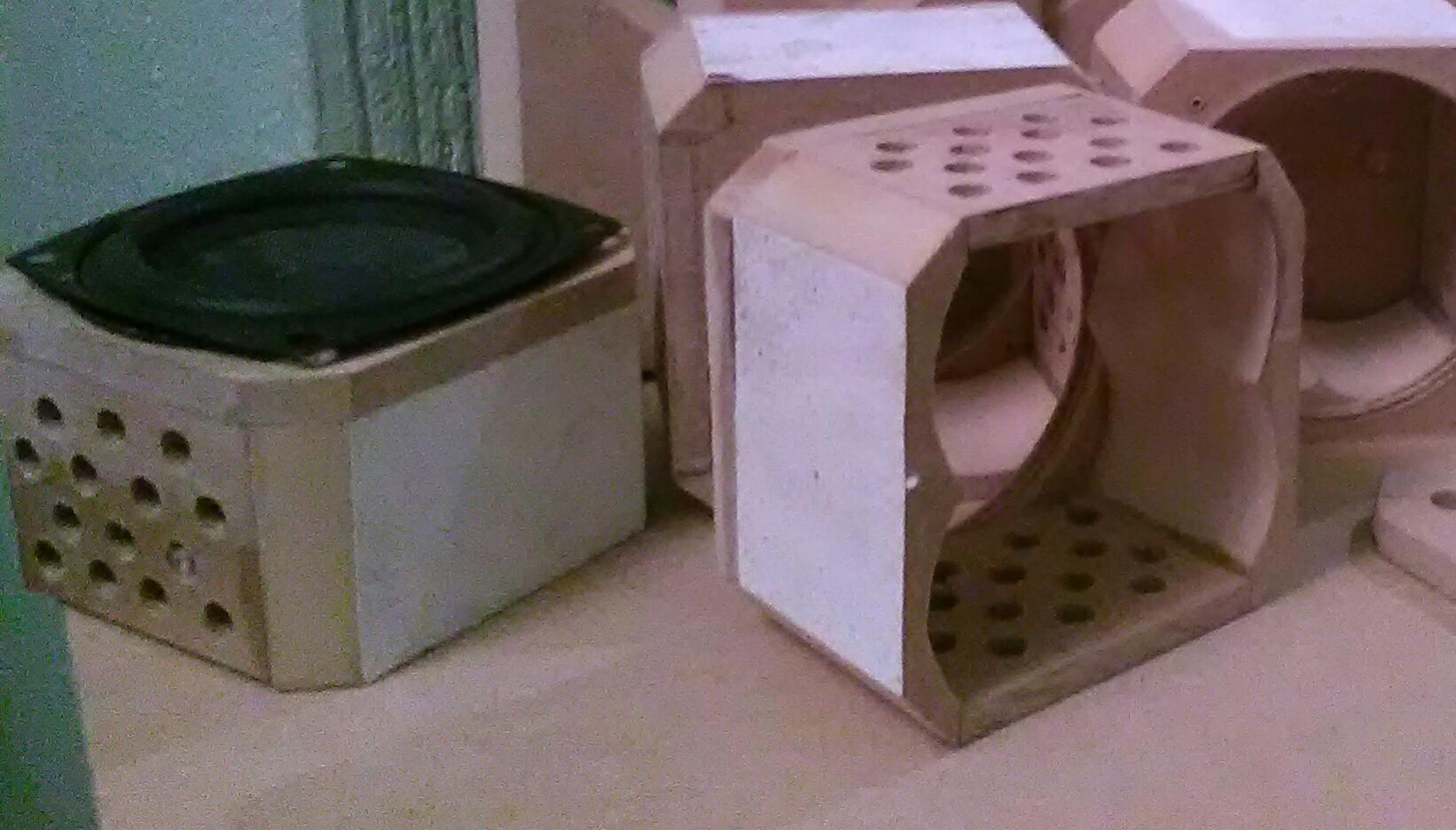

Another thing I thought of yesterday. Right now the sides of the braces in the midrange chamber are flat. So they reflect sound from the midrange driver right back. On the new pair I will make those sides pointy like the edge of a knife. So it doesn't reflect the sound right back.
They are all small improvements but I'm very curious what they'll bring performance wise when the new pair is done. Obviously it won't be a night and day difference. I'm expecting it to make the midrange a little bit purer. And maybe slightly improved imaging because the midrange and tweeter are so close together.
Obviously the difference will be very small. But perfection is in the details.

Well the only thing that might be called a real "mistake" was the round top. But that's why I changed it to th square top.
Neither a round top nor a flat top is inherently better than the other. Baffle diffraction is affected by 3 things - cabinet dimensions, driver position and edge/surface treatment. You can just as easily get a decent diffraction response from either a flat top or a round top if the driver is in the right location depending on the cabinet dimensions. Furthermore, although this is kind of mute when you are using a driver that begins with an extremely flat response, it's not just the diffraction response that is important, it's how the diffraction response and the driver response combine together that matter the most.
Just randomly changing your baffle shape is sloppy work. Instead, use a diffraction simulation program to find out what the best combination of size and positioning are for the drivers in question. Better still to make some real world prototypes afterward with something like cardboard or bristol board or rigid foam insulation sheets if necessary, and then measure the results before you build the final cabinets.
I used to think this way when I started out too. Then I did some research. The question of whether or not a sound wave will be reflected by an obstacle or whether it will simply wrap around the obstacle is dependent on the size of the wavelength vs the size of the obstacle. If the wavelength is approximately equal to or smaller than the width of the object, it will be reflected. But if the wavelength is greater than the width of the object it will effectively ignore it and just wrap around the obstacle. The frequency of a wave with a length of 3/4" (the assumed width of your bracing) is about 18,000Hz. So unless your mid is popping out some extremely high frequencies, keeping the brace edges flat or rounding them over will make absolutely no difference. But have at it if it makes you feel better and that makes you think the speakers sound better but it's not based on the science.
I skipped through the last page and have not seen measurements. 3wayaddict, did you make new frequency response measurements with the right gate settings? It could point out why you experience a lack of warmth.
I haven't read the entire thread. Do you use felt damping inside? How about felt around the mid and tweeter? In my better designs; I use felt inside and out. I also use foam pyramids inside behind the driver baskets and then poly' fill for the rest of the cavity; 35% to 75% depending on many things. I also sometimes use thick, high density cork on the baffle between the driver frame and baffle board. I have class D amps for the lower woofer and sub woofer, everything else uses class A/B. Do you think maybe class D in the mids or highs could be too "edgy" ??? My latest LP on the MR16 mid is a single 14 AWG flat foil. Electrically, the F0 is lower than would normally be with a higher order passive X/O but the rising FR of the MR16 gets a more gentle (combined acoustic/electric) roll off than true 1st order. Can you adjust the order with the active X/O. Q???
Instead, use a diffraction simulation program to find out what the best combination of size and positioning are for the drivers in question. Better still to make some real world prototypes...
Basic diffraction simulation is valuable for baffle loss and directivity estimation at low...mid but not much for tweeter. Diffraction affects to directivity so there no good single position if enclosure is classic box with sharp edges. On axis could be okay but many other directions are just random, and power and ERs probably fail if crossover is optimized by on axis. Solution for conventional tweeters is kinda convex wave guide; rounding or rounded bevels with adequate radius.
