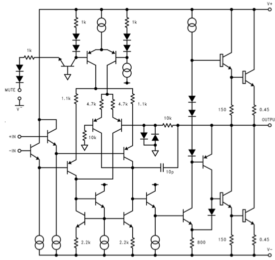

All I wanted to ask, does the TI model of the LM3886 have pin 7 missing?
otherwise great thread.
Please ignore any of the above that didn't make you laugh.
Yes. Pin 7 (GND) is not included in the model. As you can see from attached schematic (from page 7 of the data sheet), the GND pin is only used by the mute circuit. I am guessing that the mute functionality in the model just sets the output voltage to mid rail, so if you aim to model the circuit performance in the mute condition with GND set to some other voltage than mid rail, you won't get accurate results. The omission of the GND pin has no impact on the model performance when the amplifier is active (i.e. NOT muted).

Thanks tomchr,
I was doing some sims, trying to work out if pin 7 should be connected to AGND or PGND and to where pin 8 should be connected. I used a different model.
Pin 7 (GND) can connect to AGND or PGND. Personally, I would connect it to PGND to keep AGND clean. The quality of the "ground" at the GND pin only affects circuit performance in mute. I'm not so concerned about the sound quality when the amplifier is muted... 😛
How to treat Pin 8 (MUTE) is described pretty well in the data sheet. The current out of the MUTE pin needs to exceed 500 uA for the chip to get out of the mute state. As you can see in the schematic, there are three diode drops (Vbe and two diodes) and a 1 kOhm resistor in series with the MUTE pin. So you can calculate the mute resistor like this:
Rmute < (|Vee|-3*Vd)/Imute - 1000 = (|Vee|-2.4)/0.0005 - 1000.
Vd is the diode drop (I use 0.8 V as a worst case number) and |Vee| is the absolute value of the negative supply voltage.
So if you're running on a +/-28 V supply, |Vee| = |-28| = 28. In that case, Rmute should not exceed (28-2.4)/0.0005 - 1000 = 50200 ohm. I would use 47 kOhm in that case.

I came to the same conclusion about pin 7. I was not expecting to see the audio signal at pin 7.
As for Rmut, I think you need to know the rail voltage at full power before calculating Rmut. In some of the sims I was able to lose more than 1/3 of the rail voltage and get the amp to mute. A diode in series with Rmut seemed to help some.
That's true. You need to use the worst case rail voltage.

No. Pin 7 is a ground connection used for switching the bias between the input stage (active state) and the error amplifier used for the mute function (mute state) in the LM3886. It needs to be tied to ground. See the circuit schematic for the LM3886 (image attached to Post #89).
~Tom
~Tom
I connect pin 7 to power supply GND using a separate wire (P2P) I think I will have to rethink this. I connect Rmute to power supply negative. This is also probably wrong.
I think its a choice between power supply symmetry and good grounding practice. I want both.
It sounds like you're doing it right. You don't need to run pin 7 (GND) through a separate trace, but there is no harm in doing so. Rmute needs to go to a negative voltage. The negative supply rail is the most obvious choice.
