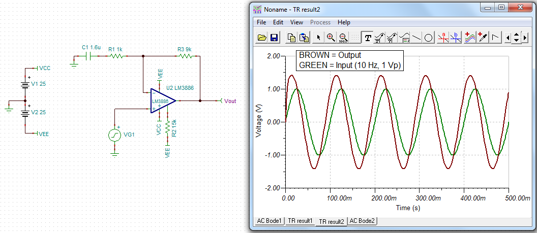

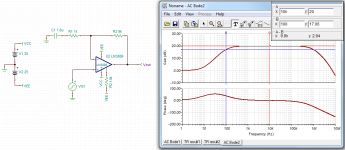

To make the math easier, I will use a 10 Hz signal.
If the amp has a gain of +10 V/V with Fc = 100 Hz, then the pole and zero I talked about in Post #39 are located as follows:
Fz = 1/(2*pi*(R1+R3)*C1) = 10 Hz
Fp = Fc = 1/(2*pi*R1*C1) = 100 Hz
This means the amp will have 10 V/V (= 20 dB) of gain mid band and 1 V/V (= 0 dB) gain at DC with a transition at +20 dB/dec from 10 Hz to 100 Hz. At 10 Hz (Fz) the gain should be about 3 dB (= 1.414 V/V) and at 100 Hz, it should be 17 dB (= 20 - 3 dB or 7.08 V/V).
This also means that if you apply a 1 V amplitude test signal at 10 Hz, you should get 1.414*1 = 1.414 V out of the amplifier. My simulations confirm this.
See my simulation results below. The first image shows the frequency response (gain) of the amplifier. You can clearly see the 0 dB gain at LF, transition from 0 dB to 20 dB at a 20 dB/dec slope from Fz to Fp and 20 dB midband. The roll-off at HF is caused by the limited bandwidth of the LM3886 itself. The second image shows the transient response with a 10 Hz sine wave input. This is what you would see if you were to measure the circuit with an oscilloscope.
Note that in simulator terms, "transient" means that time is the swept variable. "AC" means the frequency is swept.
~Tom

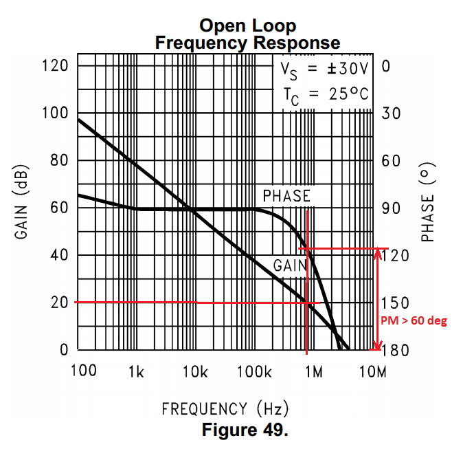

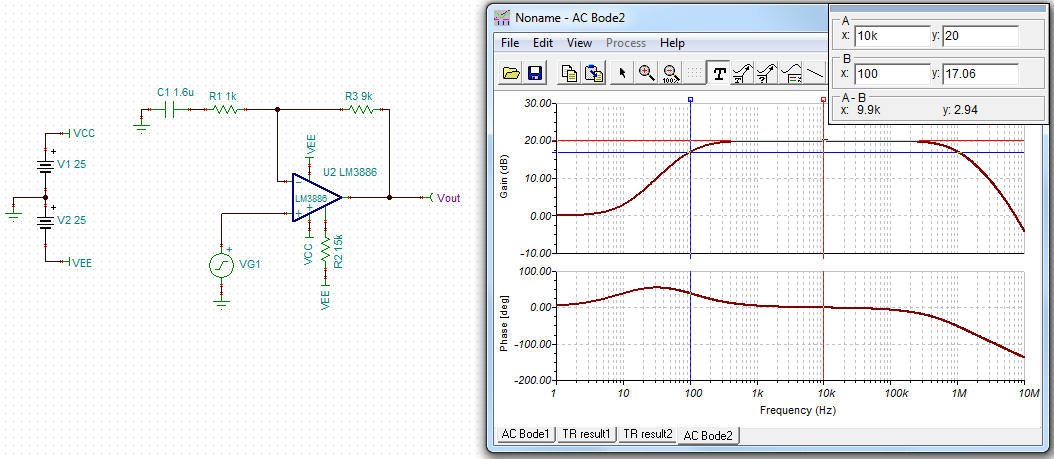

Look at the phase and gain margins when Closed Loop gain is set to that minimum of 10. Not nice.
The datasheet indicates that the PM should be greater than 60 deg at a closed loop gain of 10 (= 20 dB). See attached. The figure is straight from the LM3886 datasheet. I annotated it to show the PM at a closed loop gain of 20 dB.
Look also at overshoot when set to lowish CLgains.
Always measure the transient response of the amp. I agree wholeheartedly there. In the ideal world, we would also measure the loop gain and confirm the phase margin, but few people have the gear necessary for this. Although, the measurement is really not that difficult.
Alternatively, one can measure the output impedance (versus frequency) of the amp. That says a lot about stability as well.
~Tom

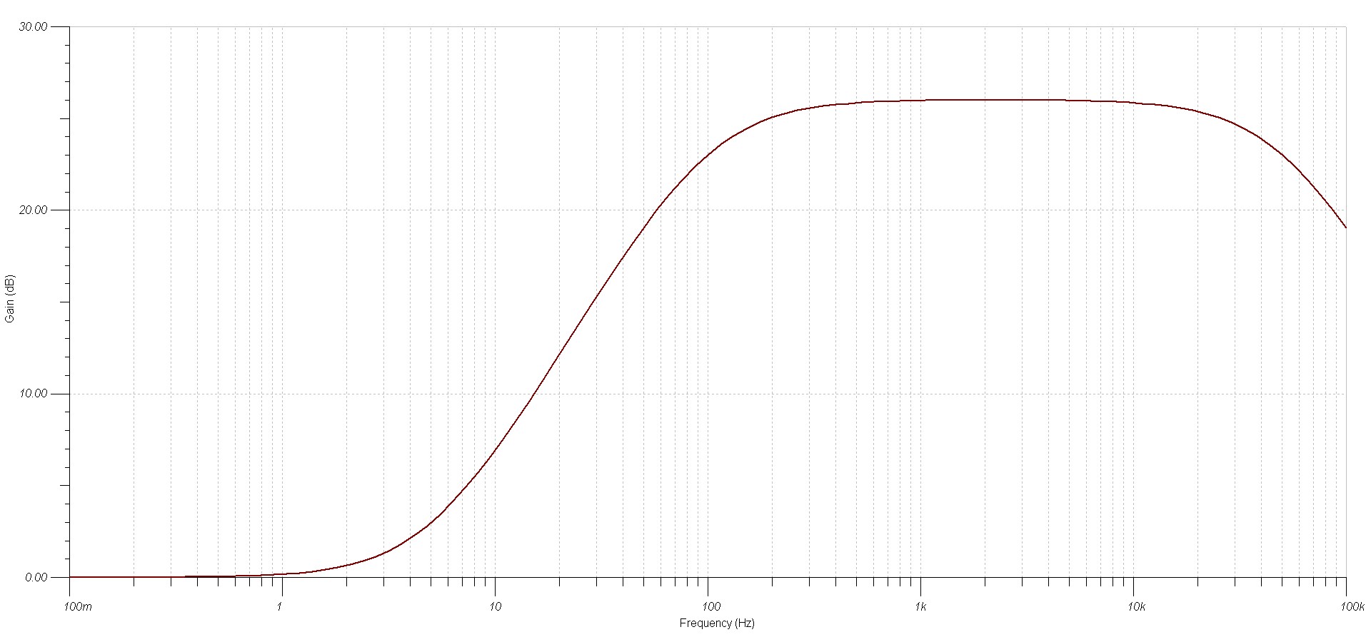

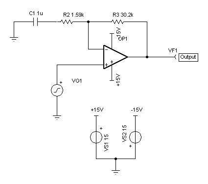

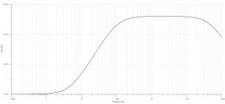

OK, one more time with pictures.
LM3886 amp chip is internally compensated for minimum gain of 20dB (X 10)? Check.
Feedback network has a high pass roll off with -3dB at 100Hz? Check.
Amp has gain of 26dB (X 20) in the pass band? Check.
Amp has gain of 21.5db (X 11.9) at 75Hz? Check, and still within minimum gain requirement.
Amp has gain of 19db (X 8.9) at 50Hz? Uh-oh - not within minimum gain requirement.
Amp has gain of 13.9db (X 4.1) at 25Hz? Uh-oh - REALLY not within minimum gain requirement.
Of course, while nobody would actually build an amp like this, I felt an exaggerated example would illustrate my point better.
And yeah, I get your point that in actual practice having a lower Fc at the input Vs the feedback network doesn't necessarily mean there WILL be problems, the point I'm trying to make is that it makes no sense to build it with the potential to have problems that are easily and simply avoided to begin with. In this case, just make the feedback cap bigger.
Mike

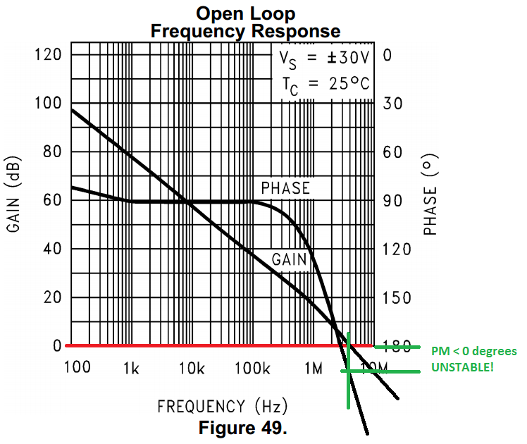

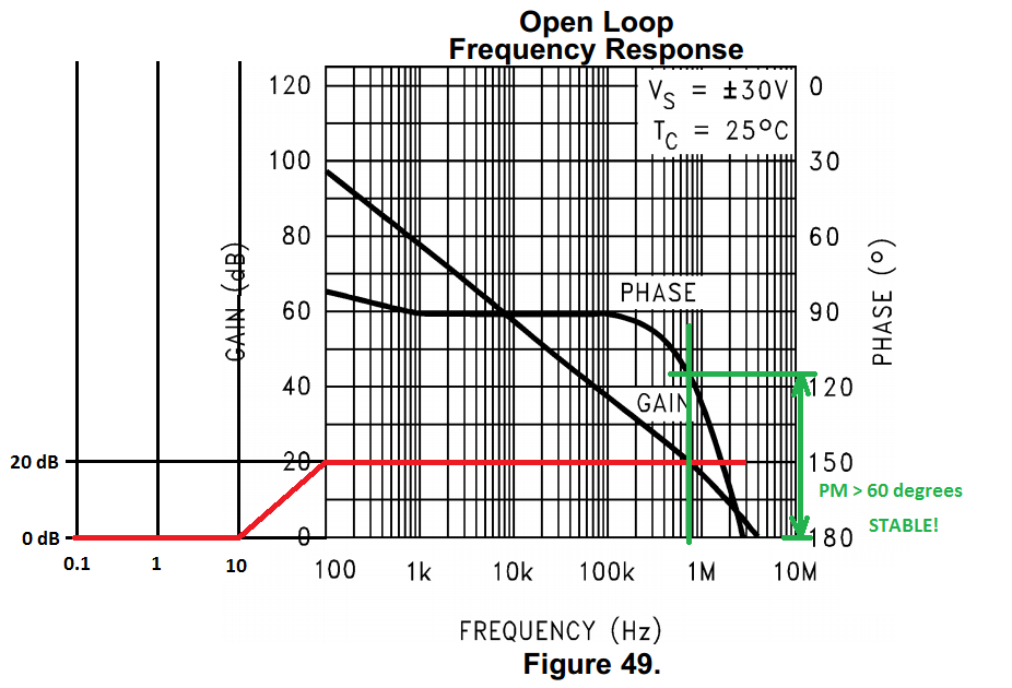

I see the root issue here. You appear to have misunderstood the term "unity gain stable".
"Unity gain stable" means that the amplifier's open loop phase response is higher than -120 degrees when the amplifier's open loop gain crosses 0 dB. This leaves at least 60 degrees of phase margin (PM = -120 - (-180) = 60) when the amplifier is configured as a buffer with no external compensation.
On the first image, I have drawn the case where the LM3886 is wired as a buffer. You will notice the negative PM, hence, the circuit is unstable. The red curve shows 1/(feedback gain). The phase margin and unity loop gain frequency are marked in green.
On the second image, I have drawn the case you simulated. I had to extend the frequency axis to show my point. The red curve shows 1/beta = 1/(feedback gain). The phase margin and unity loop gain frequency are marked in green.
Stability deals with the LOOP GAIN not the CLOSED loop gain. For an LM3886, the closed loop gain can be 0 dB as long as the loop phase hasn't dropped below -120 degrees when the loop gain crosses 0 dB. The CLOSED loop gain is irrelevant for stability analysis. Only the LOOP GAIN (and phase) matters for stability.
Terminology:
Open loop gain (A, forward gain): Raw gain of the op-amp.
Feedback gain (beta): Gain of the feedback network. (usually attenuation, actually, so gain below 1.0 or 0 dB).
Loop gain: [Open loop gain] * [feedback gain] = A*beta.
Closed loop gain: A/(1+A*beta). For large values of A, this simplifies to 1/beta.
I strongly suggest that you read Franco or any of the other references on this. You can also check out this YouTube video on stability analysis using Bode plots.
~Tom
