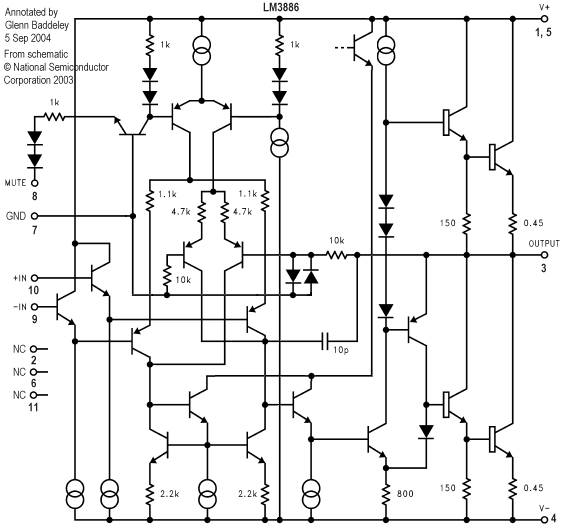

Has anyone managed to get a circuit model of the LM3886 to function correctly?
Using the circuit published,I find huge crossover distortion at higher frequency's - with the step response showing a horrid "Step" around the falling edge "Crossover region".
FFT measurements of LM3886 designs does show crossover components (about -110dB Ref. 1W 8R) - but the simulations show worst results - in fact looking at the internal schematic, I don't believe the transfer Gain around the crossover region is ever going to be "Smooth".
I had to slightly modify my own simulation circuit of the LM3886 - Q10 is loaded via a 5mA CCS, rather then the diode "load" indicated in the LM3886 "Equivalent Schematic"... With the Diode "load" the crossover region was even worst (And I don't believe the indicated diode connection is correct, unless some oddity of on chip device is used).
Note - I have no idea of the on chip transistor characteristics, so I used the "crummiest" discrete devices I could find for the simulation model - still I had to tweak the Cdom Cap to 18pF to match the Gain / Phase plot shown on the Data Sheet.
Does anyone have a better internal circuit? I suspect NS have deliberately not disclosed the true "circuit" in there published "Equivalent" Schematic.
I can correct OPS design to function correctly - but what's really inside the LM3886?

Thanks for the reply, but the output stage design still follows the published NS circuit so will display the same Crossover irregularities...
Non Complementary OPS are notoriously non linear around the Xover region - Baxdal's (sorry for my spelling) diode goes some way to help linearising the gain, but the natively low output impedance of the upper EF stage, and the inherently high impedance of the lower half is never going allow "Complementary" performance between each phase of the OPS.

Thank you - however once again it still shows the same Diode loaded PNP driver to the lower output stage. TI (NS) AN-898 Application note Fig 1 shows this connection loaded via a CCS which makes more sense and improves the simulated step response WRT the Failing Edge.
On your schematic you can see the Diff pair CM and EF buffer stage switched via an NPN transistor which I presume is part of the protection / Mute circuit 🙂
Maybe they did not have a symbol for the CCD (constant current diode) at hand😀
Another detail is also interesting ... feedforward error-correction within the main differential😉
Oh - I don't see it? The second Diff Pair with 4K7 Emitter Resistors enclosed (Drawn) within the Main input pair is only enabled during Mute - Otherwise I'm missing something major? 😕
Only enclosing the Output stage within the Cdom feedback loop is a little unconventional and can lead to stability issues in practise (making it more sensitive to capacitative loads)... What have I missed? :innocent:
So let me get this straight. You're unhappy with the TINA-TI Spice model because it's "idealized" but proceed to build your own from the equivalent circuit schematic using models for various discrete devices. And you want to model distortion and clipping behavior?
Both will be dependent on device characteristics. You won't find those published by National as those are confidential company information. You can take your best guess but in the end you'll be simulating a circuit that's rather different from an LM3886, so if the performance of an LM3886 is what you're looking to model, you're really shooting yourself in the foot.
Simulators are great at giving you data with many digits for the THD. How many of those digits are valid? Not many, it turns out... Once you start pushing 0.1 % or 0.01 % THD, you really have to ensure that you're simulating the THD of the circuit and not the residual error of the circuit simulator.
Add that the circuit schematic in the data sheet is an equivalent circuit rather than the actual circuit. I guarantee you that the details of the compensation network are not shown in the equivalent circuit. I would also expect that things like saturation clamps aren't shown either.

As a Chip designer myself I prefer to model "real" circuits rather then an idealised Opamp block with various parameters dropped into the model.
I'm only playing with the design trying to improve an existing product (Audiolab M-PWR) - if I was serous then I investigate the Fab process and I might even have access to models of the process characterised - but I've not bothered to make the phone calls as I'm only playing around for fun.
I prefer real models as I tend to try various external circuit tricks that a simple "OpAmp" model would offer very little information - For instance the Tina Model does not show the abrupt Falling edge "discontinuity" as the upper EF stage hands over (less then gracefully) to the lower CE stage.
Measurements on the real device at higher frequency's display this issue, so for my purposes my model is closer to the physical device then the Tina Model.
I've NEVER stated that I wanted to model THD, my THD results are based on measured hardware - I've never had much faith in simulated THD results - only using them as a "direction finder" rather then for any absolute values.

Fair enough. And you're right. I did make some assumptions when typing up my response. It's difficult at times to gauge the intent and skill level of people here. And sometimes my own cognitive biases get in the way as well. I'm human. What more can I say? 🙂
Yeah. The clipping behavior of the LM3886 is not pretty. It also challenges the stability of the circuit. At in my non-optimized circuit with way too much parasitic inductance in the Zobel network, I saw some ringing around that discontinuity. Interestingly enough, only on the negative swing.
