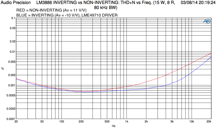

To quote Bruce Hofer from this month's audio.tst : The first rule in ultra-low distortion analog circuit design is to avoid non-inverting op-amp configurations like the plague.
All this stuff you guys are writing about caps and bypassing are of little consequence compared to changing the topology.
Rather than relying on blanket statements, one can also analyze the system. One then realizes that the CM distortion in a non-inverting amp is a pretty high-order effect of little to no impact. One can then build both circuits and compare their distortions... I did that. The results are below. More detail in This Thread.
For a true apples-to-apples comparison, the gain of the two circuits should be the same. That puts the inverting amp at a slight disadvantage because it'll have slightly lower loop gain. I performed that experiment in a previous setup and found the inverting amp (Av = -11 V/V) to be nearly line-on-line with the non-inverting (Av = +11 V/V) amp as far as THD+N goes.
I really don't see any reason to avoid non-inverting op-amps "like the plague". In fact, you're more likely to screw up the performance implementing the drive circuitry needed to drive the low input impedance of the inverting amp.

On a CMOS-input BiCMOS op-amp product (LMP8100 or LMP2021, I forget) I worked on quite a few years ago, I actually measured lower THD with the amp with it in a non-inverting buffer configuration. I rigged it as an inverting amp as well with a gain of -1. In that configuration, it had slightly higher THD.
My measurements above of the LM3886 (bipolar input) shows the inverting being marginally better. However, this does require a driver that can drive the low input impedance of the inverting configuration. This driver will need to be engineered and designed properly and its signal ground connected at the appropriate point in the LM3886 part of the circuit. Otherwise, the performance will be significantly worse than that of the LM3886 in non-inverting configuration.
That's why my recommendation is to use the non-inverting LM3886 unless you have test equipment to measure that you didn't screw up the grounding of the driver.

did you do distortion measurement comparisons at gains of 2times and 20times?
2x, no. 20x was slightly (negligibly) worse as you'd expect from the slightly lower loop gain.

Hofer's comment are for ultra low distortion ~ 1ppm or less, and common mode swing is bigger at low gains
audio power chip amps are not capable of ultra low distortion on their own, and most are decompensated for Av >10 - so they don't have much common mode on the input even in noninverting mode
inverting is not a panacea, power chip amps are limited by many other errors than common mode input nonlinearity
