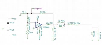

Looking at the equivalent circuit schematic in the LM3886 data sheet, it becomes pretty obvious why the VEE PSRR is so much worse than the VCC. The VAS sits on VEE... I would have been nice if the amp had been differential all the way to the output stage.

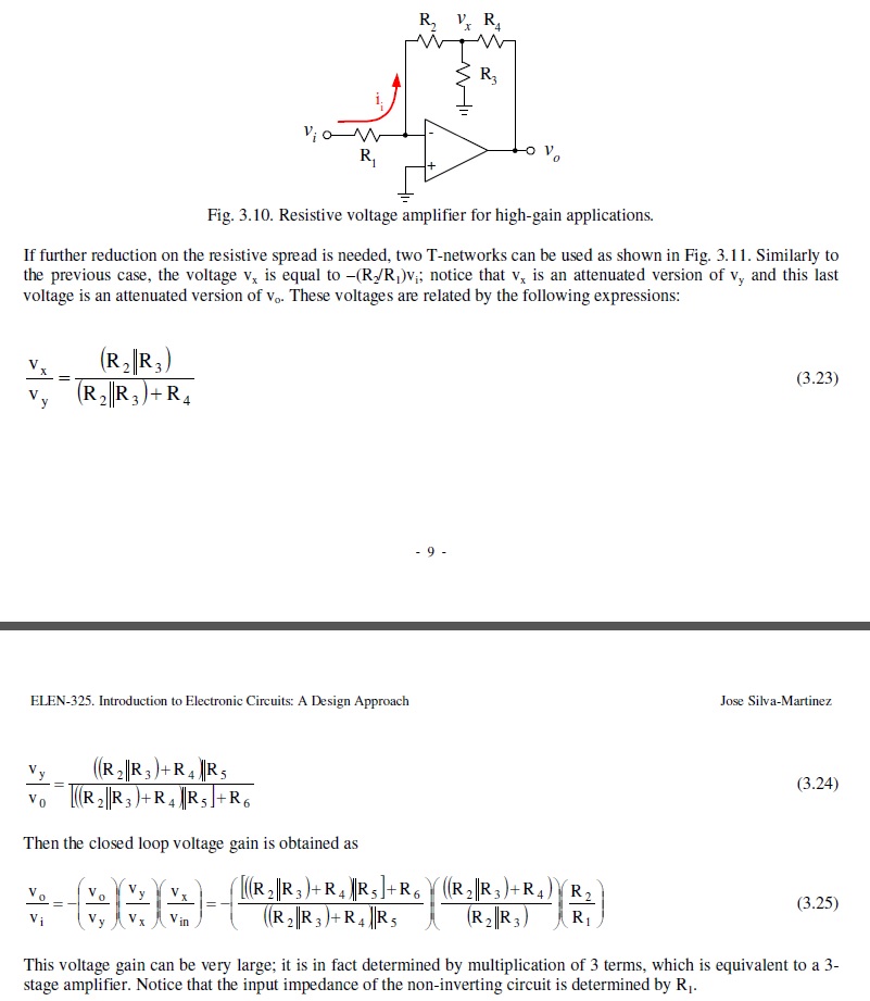

Maybe I'm misunderstanding your "T-net" thing. I'm thinking of the topology commonly used to create a high gain circuit or to lower the impedances in the feedback network to combat issues related to high op-amp input capacitance. That circuit is a T-network from the op-amp output to the op-amp input forming the feedback. It's basically like the regular resistive feedback network with a voltage divider before the feedback resistor. Is that what you're referring to?
Fig. 3.10 in this .pdf is what I'm talking about. That circuit, if used with an LM3886, does nothing to address stability issues related to gains below 10 V/V. The loop gain/phase is the same with the T-network as it would be with the regular feedback network. The only advantage of the T-network is that it reduces the impedances in the feedback network. This may help in high-gain situations where the input capacitance of the op-amp along with the high resistance feedback resistor would cause a pole in the feedback transfer function, dorking up stability.
If Andrew wants PM > 80 deg at gains below 20 V/V, he'll need to apply phase lead/lag compensation to the LM3886. No T-network will work around that fact.

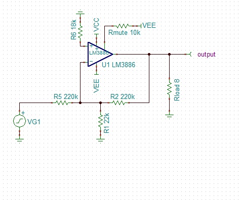

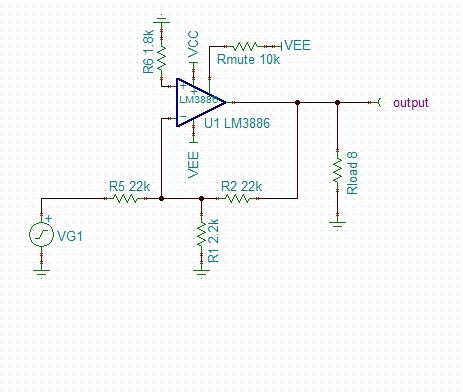

I think he was referring to Thorsten Unity Chipamp. If I understand your point, it shouldn't work. I've always wanted to throw it together ...
Ah, the trick is, it has to be inverting and the 'T' is config'd differently!
Here's T's circuit description:
"...you can extremely easily get unity gain in inverting mode. Simply use a pair of 220k Resistors, one from the Amp input to the inverting input, the other from the inverting input to the Output.
NOW observe the magic. Place a 22k resistor between the inverting input and ground. Then place an 18k resistor between the positive input and ground. Unity gain and stable. Easy as pie.
Sayonara
PS, this same sort trick lets you use the OPA637 as I/V converter without osccillation. It sounds notably better than OPA627 in this position but is not unity gain stable.... "
from
http://www.diyaudio.com/forums/chip-amps/9852-gainclone-no-gain-yes-pain.html#post112061
Here's what it looks like:
But I prefer the low res one (just div all res by 10):

What are the disadvantages of using this High Noise Gain arrangement compared to normal gain arrangements?
What stability margins exist for the high noise gain arrangement?
Are they the same as using the chip at a real gain of 10times?
The noise gain's the same as for the standard (20 or 26dB gain) arrangement, just the signal gain is reduced.

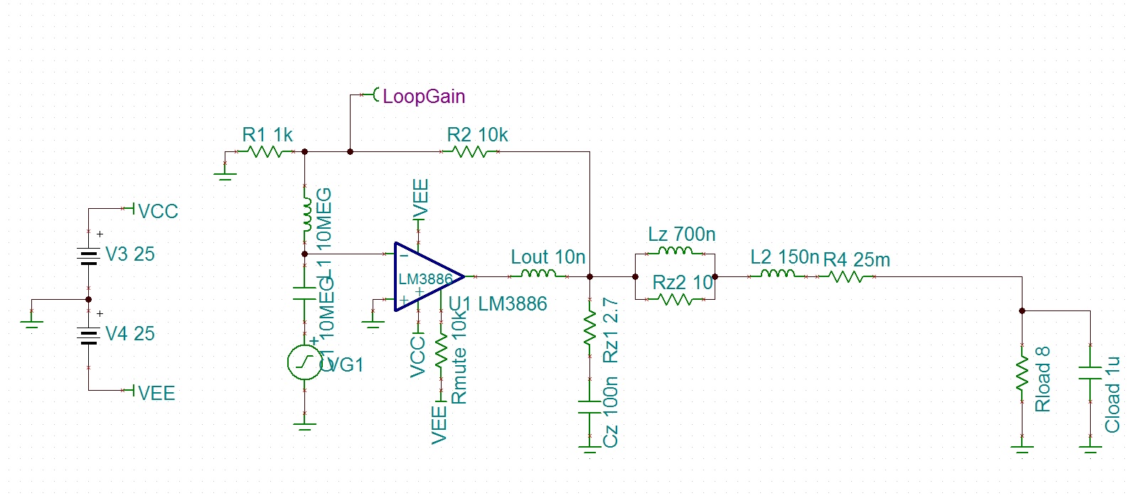

I just reinstalled Ti's TINA and have tomchr's clever 3886 loopstability file:
http://www.neurochrome.com/audio/wp-content/uploads/2014/02/LM3886-LoopStability.TSC_.txt
from his awesome:
LM3886 Chip Amp Stability Analysis
I'll see if I can figure out how to run the sims ...

If i may volunteer a reply the 22k resistor is there to provide stable dc reference.
T: Wrong. It's there to provide a noise gain of slightly over 10, ensuring the amp is stable.

Hi, But, what is the role of 22k resistor?
T: To make the Amp think it has a gain of 10 and thus to stop oscillating.
Hi, Yes you can: resistor from output to -input = 0 ohm, resistor between - input and ground = infinite...
T: Not with an LM3875 or LM3886. They will be instable at such a low gain. Sorry kid, no dice...

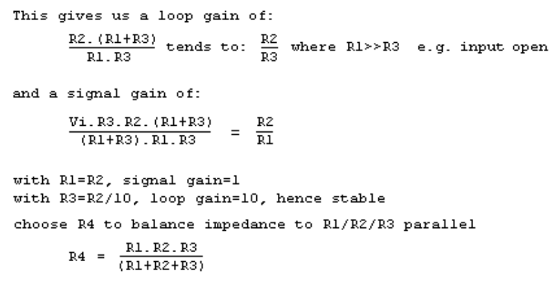

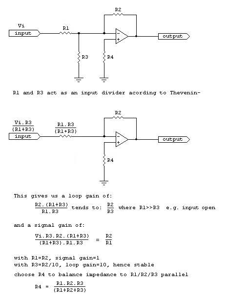

mc2:
"There seems to be a deal of confusion over this circuit configuration.
In fact this is a conventional technique for getting a signal gain less than the minimum stable loop gain with an op-amp.
I have expanded the math in the attached diagram. In essence the configuration provides an above unity loop gain (in this case approx. 11) but at the same time attenuates the input signal in exactly the same proportion, hence preserving the signal gain.
You can see this effect in the way the effect of R3 cancels out in the signal gain equation below.
mc2 "

Are you saying that the only disadvantage is higher noise levels?
or am I reading too much into the extracts you have posted?
I have the view that using a 3886 @ a normal gain of 10times leaves us with stability margins that are too low for good performance or good sound quality.
I prefer using a gain of around 26times to 30times to get the benefits of the improved stability margins at that gain.
