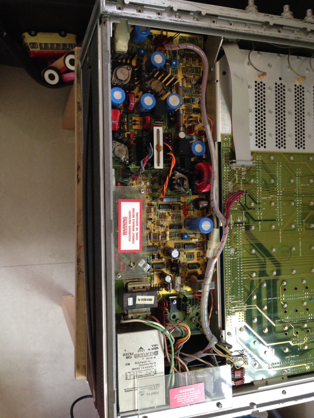

I just fixed my HP3577A where the AC input filter was short circuit. The filter box is replaced by a similar one. Loop gain measurement can be performed again!
I have been using a current injection probe proposed in Injection Transformers for Closed-Loop DC-DC Converter Network Analysis - Application Note - Maxim to make measurement. Any comment?
PS. Photo shows the original filter box.
