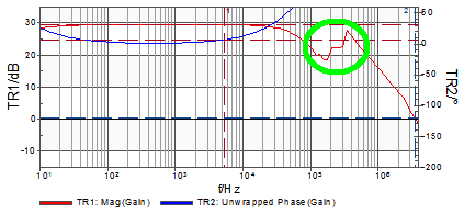

Those look like closed loop plots. Open loop is more interesting for stability. If you have the op-amp/LM3886 running as an inverting amp, you can measure the loop gain at the inverting input pin. What you'll measure is actually the residual error voltage, but that is inversely proportional to the loop gain, so all you have to do is change the sign on the magnitude curve (in dB) to get the loop gain.
That said, the peaking shown in the uncompensated case may be indicative of marginal stability. OTOT, the "wonkiness" at 100-400 kHz in the compensated case is a bit disturbing. Is that a measurement issue?

I don't think it's a measurement issue as I calibrated the probes before doing the runs.That said, the peaking shown in the uncompensated case may be indicative of marginal stability. OTOT, the "wonkiness" at 100-400 kHz in the compensated case is a bit disturbing. Is that a measurement issue?
Calibrated or not, the abrupt changes in gain and phase don't look real. It could be that not enough points were used in the sweep or the interpolation between points screw things up.
Also, you're looking at the closed loop gain rather than the open loop or loop gain. While the closed loop gain is interesting, what you want to look at for a stability analysis is really the loop gain.

The plots were done with the LM3886 in non-inverting mode, the conventional amplifier gain of 26dB, without benefit of Cordell's inverter and buffer. The dashed plot is "memory". Yes, I understand that I should break the loop between the buffer and the inverting input.

I am not aware of any analog system that can create an abrupt change in amplitude or phase. There's always a smooth transition. It could be that the amplitude/phase responses do change smoothly, but there aren't enough data points to determine that.

What abrupt change in gain are you describing? The compensated LM3886 in post 103 seems to have a pretty normal slope. The dashed line is the data in memory, and it shows a pretty dramatic impedance change which you won't find in the TI model.

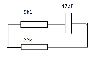

Solid curve of plot #2 (22k+47pF) is dashed curve of plot #3 (9k1).
That ragged irregular rise of some 15dB magically disapears when just a single resistor is changed? (exact schematic would be nice, it's unclear how you've set the gain exactly). Looks definitely unreal to me, especially from the "sawtooth" blip which is still present in the second curve. Further, the 0dB crossing is not at the same frequency but two ocatves lower (1MHz vs 4) which looks like a very clear indication to me something went wrong in the measurement scaling/normalization.
He means 22k\\(9k1+47pF).
