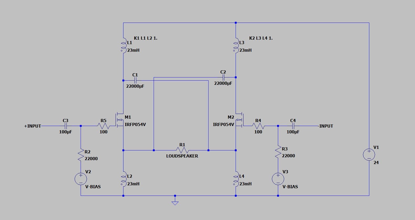

Just one question: Looking at the sch. there is only 1 Vinput, but the design is balanced. Is the 1 pcs Vinput a simulation thing and in reality one uses bot +V and -V for true balanced operation ?

Vin is just a label. The real input is V2, and V2+ and V2- are used for true balanced operation just as you suspected.
I got a suggestion to use a cathodyn (a.k.a split load inverter).
But I cowardly walked away from that path.
The preamplifier is now a simple operational amplifier (OPA1612) with 11 times amplification (V2+) followed by an inverter (V2-).

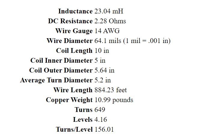

I want to try balanced XSLAPS;
The calculation for single 23mH inductor as flollows;
For bifilar winding we have to double the values here above;

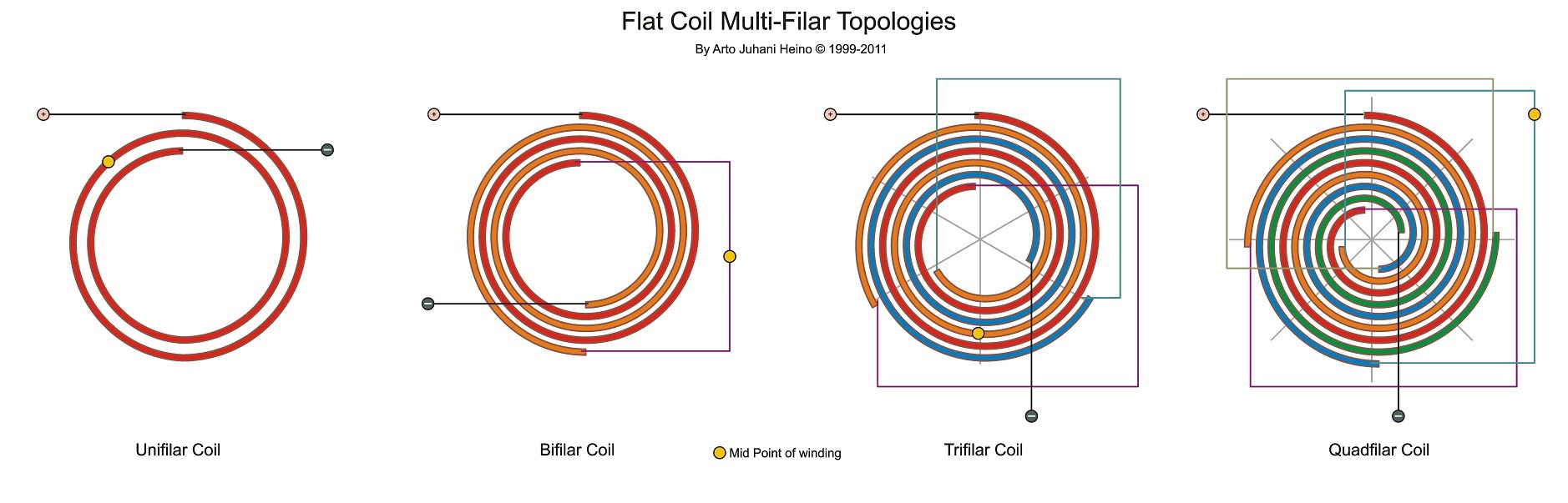

I was thinking if quadrifilar make sense or not?

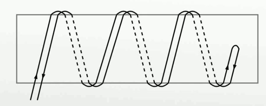

Also in both bifilar and quadrilar winding there is 2 pin end output but we need 4 pin positive rail, negative rail, drain and source.
Could you please make a small sketch to explain it.

Thanks than i will follow dot notations on the schematic. This is gonna be expensiveThe ends of the two windings are not connected to each other.
