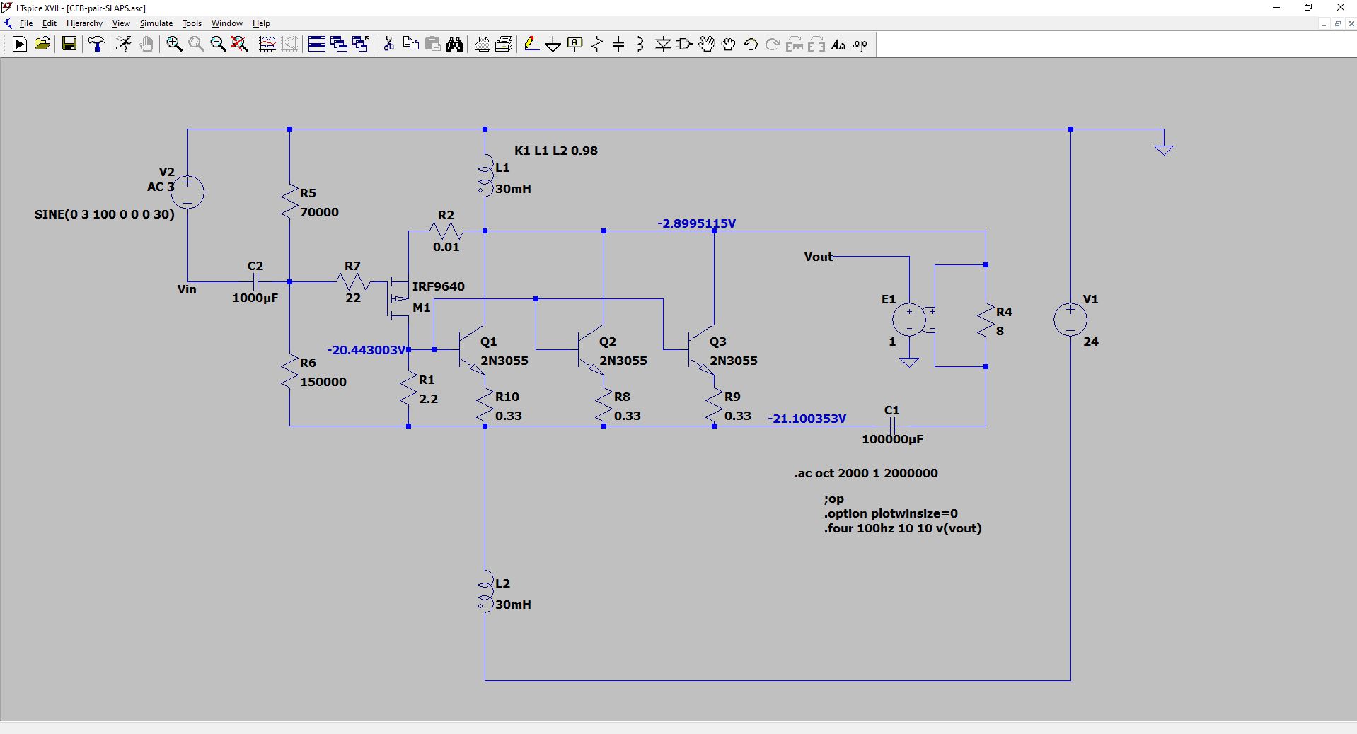

Improving SLAPS - introducing X-SLAPS
What's with the voltage source at the bottom of the schematic?
Simulation purposes? Some kind of bias, how can it then pass the input capacitors?

solhaga and Circlomanen, thank you for suggesting a clean and elegant topology.
What about using a CFP (MOSFET-BJT) rather than single MOSFETs?
If more of the the power to drive the load can come from the slaved BJT rather than the MOSFET, wouldn't that give more freedom for choosing a MOSFET with improved characteristics? (lower capacitance, better transfer curve).

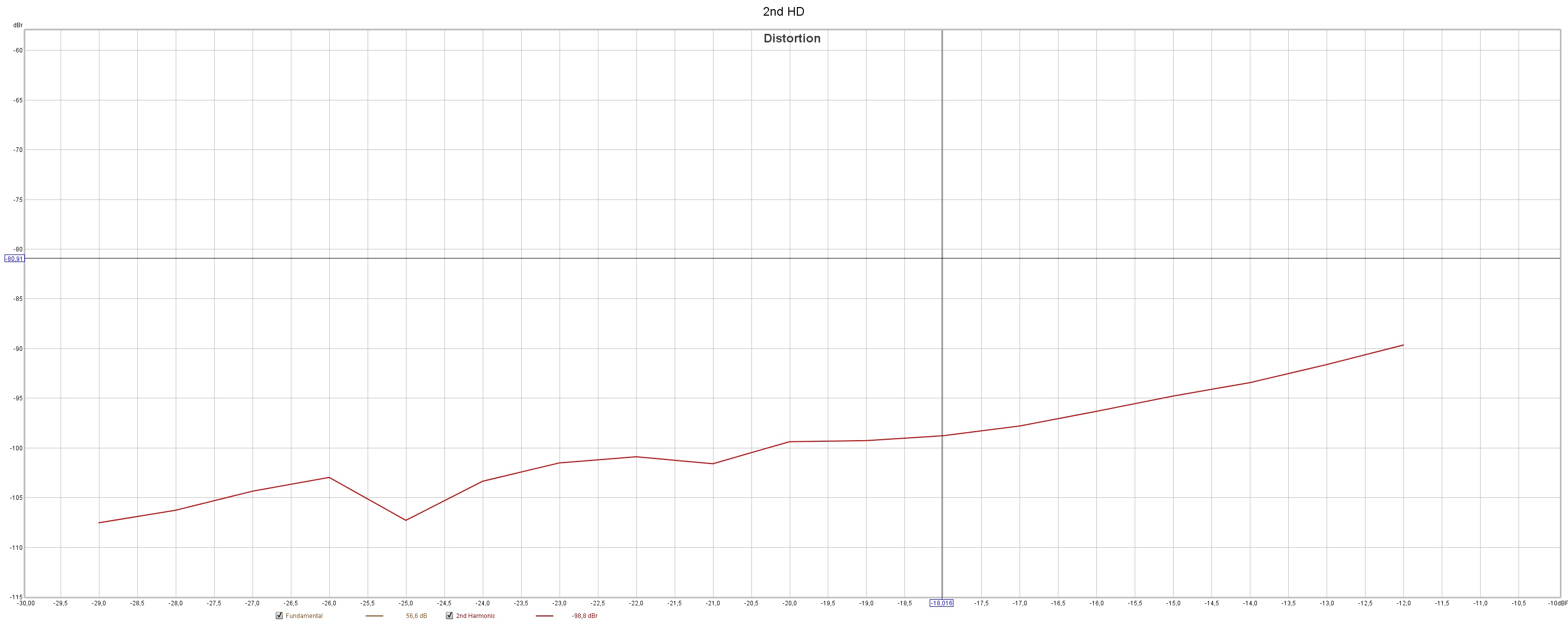

First measurements without the source resistors; it's only resistance in the coil, 0.7 ohm.
All measurements are at 1000 Hz and from an input level corresponding to 0.25 W (-29 dB) to 13 W (-12 dB) with 1 W at -23 dB.
The HDs got better with increasing Id, but I stopped at 3A.
Uds is then about 20 V, so the heat sink is at 60 degrees Celsius :redhot:

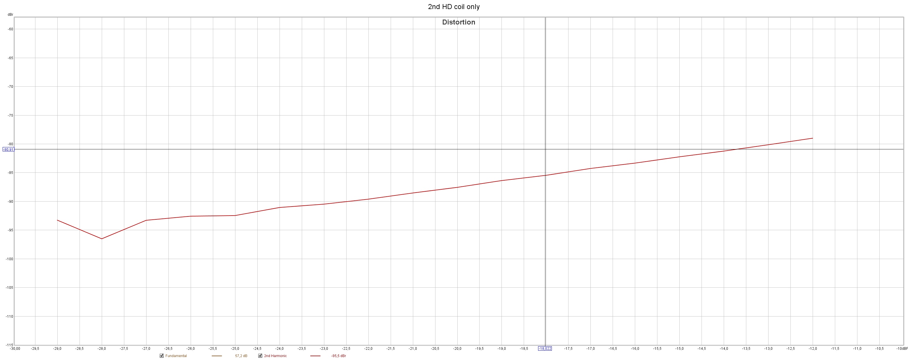

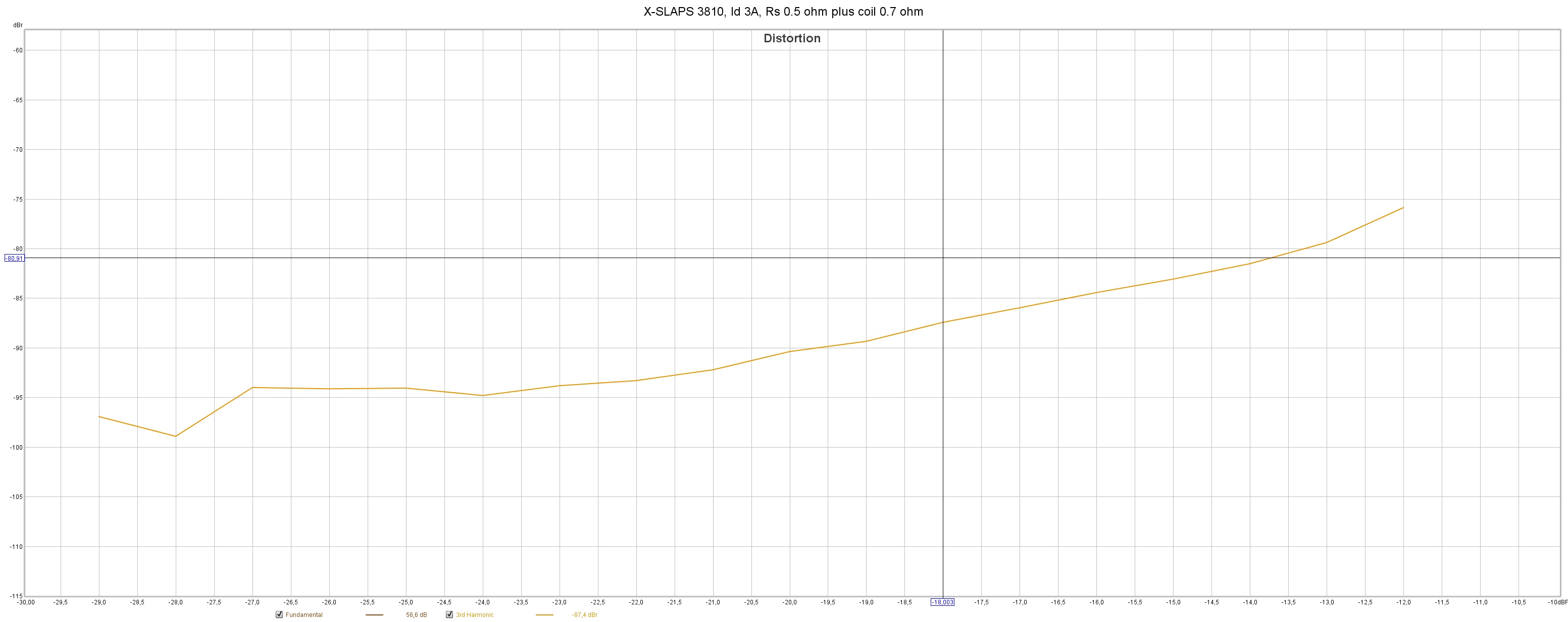

3rd HD with (0.5 ohm plus coil):
and without (only coil) source resistors:
Not much difference.
2nd HD with (0.5 ohm plus coil):
So with the source resistors, the 2nd HD is actually about 15 dB better!
So, some source resistance is needed.

If the second harmonic gets 15 dB worse without source resistors then this indicates a bad matching between the two sides - leading to less effective cancelation.
I would guess that the comparably much less reactive source resistors does a great job at linearizing the devices and making them much better matched over a much larger range of voltage and currents.
With very closely curve trace matched devices you would probably not need a lot of source resistance (local feedback) to get the lower second harmonic content.

I've tested today with 0.0, 0.1, 0.2, 0.3 ohm and 0.47 ohm as source resistors and both 2nd and 3rd HD gets better for every increase of Rs.
But not as good as the 0.5 measurement above that was done a couple of days ago.
I just remembered that when I started the measurements today, I accidentally broke off the drain pin of one of the MOSFETs and I had to replace the MOSFET.
So the 0.5 source resistor measurement above must have been done with more closely matched MOSFETs.
Comparing 0.5 to 0.47 ohm measurements shows that the better matched 0.5 measurement has 10 dB better 2nd HD.
Which proves your point!
I'd better do some curve tracing then or just keep changing one MOSFET.

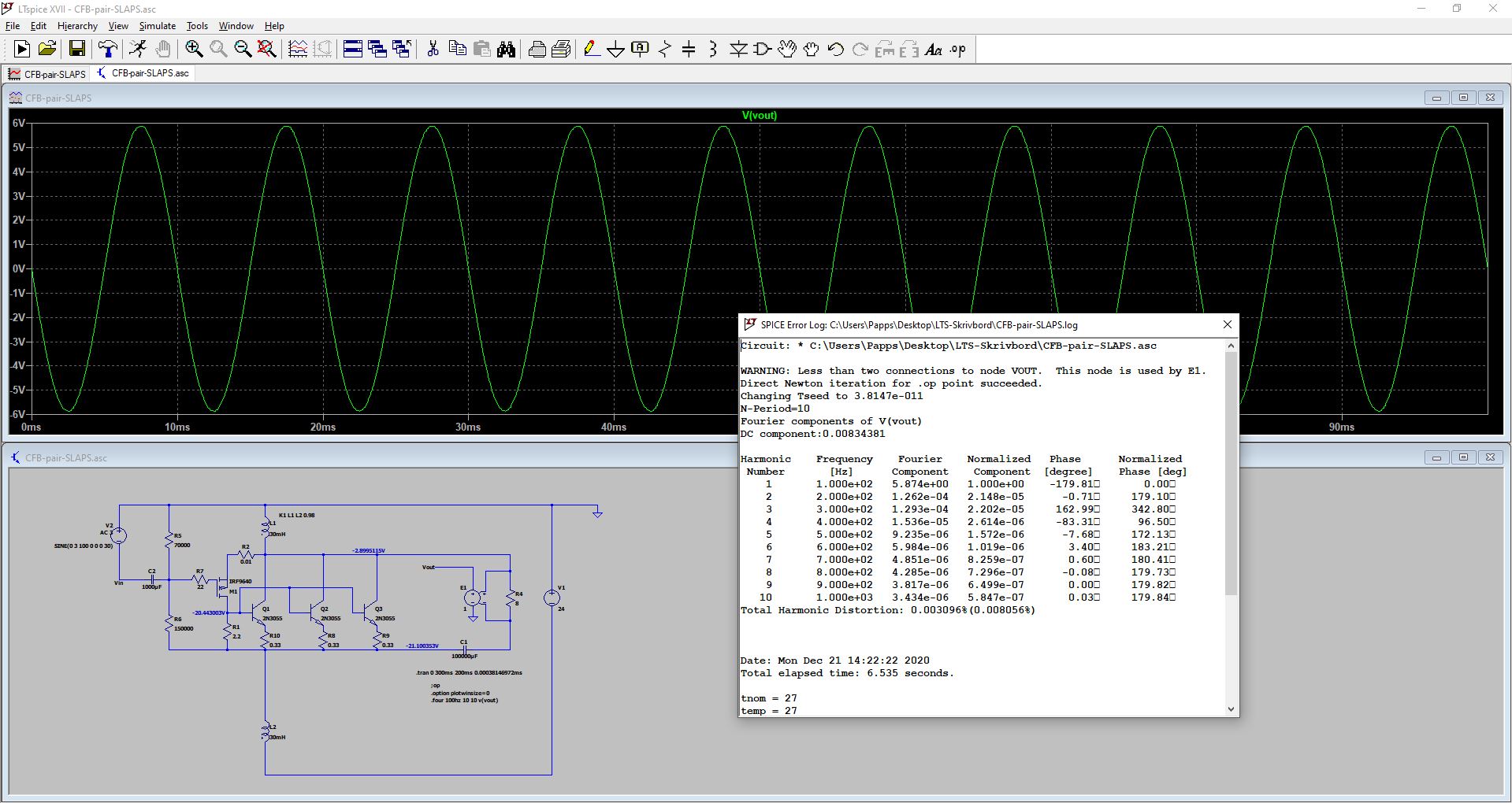

I tested a CFB pair in a normal SLAPS, and it does work nicely. This is with simple stock devices and no real optimization.
It will need some high frequency compensation as it does show a peak and some phase issues at a few hundred kHz.
I have not made a full XSLAPS simulation yet, and personally I prefer a more simple single Mosfet setup over the CFB pair version.

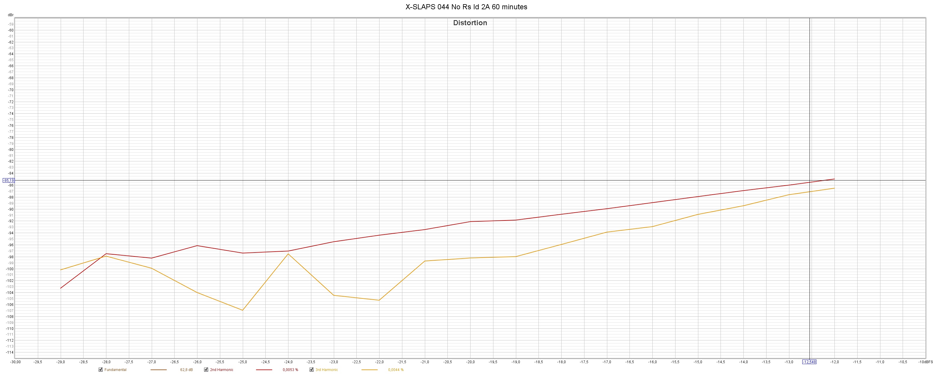

IRFP044 on the other hand, proves to be stable .
Starting at Ids of 2010/2003 mA with Vgs 3.364/3.391 V, they increased to 2039/2024 mA with Vgs 3.333/3.365 V after 20 minutes.
I then did a re-calibration so that the Ids was 1993/1993 mA with Vgs 3,333/3,365 V.
Still after another 40 minutes (60 minutes total) Ids are 2000/2000 mA with 3.325/3.361 V.

So I'd would say that X-SLAPS with IRFP044 is possible to match after 20 minutes.
Here's how the IRFPS3810 and IRFP044 measures (still not matched other than low current Vgs matching) after 60 minutes, still no Rs.
IRFPS3810:
IRFP044:
So at 1 W (that's -23 dB input level) IRFPS3810 has 2nd/3rd HD -90.1/-93.6 dB and IRFP044 -96.6/-105.3 dB.
And at 13 W (that's -12 dB input level) IRFPS3810 has 2nd/3rd HD -80.2/-73.8 dB and IRFP044 -84.8/-86.5 dB.
So I'd say IRFP044 is a winner, it is matchable and will most probably have better HD levels (about 10 dB according to above).

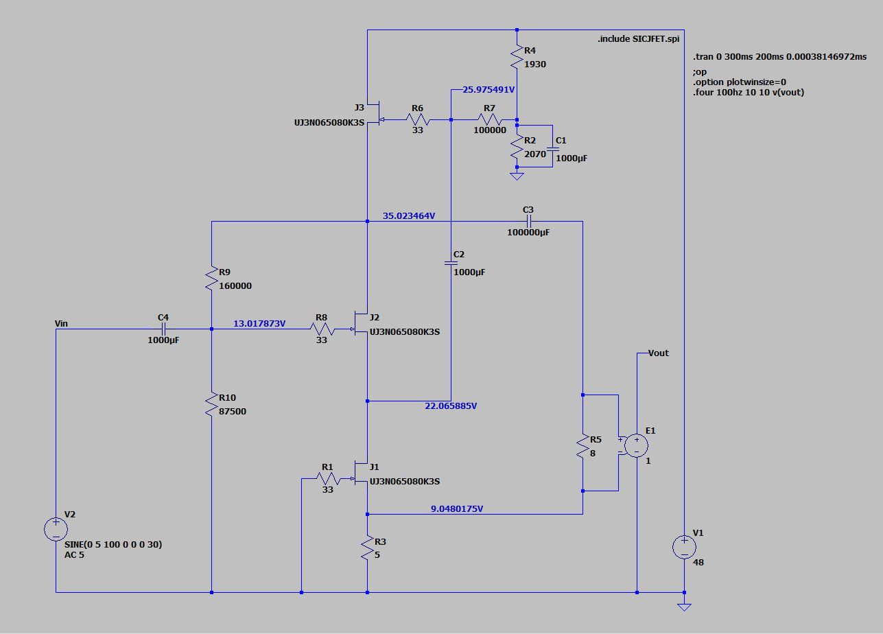

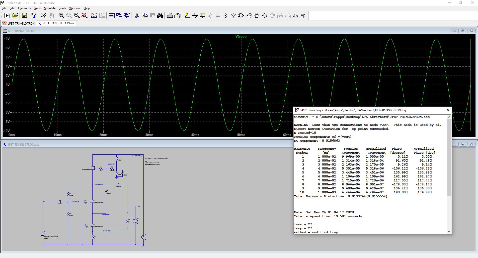

This is the closest non-inductor version of a SLAPS I can come up with.
It is a simple version of the Tringlotron. It can have so much positive feedback in the feed forward error correction that it gets a negative output impedance.
Something similar to this design but with Nelson Pass SITs could be a lot of fun. :)
It does have its drawbacks though. The available output voltage swing is very poor compared to the inductor loaded version. It is prone to high frequency instability (it is very very fast already with normal Mosfets) and it needs close matched pairs of devices closely mounted on a heat sinks for close thermal tracking. Lots of heat for comparably less output power then the SLAPS or XSLAPS.
Several complex versions of the Tringlotron has been explored in the Solid State section of this forum and TubeCad has covered the Tringlotron several times. But I have never seen it in the Pass section, even though it is novel way to incorporate true feed forward error correction (not a cleverly hidden negative feedback) in a reasonably simple design with a few mosfets, SITS or SIC Jfets, lots of heat and a beefy powersupplies (all hallmarks of Pass designs, which is why I post this here).
