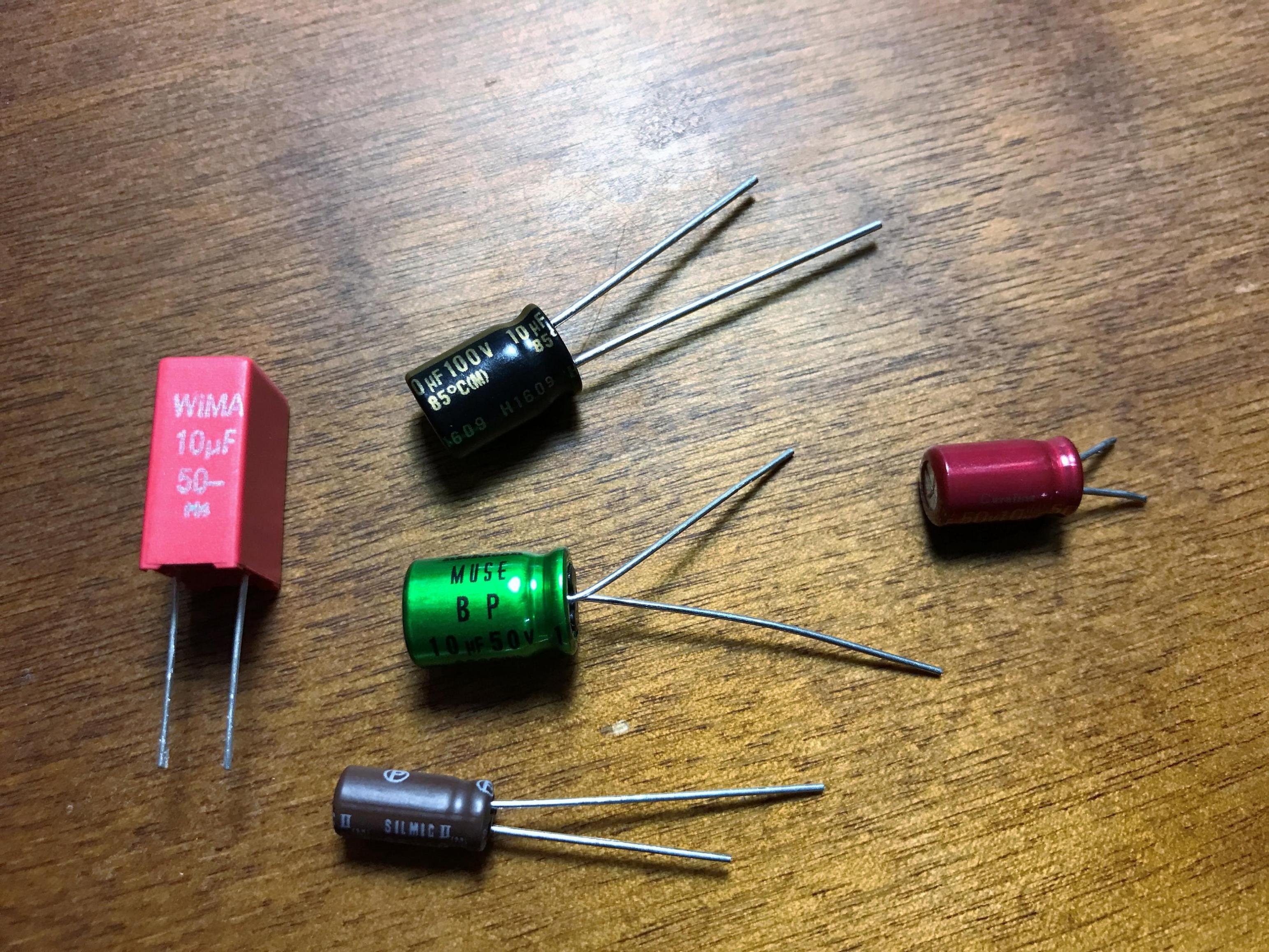

But for coupling caps, I don't know, I don't trust those smallish caps and prefer NP/BP. In my ears, some vintage NP/BP is equal or better sounding than Black Gate N.
Actually these mks2 caps are not so small , 10uf/50v plastic is going to be at least same size if not larger than an 10uf/50v electrolytic.
I cant say I compared mks2 with other polyester caps, it's just that mks2 has 5mm lead spacing and is available at mouser/digikey. 600v coupling caps will be way too large and more expensive. I would be very happy just with mks2/ MKT370/mkt470 or other ones or even np electrolytics like nichicon es.
I think these are the candidates for coupling caps where space is limited.

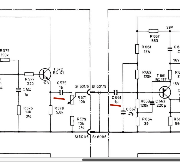

My has 50Kohm input best for 0Db on 20hz 1.6uf .

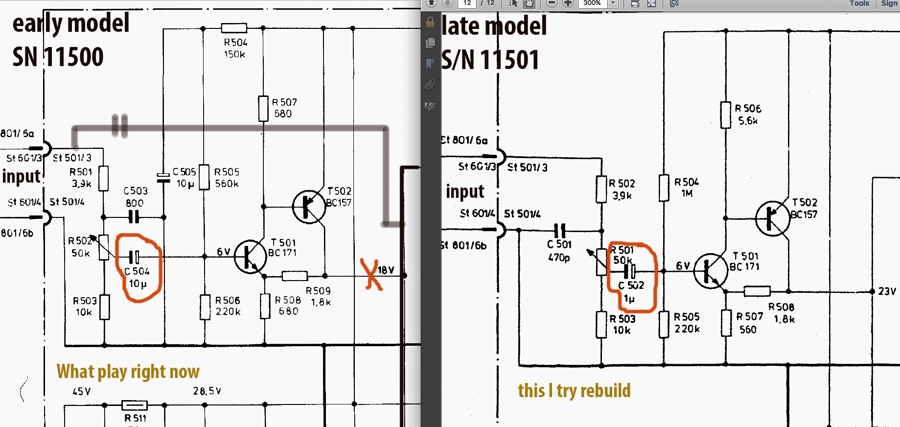

Other strange things amplifier the same on early and late models Braun but different crossover and preamps for crossover with the same frequency cut . Also different coupling caps on old 10uf on newer model 1uf . I play music on old model right now .
On my old model one time I bypass preamp for crossover like I show on schematic and sound much more fat, less compress like 2 times , more real then with preamp . For example if play one speaker stereo sound not full like two speakers together side by side , then I bypass preamp one speaker start sounding real like two speakers together .
May be not so good preamp ? I use DAC with 50ohm output
If it’s a coupling cap you can use a larger value , instead of 1u u could use 2.2, 3.3 or even 10uf. It is not the best , some will say that the amp will be more sensitive to noise, radio or cell phones....
I try without input coupling caps play music , any shifting on, off electrical devices in home make big pulse from speakers .

Use a film capacitor. 2u2 to 4u7 will be more than large enough.
You can't parallel a larger capacitor with a small one to improve response. The biggest problem is DA in the capacitor. That energy is lost no matter what you stick in parallel. So just use a good film capacitor. Even 1u0 is large enough, but you can get larger capacitors with a 5mm lead spacing. May as well go that route. I didn't suggest higher than 4u7 because the prices rise very quickly with capacitance. Decent capacitors will have voltage ratings of 50 to 63 VDC.

So on schematic 5000UF capacitor for LF and MF amps .
Bridge B80C5000 , may be get new one w'll be better ?
Sounds like maybe some of the Wima mks2 would work for coupling perhaps?
The 4.7uf version has 5mm spacing on the leads, is fairly small.
Yes , thanks phase , about MKS2 tell me asuslover Two times in the same place is not casual.Sounds like maybe some of the Wima mks2 would work for coupling perhaps?

Hi Pashka,
I would leave both capacitors in circuit. Some other products don't have coupling capacitors. Their designers should be shot (several times).
Those film capacitors are fine for signal coupling. I've used them often and have tested them on my HP LCR meter. They are a lot better than an electrolytic capacitor.
-Chris

fyi, i used a 1ufd/63volt film cap in an input cap that called for 10ufd/25volt ecap....bass was tight and fast...
It possible then speakers not play lower 50hz . A lot of like this .
1uf cut low frequency , working like low cut filter , for many speakers this is good ,don't need play what can't play.
^or what is not in the program material in the first place...
years ago, i read that big coupling caps are good in the noise department, the same book never mentioned about bass response being better with bigger coupling caps...

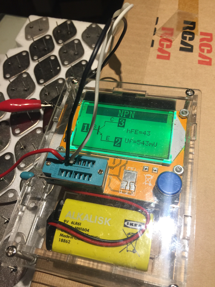

Finally today arrive original 2N3055 transistors from Germany old / new stock for my second set amplifiers. I want get match pair transistors but I dot- know what need match . It is possible match this transistor with tester what on picture (I don't know name) .??? How right match transistors ? What important hFE or Uf ? How close must be digit between transistors ? Thanks .
I got 100 x2N3055 original , If somebody need ones let me know .
Hi Pashka,
You need to match beta. Uf differences will be swamped by the tolerance of emitter resistors.
Because transistor parameters are extremely temperature dependent, the transistors must be at the same temperature as you measure them. That means allow them hours to equalize and then measure them without touching them in any way. Don't even breathe on them as that will throw out the readings. Why not set them up now and measure them tomorrow morning first thing?
-Chris
-Chris
Thanks Chris . I TRY UNDESTEND, what need match . I have chinise box , it show transistor and Uf and hFE . Yes I try test and heat transistor in my hand and parameters was change . Chris I reading right now this one , I just search with two uniq words "match beta" . A lot of new stuff for me , before I grow up i need know what parameters need match Uf or hFE or together and how perfect between transistors ? Thanks
