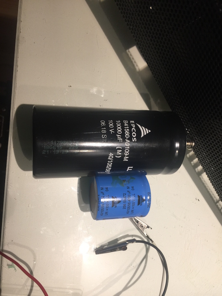

I changed capacitors gradually on one channel. About the beginning in the power supply put capacitor 560 series from EPCOS TDK, these are leaders in a sound and characteristics. The sound did not change, I tried to hear improvements and especially did not hear a difference, the sound was best before and after and I did not grudge the spent money on this capacitors and I went further.

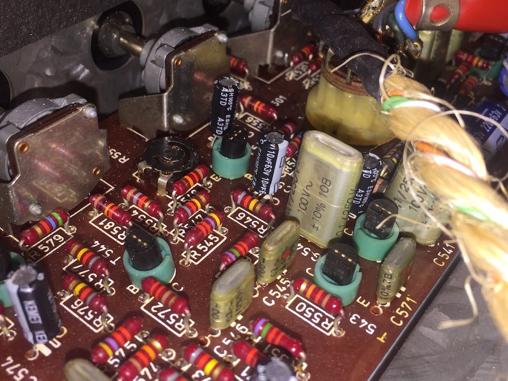

Two pictures .

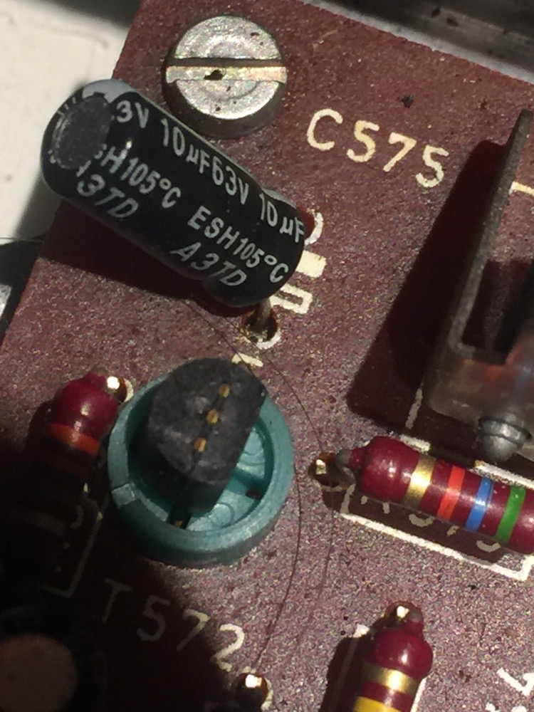

PS capacitors before and after .
Crossover board before recaps , you can see how bad trimmer resistors, and 10uf capacitors what was replays . Right now on very low volume music sounding best , and Yes percussion HF not is good , to small on low volume . Need get right one capacitors. Right now I have on HF amp silmic, KZ and Pana FC .

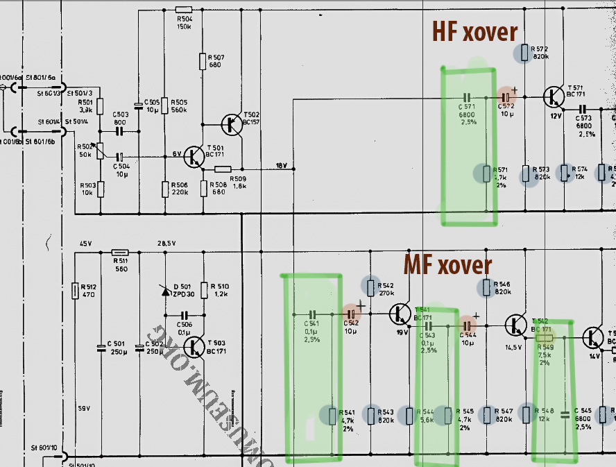

QUESTION:
Can I replace 10uf polar Aluminum Electrolytic capacitors for example with film MKS2 ??? On picture I marked in the pink color this caps , all these capacitors on signal twist polarity minus to a signal entrance. IS this coupling capacitors , can I replays with film not polar ?
2. Green fields showed crossovers. DO I need change resistors which are shown blue color with Metal Film or they do not influence a sound???

You can use any 10uf caps Pashka if I recall the Wima MKS 2 is not that transparent a cap & highs is not that good if you go MKP size will be big & space would be a problem. Another choice is to try Nichicon Muse Bi polar caps , they pretty good sounding
From the beginning you were told to replace the COUPLING electrolitycs with mks2(or other plastic mkt), mkp are way too large ..... , and now you are asking if is ok? even if you use audio electrolitycs(polarized or not) is still very good. But if you expect miracles to happen just because you replaced some caps you are on the wrong track. It is like having an old Kia and you buy the best tires you expect the car to feel like a new Porsche...

I made as told replaced the coupling capacitors with MKS2 like on schematic . I considered that couplings it is only those capacitors which stand between the crossover and the amplifier and also the beginning of the crossover. Whether the question consisted the condensers marked on the schematic in pink color is it also coupling capacitors ?
It is nice the your mucking around to learn & pick up the spirit of diy Pashka.
Like I said, your getting way ahead with too many mods at one go. I would leave the ampliifier part alone & focus on the XO first as this will affect the sound that goes into the amplifiers. It is only when you think that it sounds good to you then you move onto the amplifier tweaks. This is the best way that I can advice you cause if you muck around with everything it will end up a merry go round & you’ll be chasing at the tail of what went wrong.

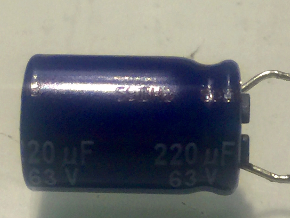

Somebody can identify these capacitors near KZ nichicon ?
47uf and 220uf
And one black one 10uf on board .
Thanks .

PS 10000uf make more vibration make more sound compite , not big different , but I hear ,much better, > Today I have Id , maybe try bigger caps for PS . Over all now sounding perfect . I want maximum realistic sounding system. Any small changes improvements w'll make me happy .

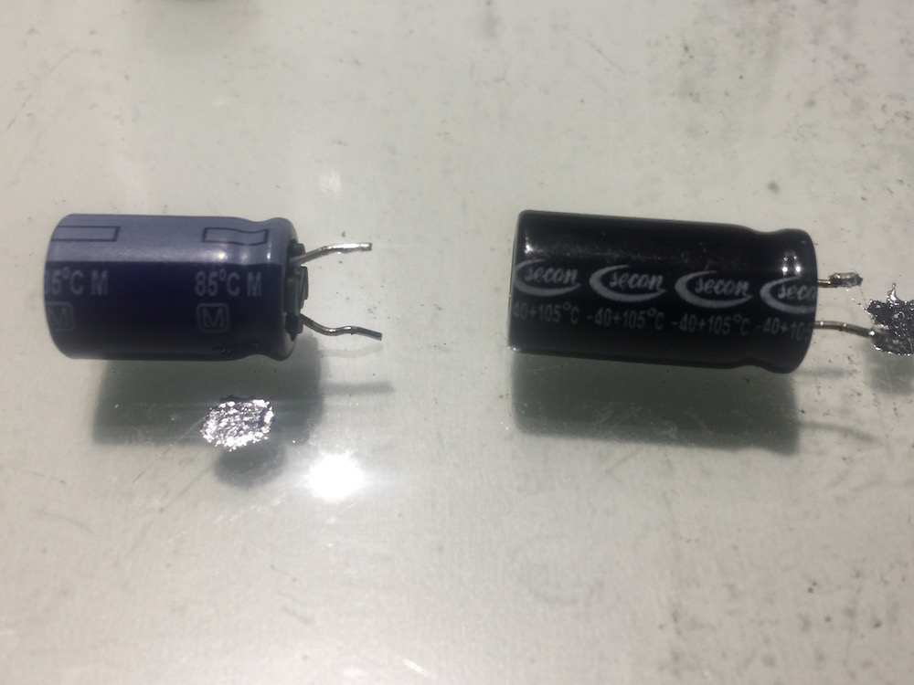

This is mine main set of amps first generation 10500 . it was recap in NY before I bought them . You can see capacitors what was and now on LF amp and XO.
I'm ask everybody , maybe some one know this capacitors .

I need know what capacitors on pictures

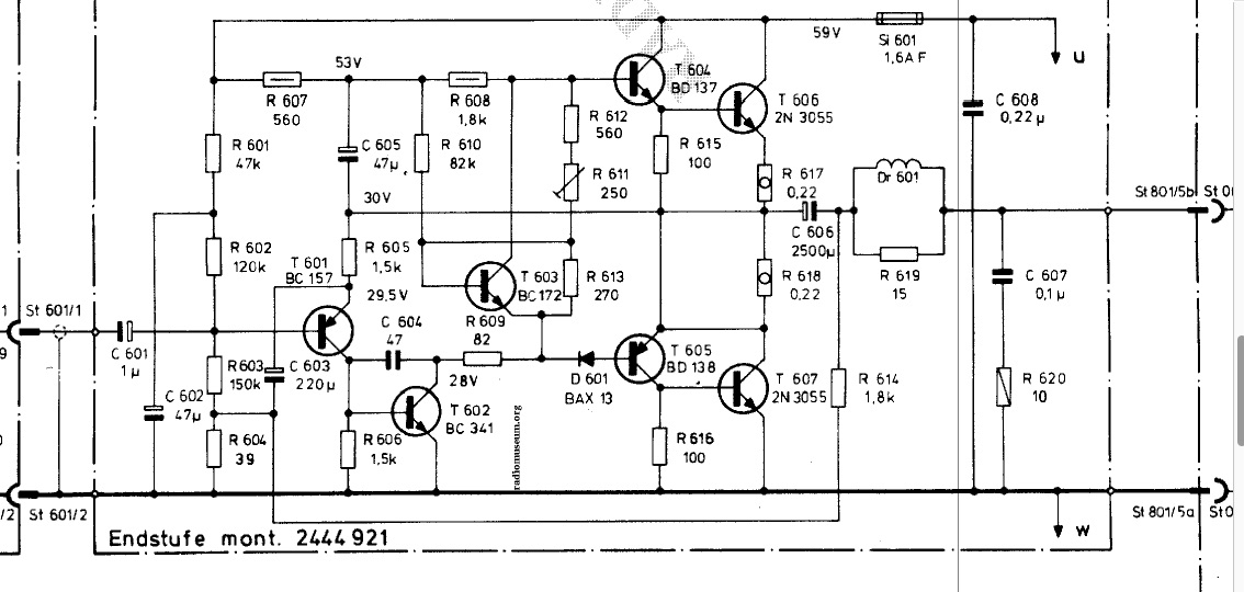

I sit and listen space music and I want to cry , not with music, and that I look at the scheme of the amplifier and I understand nothing how this works and more . By bad accident I left tweezers on a table then the amplifier on it put and got consequences:
Transistors burned down
T606
T604 605
Resistors
P607 P608
This is all this that I found. Replaced all burned-down spare parts turn on and T604 T605 and fuse burn again , I check again resistants between two amps good one and this and all was looking fine , turn again and the same story . T604 and T608 burn again. Instead of a BD137 BD138 I use BD139 BD140.
Where and what I need check , where can be problem ? This is my second set of amp Braun .

Is the orientation of T604/605 soldered back correctly Pashka ? Check D601 & R611 with dvm to see if they’re still ok. Situations like this are tough to debug. The short circuit may have damaged other transistors as well. Check also the continuity of PCB traces Pashka.
