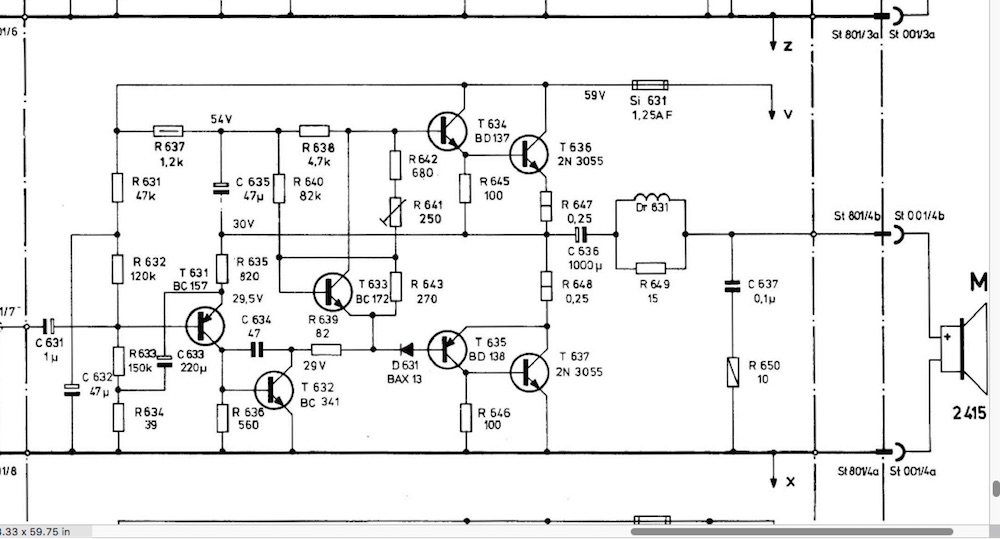

I would try and get the hfe with in 2 milivolts or less if you can even, but like anatech mentioned, the source resistors will have a tolerance of their own that will take over.
So you will need to find some 1% resistors also to continue the precision trend.
Thanks . So I need match resistors R646, R645 on board equal like 1%. What about transistors T645 T646 need match too ?
I order basket 1% resistors 3 days ego 🙂
That's a singleton amplifier. Yuk.

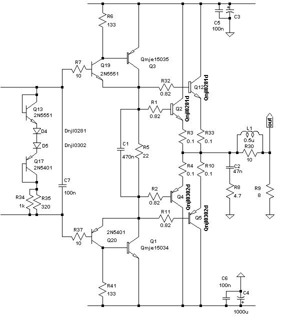

You don't have to match anything at all. If you have the time, look up the Symasym amplifier developed on this forum. Look at the differences between that one and the one you plan to build. That explains why things didn't make sense to you.
-Chris
-Chris
Thanks Chris . I look schematic Symasym amplifier , very interesting , for me with low level understanding I see no feedback on schematic , parallel double output transistors . This is all what I get .

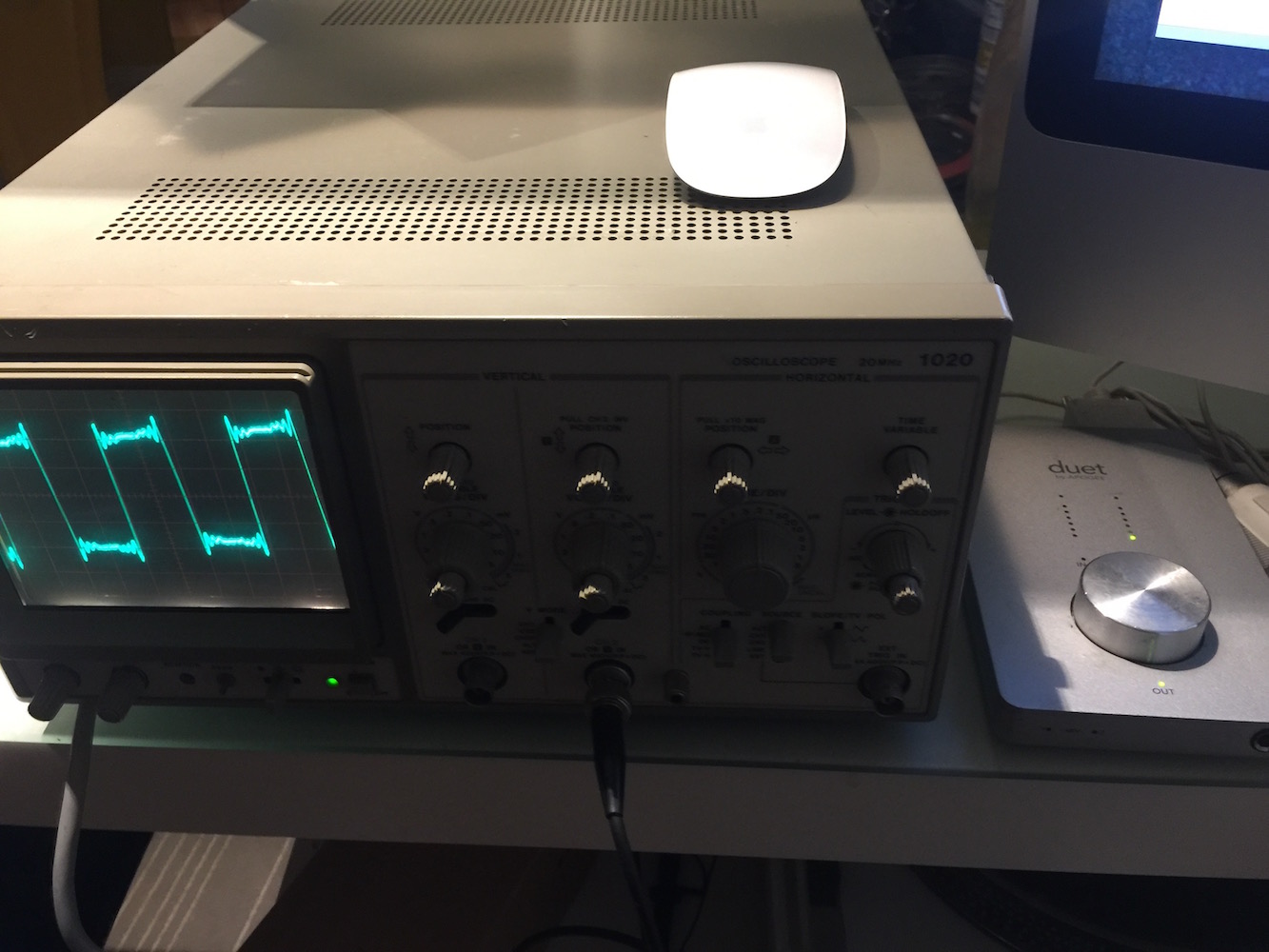

Can I use a generator from a computer through a sound card to use an oscilloscope ???

Your sound card can only take 5 Vp-p, or about 3 1/2 Vrms. It's risky measuring an amplifier straight in like that. If you had a THD meter, you could connect the monitor out to your sound card and look at the spectrum of the distortion..

maybe I did not explain it right. I meant to use the computer and the external sound card as a signal generator for the amplifier, I will look at the THD on an oscillograph.

You would be fine using a sound card to generate test tones. That is a good plan.

Thanks Chris . I found this circuit. Honestly, I do not understand anything in schematics. What I saw is the double output of the transistors in a pair and there seems to be no feedback. How to apply it to my amp to improve I have no idea. only desires.

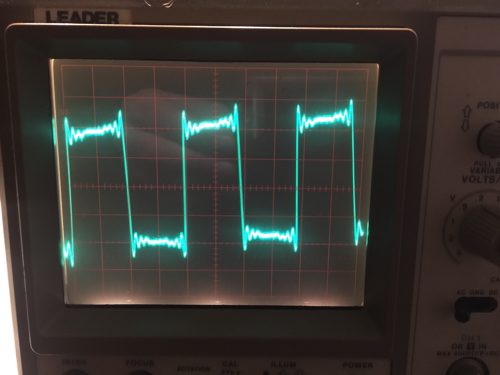

Ok. I try send square Wave signal from Mac thru sound card Apogee Duet to Oscilloscope .Is it normal looking or this is real bad one what show pictures ? Maybe need real generator something like Chinese from ebay ?
Thanks .
Hi Pashka,
No, that looks good. The sound card has filters that ring just like real analogue ones will. Normally you do not send square waves through a sound card. I have seen a lot worse too..
These days when I want a square wave, I use a pulse generator instead of a function generator most of the time. The rising and falling edges are a lot cleaner and you can even set the rise and fall times.
