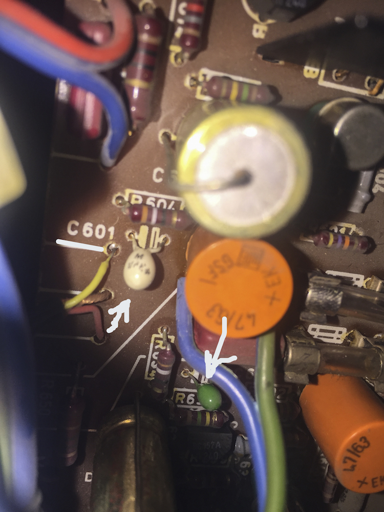

This one C636 and so on . so what you tell me .what capacitors are you talking about? what "orange EPCOP", which one you decided to replace ?
I would definitely replace C636, c655(same value or larger), c606( This one I would replace this with a larger value, more than 3300uF).
And I would probably take a look at all of those 1uf caps in the signal path, replace them with audio electrolytics (es, kz, silmicII etc) or even with mkt(wima mks2 etc).
Look like EPCOP best . I check amperage , nobody can bid .

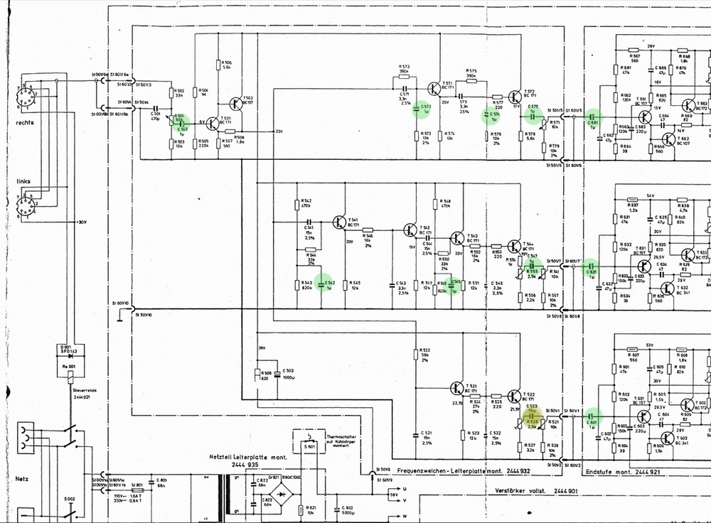

asuslover I don't understand with WIMA 1uf capacitor I can recap all 1uf cap crossover board ? Schematic show polarize capacitors .
Sorry , I'm just started and don't understand a lot. SOON i'll be best , I got all ready oscilloscope in my house 🙂
On schematic green color 1uf polarize capacitors , so I can recap all with WIMA or just between crossover and amp ?

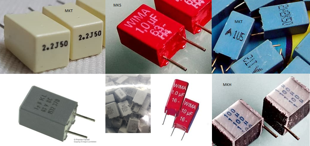

Replace with wima mks2 (film) or nichicon es(not polarized electrolytic )only the Coupling ( just between crossover and amp and before the crossover) caps , 6 of 1uf and 1 of 10uf.
BTW, for MKS to fit on the electrolytics footprint, you need to find those with a maximum of 63V rating. In this position low voltage rating is okay. 16V is probably the smallest I have seen.
The maximum capacitance for such a smallish cap will be 2u2. You can increase the capacitance from 1uF to 2.2uF with better result. But not the one in the crossover as that will affect the frequency.
The crossover itself will benefit from higher quality capacitors. I use metallized caps for my crossovers, never compare the result with electrolytics. But for coupling caps, I don't know, I don't trust those smallish caps and prefer NP/BP. In my ears, some vintage NP/BP is equal or better sounding than Black Gate N.

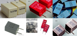

asuslover did you compare MKS2 with MKP WIMA or Vishay Roederstein MKT1822 or you thinks MKS2 this is better for now option for this amp ? I know in future I can play with different caps .
Other question voltage on capacitors , WIMA and other film caps sometimes has high voltage like 63v and up , is this better for sound , coupling caps whit high voltage like 600v ?
