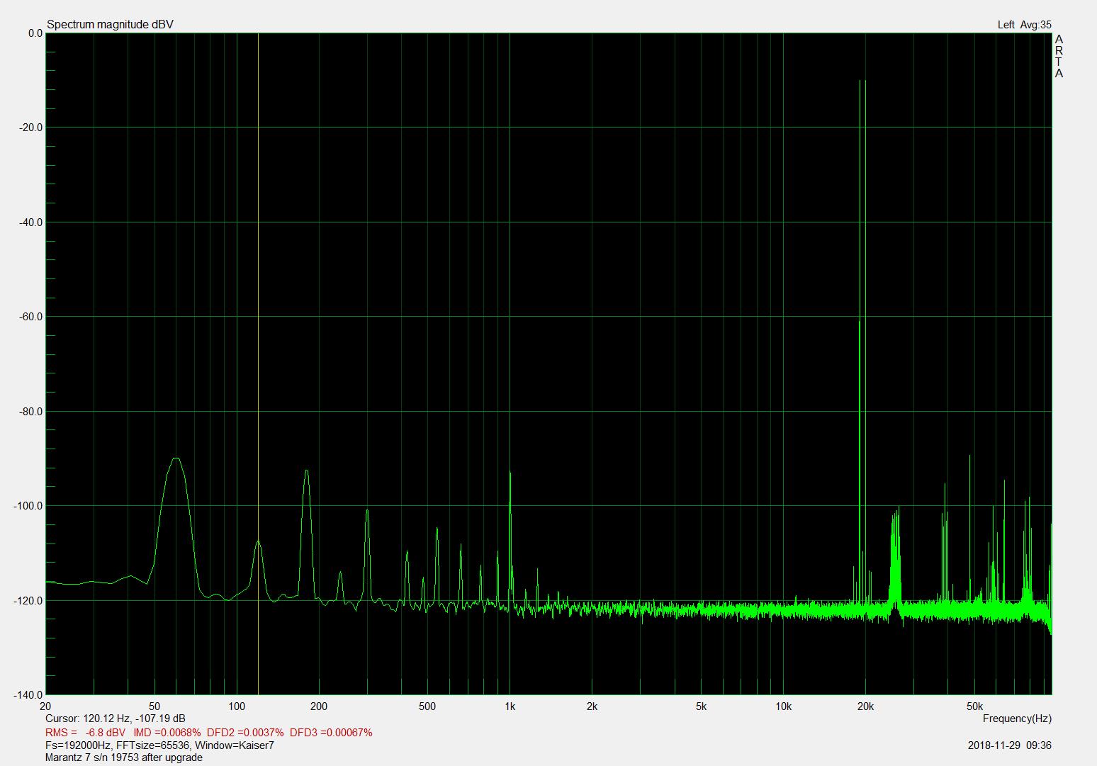

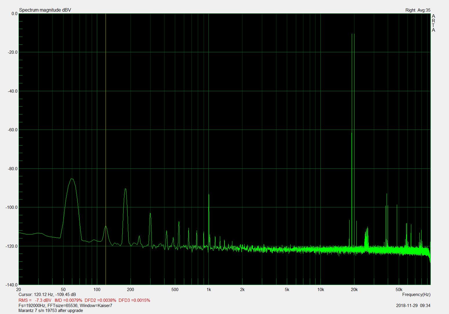

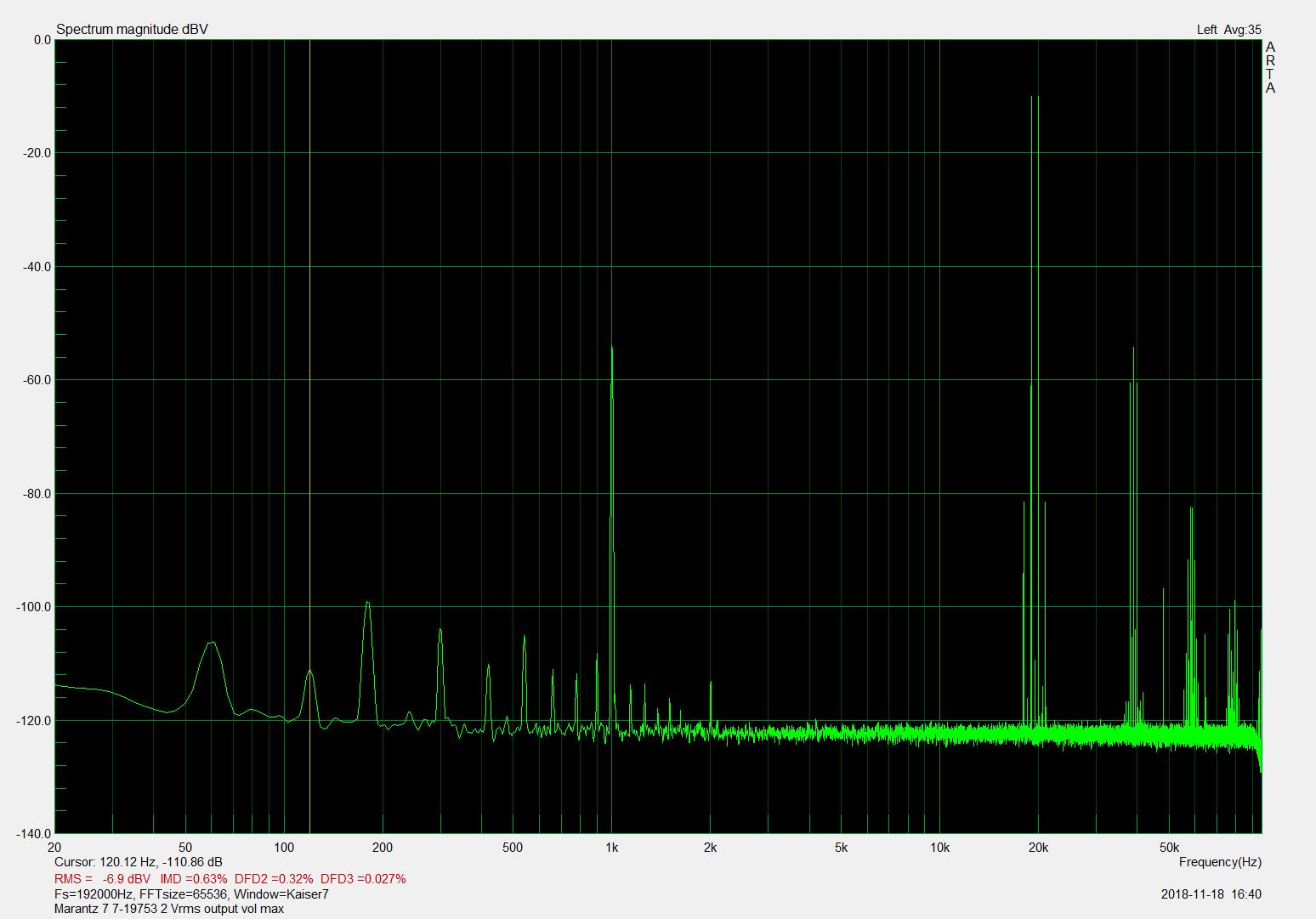

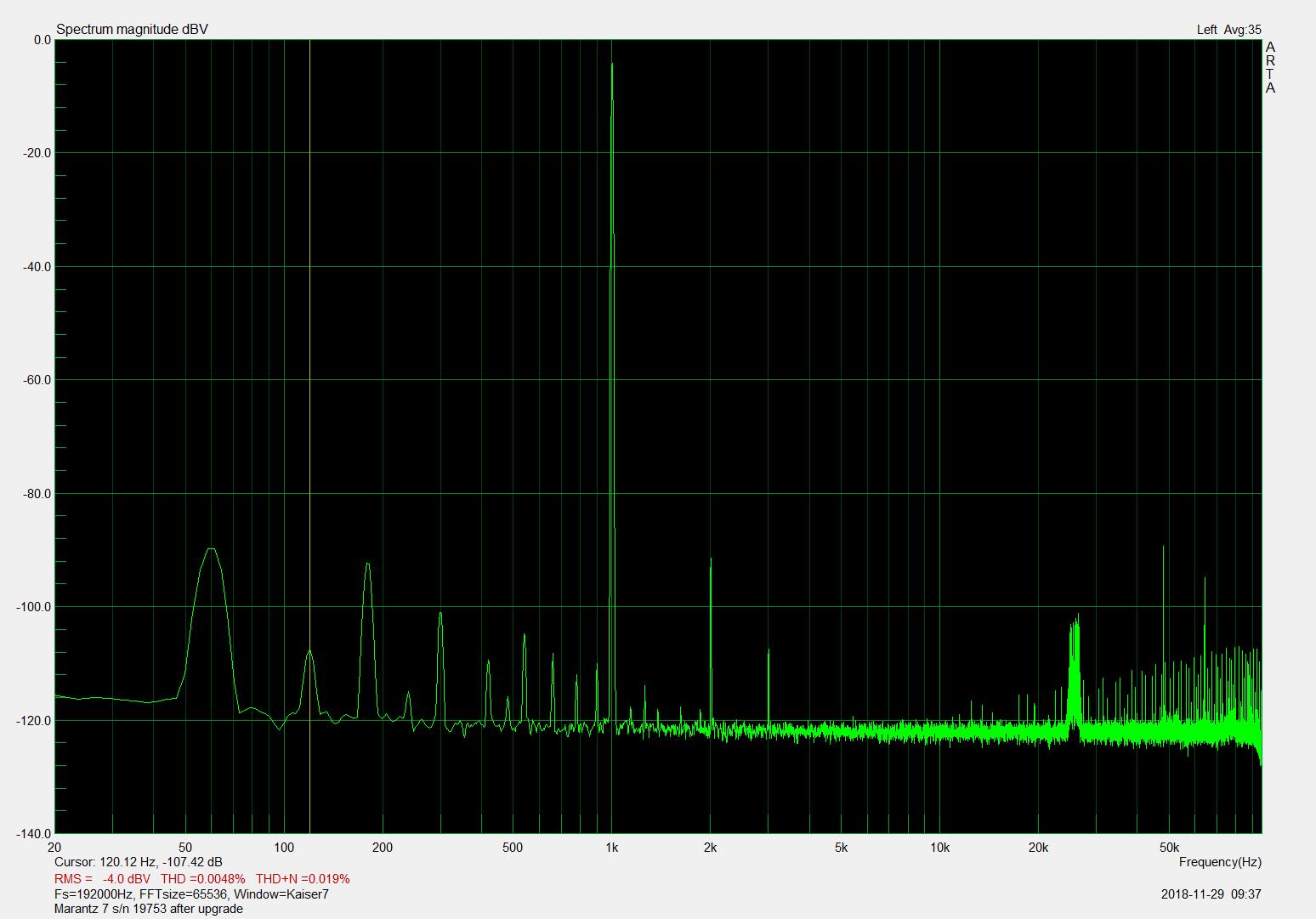

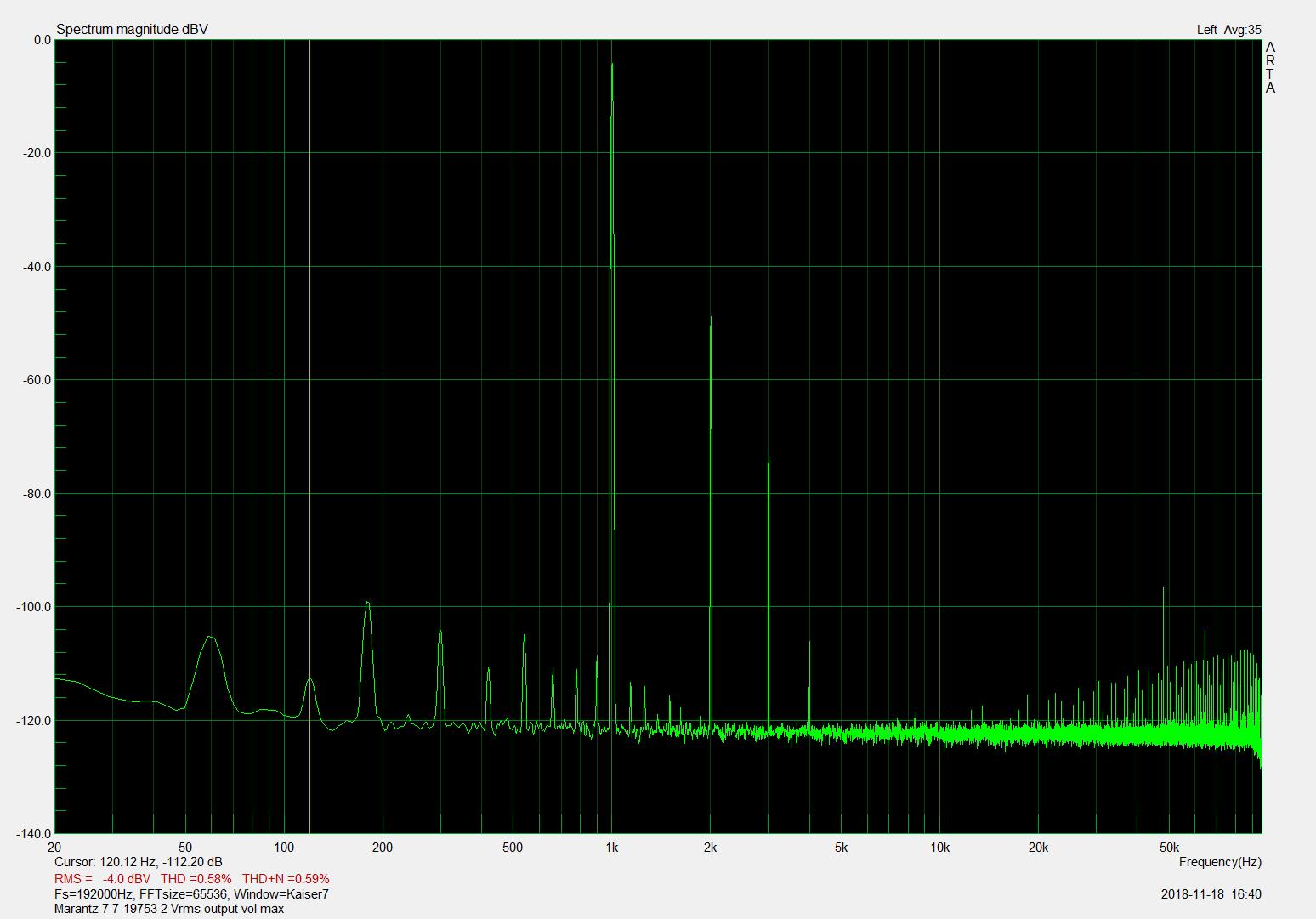

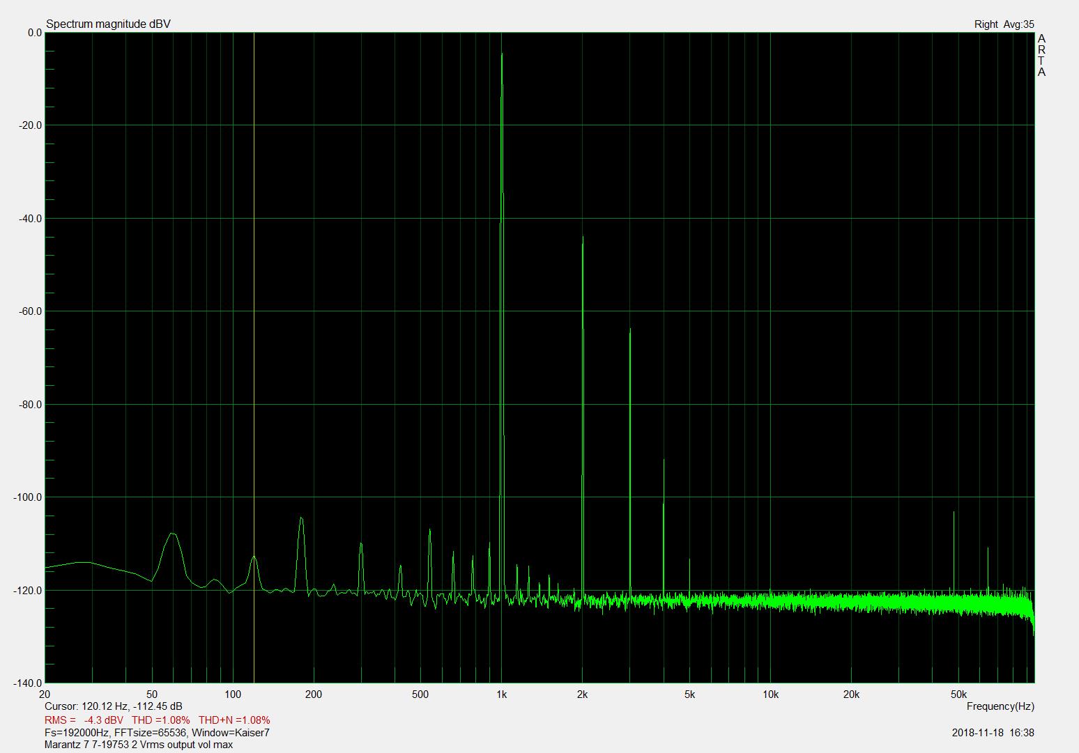

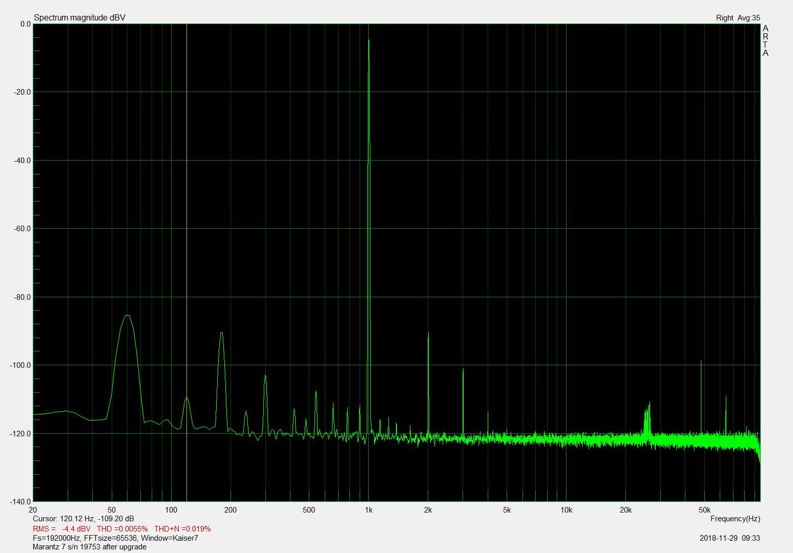

Case in point. I just rebuilt a Marantz 7 (a real one). Starting out the distortion measured over 1% at 2 volts out. After the rebuild replacing both resistors and capacitors, the distortion measured 0.0055%. A massive improvement. The customer called tonight actually, and he was annoyed that music from crappy sources sounded worse, but when pressed he admitted that good music sources and masters sounded a lot better. So when I asked him what he wanted done, he said he'll try to make up his mind. Previously the preamp hid all the defects because it really manged the sound going through it hiding the poor quality. However with the highs restored , the older music (1950's through mid 70's) couldn't hide behind equipment any more.
So, the rebuilt preamplifier now shows the truth instead of glossing over the bad bits. He listens to good quality music normally. I'm pretty confident he will choose the cleaner version of that preamp.
So you see, introducing distortion and noise might satisfy someone short term, or until they hear something really good compared to their current stuff. But reducing distortion and noise floor is always the right direction. The better capacitors do not have a sound (or minimal at best).
One further comment folks. Capacitor ESR is not the parameter that matters in the audio path. It is entirely pointless to make decisions on ESR except in maybe filter capacitors. What the most important thing to look for is called dielectric absorption. What that is is energy lost in the dielectric of the capacitor (= distortion, or having a voice for example). Unfortunately, good meters that do an accurate job of measuring dielectric absorption (or DA) are more expensive than the cheap meters that measure series resistance. So there is a cost to admission to that party. But wouldn't you rather be right than being hit and miss by chance?
Also, if someone is charging me to work on my equipment, I expect them to have the proper instruments to support what they are charging me for. Guesswork doesn't cut it these days. The better the equipment sounds, the more people will make the choice to listen to it. When you are dealing with cheap, "junky" electronics (example NAD 3020), all bets are off. But it would seem to be intelligent to take the path of improved performance (lower distortion and noise) than trying to colour the sound, maybe to hide the problems?
Here is the tests for the right channel of that preamp I was talking about. Tell me which one you would rather hear your music through!

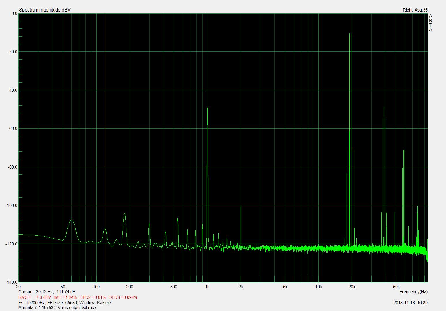

Sure, here is the left channel. I have IMD as well, they tell a similar story.
The rebuild included new tubes (Electroharmonix 12AX7EH) and replacement of the resistors and capacitors. The selenium rectifiers were replaced with silicon types. The main filter capacitors were surprisingly in good condition. I check the waveform across them under load with an oscilloscope. No leading edge "pips".
There was no change in schematic. It's a classic preamplifier that was well designed. I'm not going to second guess those excellent engineers. Therefore, if the same work was done to your 7, it would turn out the same way. It sounds much better now, but not as euphonic. That character is due to the carbon composition resistors. Terrible things.
I used to repair equipment with carbon composition because that was all that was available. 5% was considered high precision. 2% was just silly and we didn't ever see 1% resistors. We used to match resistors by cutting a notch into the side of the low value one and cut until the resistances were equal. Then seal it with a lacquer. Pretty barbaric, but that was what we were taught.

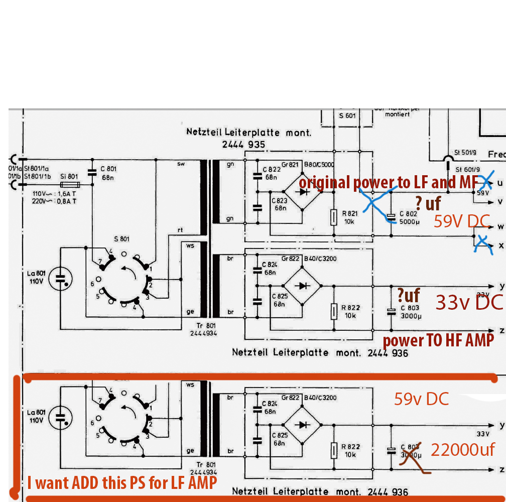

CALMART Thanks for help .
Yes I want add independent power for LF amp and change 5000uf to 22000uf capacitor (new transformer 200VA)
Original transformer got 2 output :
1. 59VDC to LF and MF amps.
2 Second one 33v to HF .
So what I know from internet :) for LF amp is good large capacitor like 22000uf . For HF amp better keep like on schematic 3000uf.
What can you say what capacitance capacitors to put on each amplifier will be correct?
What bridges will apply to each amplifier?
Can there be any other ideas on how to do it right and better ??? . thankс:worship:

the choice of psu capacitance is very much dependent on amplifier topology and how well their power supply ripple rejection ratio is...how well do you know your circuit? or you are just taking the anecdotes as to how adding psu caps improve things? then it is a hit and miss thing...
ripple voltage is directly proportional to load currents and inversely proportional to capacitance in the psu....
if you know your full load currents and know your tolerable ripple voltage, then you can determine the size of your psu caps..
in the 1980 Walter Jung wrote an article about PSU energy bank in the AUDIO magazine, i asked permission to repost that article here, but i got denied, the author has since then had a change of heart...
you can of course do as you wish, after all it is your amp.....

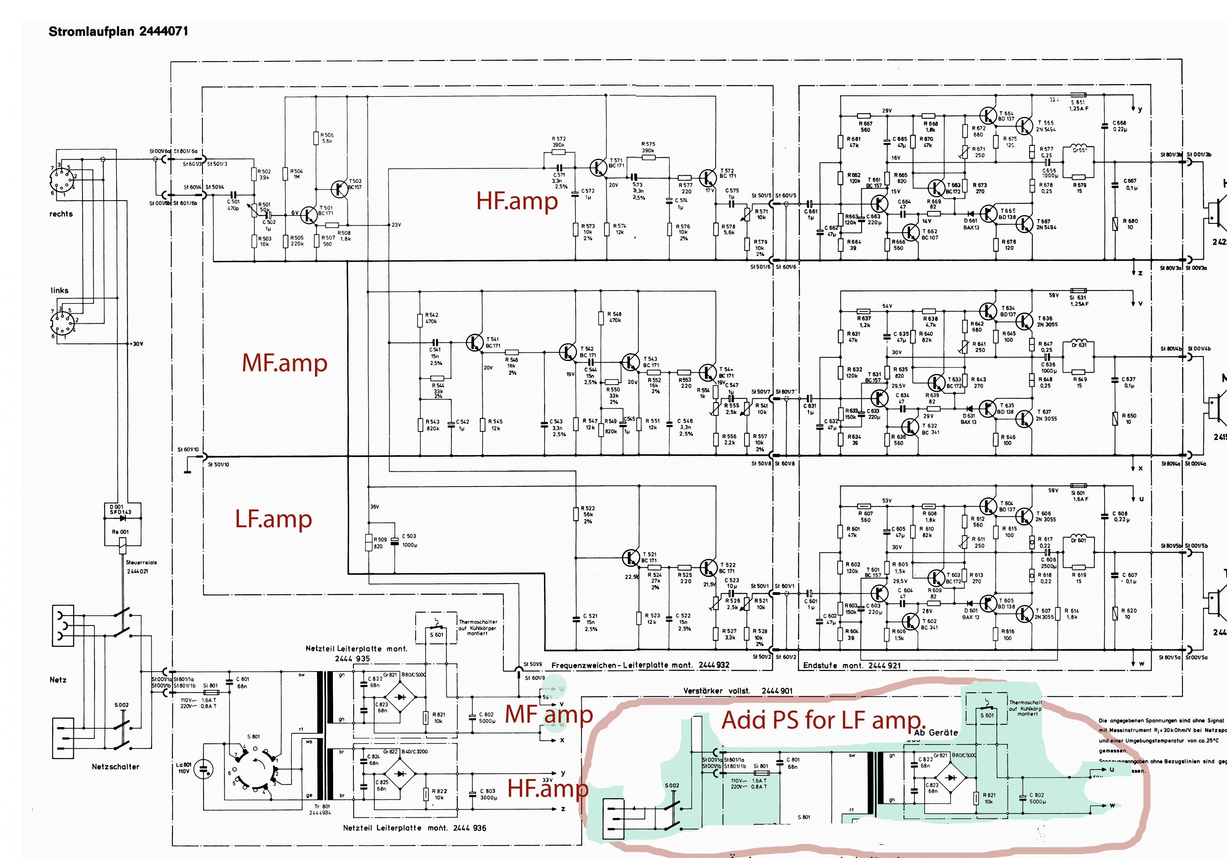

If I say the phrase :
"ripple voltage is directly proportional to load currents and inversely proportional to capacitance in the psu ..." after these words, any girl would be willing to spend time with me. :)True, I will not do this, I am not at that age, although I have a young soul.
I looked and I know the circuit of the amplifier, but no more, just looked and then my knowledge ends there. What can you say and advise for improvement. Amplifier circuit 70 years. I can hold a soldering iron in my hands. I really like the sound of everything that I had and I would like to squeeze the maximum.
This is amplifiers schematic . Thanks in advance for your help .

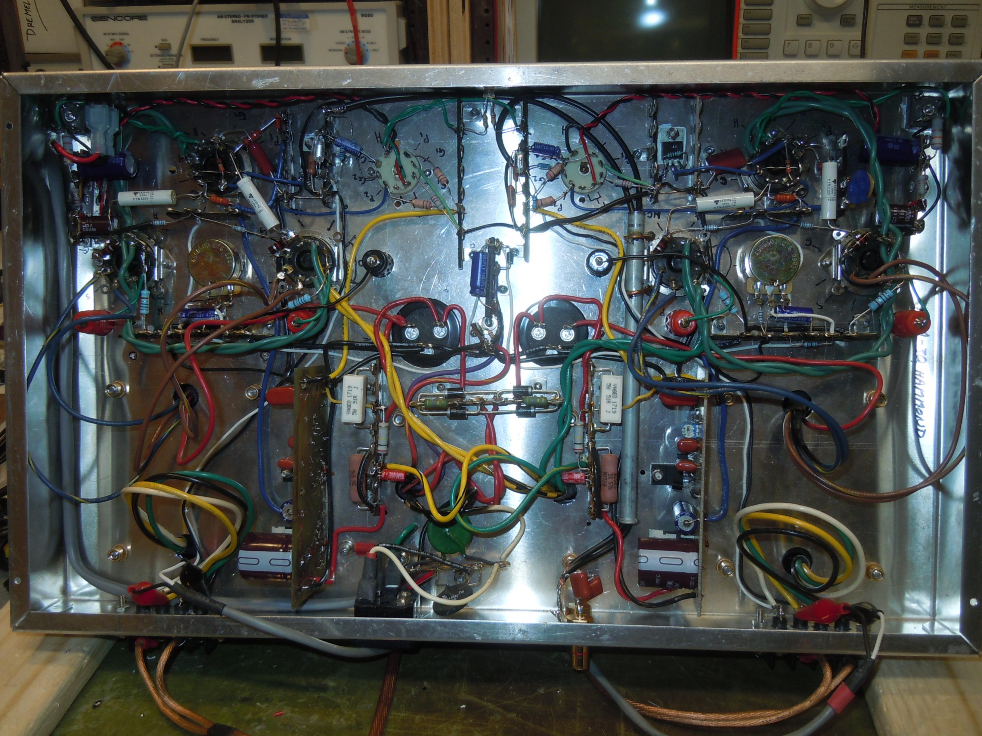

Here's a money shot of the prototype amplifier.
-Chris
Reasons why this can sound very good:
#1. The drivers. The tweeter and dome midrange look good.
#2. Simple active crossover designed for the chosen drivers.
I have saved the circuit (thanks) so I can make similar design for different drivers. The transistors are not the best, but you cannot just put different transistors without changing the design. Parts values should be precise in a crossover filter.
Resistors on the filter circuit could be noisy. Changing to Dale RN60D may improve things if not too expensive.
Power supply can be more regulated using Capacitance Multiplier. This should give huge effect I believe.
The orange capacitors on the filter seems to be Siemens which sound good. The yellow axial one (in amplifier bootstrap if I'm not mistaken) looks like a Frako and if so hurry replace it. The 3 amplifiers use the same value of bootstrap cap (47uF) which they don't have to. Low ESR is a good thing here that axial metal cap alike Kemet (tantalum I guess, usually around 10uF) sounds very good.

On the rest you are absolutely right, about not adding capacitance on a power supply just for fun.
You do have to measure the maximum current you have on your supply, and calculate the capacitor value according to that.
Just stick with original values. Smaller capacitance is good to HF, higher capacitance is good to LF. For any given brand, the higher the capacitance the more expensive and the lower the general quality (higher leakage current, higher dissipation factor). So choose the smallest that can deliver required frequency. If you think you need more bass then you may look at some capacitors to increase the value (input capacitor, output capacitor, PS capacitor).
Lets say you now have 5000uF Silmic II, will 22,000uF Silmic II an improvement? Probably, probably not, but surely not if the brand is 'cheaper'. Imagine how much money you need to spend for 22,000uF Silmic II :D
Frako is a horrible capacitor. My favorite axial cap for output coupling is a Philips with blue transparent sleeve.
For power supply, I just pick capacitors with lowest dissipation factor. Cheap one (and probably 'fake') is Nichicon KY but I choose the 100V rating (could be a little expensive) because 100V is the sweet spot for the lowest dissipation factor. A great value for money is the new blue ELNA (such as the RE3 or REX?).
Tube guys prefer something 'slow' (slow recovery), engineer type may prefer fast ones. Both have advantage and disadvantage, but the best of both world is in the right threshold of Vf and Ir. The Shindegen suggested by Sumotan falls into this category and can be easily found and cheap. It is very smooth as he said.
Any amplifier will benefit a lot from better power supply (especially with single ended topology like yours which has low PSRR). Some people like raw PS, some like regulated one. Both have advantage and disadvantage. Best of both world is probably a Capacitance Multiplier. The output voltage will be lower but I think still will do.
