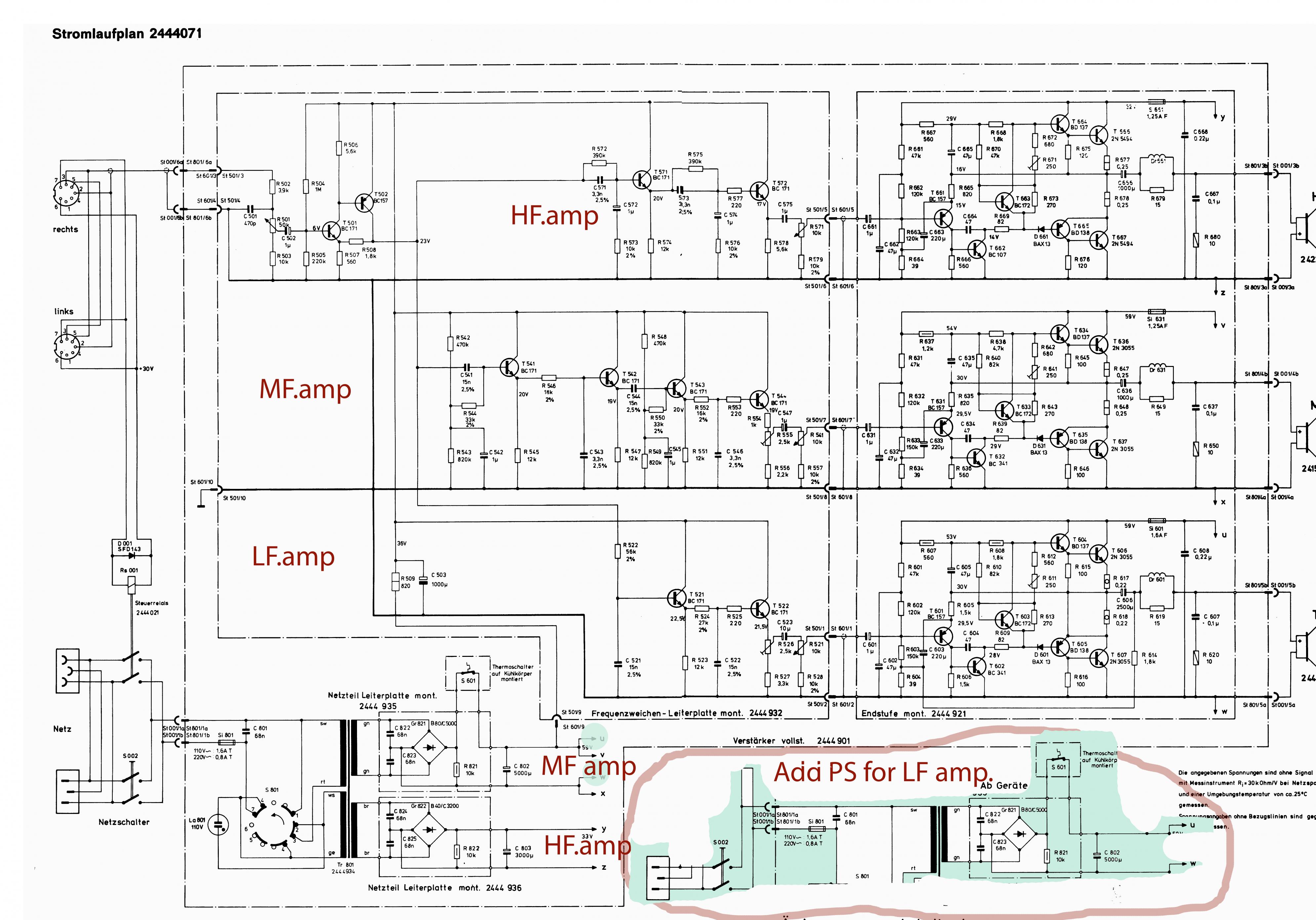

The broken amplifier did not touch yet. Changed one capacitor uf C633 in the power amplifier MF, put Panasonic of FC. The sharpness and all charm of KZ disappeared. Panasonic sounds neutrally. Need time for Panasonic has to burn through but the difference is heard at once. The C603 capacitor seems to me has the greatest influence on a sound than other condensers as well as changes in the crossover is minimum. I do not understand the scheme that occurs, but here obviously the capacitor is involved as feedback and all sense of a sound in this piece. Also P635/636 resistors influence strongly. Likely it as that is calculated, there is no wish that the phase was turned or other negative changes happened, but on the scheme of the LF amplifier resistors 605/606 same as on MF of amp there are others. Attached the schematic On R605 amp MF the 620th, R606 the 560ohm On R635 Amp LF 1.5K ohm, R636 1.5Kohm
I removed on LF of the amplifier feedback the resistor R614 long ago, the sound on LF became with bigger information less pressed down. It is more than reality.
I want to understand that as well as that it is better to change to a sound to the best on this site of feedback schematic . As as influences and changes a sound changing resistors and capacity of the capacitor in this feedback. There are any ideas?
Do you happen to have extra KZ on hand ? Parallel another KZ & listen again
Thanks for participation and interest. If not you I talk to yourself here>🙂
Do you mean increased capacity UF on LF amp ?
It is interesting whether it is possible to mix Panasonic in parallel with KZ.
With KZ the guitar sounds just super, all string instruments, the only thing sticks out bad top of mid frequencies. On the record Etypejazz - You Are the Sunshine of My Life (Album reference vocal) studio defect at the beginning heard noise of microphone with KZ distinctly, with Panasonic noise was gone.

What is 39 ? (With R614: Gv = 1 + (1k5||1k8)/39 ~= 22.0 dB
It is very interesting. But I noticed that the sound of LF changed not to much on loudness, without resistor feedback R614 began to sound corporally more, openly, with a big weight, more natural , realistic more bass. wight. All instrument have more body . Overall tonality ok
Connected back the R614 1.8kohm feedback resistor. The sound became with the cut-off bass, added power from LF crossover, the sounding not change , more compress then without R614 . I test how sounding one speaker without and with R614 . Big difference . On stereo then 2 speakers without R614 sound full and complete .
Yes increase un LF amp. You said KZ no lows right ? Hence my comment, add another KZ & see if bass improve.
Yes sound LF speakers with KZ play looks like less information coming thru this capacitor . Compress sound on bass , soft 50-60hz no information upper bass , and ultra low .
Right now I'm increase capacity on C603 LF amp , and MF amp C633 from 220uf to 1500uf with Panasonic FC .
I dont know what is changes electrical , but after test with feedback resistor this sounding perfect and realistic .
While you are trying caps, why not change the bootstrap cap also? It is the 47uF (C605@LF). Going higher capacitance theoretically will lower distortion (but with small capacitance you can get good quality cap).
BTW, 39 Ohm is the gain setting resistor (Rg). Feedback usually consists of two resistors (Rf=1k5 & Rg=39) and a cap (220uF). I have never used the extra feedback resistor (1k8@LF) with this topology. I expect it will make better control of the woofer but you don't seem to like it.

Now turned on in parallel Panasonic and Silmic II on amp MF. Let will be fried together. I don't have other Caps . I need get more info what next I need to buy .

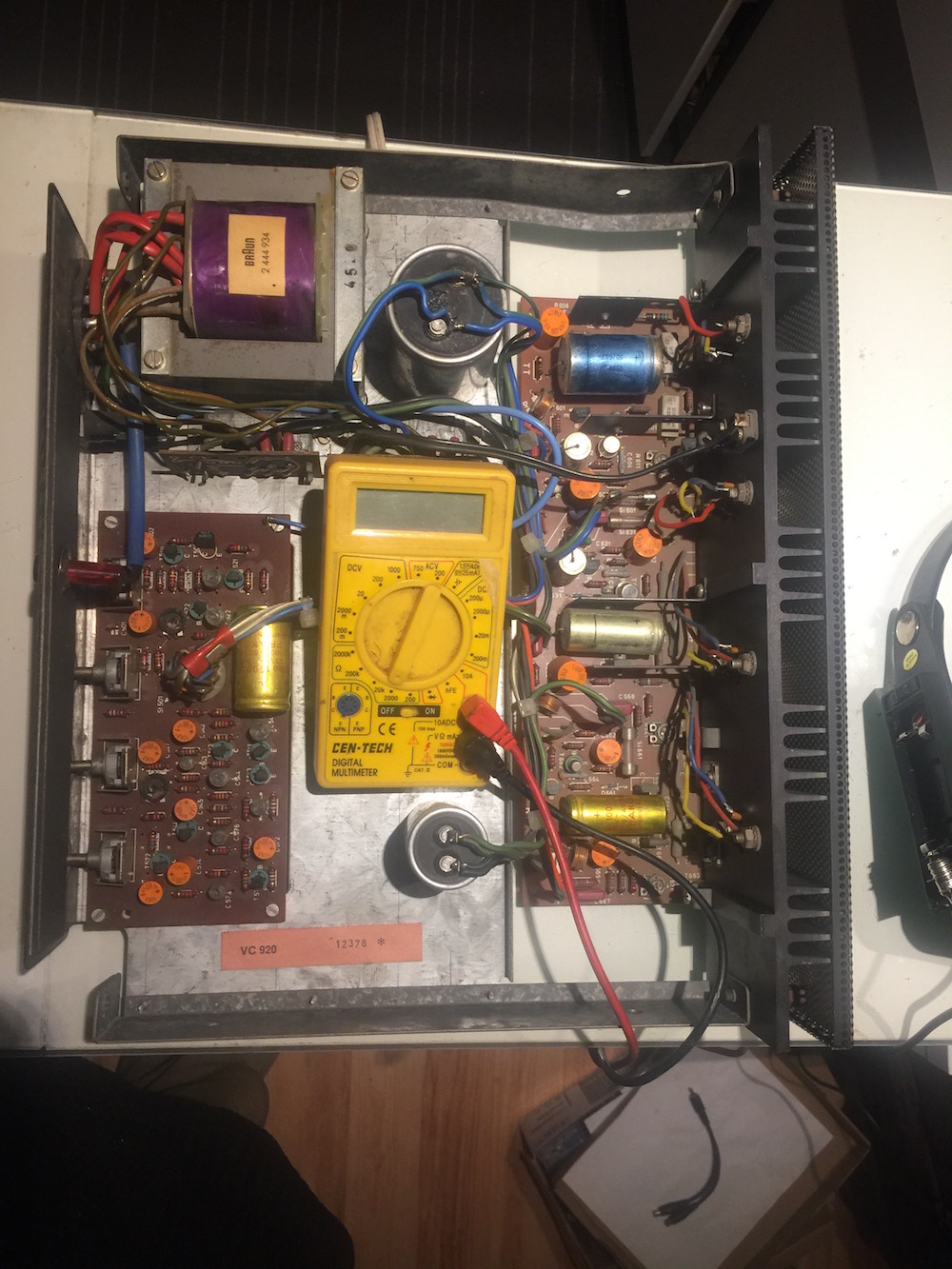

Is the orientation of T604/605 soldered back correctly Pashka ? Check D601 & R611 with dvm to see if they’re still ok. Situations like this are tough to debug. The short circuit may have damaged other transistors as well. Check also the continuity of PCB traces Pashka.
Thanks .
Yesterday rechecked all details in not the working amplifier. Everything is OK. And in my head your words, "Is the orientation of T604/605 soldered back correctly Pashka ? ".
Now looked and saw that mixed two transistors in places. BD139/140. Now I will correct, it is sure that will work.
Sorry , I was wrong . still the same problem burning BD139/140 . Is it little bit crazy .

One amplifier from second set still not working .
Burning all time BD139/140 T604/605 .
Transistors output 2N3055 OK .
I don't know why . Stock .
