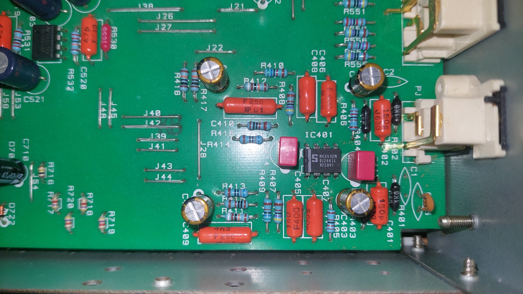

Hello all, bit time passed since last posting about modding Rotel's, got my hands on a new project, one RA-06, the one problem it has is the volume pot, I think its an Alps motorised one, even on minimum volume, you can still hear faint sound at night in one of the speakers, will cleaning the pot with deoxit help? maybe that's another problem somewhere else in the amp?
Also, I am loosing my sanity trying to find what kind of caps are the red ones that Rotel put in there, they are all low value caps in the PF/NF range, in all my time I have never seen them anywhere, any info on composition or maker?
The red ones in the photos

Hi Christian,
The caps are most probably PS, Rotel used LCR Components types for many years. Not sure if these are.
In the volume pot, it sounds like the wiper does not quite reach the end contact pad. You could try deoxit, but I doubt that would fix it.
