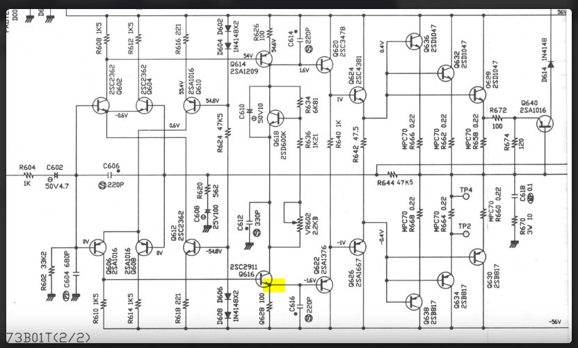

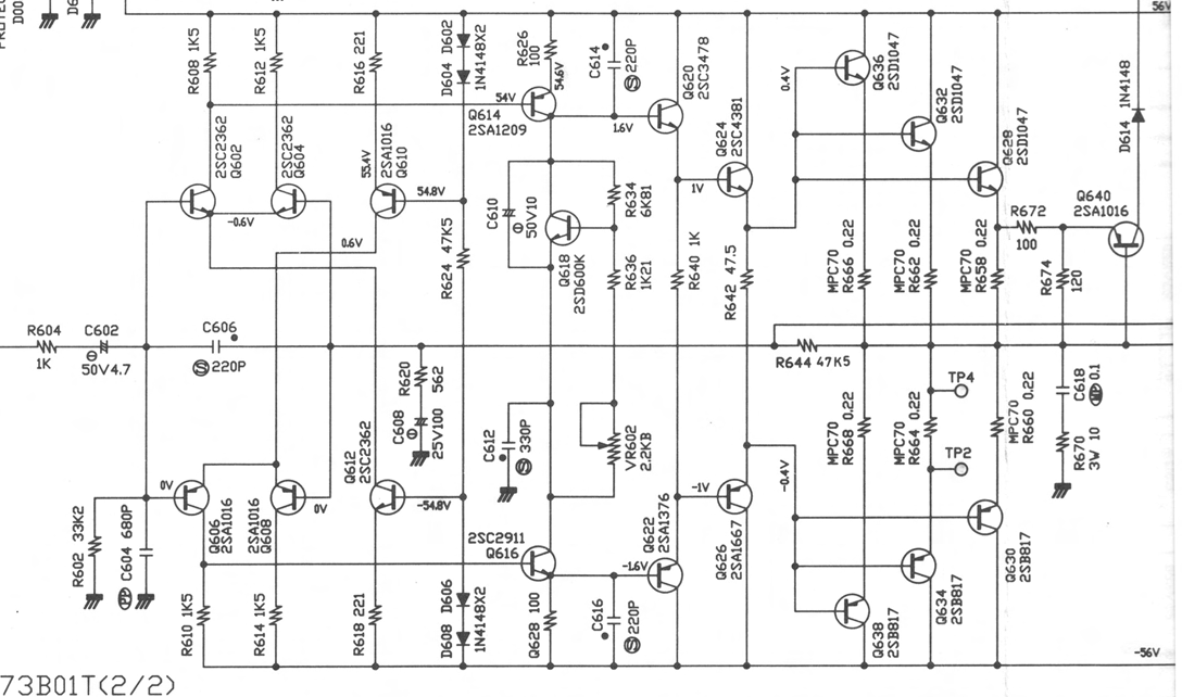

Hello all diyAudio readers of this thread.
With the Silly Season
rapidly approaching I thought that a little brain teaser could maybe be helpful to counter all the silliness.
This is the schematic of a RA-980BX power stage. There is a serious flaw in the drawing - can you find it?
(I only posted the drawing of the right channel, but the left schematic has the same mistake so that wouldn't have helped you.)
(Ok, one hint: IF this schematic had been correct, the amp would immediately have blown.
First prize for finding it is - nothing.
Second prize is double that.

Lol!
Yes, caught it also.
Had it actually been connected that way, new output and driver time + more. Resistors also and possibly all the way back to Q614, Q616.
Drawing errors are pretty common. Component designations can also be wrong as well as values. They used to proof read manuals, I don't think they do anymore. Many are drawn in a way that is very difficult to follow on top of that.
Nice catch. Knowing how it is supposed to go, your brain just fills it in. I can see where a new technician could be caught by that.

Yes, R628 (not Q628) will pull all the driver and power transistors full ON and a spectacular amount of current will quickly destroy them before any fuse blows.
The forward connection from the lower VAS Q616 should of course go from its collector just like the top Q614 (and it fortunately does that in the amp).
But the proofreading was apparently done the morning after the company party, just look at the interesting direct speaker connections:

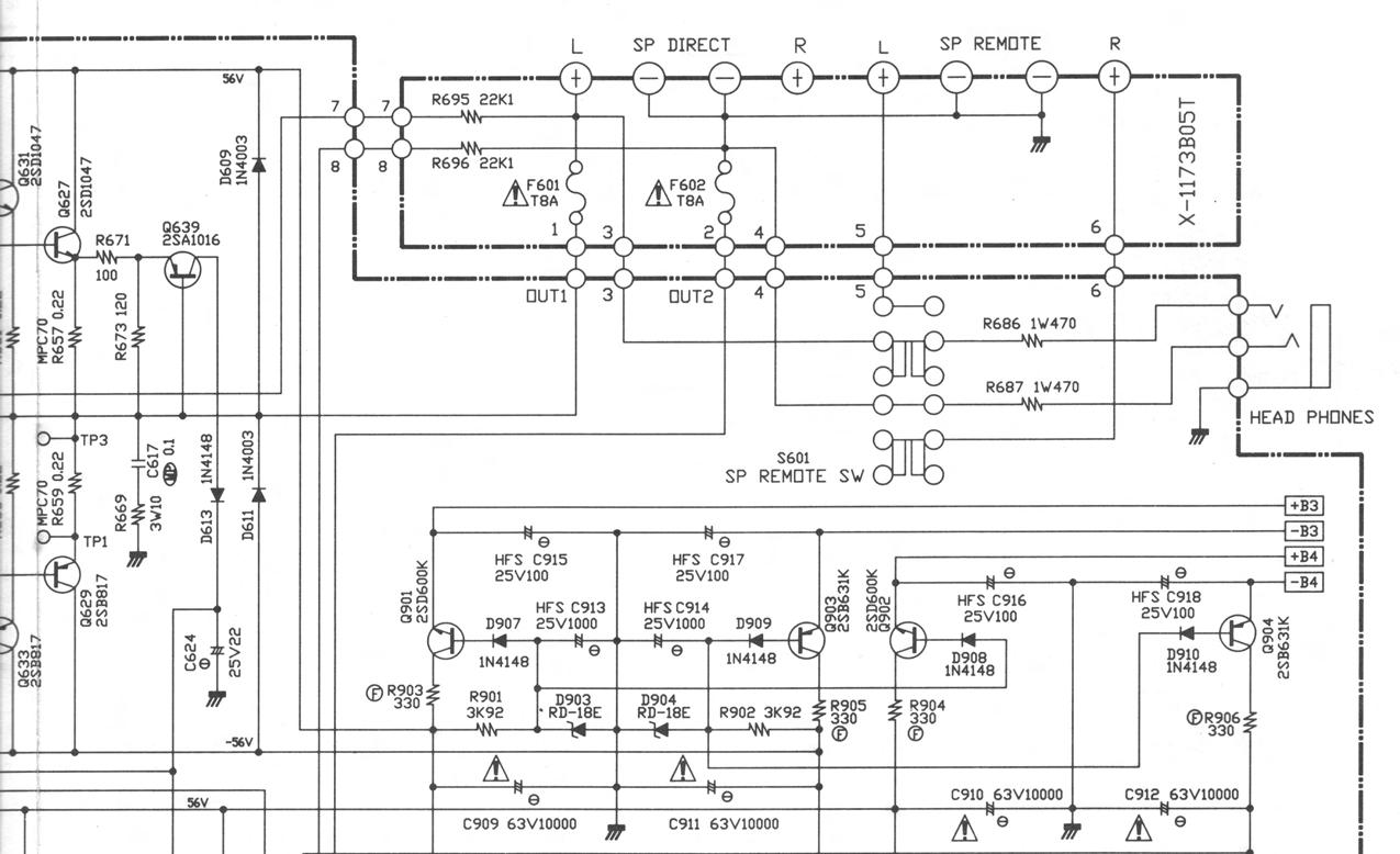

I especially like the fuses in-line with the speaker connections. Excellent. After engineering an amp to have low distortion, let's put a distortion causing element in line with the speakers.
As a tech, we don't look at things outside of the area we need to in normal work. We don't assess the entire design unless we have a good reason to since time = money. But the company who designs and builds the equipment ought to at least be expected to produce accurate documentation. There is no excuse for this.

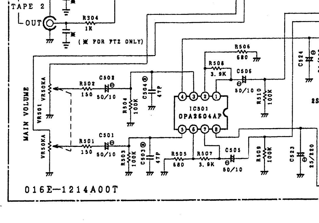

Hello and a good day to all, I also have a Rotel 971MK2, a bit modified, I m working on improving the pre-amp part now, replaced caps with solid ones, and I m on the op amps part, currently I added a BB2604 in the tone part also, stock it has one 2114D, maybe will order 2 OPA1612 and be done 🙂), what got my attention upon checking the RA-02 and RA-06 schematics was some resistors on preamp and volume pot part:
RA971- R501-502 is 150R
RA02/06 same resistors are 470R
Also RA971 R505-506 is 680R in RA02/04 it's 470R
Last but not least R507-508 is 3.9K in RA971 but 2.7K in RA02/06
Why this difference? does it improve something? more attenuation? and other bias for opamp?
Thank you all for your opinions

Hi Criss,
R505 and R507 determine the gain of the opamp: Vo/Vi = 1 + 3900/680 = 6.7
In RA-02 this calculates as: Vo/Vi = 1 + 2700/470 = 6.7, ie. the same gain.
R501 does cause a bit of overall gain reduction with R503, but very small: Vo/Vi = 100000/(150 + 100000) = 0.999
The RA-02's 470R gives slightly more attenuation: Vo/Vi = 100000/(470 + 100000) = 0.995 Difference not audible.
Per

Thank you for your help and inside with this, interesting abordation on that part by Rotel, so in essence they kept the same gain, it puzzels me why they went with 470r/2.7K instead of the usual 150R/3.9K
Also, I was wondering, got my hands on some OPA2228 today, but they need at least a gain of 4 or 5 to be stable as far as I undersand they would be stable in this circuit?
I know many swear that op-amps dont change the total ballance of sound, but swaping op-amps in this 971, got me thinking otherwise, I swapped from Signetics 5532, to aTI5534, to AD823, I even have 2 pieces OPA-627 genuine (if someone wants some), LME49720NA was the best overall but the RF problem was beyond fixable, but the OP-amps are another thread, my main mods where swapping most transistors and implementing the light version of your mods, will post some pictures tomorrow, but all I can say is that its beyond all my other amps as far as sound quality and the mere pleasant feeling it gives
Thank you for all your time and help
