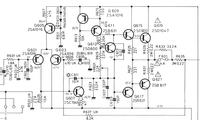

I think that it is maybe time to go back to the original theme for this thread - improving the Rotel RA-820AX. (Remember that?)
I recently had three 820'ies in for upgrading and was almost done with the first when I noticed some strange MHz spikes on the scope trace. Hmm.🤔
OK, the upgrade includes faster semiconductors and higher overall open loop feedback, but I had never seen that before. So I started to poke around the Miller caps and other possible places to try to find the root cause of these spikes - no response. Warning: Kids - do not try this at home!!
Until, in my desperate wisdom, I tried to put a 100nF cap that happened to be lying around - across the speaker terminals.
By the time I had pressed and the scope had finished the Autoset process - the channel's driver emitter resistors burst into fire.🔥 Power off!
No transistors or heat sinks felt hot and no fuses were blown. The speaker protection relay circuit had not clicked. But the channel was very dead.
And so were all drivers, all power transistors and their 0.22R 2W emitter resistors!
What happened? -- (Why am I asking you this? - How would you know?)
Except perhaps those that have studied Doug Self's books more closely than me. In the chapter on Output Networks / Output Inductors he writes:
I can now definitely second that.
The RA-820 has no output inductor (actually very few Rotels have) and no Zobel network (although the pcb is clearly prepared for that).
Instead, it uses a 0.22R 2W series output resistor (not sure if it is wirewound or metal oxide) - and not sure what that resistor should do - or protect.
Admittedly, in normal use without letting a nosey plonker like me anywhere near it - all is absolutely fine and the amp is totally stable.

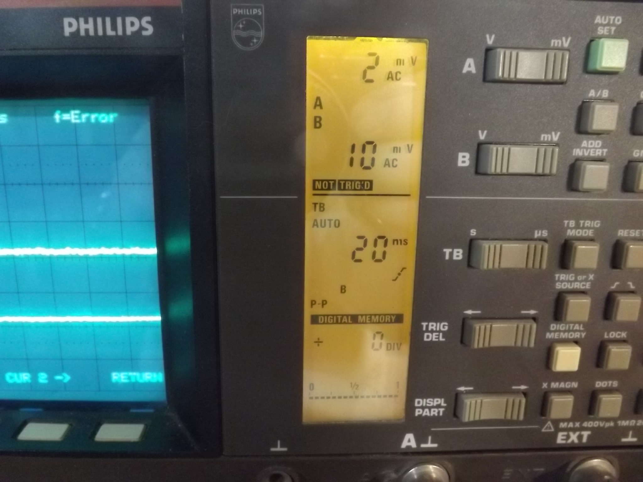

PS. I found the reason for the spikes on the scope - my trusted old Tek TDS210 was saying its last goodbye with this final spiking prank on me.
Well, RIP old mate and thank you for the 40 years.
(And hello again to my even older Philips PM3375, which sprang back into life with just a little bit of TLC. Oh, the blessings of the analogue scope option).
"When a shunt capacitor is placed across a resistive load in this way, and no output inductor is fitted,
it is usually found that the value with the most destabilising effect is nearer 100 nF than 2 uF."

Completely predictable. Some manufacturer's have a phobia about output inductors (they are not evil!!!) and zobels. These components are important for stabilizing amplifiers. Excluding them saves money, and sometimes can be spun into a story about superior design (not!).
I have seen amps blow up due to destabilizing capacitive loads. That would be some speakers and some stupid speaker wire. One an amplifier breaks into full oscillation, two things happen. The output waveform is limited only by supply voltage. and the frequencies are normally so high that both banks of outputs are on at the same time. The only things that limit current are the emitter resistors and power supply impedance. Hence your completely destroyed output stage.
It is also very common for the amplifier to need recompensating when you change output transistors types. Also, non-inductive emitter resistors buy you phase margin. Simply using inductive emitter resistors for replacement can make an amplifier unstable (okay, we'll spin it - "conditionally stable" lol!). The old test was a 10 kHz square wave and you look at the edges, 1 KHz if the response wasn't that high.. A Bode plot would also show this, but you have to remove input circuit filtering to do that.

Yes, and the heat-up of a MHz rail to rail oscillation is incredibly fast - you'll never notice what happened inside the trannies.
"Destroyed in (milli)seconds"
BTW, any thoughts on air core inductors vs. ferrite cored for this application?
A bit off-topic on the PM3375:
You never truly realise what an 8 bit digital scope pixel trace can mask away until you switch to the near infinite resolution of an analogue scope.
That said, the digital part of the Philips PM 3375 is pretty darn good too, and I specially like the easy one-button-press switch between the two.
Here, all I needed to do was to replace the incandescent pilot lamp in the display with two white micro LEDs.
But just getting access to that part of the scope was quite an operation. So many parts and pcbs inside that box!
The small fan on the back has also gone quite noisy, I will have to put in a modern silent one.
Anyway, the engineering and quality is impressive - probably explains why Fluke decided to acquire that part of Philips.
(Or was it just to get rid of a major competitor)?

You would want an air core inductor. An Iron core would require fewer turns of wire, making DCR much lower but it isn't a problem here. That and you really don't want anything with a B-H curve. If you aren't careful you may also have core saturation issues too, air cores cannot saturate. Basically, copy what everyone else does. A 10R resistor in parallel damps the inductor and limits impedance rise.
Nice recovery on the scope. My lamps are still okay, but I have had to get into that area before. The fan was never quiet, even new. My original PM3070 didn't have a fan, but did have a spot for one. Now it does (factory post install).
Fluke wanted into this segment of the T&M market. They bought Philips T&M division (I thought they originally partnered with it). But Philips as a company is cheap. I suspect they saw the R&D costs for this market segment going beyond what they wanted to spend and wanted out. Philips then bought into the medical instruments market through Agilent. Really well made stuff got cheaply made in true Philips fashion.
Yes, in analogue mode these are super 'scopes!! That's why I bought the PM 3070. Later I got the PM 3365A. It does store large features so you can measure them well. At 8 bit, it does really well.
