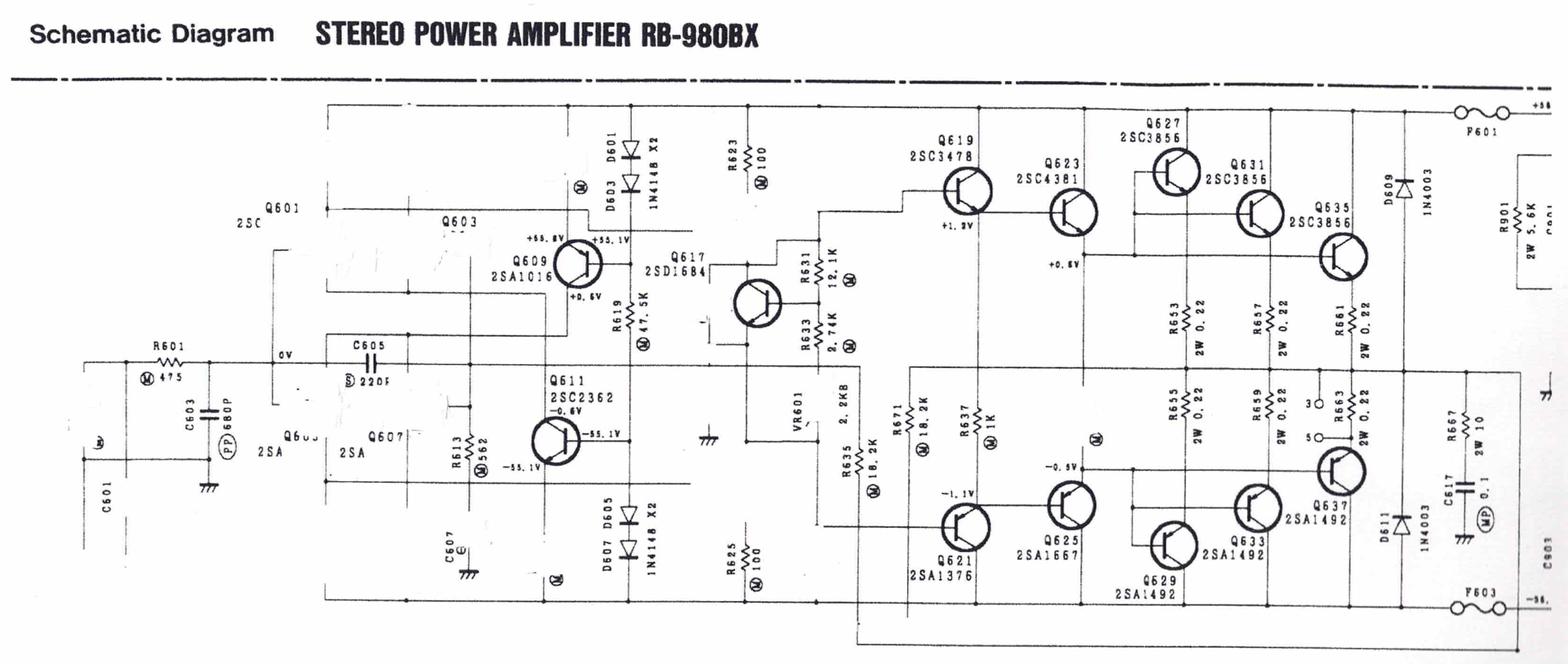

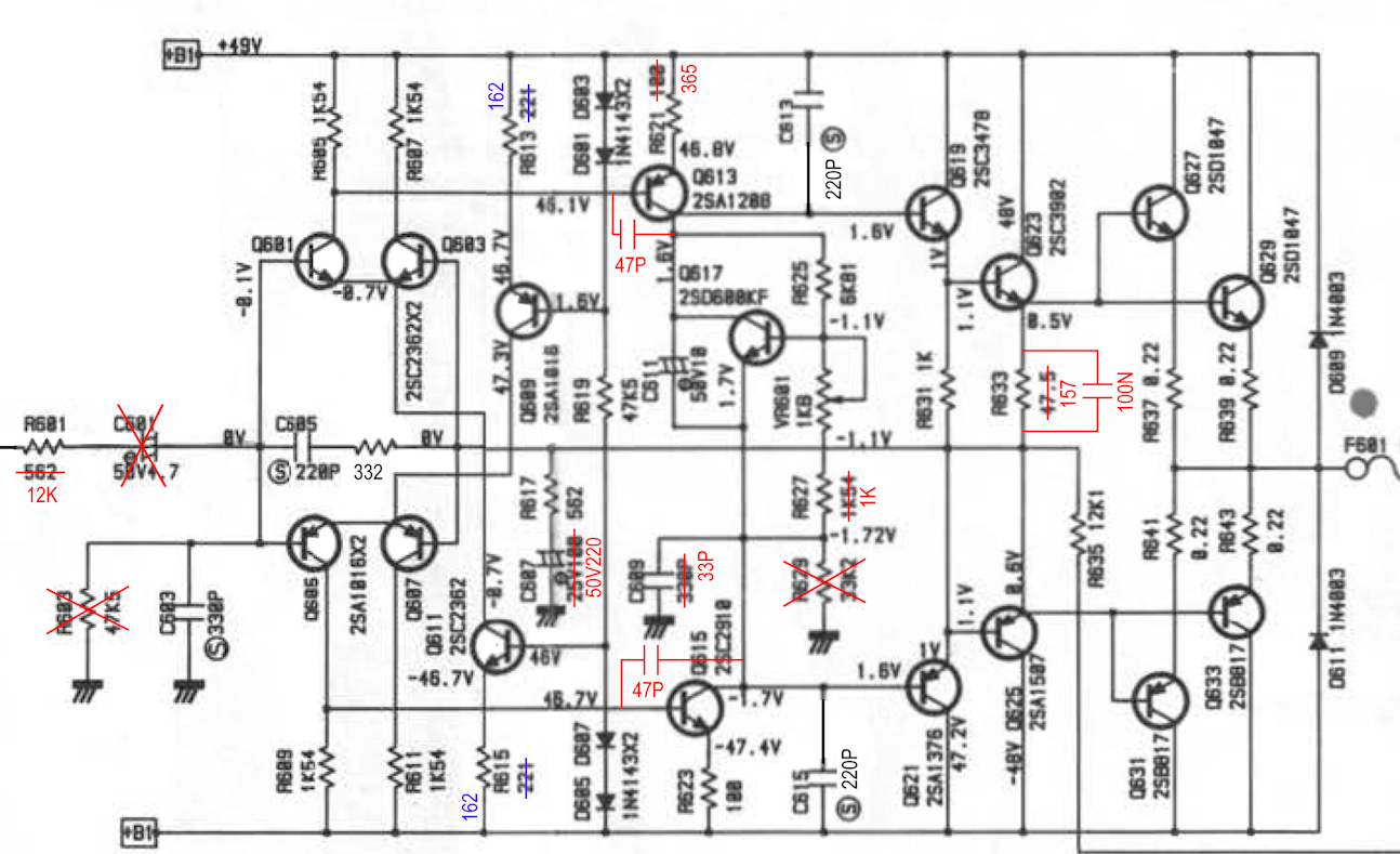

Back on to the oscillating RB-980BX - which is quite another kettle of beast compared to the small RA-810A.

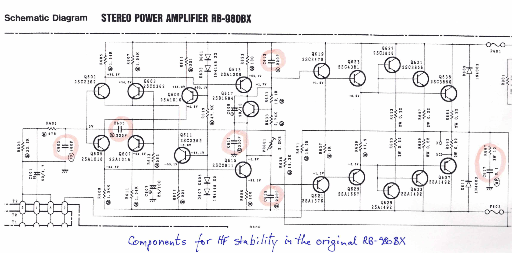

This pic shows the components responsible for the amp's stability, circled in... well, some lipstick colour.
It is actually a stretch to circle in the first RF quencher cap C603 and the Zobel network at the far right of the pic, as these only kick in when certain external factors appear. And note that the bias capacitor C609 is not circled.
C605 limits HF gain, this has been discussed earlier on this thread, but I just can't find the posts now, sorry - it has indeed become a very long thread.
But if you are interested, there is a good TI article on it, https://www.ti.com/lit/an/slyt630/slyt630.pdf?ts=1686932296947
This leaves three capacitors, C611, 613 and 615.
C611 and C615 are effectively in parallel through the reservoir cap, so the VAS collector load is 550p - plus component and stray capacitances.
With the 10uF bias cap C609 in place, it partly shorts in C613 to come into play as seen from the VAS, making the load over 770pF.
Maybe good for stability, but perhaps not so good for slew rate and distortion.

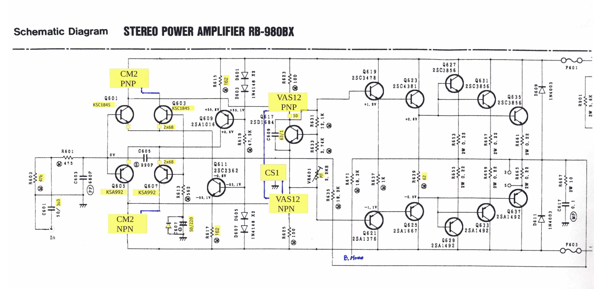

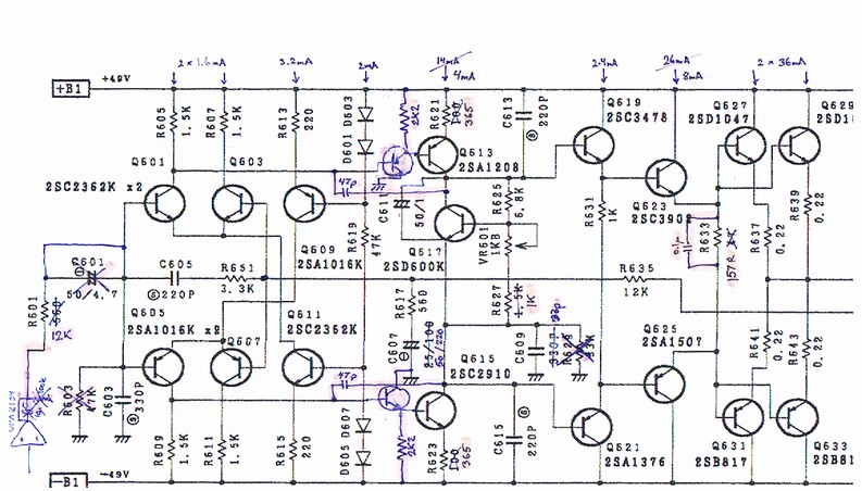

So I started the APS upgrade. Here is first what I removed for replacing - or for good.
Looks a bit threadbare, right? You should see the pcb...... but hey, cleaning it is now easy!

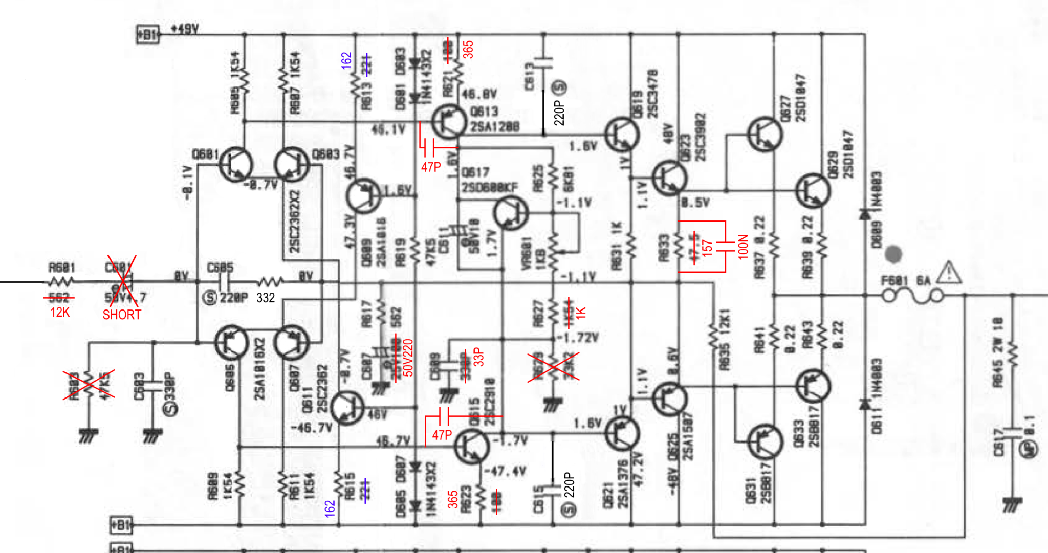

I use my SMD modules throughout and drawing in the complete circuit would make it very hard to view.
So here is the resulting simplified schematic. Each of the modules have been described previously, CM2 are improved Wilson Current Mirrors, VAS12 are EF-CM-dualVAS (both in NPN and PNP versions) and CS1 is the new 3mA current source module for VAS current control.
The original three stability caps are gone, replaced with 56p Miller caps in the VAS12 modules. New LTP pairs have emitter degrading caps and their DC current has been increased. Slew rate is doubled and distortion is >0.0028%.
Component temperature is well controlled to be below 50degC overall and the sound is absolutely outstanding.
This RB-980BX has been totally transformed - and in case you were wondering..... yes, it is rock stable.:love:

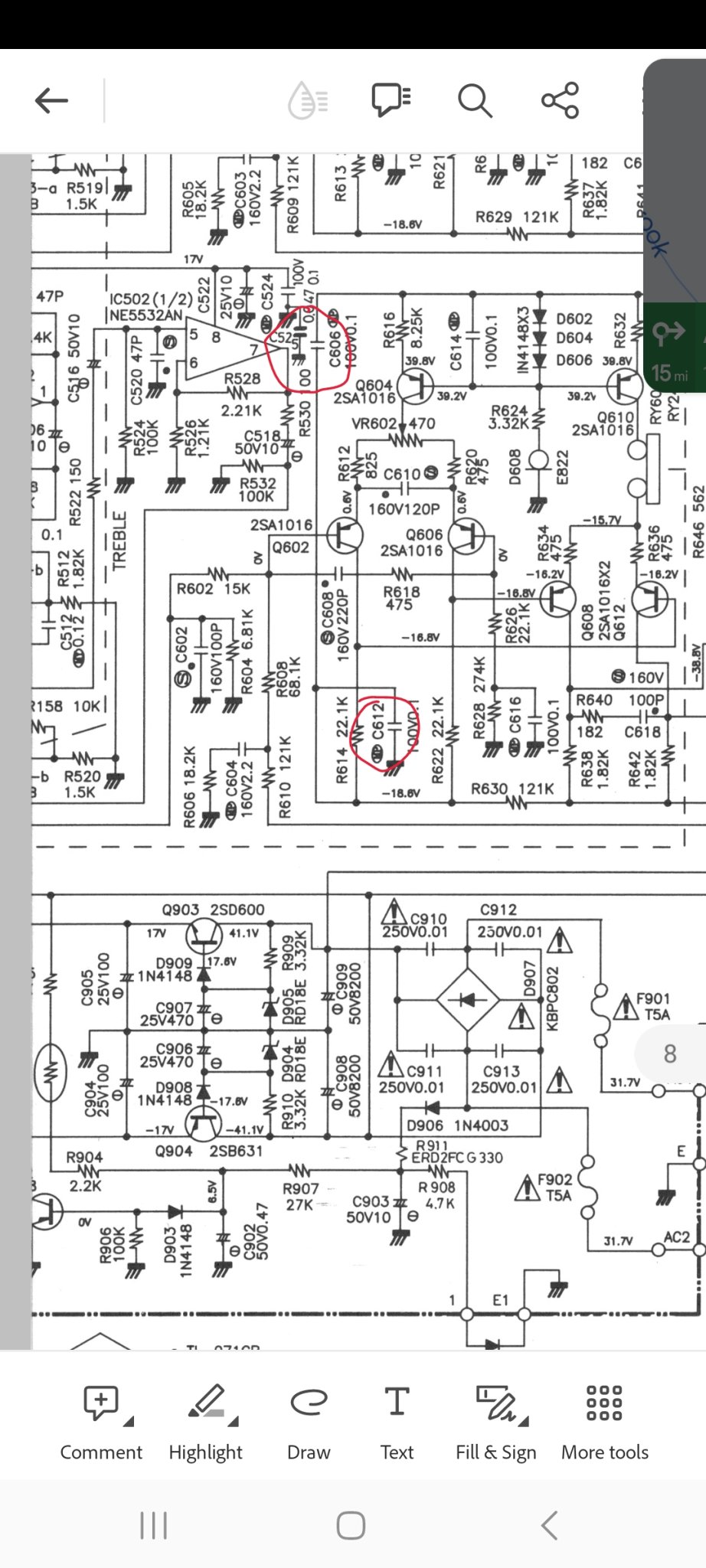

Sorry, bit unclear that
So on the 940bx schematic I take it that c606 and c612 and the same on the other channel are the equivelent to c619-622 on the 840bx (see attached pic) what does replacing these do?
Are there any other worthwhile mods to do to the 940bx

Basically, C611/12 forms a 13Hz low pass filter with R629/30 to filter out any 100Hz hum from the -18.6V rail of the LTP (Q601/02 and Q605/06).
I am not entirely sure why C605/06 was put in going from V+ to this -18.6V point. (And it is not a drawing mistake in the schematic).
But as it sits in series with the massive reservoir capacitor C909, it is essentially in parallel with C611 and thus should halve the 13Hz low pass frequency.
It will also inject hum and noise from the V+ rail to the -18.6V point, but that noise is in (broadly) the same phase as the V+ noise, possibly countering the effect of it on the LTP stage?
I would have to do more analysis and actual measuring to confirm this, but I don't have a RA-940BX at hand. So until then, I suggest to leave it as it is.

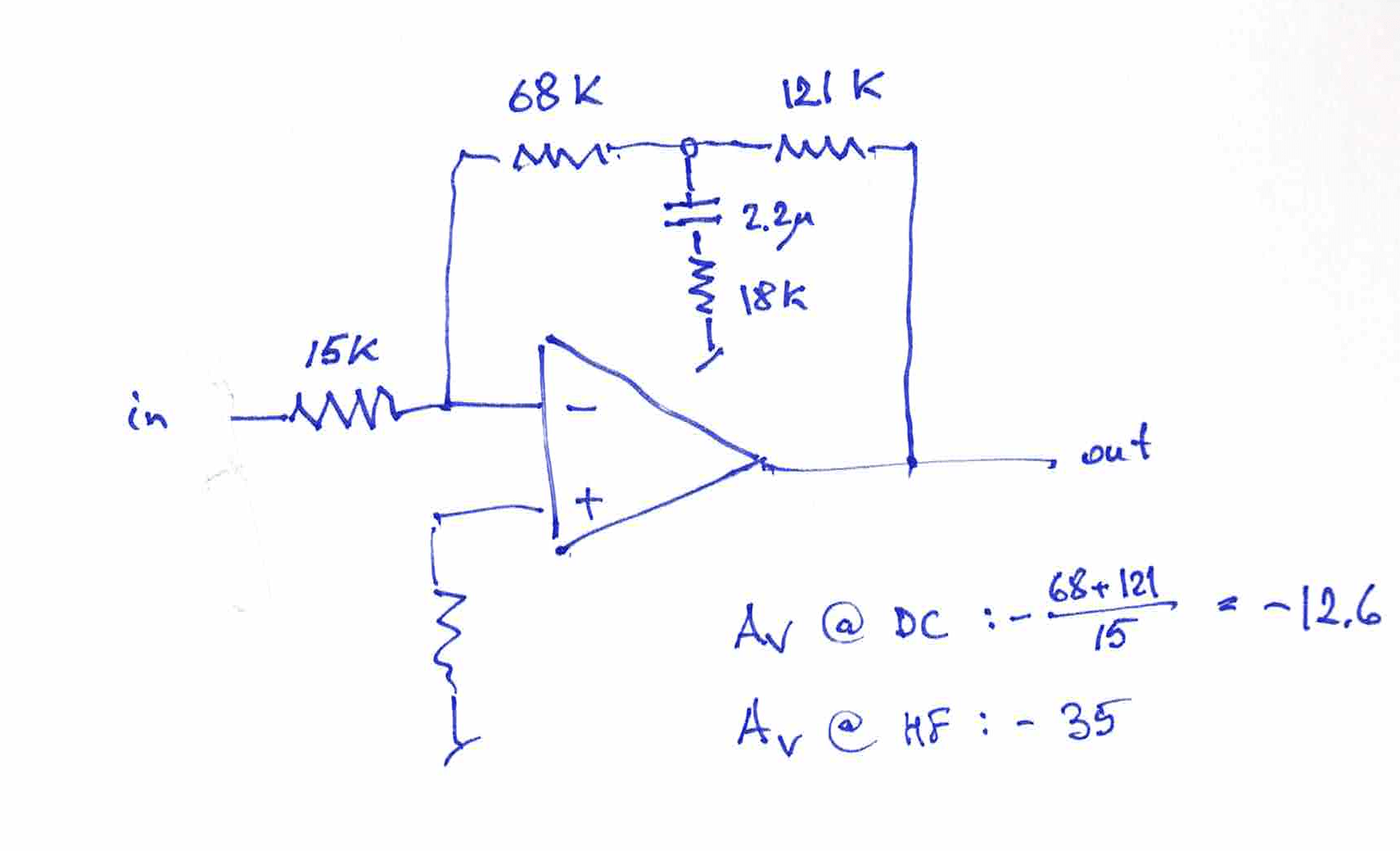

These capacitors are part of the feedback network.
The power stage of this amp is inverting, and can be drawn as an 'ideal' opamp with the NFB network like this:
At DC, the gain is -(121+68) / 15 or -12.6 because the capacitor isolates the 18k from the circuit.
As we begin to move up towards the audio frequency range, the 2u2 starts to conduct and engages the 18k.
At higher frequencies it acts as a short and the gain can be calculated as -35.
It is a clever way of getting high gain without using high value (and thus noisy) resistors.
Just think of it - to get a gain of -35 with the 15k in the input you would need over 500k in the feedback.
It also significantly increases the input impedance, although that is not really important here.

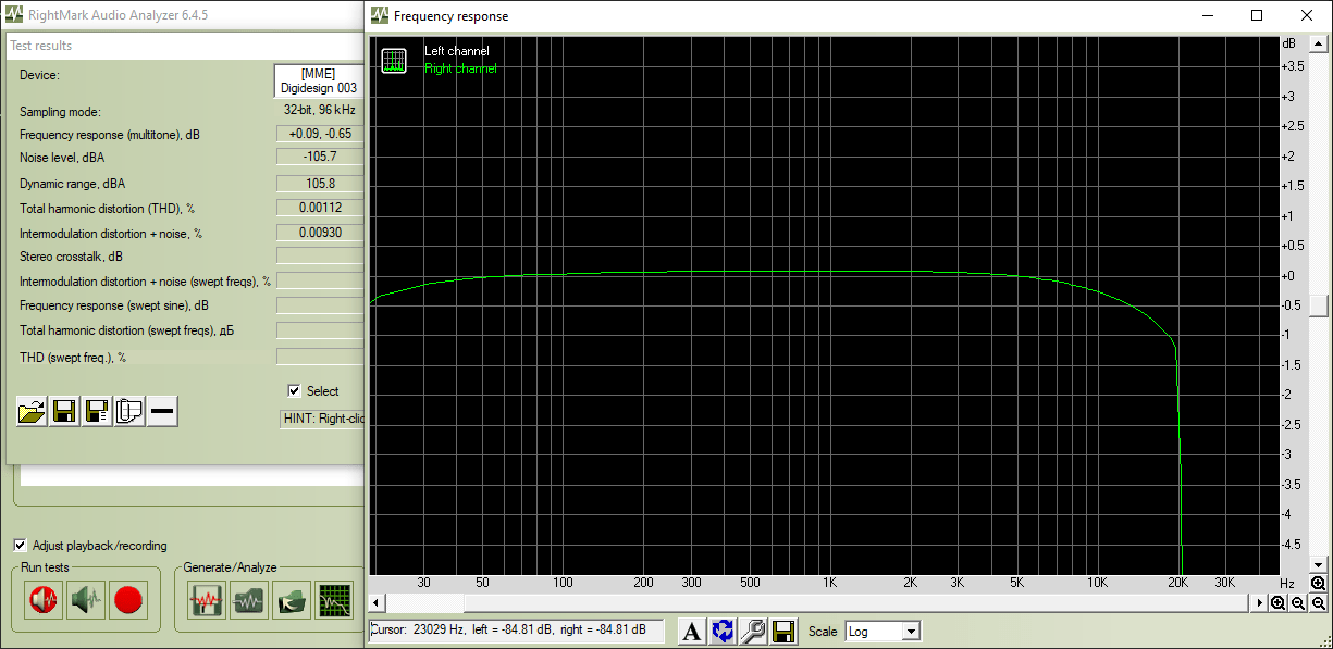

Thank you Per!
Just to avoid confusion if anyone uses my mark-up, here it is corrected as you noted.

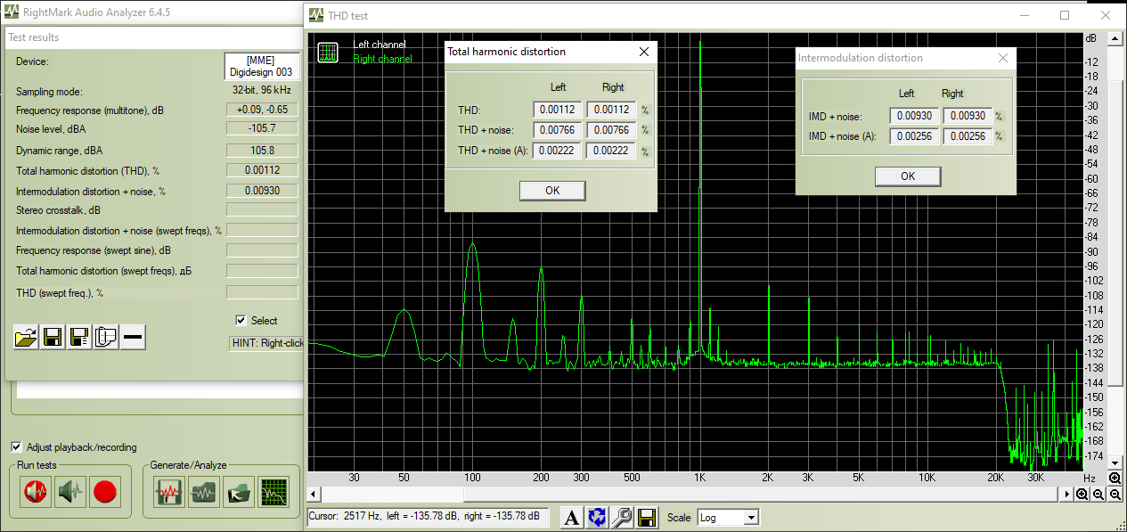

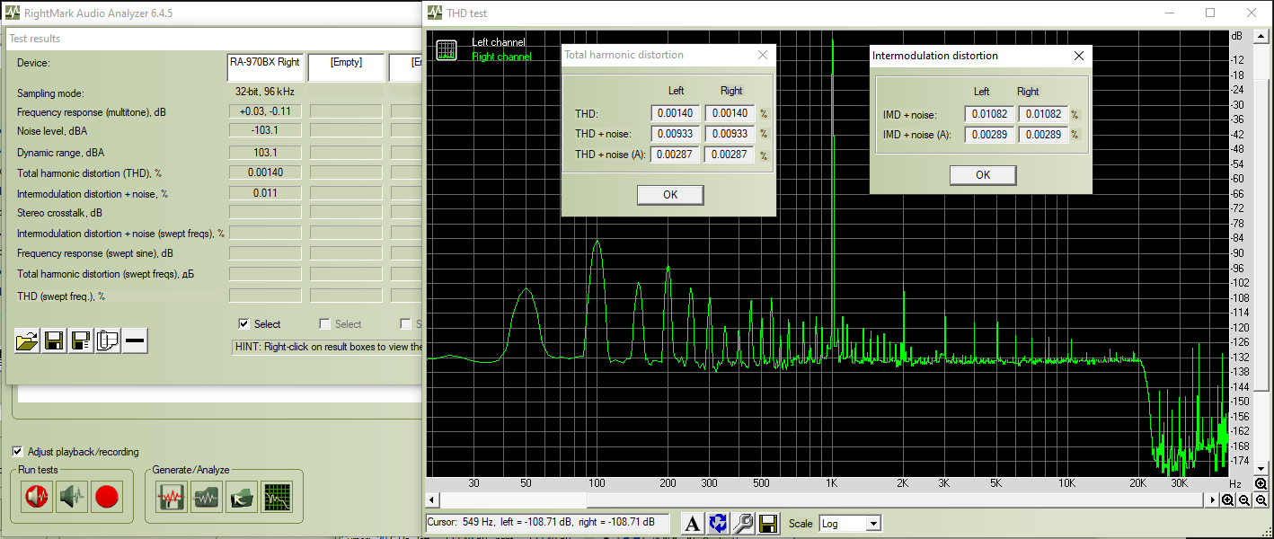

After completing these mods (in addition to a general re-cap and op-amp swap), this is the result I'm measuring (with I think quite reasonable 8mV DC offset).

Hi Tom,
That is a very impressive distortion that you've achieved! (y)
Some may remember that at the start of this long thread I struggled long and hard to get it below 0.003% without any VAS changes. Ok, that was on an old RA-820BX.
I might just try this on a RA-980BX which I have standing grinning at me on the floor.
I would definitely put a scope on the output - or for those who don't have one, at least a good DMM on AC setting.
An old idea is to try 'teasing' the circuit by introducing some hum by touching transistors and capacitors to see if you can trigger any instability.
I've never seen that work on a Rotel, though.
The 971 does have a 10R / 100n Zobel network to protect against heavy inductive loading, but no output L/R inductor against capacitive loads.
So if you want to be on the very safe side, the standard test is to load the output with 8 ohm || 2 uF - feed the amp with a square wave and watch the scope. Keep a keen eye on both scope and power transistor temperature. Do NOT go for a cuppa with any such test running!:hot:

Indeed! I had coloured those LTP resistors blue rather than red because I had not yet changed those, and I don't think I will.
This amp seems reasonably stable, but I haven't yet tried the capacitive load. In any case, as you suggested, nothing particularly exciting happened when I poked around in it.
As for sound, I'm not a huge fan of subjective descriptions, but since you asked, I would say that the amp has become clean and modern, and the best adjective I can find to describe it is "effortless". Whatever character it may have had has seeminlgy been neutralised and it's easy to forget that it's an integrated amp, not just an excellent power amp running straight off the DAC.
Now, the plot thickens. I left this amp be at this point because I jumped on a RA-971 Mk2 that came up on FB marketplare for a very good price, and immedately made the same mods. This time, things have not gone so well.
I have no idea what I did differently or if I did something wrong.
THD figures are again excellent, and DC offset is effectively zero, less than 1mV. However... this time there is a relatively huge HF roll-off (it was not there before modding), and the amp begins to heat up fast and dramatically as soon as I touch the power rails with the multimeter probe. It spontaneously does it on its own too sometimes, but this is a reliable way to trigger it.
Sorry to now dump more questions on you, but do you have any thoughts on what I may have done wrong or what may be going on? Is this similar to how your 980BX was behaving?
