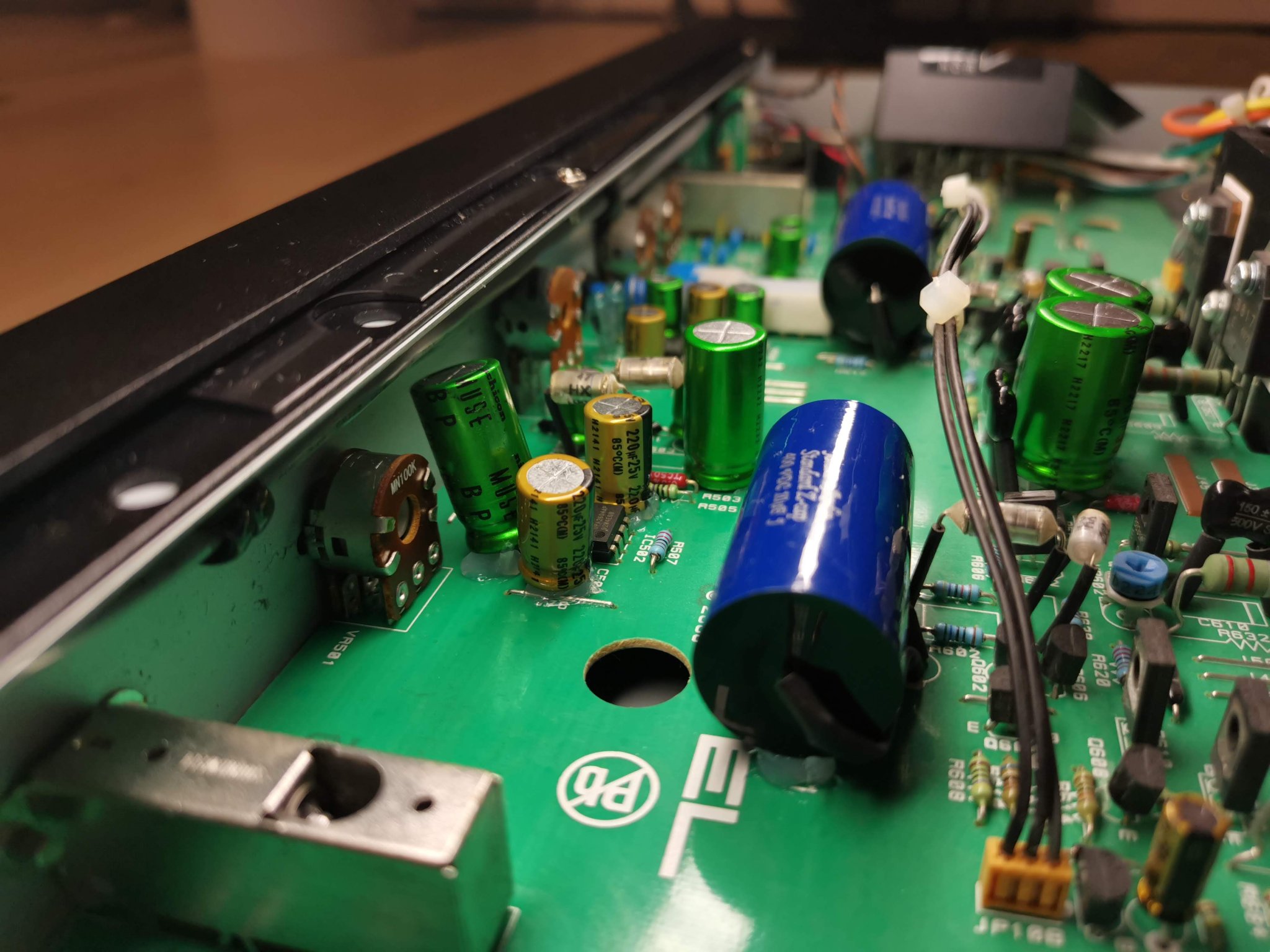

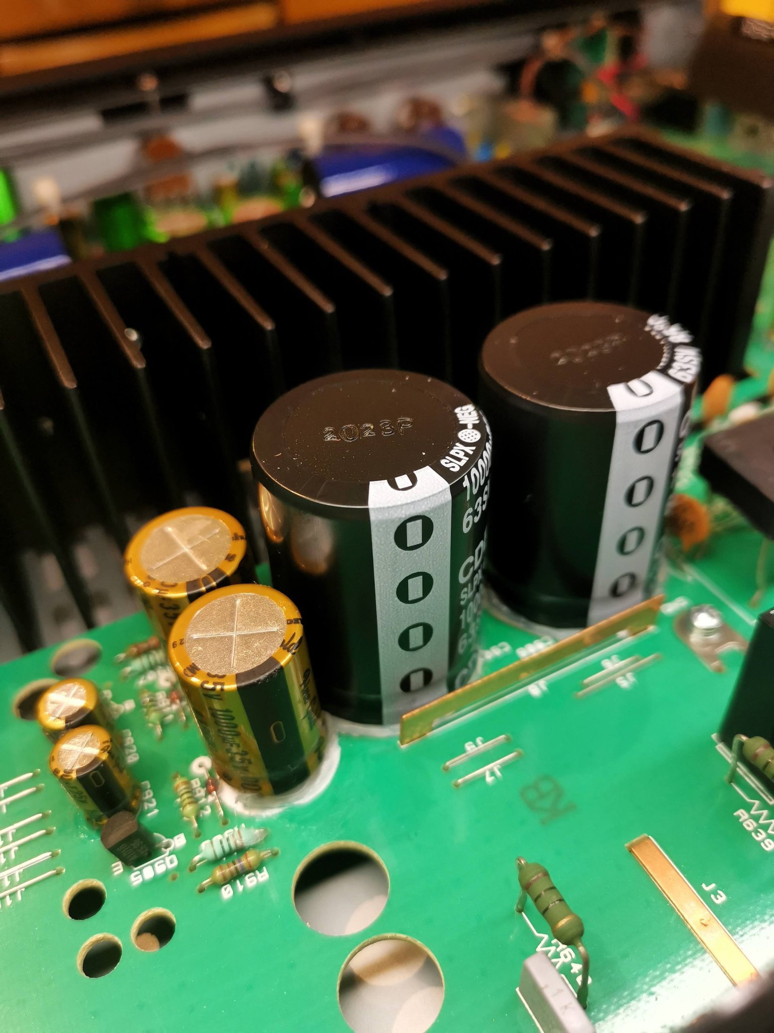

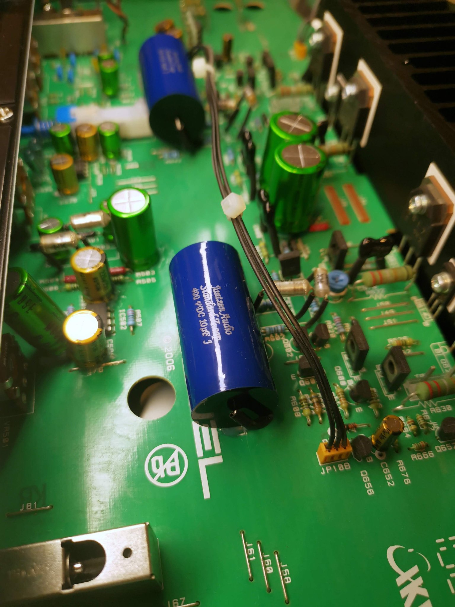

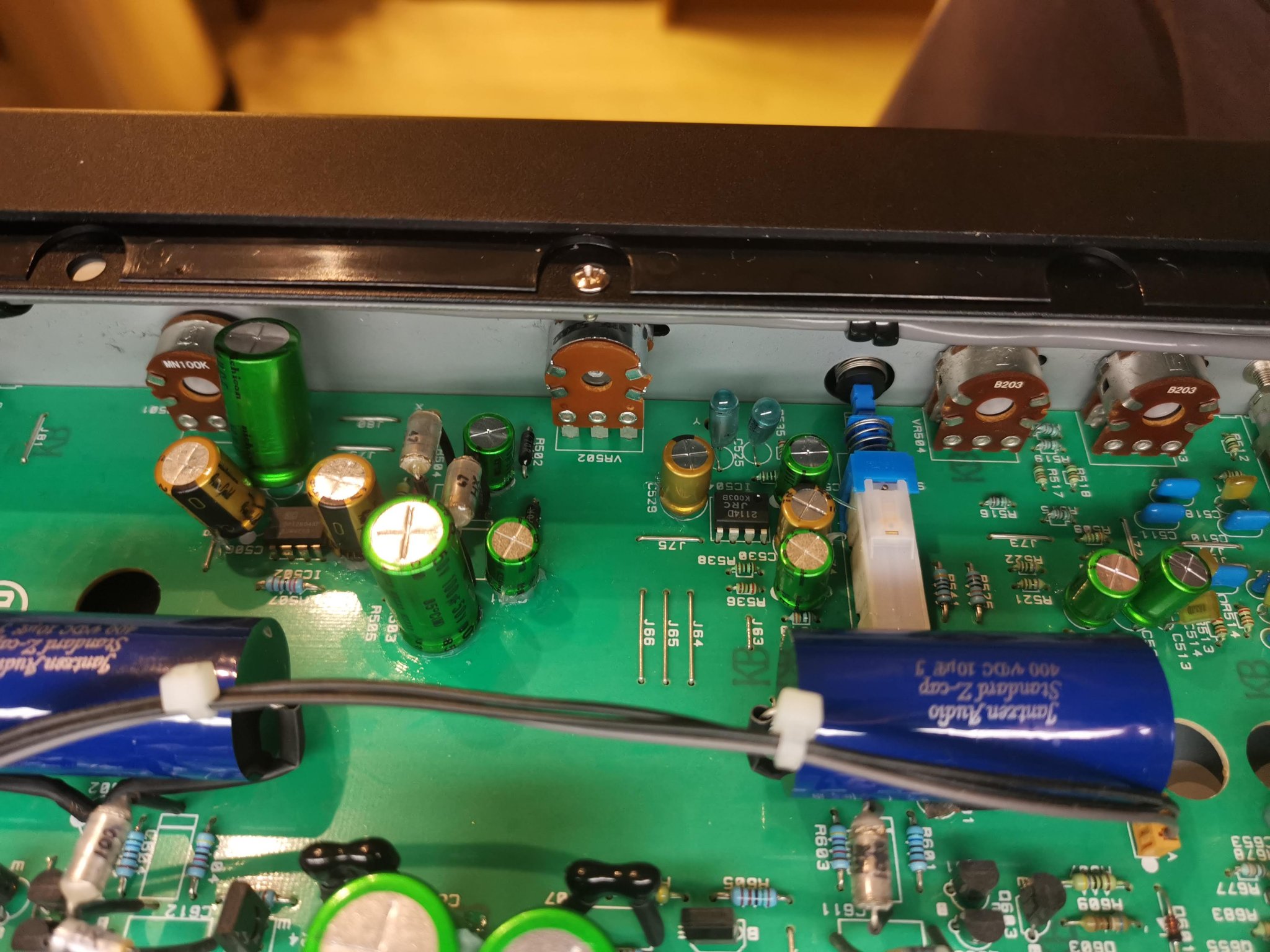

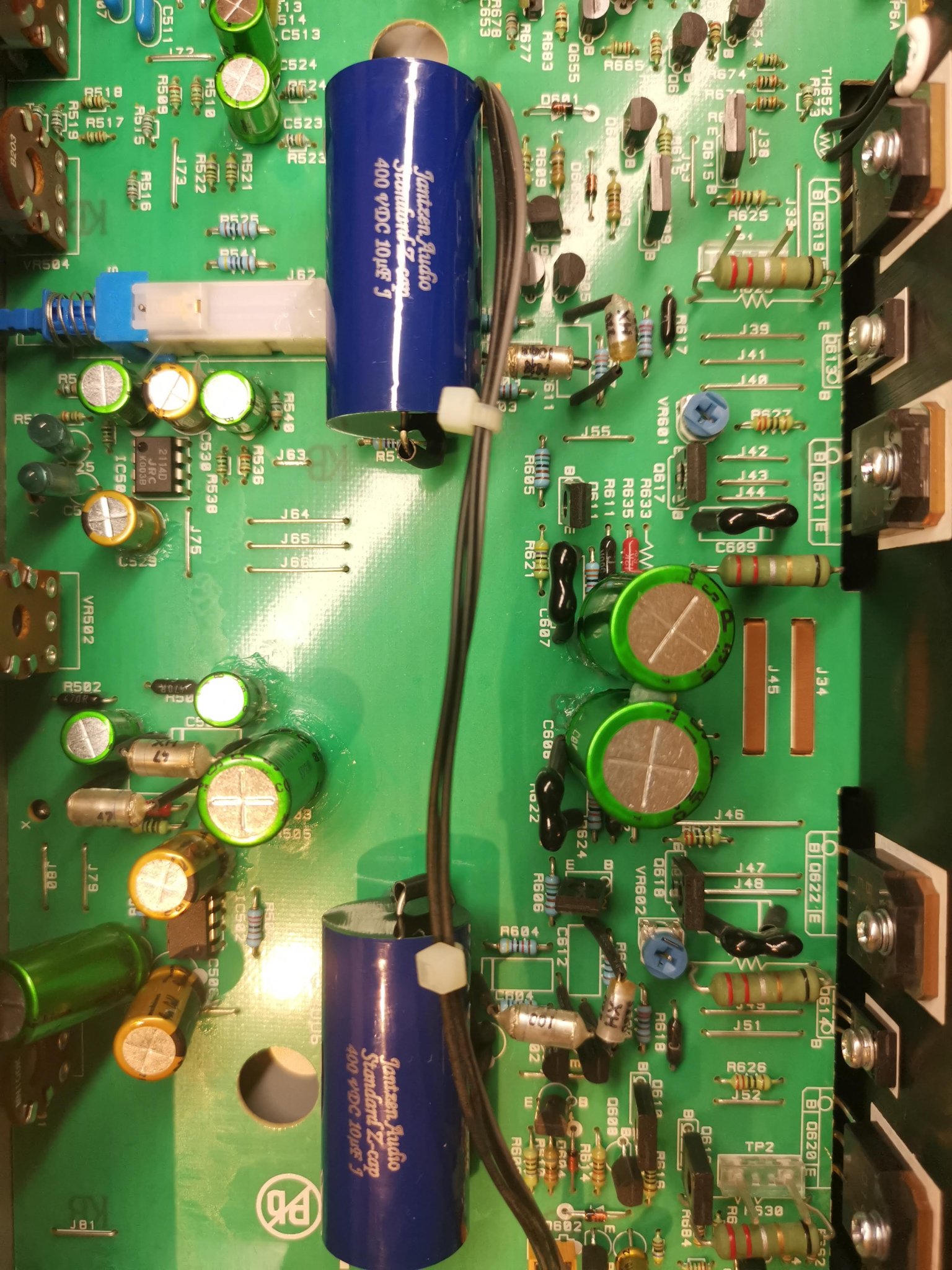

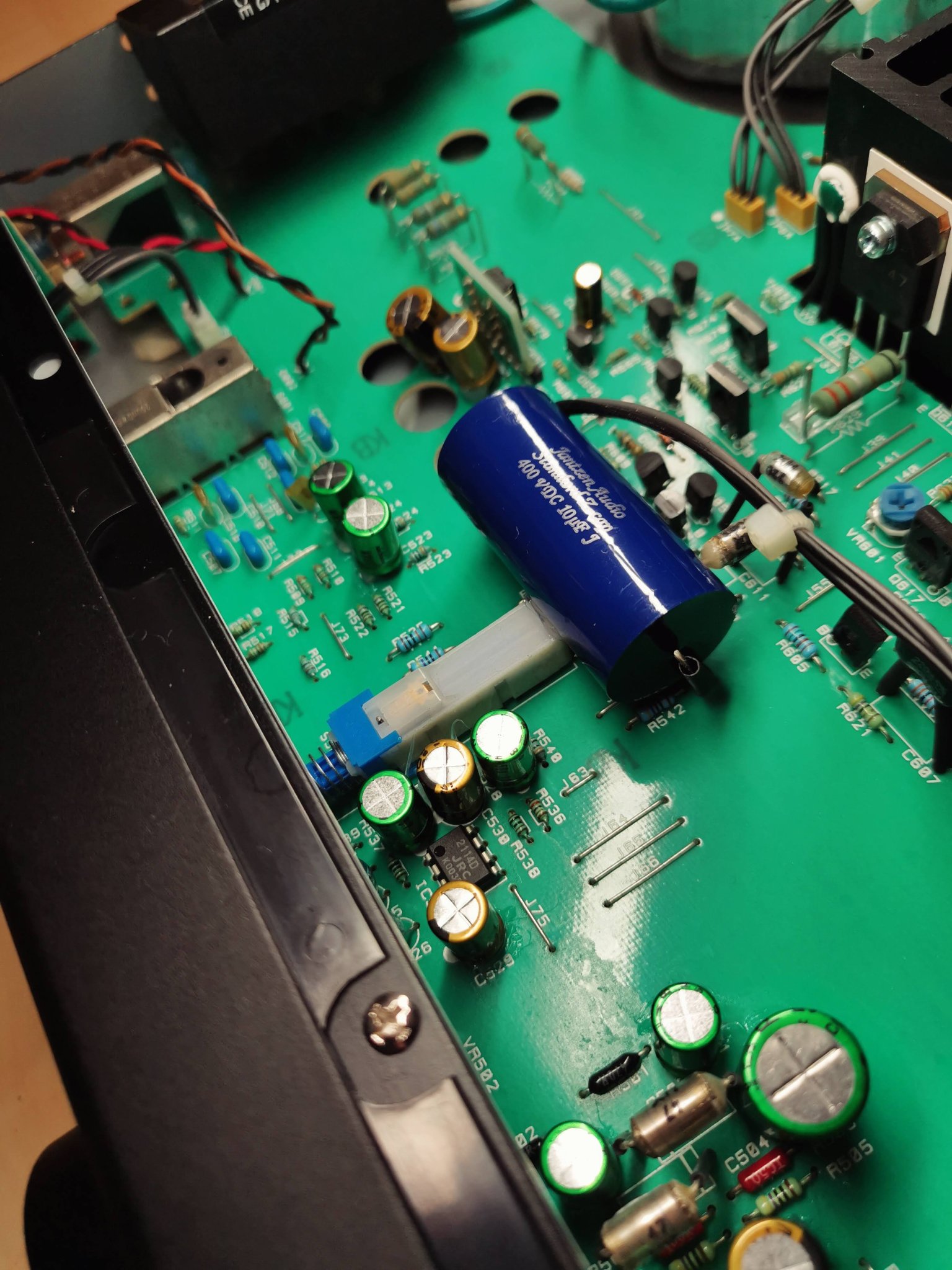

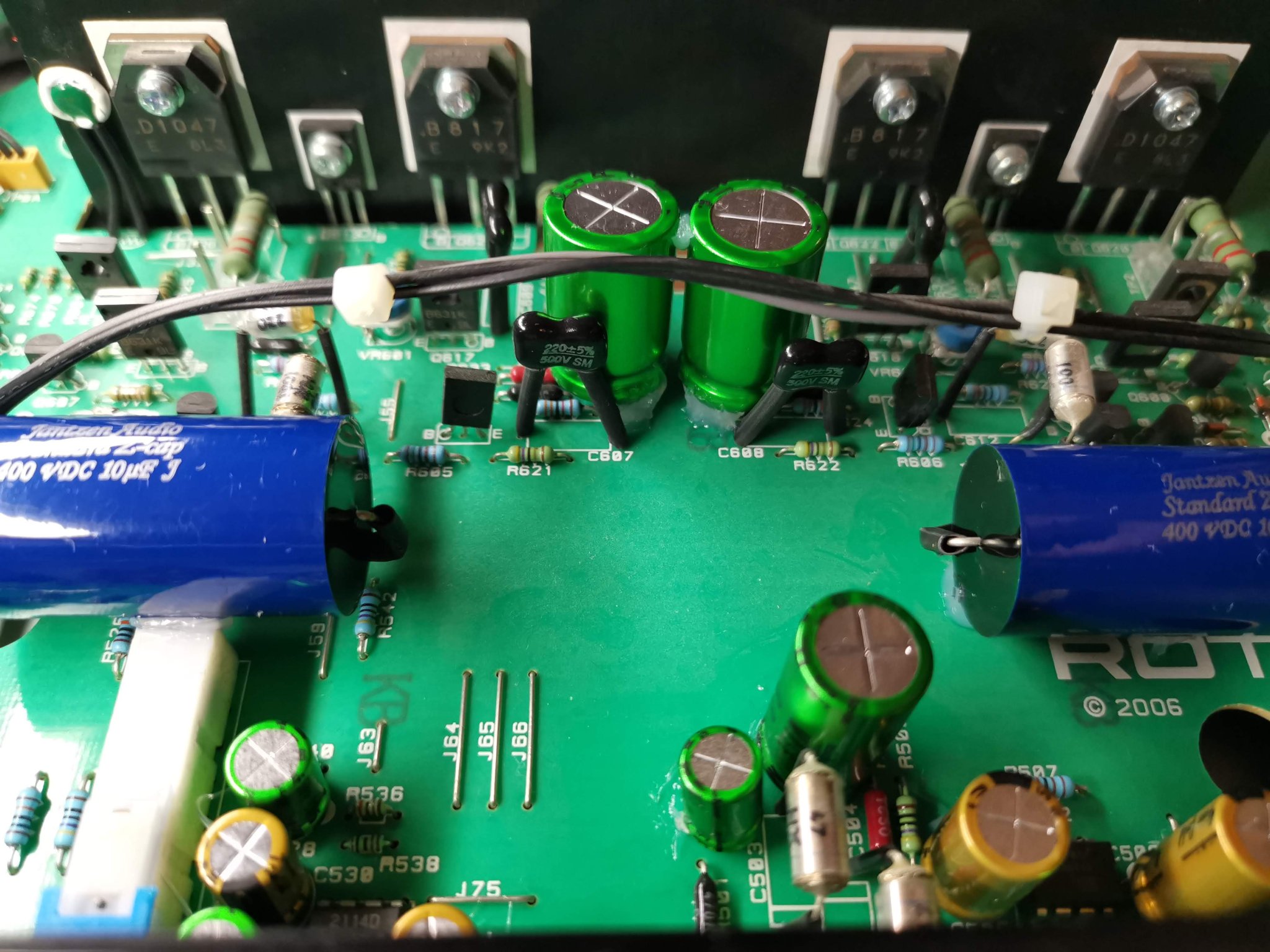

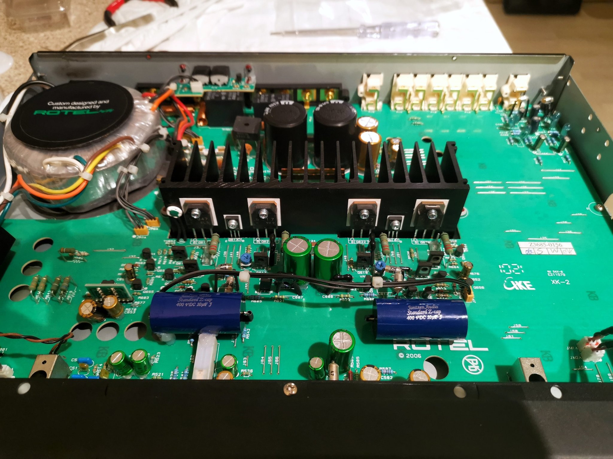

I wanted to thank everyone for their contributions and especially Per for starting this amazing thread!
I began my DIY audio journey several years ago wanting to upgrade my B&W 601 S2 crossovers to tame those tweeters and end listening fatigue. A few component replacements and additions for an upgraded filter circuit resulted in a far smoother sound which was finally enjoyable hours on end.
I had already upgraded cables, connectors, power filtering, DAC, subwoofer, etc. yet always felt there was muddiness remaining in the mids. I knew this muddiness came from my Rotel RA-04 SE, so was already on a path to upgrade the amp, but before doing so, I thought, why not check if any mods/upgrades exist? And that is how I landed on this thread!
I began taking extensive notes, completed some background research (even contacted Rotel engineers to confirm a couple of things) and prepared myself for the upgrade. Last weekend, after receiving all the components, I completed the following maintenance/upgrade:
- Replaced all the electrolytic caps (except in the phono stage as I’ve never used this and unlikely to do so in the future) and four polyester caps, with values covered in this thread (full shopping list below).
- Glued down all the new caps with Chipquick electronics grade silicon.
- Sprayed the hell out of all the knobs with WD40 specialist fast drying contact cleaner (made a huge difference to how smoothly the knobs now physically turn and crackling when playing with the L/R balance dial has completely gone).
- Finally, I tweaked the bias which now perfectly sits at 6.5mV after hours of listening, and the amp is not any warmer than before (I will monitor this in the hotter summer months though)

Upgrade notes
- Whilst input DC from my DAC is 0.1mV (limits of my voltmeter), I wanted to stay safe and did not shorting the opamp’s input/output coupling caps (C501/502 C515/516) as was discussed on this thread. I left them in place and kept electrolytics as I couldn’t source film caps (e.g. Wimas) for a reasonable price. I will likely upgrade these in the future unless someone can convince me that shorting is definitely the way to go 😊. Note that currently output DC to the speakers is 32mV.
- There was no stock available for smaller voltage C501/502 caps so had to get the 50V which was a bit of a tight fit.
- Removing the 6,800uF Rubycons stuck down with strong glue was a real pita!
Results
Lows do seem faster, tighter and better controlled (but it’s not night and day thanks to my Rel T7i which handles bass excellently).
Mids have lost their muddiness, clarity and separation have increased. I am delighted. However I ran a frequency sweep and noticed that this upgrade resulted in a 5-10db gain 800Hz and above (or a 5-10db reduction 800Hz and below) which might explain why clarity seems better or bass is more controlled.
Highs do sound better, but I wouldn’t put my hand on the fire here.
However, the biggest change, which I noticed immediately when listening to my sampling tracks, is how much LARGER the speakers sound compared to before. Difficult to explain. It’s not the horizontal soundstage but vertical. My small B&Ws bookshelves seriously sound 5 times larger as if I had huge floor standers in the living room. The best analogy I can give is like going from an ultrawide 64” TV to a full 1:1 ratio wall of sound. I close my eyes and have difficulty believing so much spatial volume is coming from the two little speakers.
So thank you all for contributing to this thread and making me a very happy listener indeed!
A few photos attached.
Alex

Well done, Alex.
If you are interested in completely getting rid of the Rotel "muddiness", I would highly recommend to upgrade with current mirrors and new VAS modules.

Hi there Alex,
Well executed upgrade 😍
I hope you enjoy your new Rotel sound for a long time but I believe that Per has more for you in store 😉

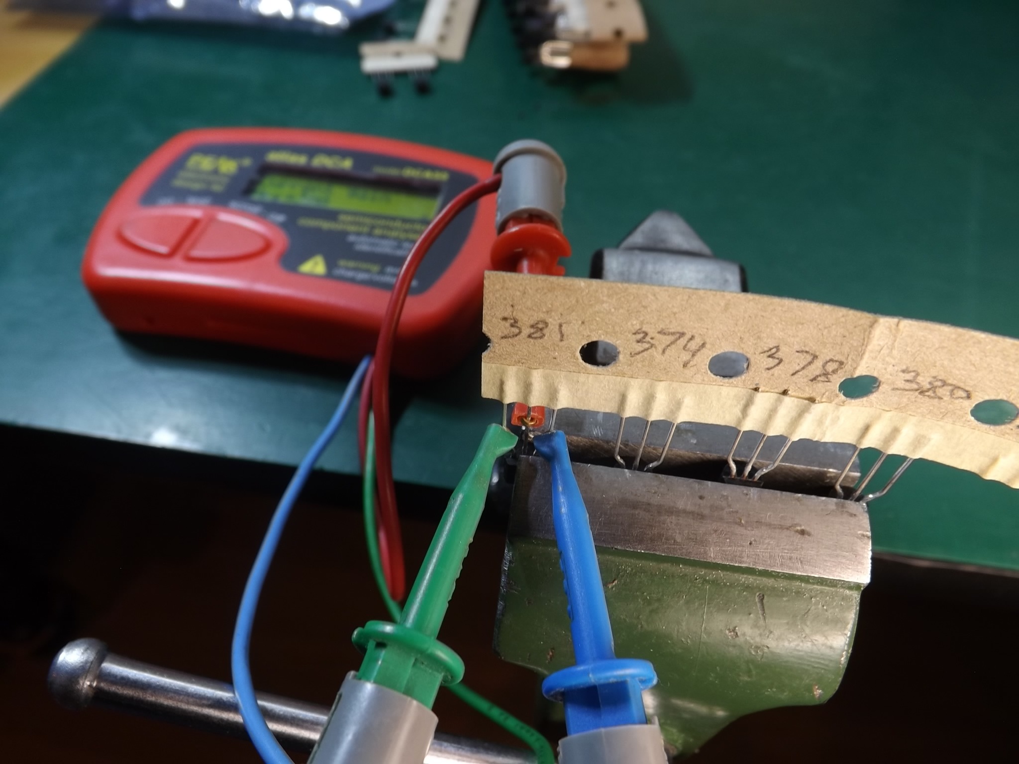

The main trick to match transistors is to keep them precisely at the same temperature during measurement. I use a small vice that can grip four transistors on the tape and has enough thermal mass to get reproducible measurements after about five seconds.
And as can be seen, I use the Peak DCA55 which I find is a real gem of an analyser. Then I note the hFE on the tape for easy picking of matches.
No, it is not exactly matching at the amp final operational current or temperature, but from experience it comes pretty darn close.

Vice it's nice trick. I did it in free air but I was using tweezers and did not touched transistors. Also was waiting some time before taking measurement.If you want to speed up things, I can offer you to buy matched and wrapped LTPs and current mirror modules from me.
If this project will prove promising for sure I will perform more precise matching procedure.
I'm not in rush but thank you for your offer. This part I want to do by my own. But for sure I'll be interested in your VAS modules. I'll contact you later on PW about those.

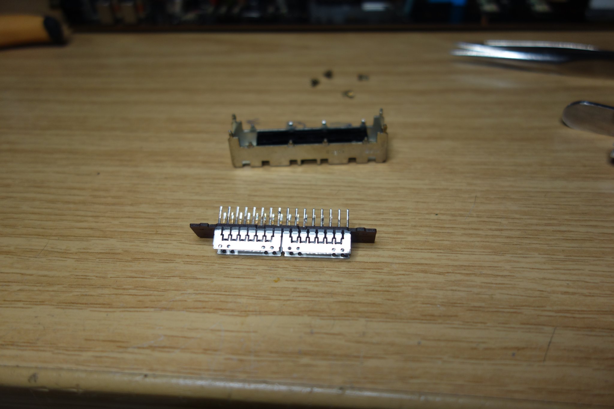

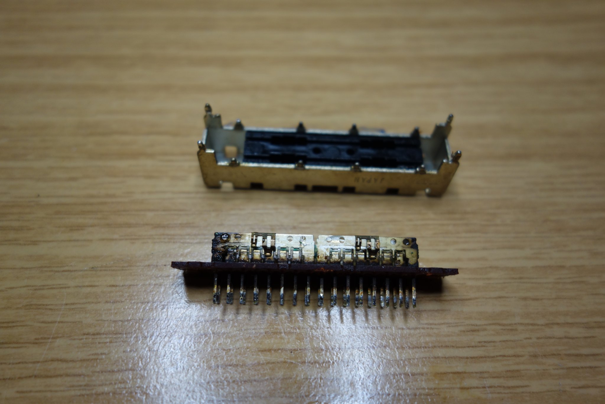

You really shouldn't do this. WD40, even Kontakt 600 is certain irreparable longterm death of every pot, there's no non killing contact cleaner. Only more or less aggressive ones. It's better to disassemble and clean them properly only with isopropyl and some vaseline or CO70.Sprayed the hell out of all the knobs with WD40 specialist fast drying contact cleaner (made a huge difference to how smoothly the knobs now physically turn and crackling when playing with the L/R balance dial has completely gone).
WD40 leaves very aggressive residue, you can't clean that up without opening up the pots.
I'll give you my latest before and after example of a 30 year old SSSR26:
Thanks for the advice @BeyondStupid. I'll just buy new pots in the future if the contact cleaner kills them, but honestly given the value of the amp and specifically the pots, it didn't make sense to spend time desoldering and disassembling them for cleaning. But will definitely take on your advice if ever I own high end pots in the future!
Makes sense, it's always a huge time investment taking out a pot. A last thing I can recommend you if you ever open up the amp or any amp again regarding pots is replacing the Bias Pots. I had so much problems with them I change them out without checking if they still work nowadays. It's a quick and cheap preventive measure to safe a lot of eventual pain later.

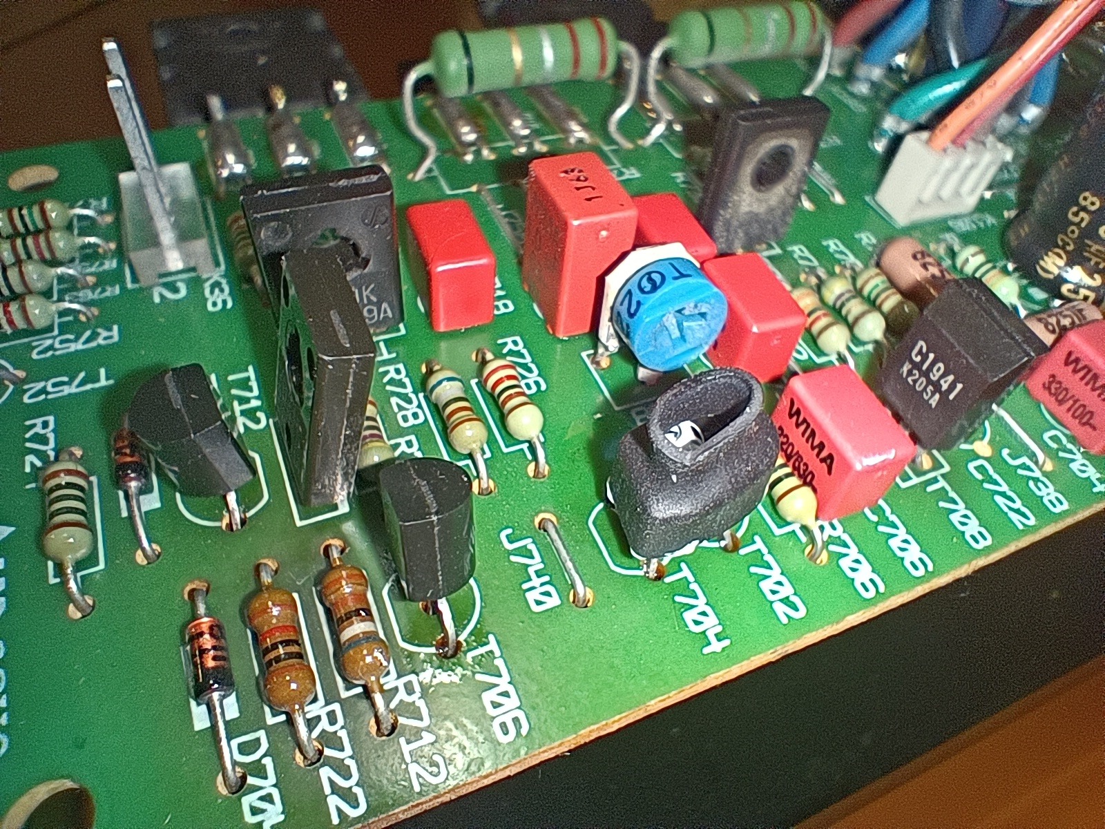

I couldn’t reuse the original driver transistors, so I tried the new(ish) Toshiba TTC004/TTA004. I must say, Toshiba seems to have picked some of the best of each of their existing silicon processes into these devices and started a refreshing new part designation. High voltage, decent current capability and hFE, modest capacitance and price in a pair of new nicely linear, isolated TO-126N package devices – what’s not to like?

Hi Sam,
I believe that the SOA is mainly determined by the transistor package and thus the max size of the chip inside.
TTC004's SOA is not much different from other TO-126 driver trannies, like eg. 2SC3902, BD139 etc. - and at times even better
Anyway, I agree that you should never use components running anywhere close to their SOA limits - unless you like to live dangerously.
I my experience the main SOA rescue factor is to keep the chip temperature down - and for us mortals this means the case temperature if the electrical specs are given.
In use as a driver transistor in a domestic audio amplifier, a 10W type should be plenty ok - with proper heat sinking that is.
And here is why I like the fully, high TC epoxy isolated TO-126N (or ML or other manufacturers' suffixes).
I then use an ultra thin layer of Thermagic ZF-12 thermal compound (other good brands are available) between the tranny and its heat sink.
It has a thermal conductivity of 12 W/m.K - if you believe the datasheet. That is over 15 times that of std. white Al2O3 filled silicone compound.
Either way, thinner is better - not the other way round. You just have to fill any microscopic interface voids with a high TC interface compound.
I have seen too many transistor repairs literally smothered in the greasy white stuff. Yikes!
Per
