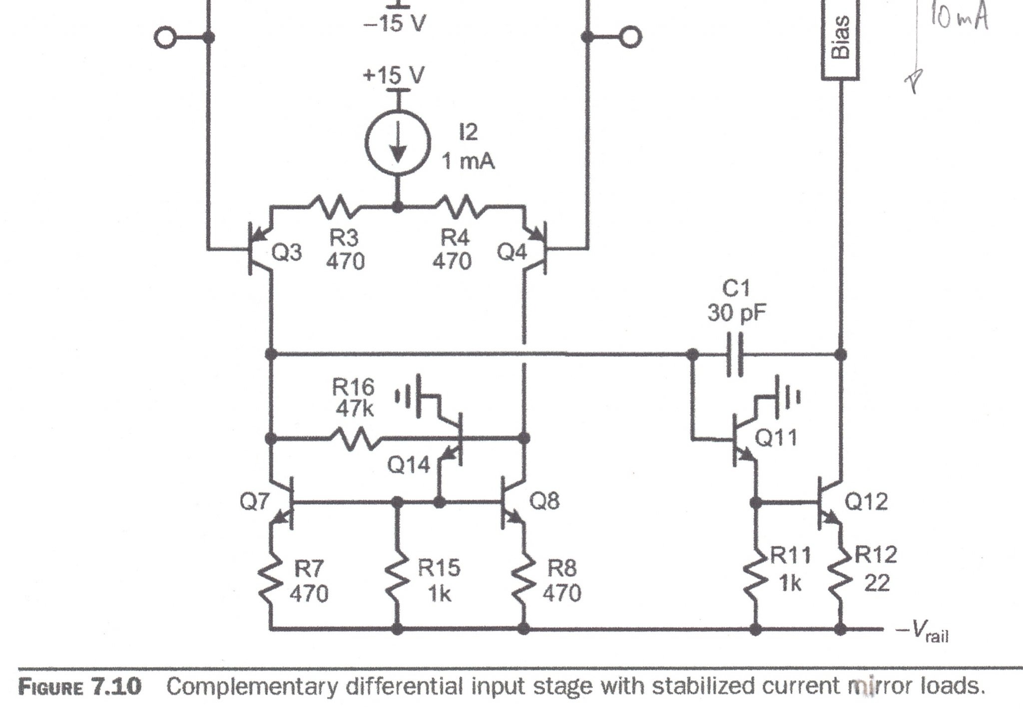

Bob Cordell suggests a seemingly elegant solution in his brilliant book ’Designing Audio Power Amplifiers’, I enclose a part of the schematic (hoping that I don’t get into any copyright problems) showing the addition of a ’helper transistor’ Q14 and two resistors R15/16 to the current mirror.
I believe that it is actually an old circuit trick from IC opamp designs, and as I understand it, the Q13/14 ’helpers’ increases the balance and equality of the mirror currents and the 47k resistors between the LTP collectors should ensure that their voltages remain the same, thereby allegedly defining the base voltage at the VAS’s.
So, I built this exact circuit into the RA-971 on the bench and can testify that - it doesn’t work. At least not in the Rotel.
It stopped the thermal runaway blue smoke destruction of the VAS, but there was no bias current and the output power stage never turned on. The resistors between the LTP collectors had to be reduced to less than 6k before the VAS transistors even started to wake up.
(I noted that Cordell later in his 2016 Burning Amp talk had changed the values of these resistors by a factor 10 (!), so the 47k was now 4k7 and the 1k had been increased to 10k).
I tried those values as well, but the control of the VAS and bias current was still found wanting and subject to VAS temperature variations.
Add to that the unwanted loading and reduction in transconductance of the LTP input stage.
Maybe someone more knowledgeable than me could comment on these findings?

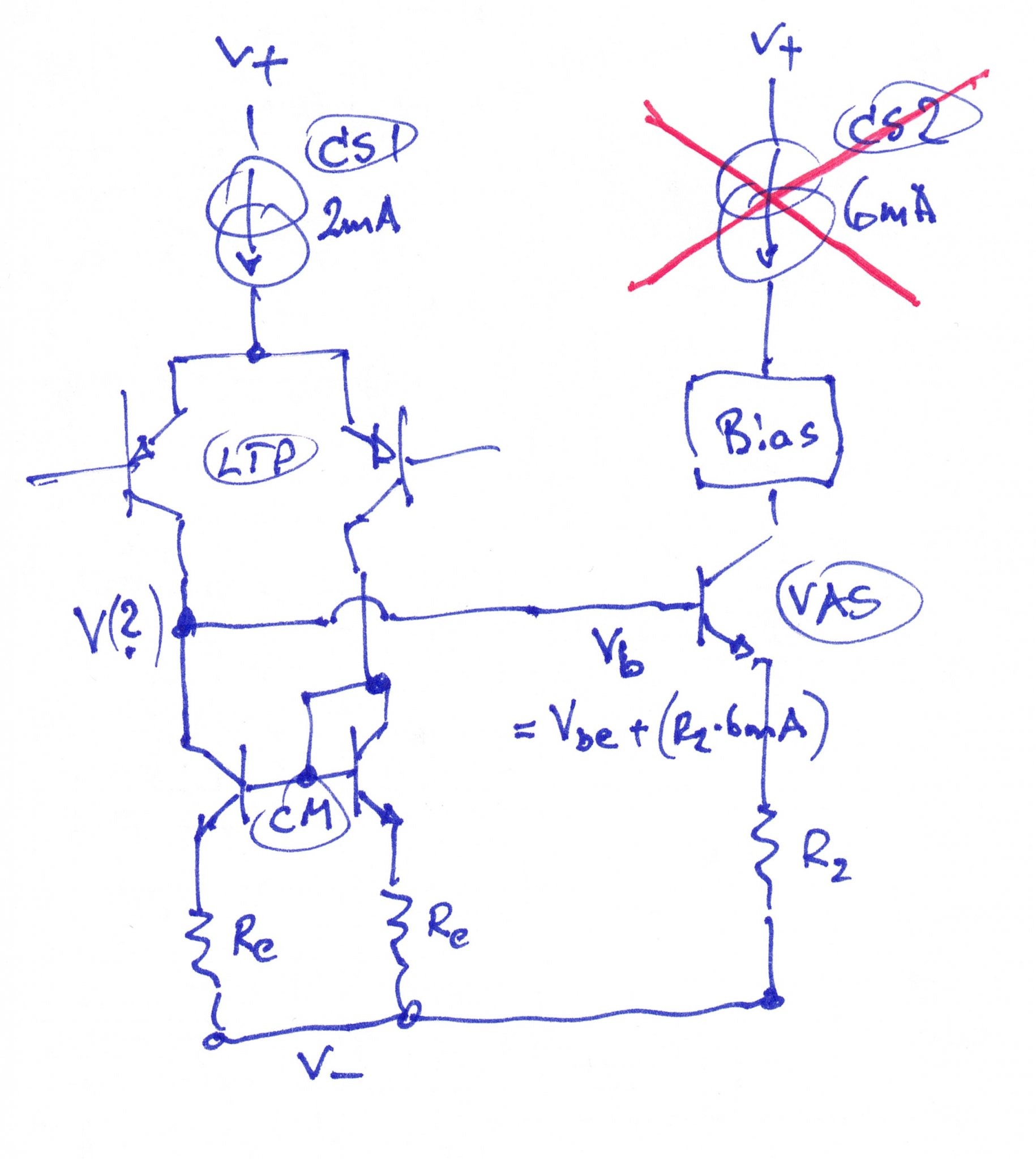

Double Differential Input Push-Pull EF-VAS Bias Revisited

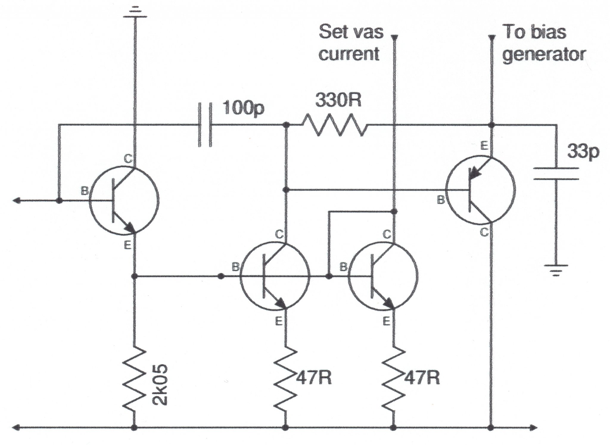

A better solution would perhaps be to somehow place a stable current source inside or around the bias voltage circuit between the two VAS’s, but all designs ideas that I have considered in and around the VAS/Bias string eventually fall short for a variety of reasons including the basic fact that current sources are high impedance whereas the bias circuit is essentially equivalent to a resistor of a couple of hundred ohms.
Chalky suggested (post #433) a seemingly elegant solution for current control inside the VAS module which I recently decided to revisit and eventually try out in practice.
The VAS transistor now (also) form half of an internal current mirror with an extra transistor with external setting of the mirror current.
But it first met the other unfortunate restrictions in my ’drop-in’ replacement objective: Available size and temperature control of the modules.
The modules are intended as drop-ins for a TO-126 or TO-220 sized VAS transistor, so I can’t go much beyond a10x15 mm pcb. Further, the onboard SOT-23 SMD transistors have a max dissipation of 350mW, so when the rail voltages go to e.g. 50V you reach that limit with a 6-7mA VAS current (and these small devices do heat up unnervingly quickly). And Rotel rarely used - or even made space for any heat sink on the VAS transistors.
However, I thought these issues could most probably be sorted out - somehow.
But unfortunately - this design idea didn't work.
While the VAS transistor current is now well defined by the extra current mirror transistor, you have no control of the current in the PNP emitter follower – and consequently the total bias stage current. And, you guessed it...more blue smoke ensued.
So, back to the drawing board….🤔
TBC,

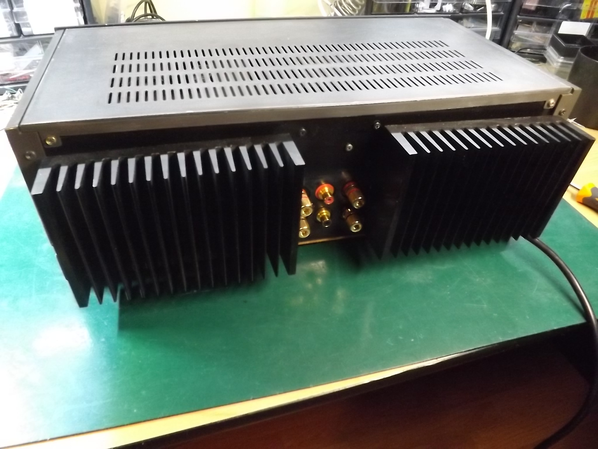

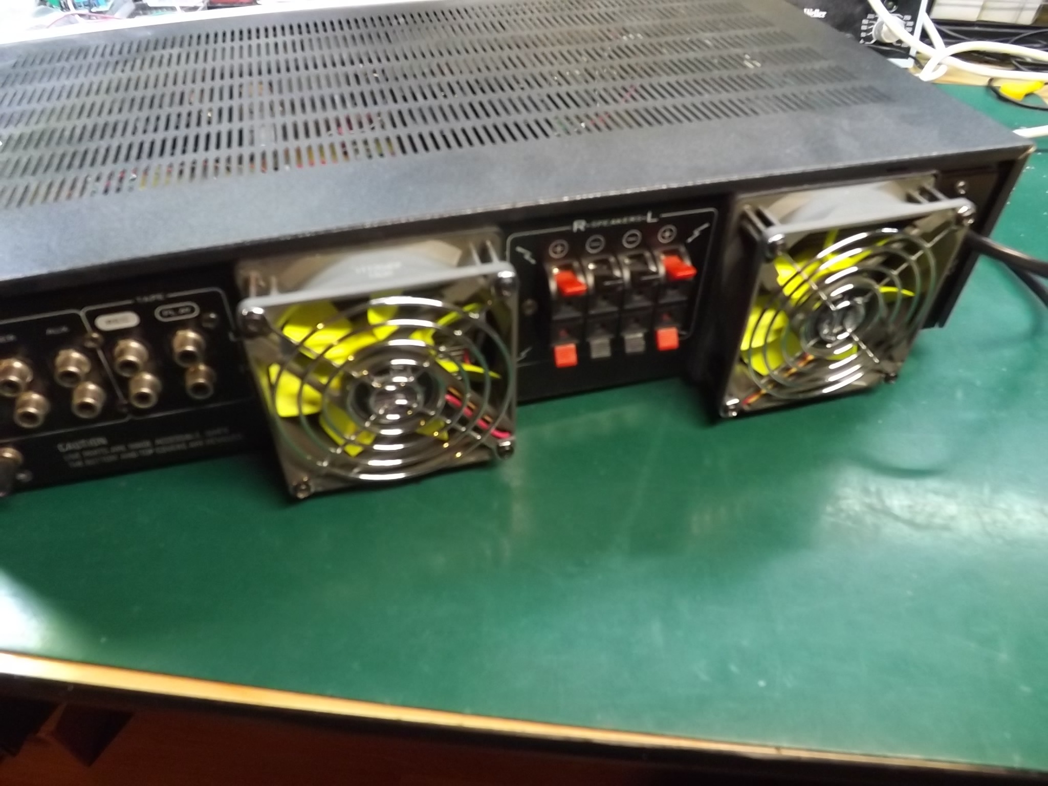

Yes, you can indeed get absolutely great audio enjoyment from a class A amp.

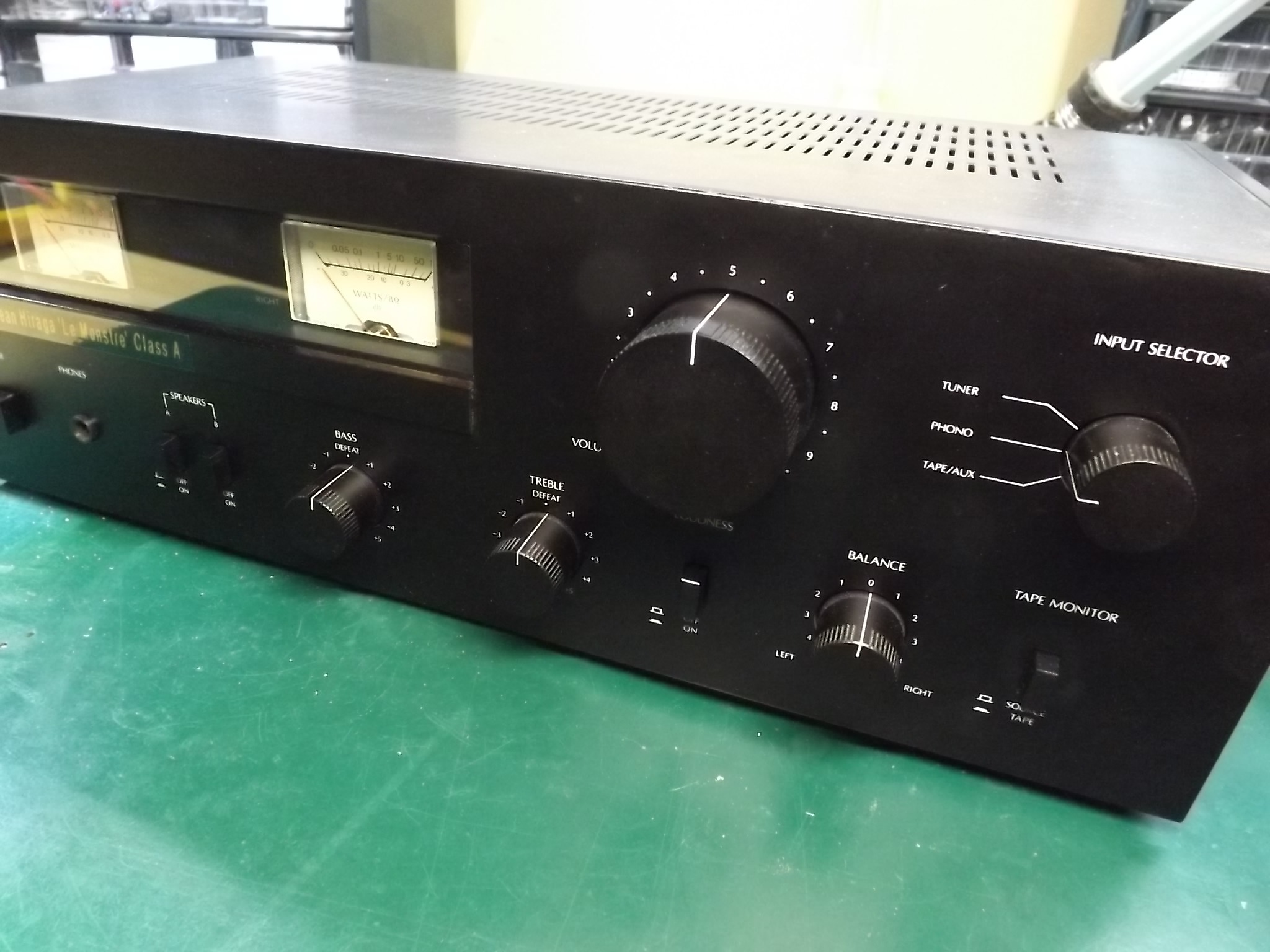

The trouble with even an 8 Watt 'Le Monstre' is to manage the idle heat produced in class A.
I have two JP Hiragas (both home built on a shoestring budget, of course). One (built into an old Sansui A-40 case) has big passive heatsinks, see pic.
The other is built into a smaller Pioneer SA-410 case using CPU heatsinks cooled by two fans at the rear.
Mind you, I went through a lot of 80mm fans to finally find some (and a way of driving them) that didn't have an audible buzz or whizz.
But both amps now keep the heatsinks at touchable temperatures.
And they do sound outstandingly wonderful!
I now sometimes use them as comparison 'yardstick' for my Rotel upgrades.
Per

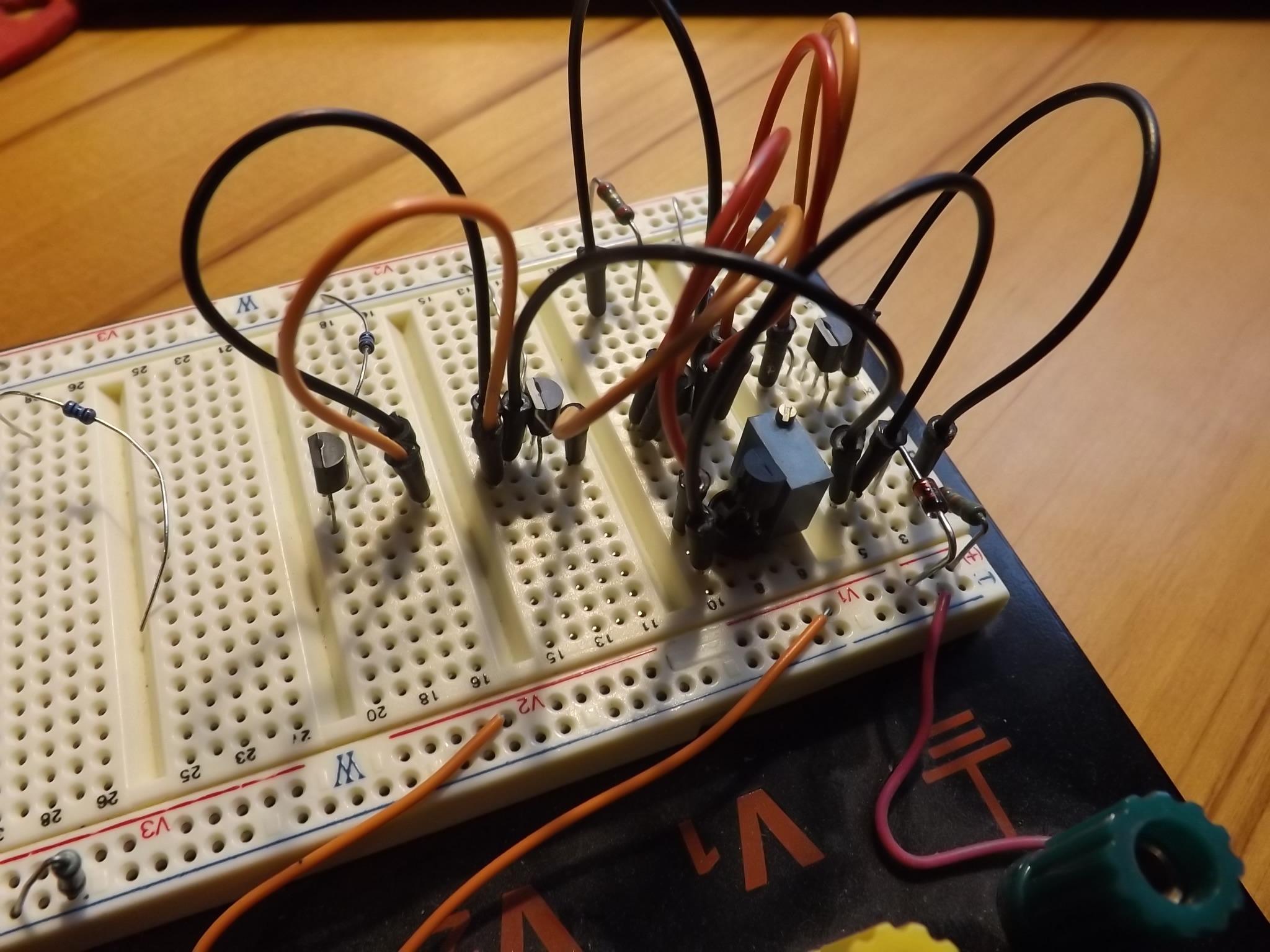

Firstly, a general warning: You should not do upgrade circuit experiments like this in a working amplifier.
Well actually, you can, but at your peril. You will very soon find out how much ’oomph’ there is in those big reservoir capacitors long after you’ve panic hit the off switch!

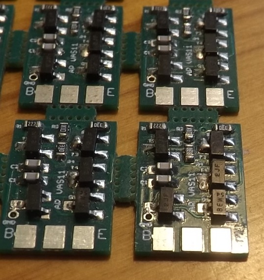

Therefore, I chose to breadboard one of the LTP-CM-EF-VAS halves on a plug-in ’fumbleboard’, well supervised and current limited by two bench power supplies and as many DMM’s I could hook up.
After the usual stupid flying wire connection mistakes, I got a stable VAS current in a variation of Chalky’s original idea in which I ditched the last PNP emitter follower and instead used a parallel pair of VAS transistors to keep the heat dissipation of each in check.

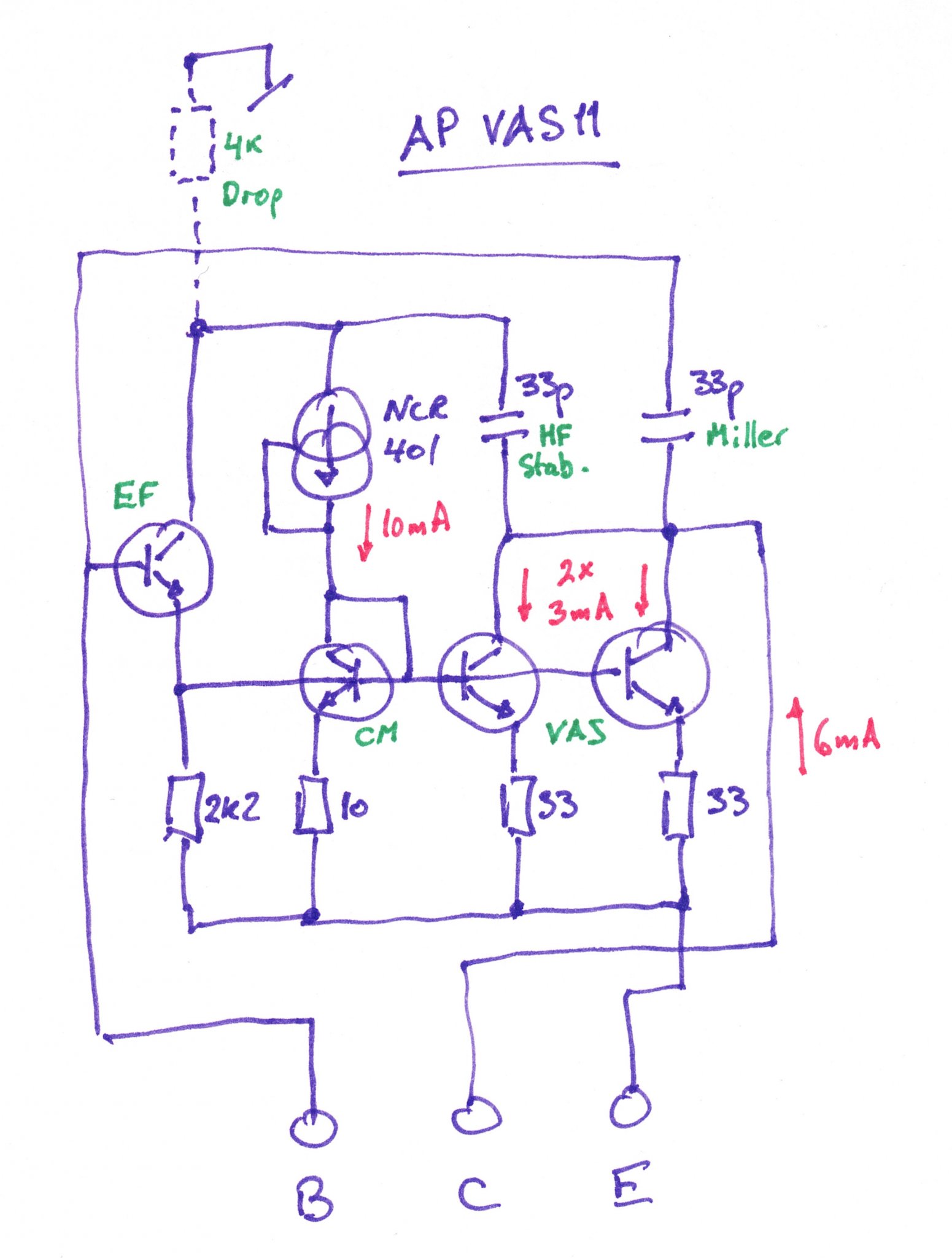

Because of the promising results I decided to CAD things up only to find that I was out of real estate on the VAS module pcb - and I couldn’t place a traditional current source onto it without making the module too big – or production very difficult indeed.
I could just fit one more SOT-23 and maybe squeeze in one more 0603 resistor, so I first thought of using the trusted old LM334 (which, BTW itself is a class act in clever use of current mirrors - if you're into that thing). But I soon learned that it was not available in SOT-23 – at least I couldn’t find any or indeed anything comparable.
Fortunately, there are now mA LED drivers in SOT-23 packages and I chose the NCR401.
It is basically a classic 'two diode / one transistor' 10mA (nominal) current source - all on a chip. Which means that it should theoretically also be lower noise than more complicated current regulators. And no extra resistor is needed.😌
One drawback is that it can’t take an amp’s 50V+ rail voltages, so I decided that a drop resistor in the ground wire would be acceptable, whereby it only ’sees’ about 15V. And a second was that it has no adjustment option to get a lower current, so I had to work with the 9mA.
The circuit I finally decided to have made into VAS11 pcb modules looked like this:
(yes, you read that correctly....VAS11 (!) - there has indeed been quite a few ideas and iterations since VAS3 and 4 over time)
All transistors are KSC1845 (or rather FJV1845). The NCR401 sources 9mA and the differences in emitter resistor values should give a VAS current of 3mA through each of the VAS transistors, 6mA in total. At least in theory.
The external resistor (4k for 50V rails) at the top drops the voltage by 35V (so it should be a 1/2 W or 1W type - and it does get hot!).
But VAS module dissipation is quite well spread out over the pcb and less than 400mW total.
So, did it work?
Well, not exactly as planned….😳
TBC

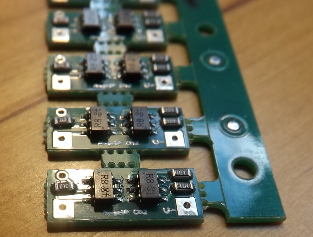

I got so carried away with optimism over the promising VAS results that I skipped the safe but tedious breadboarding of the design and, yes - I went straight ahead and put the modules right into the RA-971 (in clear violation of my own principles of caution and proper due diligence).
The result was of course inevitable – blue smoke (but not from a cigar).
A bit (ok, very) disillusioned and disgusted, I put the project on the shelf for... (cough)… a number of months (read: a year).
⏳/😶/:shutup:
But ok, I was kept busy repairing and upgrading a seemingly never ending stream of RA-800/900 series, RA 01’s to 05’s, but also some DDiPPVAS amps like RA/RB971/980/991’s.
Although in these, I decided to forget all about using a LTP current mirror and kept the existing LTP collector resistor and VAS transistor while finding the best place on the pcb to put a discrete TO-92 EF in front of it.
Admittedly, this works very well indeed, but it is fiddly and requires track cutting, drilling and scraping solder pads plus strict concentration to get absolutely right – not easy DIY stuff, imho.
And of course we all would ultimately like to ’up the ante’ with current mirror modules.🙏

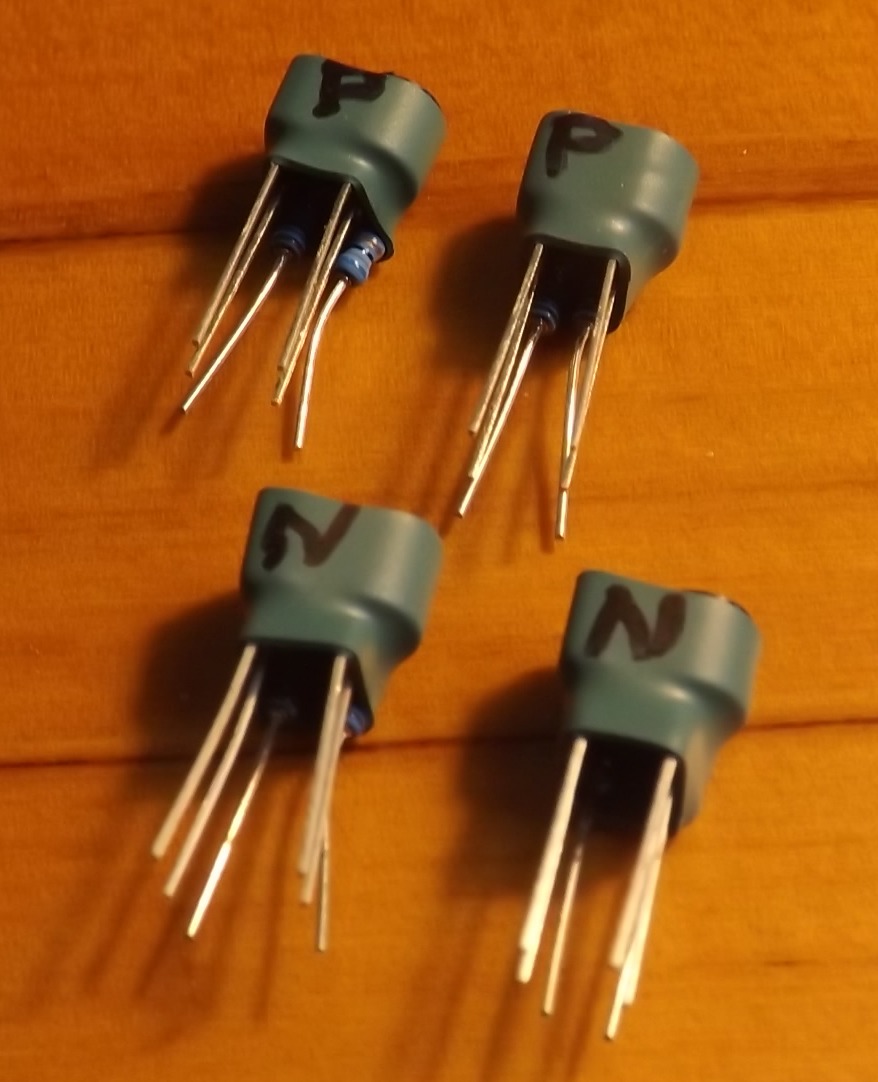

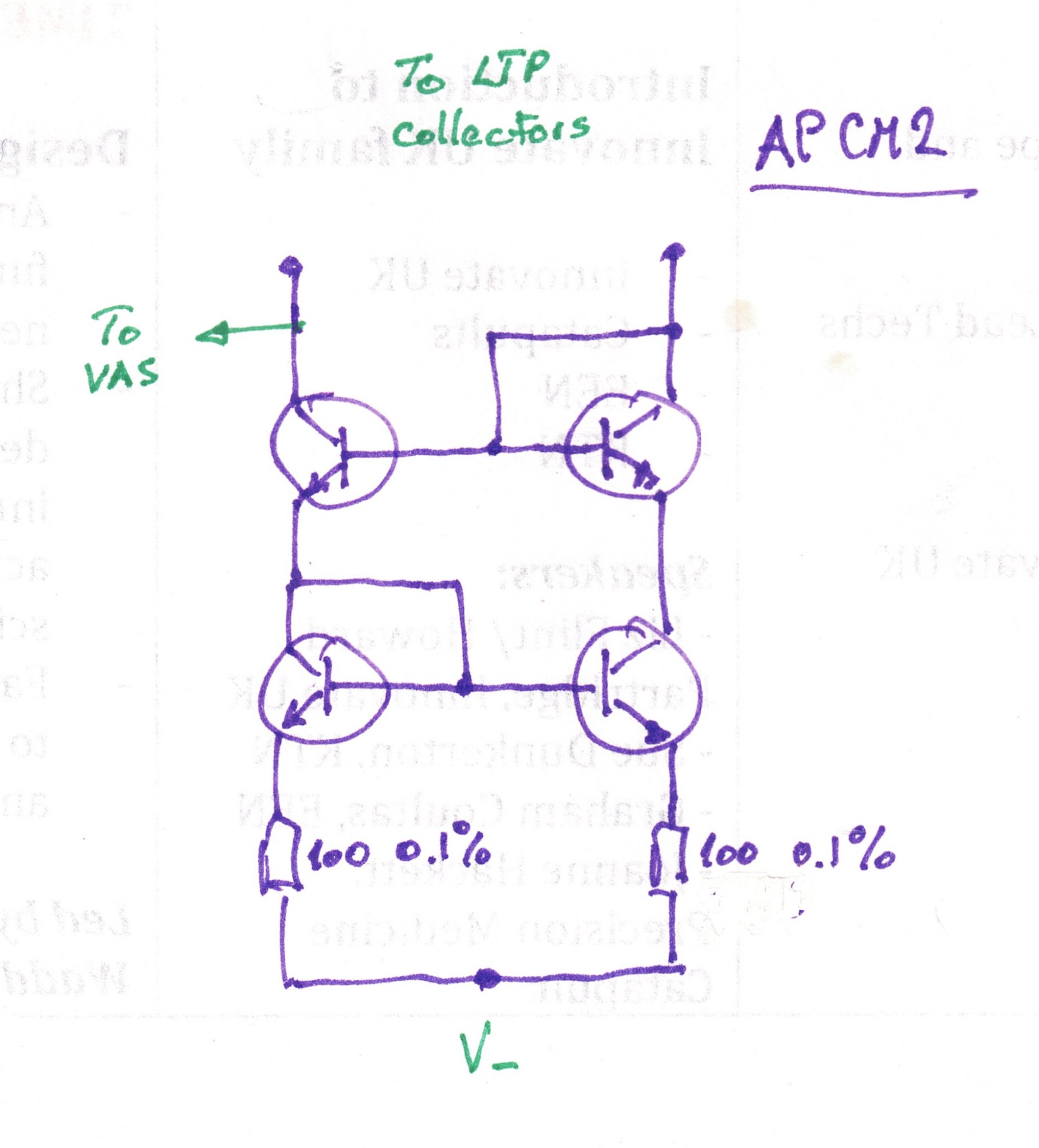

Speaking of which, I made a new CM2 version of the LTP current mirror module, making them into improved Wilson mirrors, further improving linearity:
Using two BCM847 matched transistor pairs greatly simplifies the need device selection for parameter matching and is really little more effort than making the old CM1.
With 2mA through each LTP collector, the voltage across the mirror is 1.5V, so the BCM’s have no problem operating within high voltage rail amps.
(You may note that I actually also made space for a resistor between the LTP collectors – in case I was wrong in outright discarding the ’helper transistor’ solution. You see, being wrong is not an uncommon trait of mine).
These CM2 current mirrors work perfectly, giving a better current balance for the LTPs to enjoy and do the ’voodoo that they do so well’.
TBC
To complement the improvement by the new CM2 mirrors, I also decided to put in emitter degrading resistors in the LTPs.
Now, ”degrading” sound like the opposite to ”upgrading”, but it is actually a brilliant idea (and excellently described by D. Self in ’Audio Amplifier Design’).
From memory it reads:
All transistors have a finite collector to emitter resistance, roughly equal to 25/Ic (in mA). So, eg. for a 1mA current, this internal resistance is 25 ohms.
Unfortunately it is not linear, leading to added distortion.
Adding resistors to the emitters of course increases the total resistance, but discrete resistors are linear. So, putting in 25 ohm ”degrading” resistors but then increasing the current through the LTP to, say, 2mA - we have replaced 25 ohm of non-linear internal resistance with a linear.
And increasing LTP current (while carefully minding their temperatures) has a second advantage as it provides more current to faster (dis-)charge the Miller capacitors, giving a faster amplifier slew rate.
(You can also see such resistors used in Cordell's schematic in post #825)

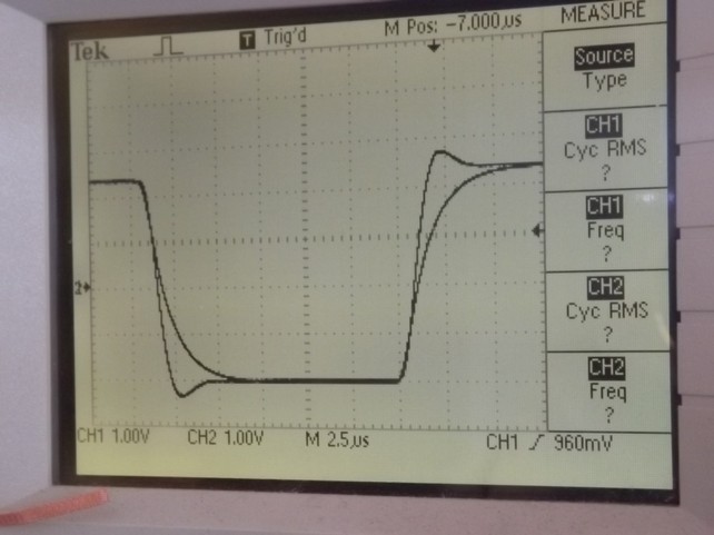

And speed up it does. This trace is from a RA-931 fed with a square wave, showing the difference in the speed of the signal response (Slew Rate) before and after adding the emitter degrading resistors. In fact, it now has a small overshoot which doesn’t look good on paper, but we don’t normally play square waves through the amps, so it is probably of limited concern.
But if needed, it is easy to correct by increasing the HF rejection 100pF PP capacitor from the LTP input base to ground - to eg. 150pF.
However, physically fitting in these emitter resistors are again quite fiddly.
So, to follow my goal of making things easier for my fellow DIY’ers (and chiefly, myself), I decided to take the fiddle out of the performance by making…....(drum roll)🥁…. Heatshrink-Wrapped-Pre-Mounted-Emitter-Resistor-Close-Matched-Transistor-LTP-Units.
(Still working on the acronym 😊).
These units are now simple direct drop-in replacements for the LTPs on the pcb.
Thus armed with a improved front end setup – was it then time for a final courageous frontal attack on the stubborn VAS modules?:sarge:
Stay tuned to find out....
