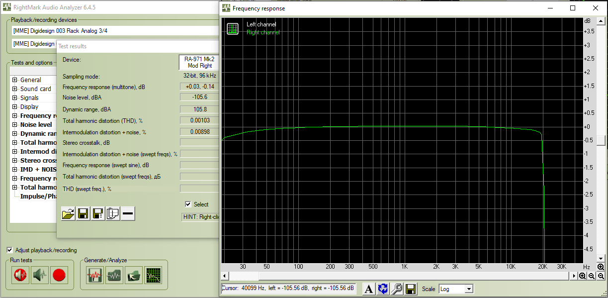

Hi Tom,
Well, you seem to have roll off at both ends.
Low end:
Did you increase the NFB 100uF capacitor C607 to 220uF?
High end:
I should have seen this on your schematic, sorry. You have run into the same problem I described in post #427. Shorting the input cap now makes the 12k connect directly to the 330pF HF cap C603, making a nice (but unwanted) 40kHz RC filter. Remove the 330p (or make it 100p), but make sure that the corresponding HF cap in the preamp's input is still in place - I think it is C503/4.
BTW, I also now see that you reduced the 3k3 R651 to 330R while keeping the 220pF - you could try to change back to 3k3.
As for the sudden heating up, that probably indicates instability. Did you put a scope on the output?
Long distance diagnosis is always difficult, I would first double check that both 47pF Miller caps are in their right places and securely soldered.
If the problem persists, you could try increase them to 56p.
Per

Thanks so much Per!!
FR sorted. And good eye! Yes, I had popped the 100uF back in to see if that was causing any of the problems.
I don't know what I did with the other one, since it doesn't have the same issue - did I not make the coupling mods? Did I take out the cap? I'll have to have a look.
Anyway, pending scoping of the output (albeit with a very rudimentary USB scope), here's how the second unit is looking now.
Thanks again. It's really quite remarkable what's possible with this unit, and now that I have two of them, I'm even more tempted to try and take things further with the tranny addition.
Tom

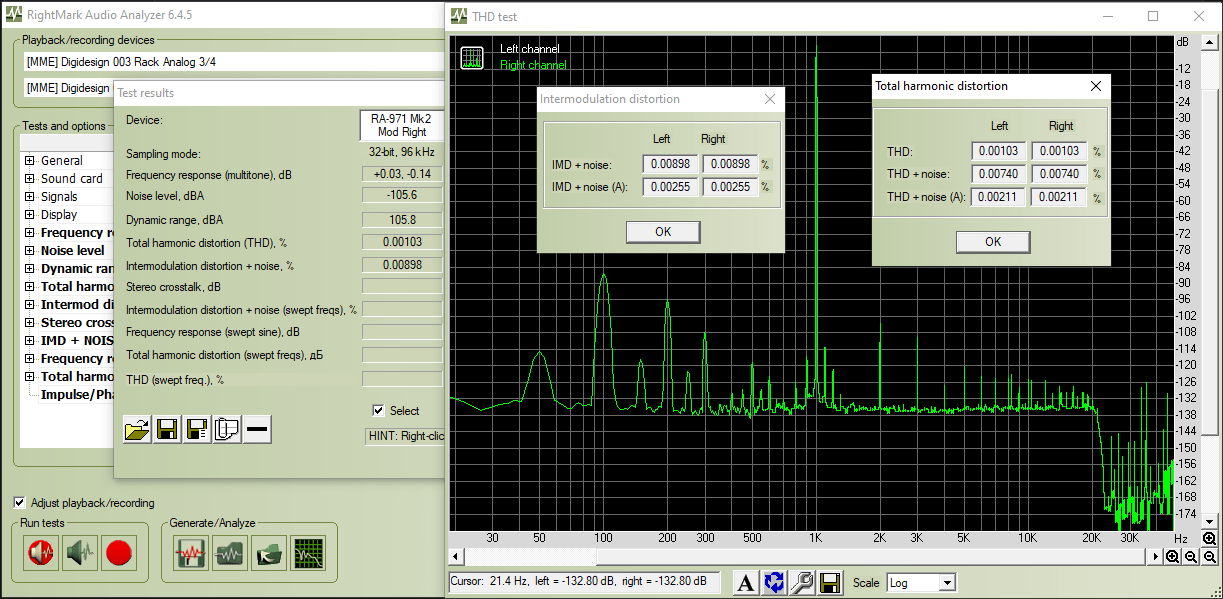

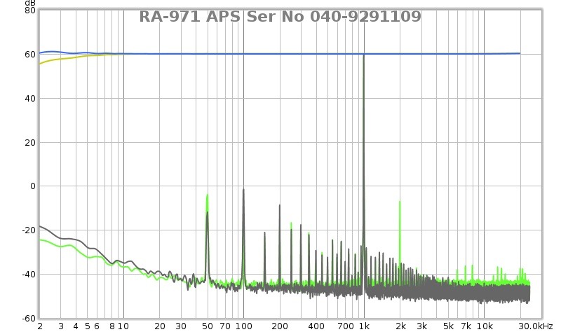

Hi Tom.
That looks better, although there is still something a bit strange with the roll-offs.
Which soundcard are you using - and did you obtain and use a calibration file for it?
I also see that it (or maybe the RightMark analyser) has a clear and sharp cutoff at 20kHz. That is probably done by using some high order filtering which can/will have some 'wobble' down in the pass band. So the closer to this cutoff you go, the less 'reliable' the measurement will become.
RA-971 APS measurements. Yellow and green traces before upgrade - blue and grey after.
I use XonarU7 with REW which perhaps isn't a perfect analyser setup - but a LOT cheaper than an Audio Precision device.💵💰
Again, the 50 and 100Hz peaks are probably more down to stray pickup by my measurement setup than real.
Actually, the ink on that point on my to-do list of 'pending instrument improvements' is actually fading away
Also note the slight 'wobble' down below 6Hz, but hey, try to measure those amplitudes with a standard generator and a DMM.
For the upper LP cutoff I do use a generator and a DMM on the output.
The frequency at which the ac amplitude has fallen below 0.707V of a 1V of a test signal is the upper -3dB point. On an upgraded 971 it is 185kHz.
Per

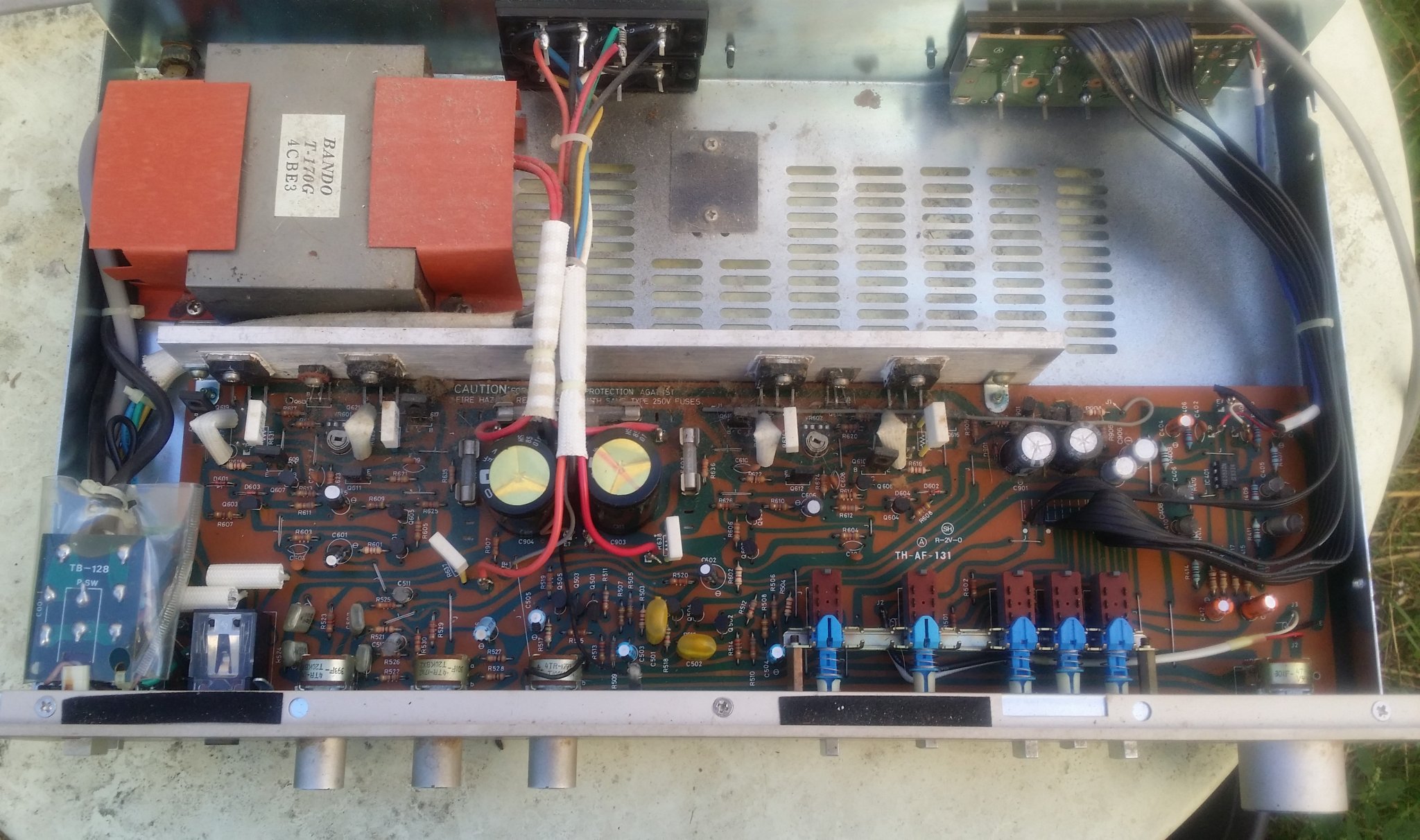

I am a few years late to the party, but:
I have an old RA820, and providing it still works, then it could be an interesting winter project to perform similar mods to those documented for the RA820AX.
However the circuit board certainly looks different to the photos of the 820AX circuit board, even though some of the components look similar (eg the IC), but are in different locations (especially the power capacitors I think).
I can't find an RA820 circuit schematic on the web, so does anyone have one that they could post, before I progress any further?

Hi Magicm31,
I don't have a tech manual on the RA-820, and no, there are none on the web that I could find.
Actually I have avoided all the 'thin' versions of the 800 series mainly because their pcb's are clearly taped up by hand with components and jumpers in all directions - not very professionally IMHO. Any upgrade will be fiddly stuff.
You are thus facing the major task to actually re-draw the layout and schematic - and then deciding where possible upgrades could fit in. Quite some work unless someone comes forward with a manual.
