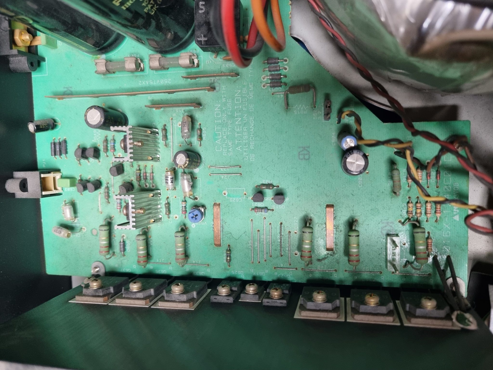

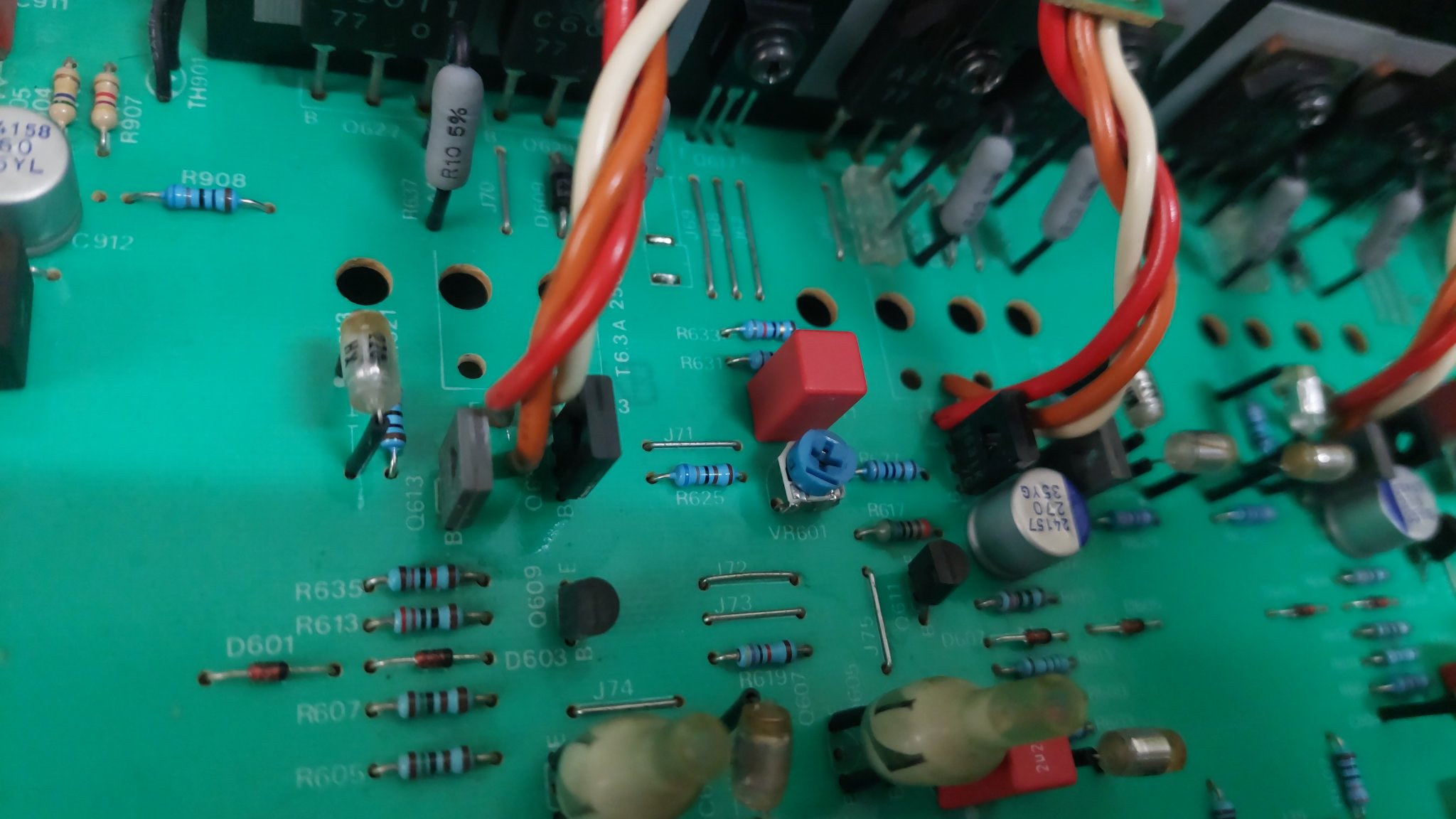

These are some photos from couple weeks ago, since then I changed the VAS transistors from BF469/470 to C3423/A1360
So the whole list of changes as follows:
All capacitors changed where possible to Wima MKS2
Changed value of relay delay capacitor to 560uf
Filter caps changed to 2 x 22000uf CDE
Pre-amp resistors changed to new ones from vishay, zenner changed to new ones to drop voltage to 32-33V
Increased capacitors for pre amp from 470uf to 2200uf, replaced 220uf de-coupling caps to Wima 10uf
Replaced 10uf coupling caps to Wima 2.2uf
Replaced input resistor from 47K to 12K (-1.5mV/-3mV on left right channel now)
Replaced Vbe multiplier transistor to KTC3114 (it seems to be the best there is for this job, very high hfe and ft)
Bias now stabilises in about 2-3min to 8mV rock solid
Replaced output transistors to Sanken C6011
Replaced drivers first to C4793 but then to C5171
Replaced also pre amp stabilisation transistors and relay transistor
Also replaced VAS resistors from 100R to 330R
Also input cap changed from 330pf to 100pf styro
Also emitter resistors changed to 0.10R from 0.22R
Added opamp sockets
I will add more recent photos tomorrow
Maybe I missed some changes 😅

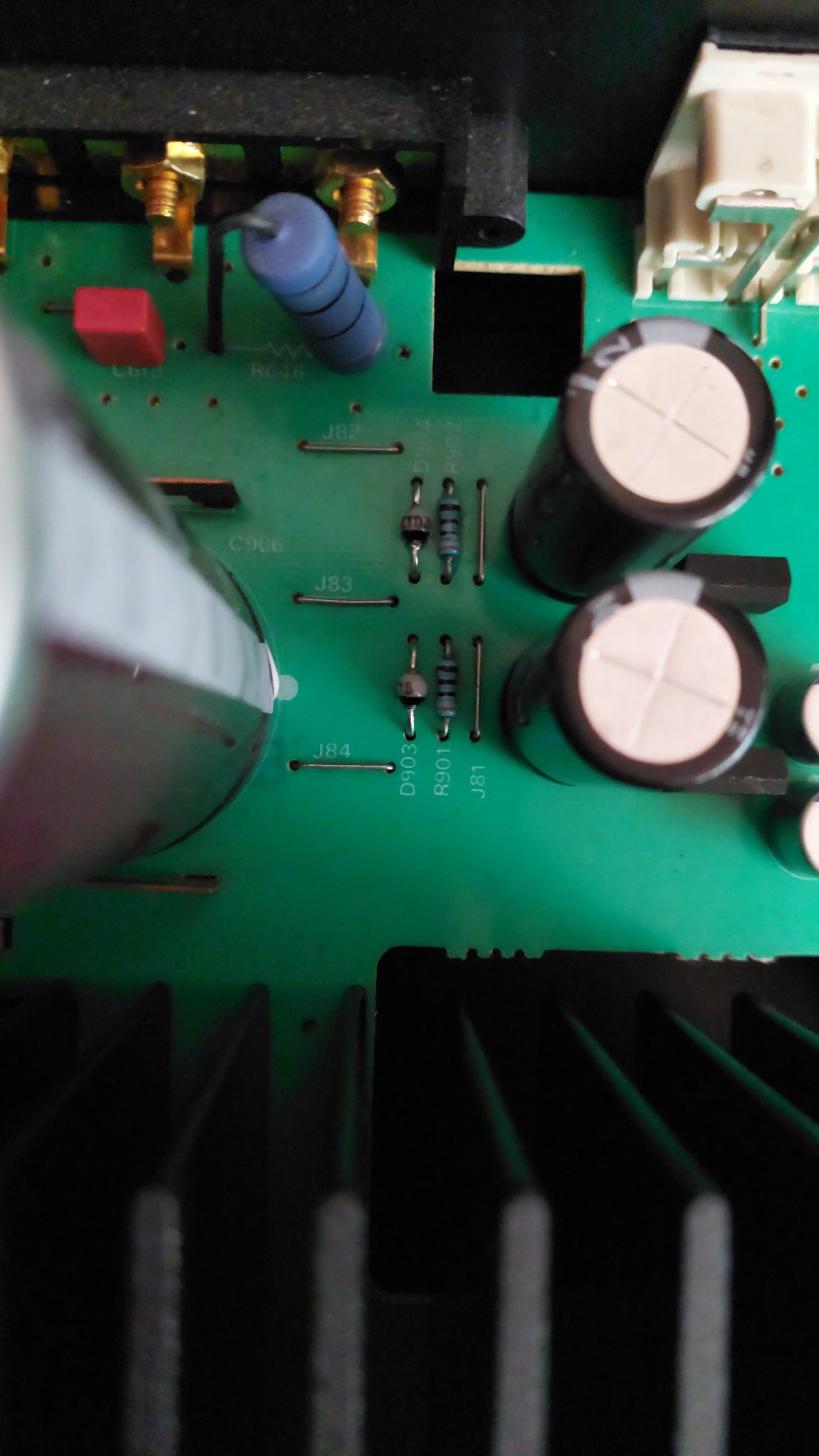

Good day, i had a few minor issues with my RA-02 and put it down to it needing to be recapped. Main issue was the right channel sometimes loosing significant gain, turning the amp on and off fixed the issue. Otherwise i was very happy with the amp which i have had for 20 years.
Following a lot of info from these forums i recapped all the electrolytics, replaced ceramics with silver mica's in power amp section and replaced the input resistors.
However now when the amp is turned on and speaker selector is engaged there is a big pop (like high gain) through the speakers and slight hum. I'm not keen to do this much more because it sounds like hell on the speakers.
Any ideas/help to diagnose where i go from here will be much appreciated. Definitely a case of curiosity killing the cat.
Erm, you replaced the compensation cap? I think there's a small chance of oscillation from the symptoms, especially the appearance of hum (due to oscillation destroying the PSRR) and the DC offset that's clearly now present. But there are many possibilities, which is why its wise not to swap everything in one go. First step unplug speakers and measure the DC offset - I'd suggest not running the amp for long in case things are overheating.replaced ceramics with silver mica's in power amp section
The original gain issue could be various things but simple loose connection or cracked solder joint is most likely.
Thanks for the speedy reply. I originally tried the mod on P36 in this thread to a tee. Problem presented so fitted same value in links, put non polarised 10uF in 601 and 602 and 100uF polarized in 605 606. For the mod i was using 220uF non polarized on C605 and C606 and 6.8uF MKP on 601 and 602.
DC offset is at .2mV which is low. So guess i'll start by adjusting that?
Offset is now at 4mV and same issue. The mighty pop goes through the right only then both hum. Quicky turn it off. I have double checked and triple polarity of everything replaced.
Most definitely at 4mV at the test points and on the speaker outputs with no load. I’m at a bit of a loss. Have resoldered everything in case of dry joins etc..
Well, you need to employ some good staged old fault finding. I guess that you don't have a scope?
Anyway, an offset of 4mV dc is more than respectable for an old Rotel - but what is the ac value? Both channels? If ok:
Isolate the problem by grounding one end of thumping channel's R601/02 and turn on. If the thump is still there, you have most probably narrowed the problem area to that channel's power stage. And we'll go from there.
Disclaimer: Remote fault finding is not the easiest of disciplines.....!!!

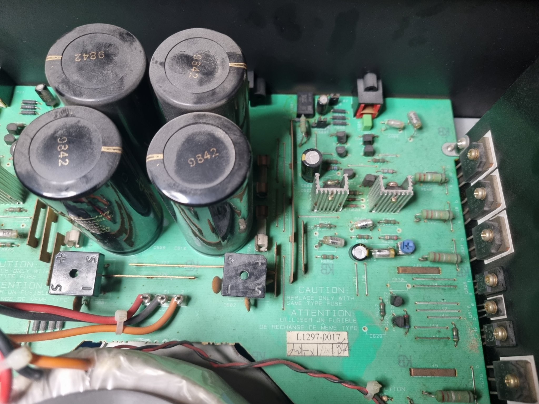

Hi folks,
I have a Rotel ra-01 with blown outputs on one channel, I've sourced replacement output transistors but am not having much luck with trusted sources for the driver transistors, what are the recommended replacements for these? I believe the power amp section of this amp is the same as the RA-931 of that helps.
I have used TTC04 / TTA04 from Toshiba with very good results in RA-931 and others.
And yes, the RA-01 uses the same power stage design and it it quite forgiving to component changes.
But why/how did the drivers blow in the first place - or are you just proactively changing them as they sit close to the blown power trannies?
Per

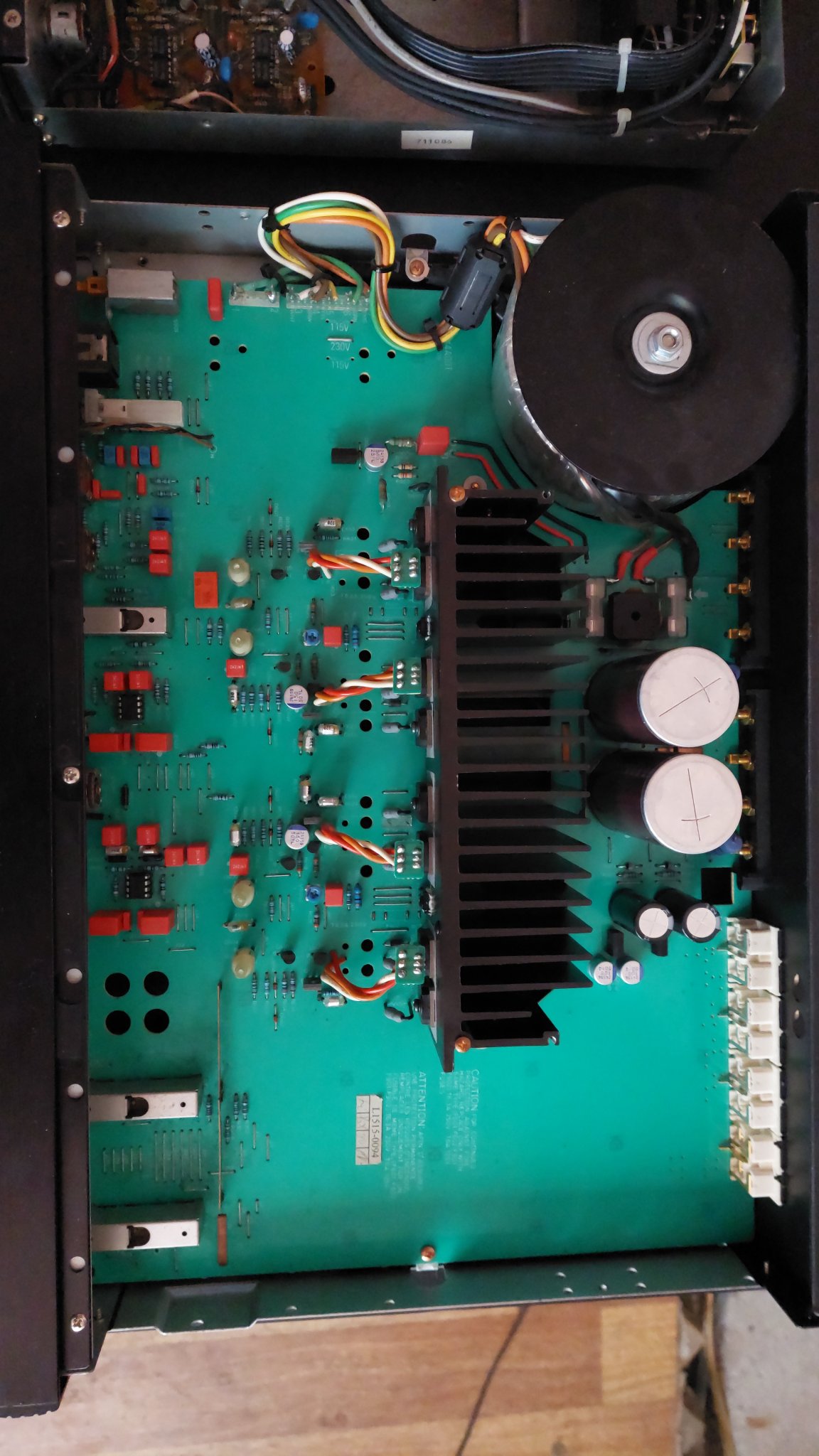

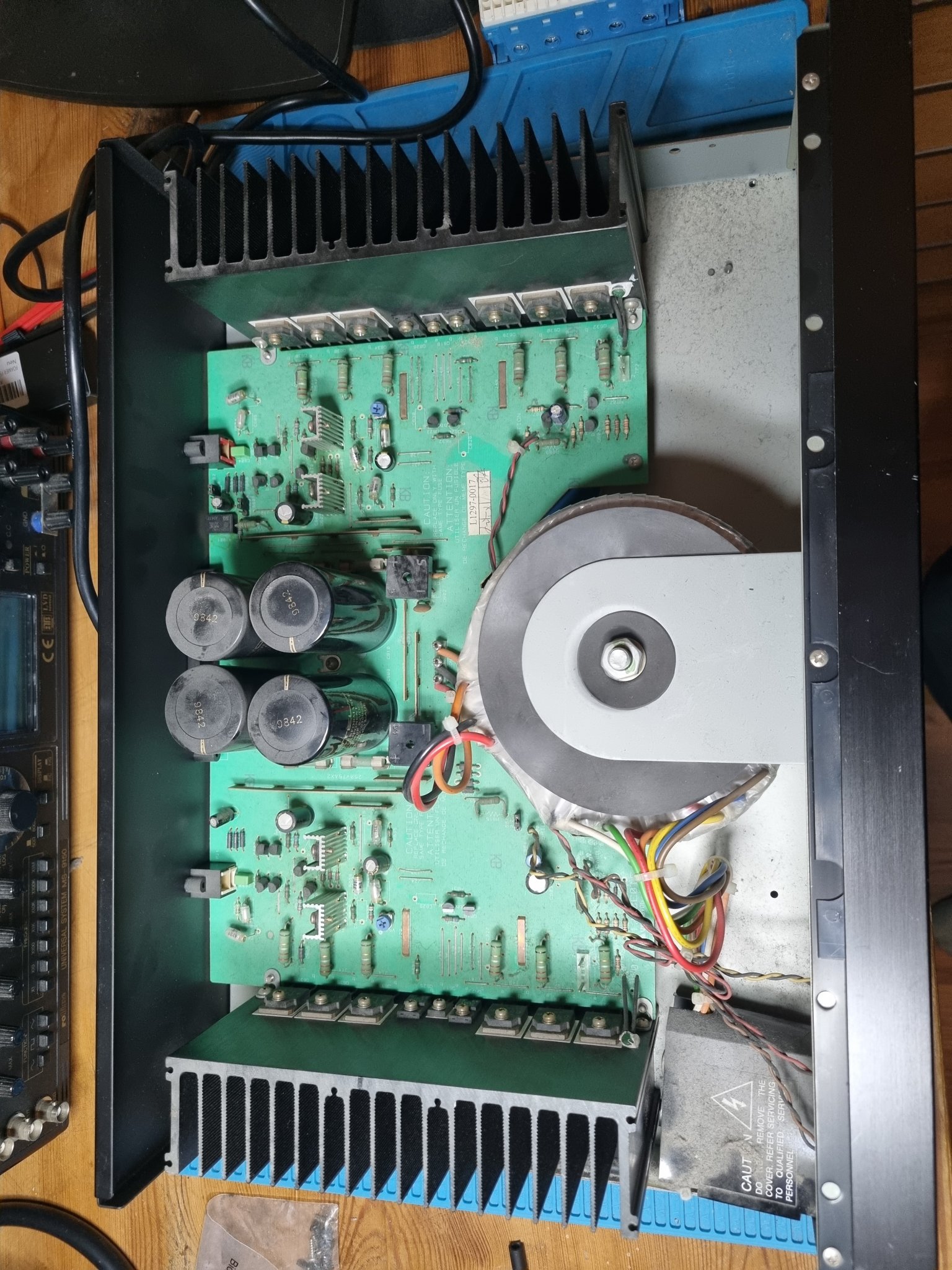

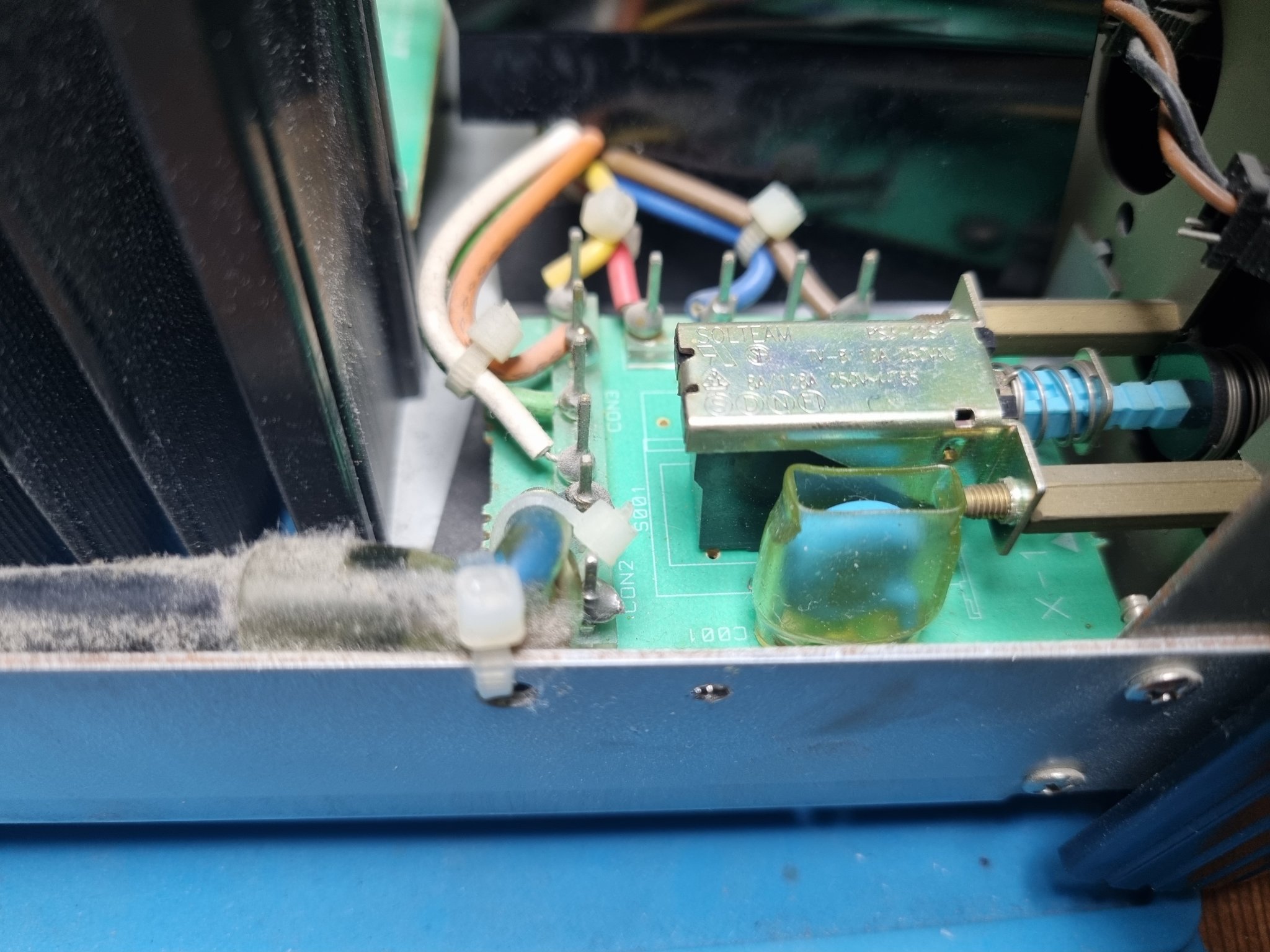

Hey there,
i know i am late to the party, but after reading through most of this thread i was so impressed by what Per started an achieved that i got the hifi bug again. i ordered a RC972 / RB981 on the bay.
While the seller told me they are working just fine i might disagree slightly.
In fact i was a bit disapointed firing everything up. Just like described by others it sounds "muddy" missing detail and punch.
even compared to an old Onkyo receiver.....
I was also quite surprised how much the amp vibrates with music playing. if you touch the case while playing a song i am fairly sure i can recognise the song even with speakers off 🙂
I opended it up and took a few pics to show the state it is in, and i am planning a few steps to get it up and running nicely again.
I will start with the Poweramp, and since its quite similar to smartdrivers 991 i will start with a few repairs and mods as described @ #393.
anything else i should replace?
i am looking forward to some tinkering, and brushing the dust of my scope.
however, i might need some advice on the way,
cheers!
- replacing caps would be the first thing, as a general question i wonder if you guys would replace all capacitors, or only electrolytics and foil.
- replace spark killer C001
- replace power supply caps
- i would like to replace C611/C612 with Wima MKS2 10u 50V, and compare the sound with electrolytics
- replace C623/C624 with Wima MKP4 100n
- replace VAS Resistors R623,R624,R629,R630 with 187R 1% 0.5W metal film
- replace trimmers with 2.2k Multiturn Types
- replace Transistors Q607–612 with matched 2SA1016KG-AA
cheers!
Jürgen
Hi yurgs,
Honestly ... if it passes audio it is working fine in many people's minds. They were honest in that regard.
Do not replace every capacitor, you don't need to do that. Most coupling capacitors will be fine. They are sized so not signal voltage appears across them, so unless the originals are defective you will not have any performance increase. Polyester capacitors aren't very good either if you want to look at it that way, so you are exchanging imagined problems. Power supply and bypass may be rough. The main filters are often okay, check with your oscilloscope.
Do not use multi-turn pots! Leave the originals unless they are truly bad. Some fixed resistors will matter, most do not. Cheap metal film resistors are worse than the factory ones. Matching the diff pair very closely will matter.
Is the spark killer bad? If not, leave the poor thing alone. There are other things you can do that solve the issue I think you're trying to protect against.
-Chris
-Chris
