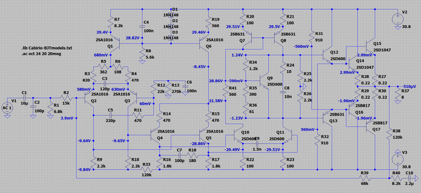

In case it helps if/when LTSpice is eventually used, I have tweaked models for the small signal and VAS/driver transistors, based on actual measurements of the ones in my 820AX, here:

Ok, I've checked the 2SD1047/2SB817 models I have and they seem to be accurate enough. Although I could only match the actual measurements at low currents, I also matched to the datasheet quasi-saturation, fT(Ic) and beta droop at high currents, as well as the on-chip ballast resistors. Please find attached the updated file with those models included.
With all those caveats (plus the additional one that, unlike a real PCB, LTSpice connections have no parasitic L, C and R), I think the rather interesting compensation scheme we have here deserves at least a stability simulation, just to see what we get. Stay tuned...

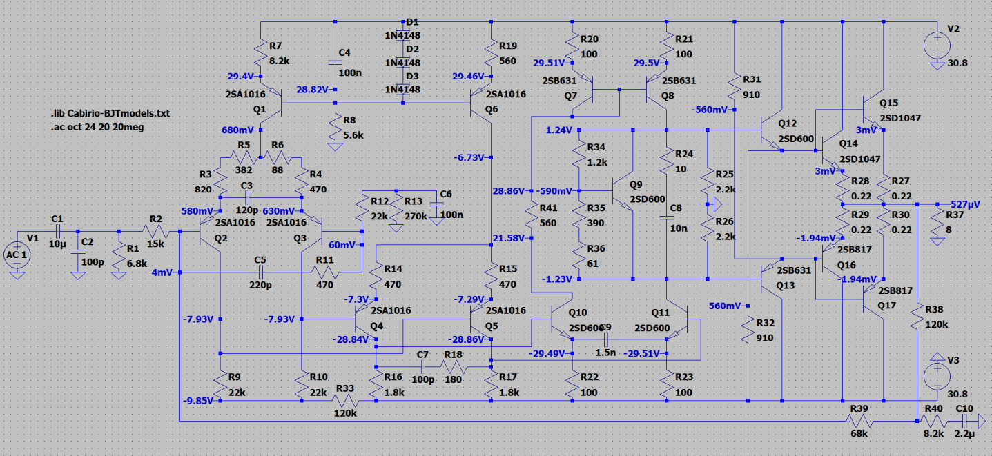

AngelP, R613 is an erratum, it should be 2k2 rather than 22k, no? Assuming this and after adjusting for offset and Iq, I get these currents, mostly close to what you've measured except for the VAS:
Q603/Q605 (LTP): ~85uA
Q617/Q619 (VAS): ~13mA
Q623/Q625 (drivers): ~35mA
Output transistors: ~11mA
Attached the ac simulation for your perusal, models file posted above.

You could also post the simulated DC voltages - would perhaps be of help.after adjusting for offset and Iq, I get these currents,
Sorry, there was a mistake in the .asc file above, this is the correct one. The voltages in the picture are fine, it's just the 220p cap going to the collector of Q2 instead of the base. Please delete the previous one and replace it with this one if you downloaded it.
Looking at simulated voltage vs. handwritten note on the schematics offeret by Per, I would think that R9 and R10 should be 22K not 2K2.
Maybe Per can confirm installed values?
Sorry, you're right. I downloaded a clean service manual to copy the schematic and didn't pay attention to your notes, Per. To clarify we're talking about R611/R613, the LTP load, could you please confirm? While you're at it, take a look at R673/R675, the VAS emitter resistors, I'm still getting ~13 mA vs. your measured ~23 mA. See the new voltages below, but I won't post the corrected asc till we're sure it all checks out...
Twice the current thru VAS transistors in real like compared to simulations would explain why they get burning hot.
Could there be damage (short) in c611 of Per's real amp (c9 of asc file)
That wouldn't make much of a difference I think, there's very little voltage between the emitters of Q617 and Q619. Other than the transistors being damaged, which is a possibility, my bet would be on R673/R675 being something like 47R instead of 100R, or even those being correct but R625/R627 (R16/R17 in mine) being something like 3k instead of 1k8. Both those options would result in the measured ~23 mA. Typos and errata aren't uncommon in Rotel service manuals...

Yes, I can confirm that that the collector resistor R611 is not 2k2 as per the schematic, but actually 22k – same as R613.
And yes, I miscalculated the VAS current, it is indeed 13mA - which still makes the un-cooled VAS trannies run awfully hot.

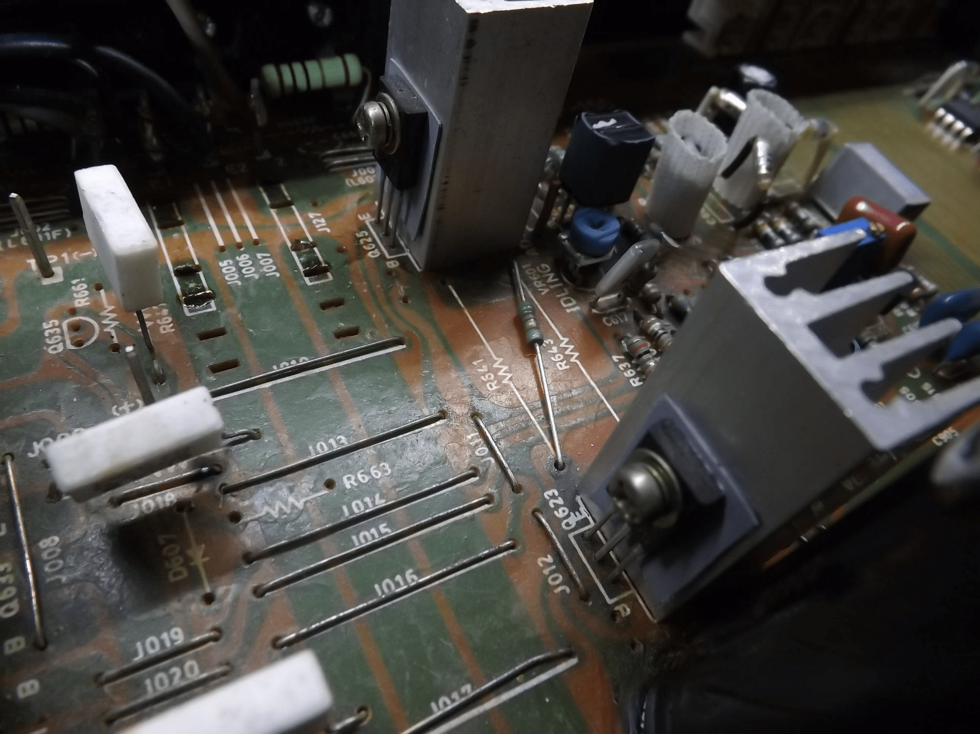

Rotel RA-820BX3 Circuit Origin and Stage 4 Changes:
Well, it appears that this amp is not Stan Curtis’ work. It is (almost) a carbon copy of a renowned design by Lohstroh and Otala first published in an IEEE paper in 1973 - with the modest tile: An Audio Power Amplifier for Ultimate Quality Requirements.
I haven’t yet read this original paper, but Doug Self has a nice review of this Four Stage Amp topology at the start of the Amp Architecture, Classes and Variations chapter in his excellent book, Audio Amp Design.
So, the Rotel engineers simply took this design and did not dare or want to alter it, and to my knowledge nor has anyone else (although I will probably be solidly corrected on this). So then why should I start to mess with this classic design?
Well, there is the overheating issue that needs to be rectified if this amp is supposed to last another couple of decades. The FR-2 pcb will continue to blacken and crumble if nothing is done about it, so that is the first job.
First, on to Stage 4 and the big 910R 2W feed resistors to the driver collectors. I believe that the original idea was that these would keep the stage in Class A for longer with currents to better cut off the output transistors. That ‘better’ has later been debunked – a single 47R or 100R ½W resistor between the driver emitters does the same job, with far less excess heat produced.
And as it will only have 1.2V (two Vbe’s) across it, so the driver current can be reduced from 35mA to 12mA – which will make the driver transistors and heatsinks run much cooler as well.
I then decided to increase the output bias setting from 2.5mV to a more 'normal' 5mV, giving about 24mA in each power transistor, as they are the ones doing all the hard work. With ±31V rails, the heat sink can easily cater for the heat produced, even with the extra set of output transistors compared to the RA-820AX. The heat sink doesn’t even get warm to the touch.
I would say that’s the stage four heat sorted.
