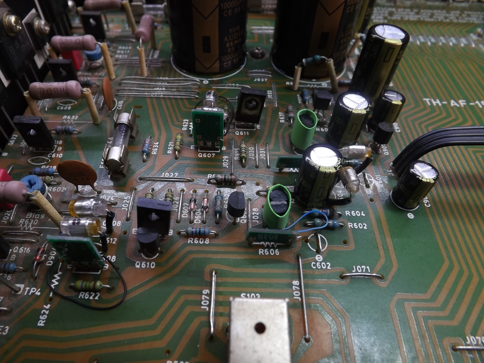

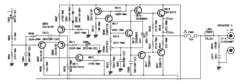

Stage 3: Power amp
There have been quite a few changes in my power stage upgrade approach since the first posts on this thread 4-5 years ago. I have given up on cascoding, etc. - it worked beautifully, but it always led to a melange of bent transistor legs and airwires. I also now have abandoned the rail filters as I found that if you put in a concerted effort to get the input stage precisely balanced, the Power Supply Rejection Ratio (PSRR) increases sharply (which I should have known - as when I worked with sensitive medical circuits I saw first hand what mis-loading a precision opamp does to the PSRR – it drops like a stone!).
This also does away with the need for cutting pcb tracks, drilling holes and scraping open solder pads etc. which appeals to me (yes, I am indeed a lazy plonker) but also increases the overall reliability of the upgrade.
So, key is: a) precisely matched input LTP transistors, b) balancing their base resistor loads, c) a good current mirror, d) a more advanced VAS stage and e) removing Rotel’s heavy VAS loading.
Thus I will be removing 13 components in each channel – for Lch: C601/605/607/609/611/613, R601/603/605/623, Q601/603/607. You can choose to do each replacement one at a time, but I normally remove all 26 at once to get better access to clean up the pcb. See pic.
And so, here we go:
C601/02 – replace with a wire short. (Direct couples the stage to the preamp).
C605/06 - repace with 220[FONT=FreeSans, sans-serif]µ[/FONT]F FM. (Improves the low SPL and phase linearity).
C607/08 - replace with 27pF PS. (Low value cap for extra HF stability).
C609/10 – leave open. (VAS load reduction).
C611/12 - replace with 68pF PS. (Second Miller feedback capacitor).
C613/14 – replace with 1[FONT=FreeSans, sans-serif]µ[/FONT]F film. (Helps output stage de-charge at crossover).
R601/02 - replace with 681R MF
R603/04 - replace with 19k6 MF (Maintains stage gain while matching both LTP input transistor base loading to 8k2).
R623/24 – leave open. (VAS load reduction).
R605/06 - replace with the CM1 current mirror module, ensuring that the pin marked V- goes into the negative rail pcb hole. Blue wire is connected to one of the collector pins of:
Q601/03 Q02/04 – replace with matched KSA992 pairs.(Greatly improves input balance).
Ensure that the KSA992 with the lifted pin and blue wire goes in the Q603/04 pcb places.
Q607/08 – replace with the VAS3 module. Ensure that the pin marked ”E” goes in the corresponding ”E” hole in the pcb. Connect the black lead to the ground pcb hole left by the removed R623/24. (VAS3 contains more upgrade magic fairy dust, more detail later).
(Getting the modules’ orientation right is not difficult – in the RA-820AX all are facing towards the back of the amp.)
That’s basically all.
Nothing to it.
Measurements and listening test to follow. Stay tuned.

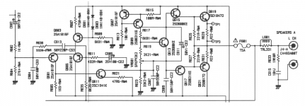

Hi Lars,
Yes, that power amp circuit schematic is exactly like the 820's (actually more like the 930 where Rotel started to put the input RC filter in (see post#363).
I'll just finish the RA-820AX stuff first.

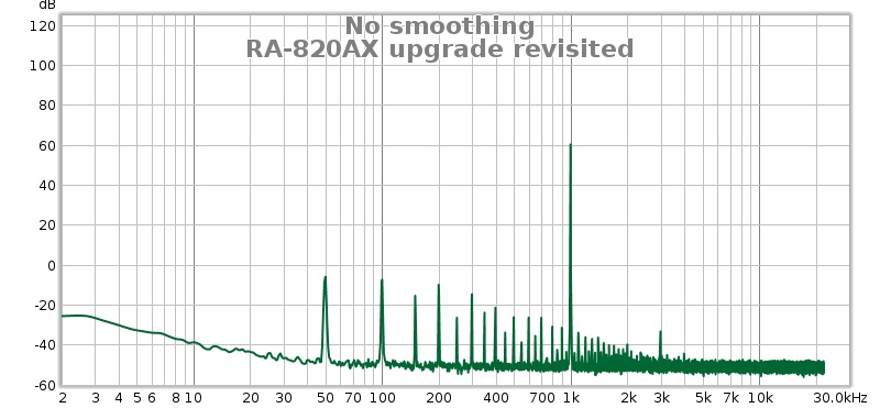

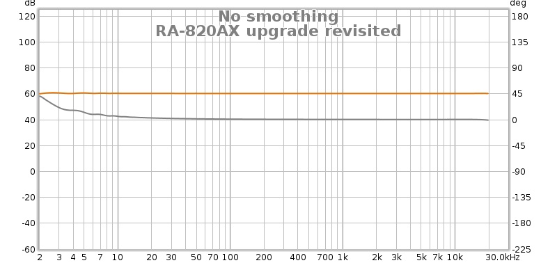

So, what do the measurements show now?
Output offsets are now: 0.4 mV / 0.8 mV.
Both biases steadied easily at 4.5 mV.
Supply ripple down to 18 / 22 mVac.
Linearity is now from 2Hz (-0db) (orange trace). Upper -3dB is at 160 kHz
Overall amp phase linear from 10Hz (+4[FONT=FreeSans, sans-serif]°) [/FONT]and up (grey trace)
1kHz THD now at 0.0027% (green trace)
I didn’t measure slew rate or damping factor, but in my experience they are better as well.
Pretty good outcome for three relatively simple upgrade stages, eh?

I measured 0.008% THD on the worst measuring channel of my RB850 at 1KHz and 2.9V RMS into a 10R resitive load.
However most of this sound characteristic comes from the PS.
I have also got an RA840BX. Maybe I should do your mods to see what the effect is. Must admit I wouldn't want it to sound more forward on brighter though.
My gear isn't calibrated to provide absolute THD values, but if I ensure that I use the same starting point and level every time, it can measure the differences between the upgrade stages. Hence the name of this thread.
