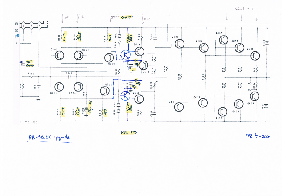

I’m very sorry I missed your “snubber“ question from March 3rd, 2020 post 400. I’m “down” for snubber caps. I fully understand their purpose. Hafler uses snubber caps across the rectifier bridges in their XL-280. Why amps at these price points don’t come w/them I don’t get as its just one or two small caps, but what do I know.Hi there Tony,
Thanks for the kudos but i only did the physical work so to speak, the real technical stuff came from Per, I owe him a beautiful sounding pair of Rotel amps.
As i said before, i'm not afraid to tear equipment down and rebuild it but replacing parts for different values let alone design circuitry is very much out of my league, i know how to use a soldering iron, i recognize various components and i can take measurements, thats it 😀
But if you have questions, i'll be happy to answer them to the best of my ability.

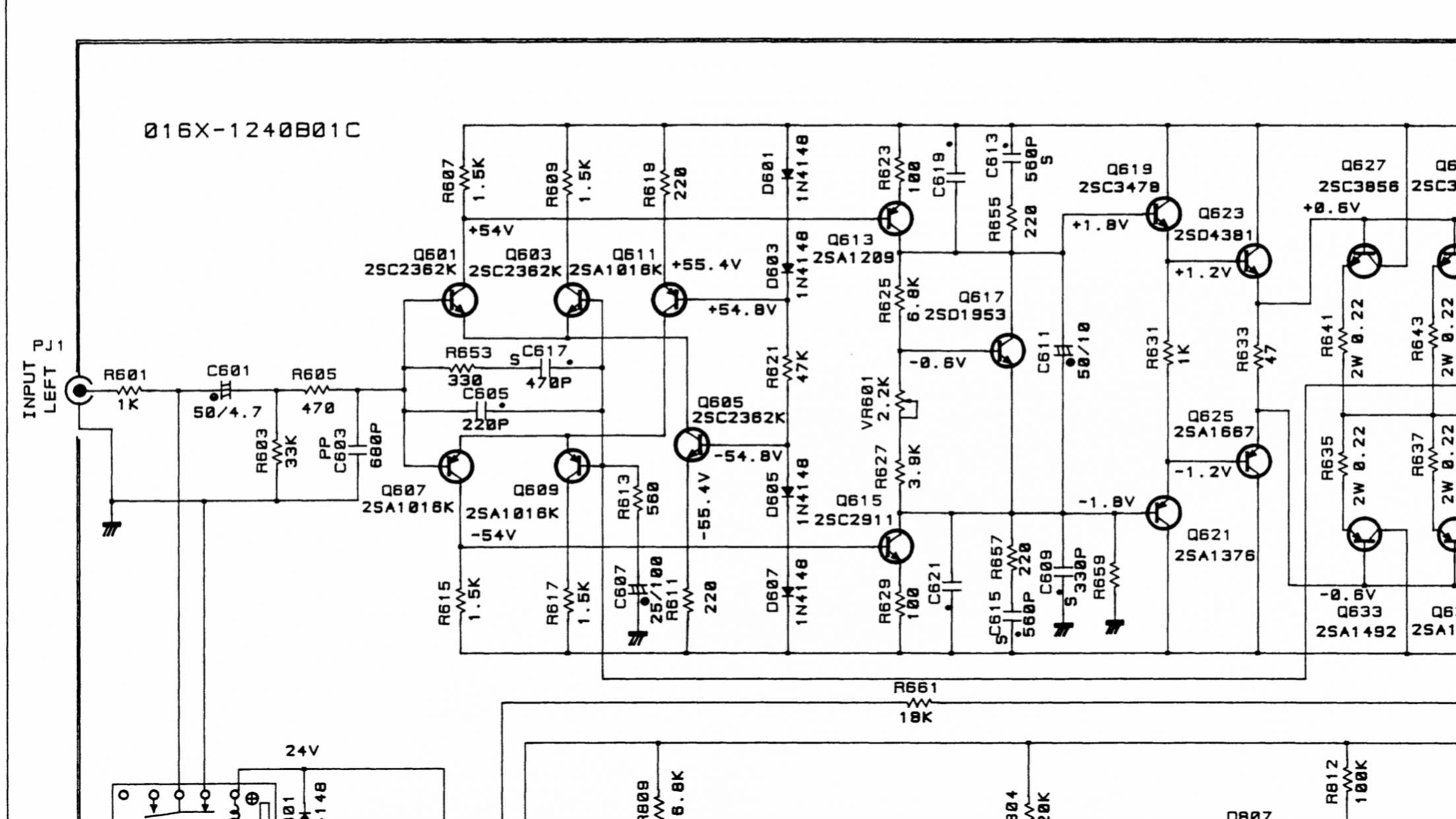

If I had not made it clear, I’m kinda on your level - I need coaching or direction (Schematic changes) to do some of this stuff. I’m good w/soldering iron and can hold my own reading a schematic. But recognizing a CCS, CAS, or a VAS - all alphabet soup to me. I look at these schematics, left to right, I see 4 columns of transistors, a single, then 2 more columns and either 3 columns or 5 columns of finals depending upon the amp.
To Per: having trouble reading your 980 mods schematic, printed or on an iPad w/hi-Rez screen blown up. Any reprint suggestions would help.
Thanks Paulus. As I said before I will follow your lead as best I can using any of your ideas I can make fit - like replacing the 4 PS caps w/8 or more 🙄(I know well the benefit of “more”) while striving for more filtering along the way.
Many thanks to you, Per et al
