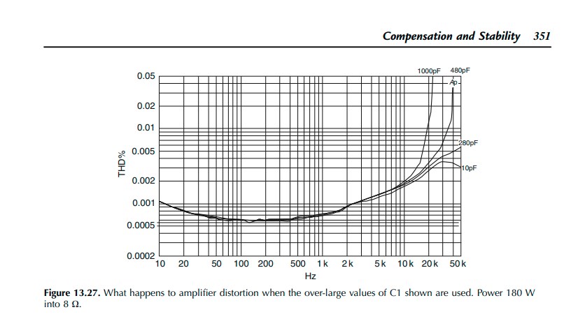

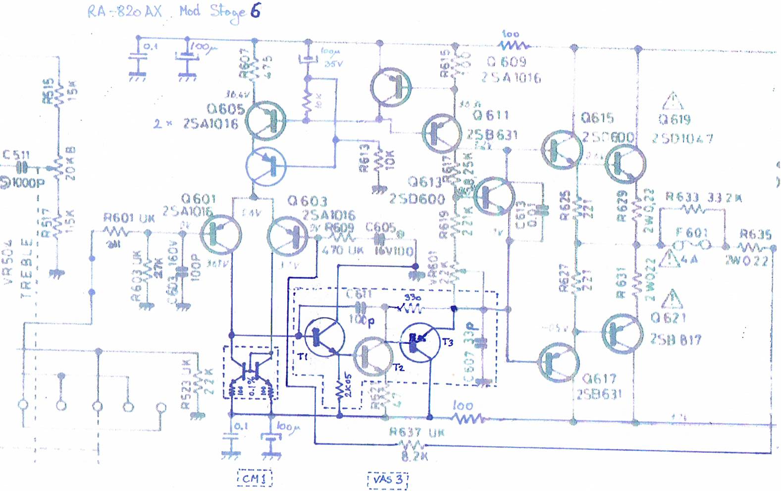

Just wanted to share couple of thoughts about my Rotel RA-921 modding.
So I was initially not impressed with the sound of stock Rotel I have bought from ebay as "faulty" but fault was only blown L-ch speaker protection fuse.
After de-soldering-cleaning-pairing and soldering back, some "life" in sound was observed. So thought it can be keeper for future moddings.
I must admit that I found stock Rotel sound interesting, different from "common" commercial transistor amplifiers. But of cause there was some issues with lack of cleariness in mid-high frequency. Despite "not-so-clear" sound had some "musicality" and "full-bodiness", kind of interesting-attractive-involving.
So yesterday I invested couple hours in this amp. Installed some Elnas for Audio, Silmic II, some Panas FR, FM, FC. And for the same gave a try to change VAS compensation from "shunt" to "Miller", by removing R623,C607 and added Milled Cap into ready to use empty holes next to Q611.
After turning on and first audition followed huge disappointment what I heard. The "Rotel-ish" sound was completely gone, and the "new sound" was way to bright and to harsh for my liking. This was exact type of sound I was trying to avoid in my systems.
Long story short - today have put all back as it was in original circuit, with one exception - "shunt" capacitor C607 replaced with smaller 220p to lift-up frequency range for correction, with hope that filtering will not overlap with audible range in hi freq as it was with 330p.
And now I can tell I'm happy with the sound! The same "Rotel-ish" sound came back, and as far I can tell, it has less "rounded" or "mudded" sound in hi freq.
So my idea is - if you like "stock Rotel type" of sound in general, but not happy with lack of cleariness in hi freq, please give a try to play with values for "shunt" capacitor at first. It is super essay mod, just one part to replace per channel.
I believe that in this place 330p is far to big value. Self Douglas in his book measured distortion figures having range of applicable values 10p-37p. With values bigger than 280p amplifier THD showed very poor results starting with 20kHz. see page 350 diagram 13.27.
Might be that Stan Curtis prototyped this amp circuit with 33p, but then some sort of typo happened to 330p.
Worth to try smaller values for C607 to find smallest which ensures stabile work and for the same will not cut hi frequencies.
As for VAS Rload resistor R623 (33k) it might be also area to play...
If to apply valve amp logic, driver's anode Rload value for best sound is 3-5x R-internal of driver valve. As driver valve sounded never best with close to infinity R-load. Not sure if that applicable there...
Kes

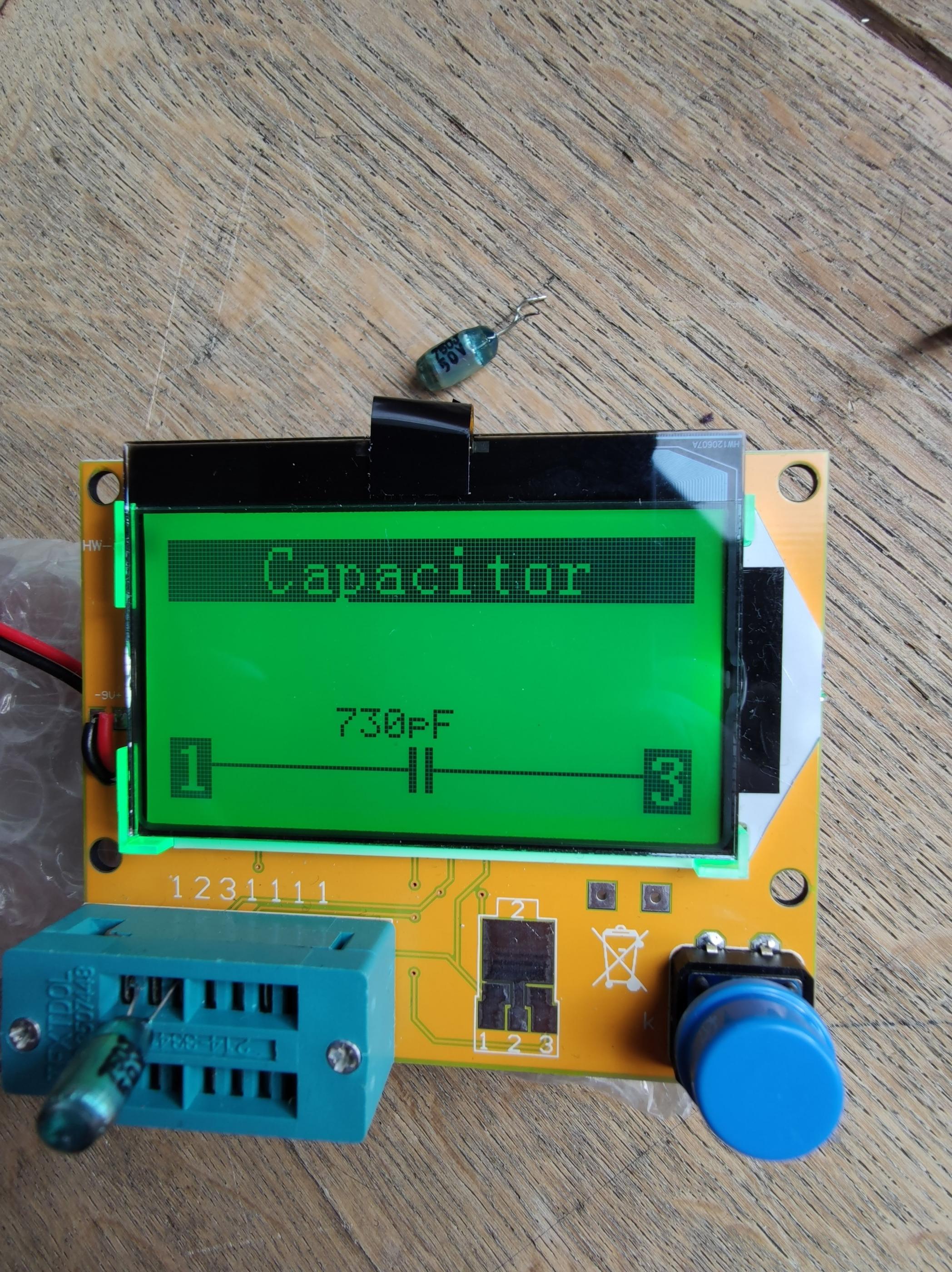

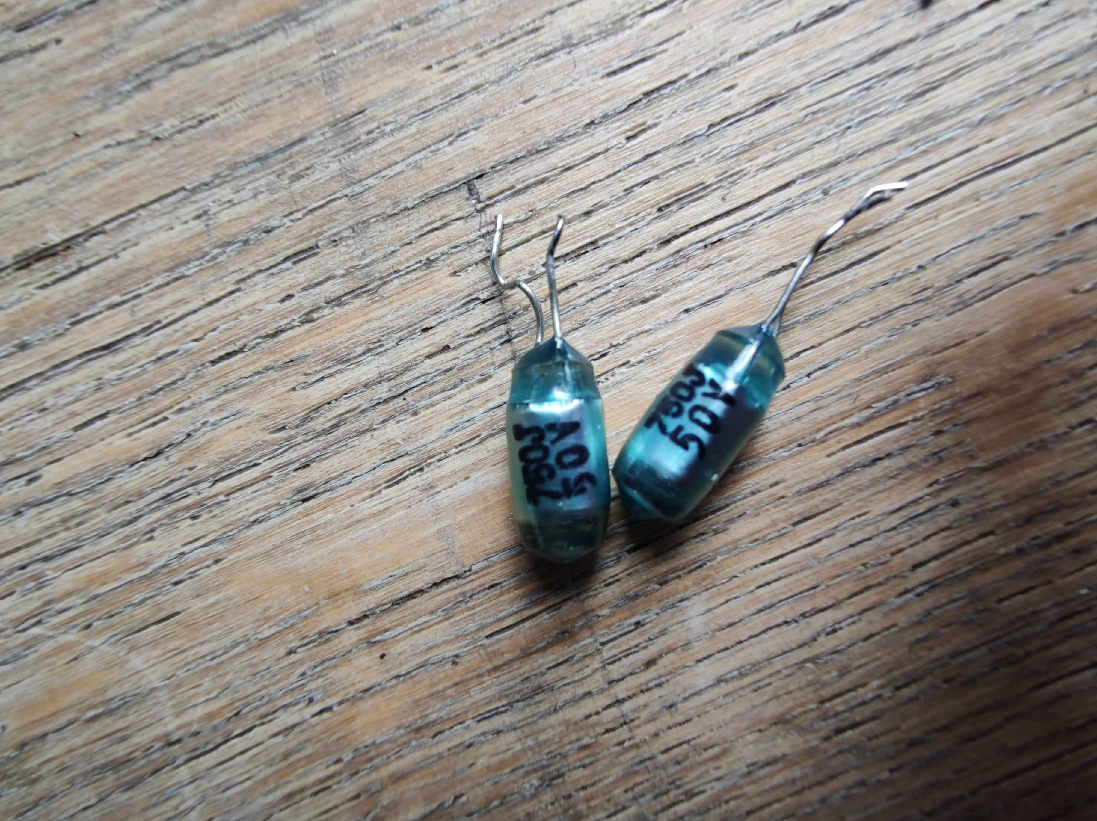

Downloaded all available service manuals for Rotel Integrated amplifiers, and seems that all of them starting from '80s have exactly the same VAS topology: single transistor with shunt type correction loaded to the ground as 33k resistor paralleled with 330p capacitor.
So we can say that those 2 VAS components: "33k||330p" is the "thing" which shapes special "Rotel" sound.
Now in terms of "lack of clarity" in RA-921, there are couple more places where to check for improvement...
1st - power amp input grounded with cap 750p, which in later models was changed to 220p and recent ones all have 100p.
2nd - need replace all ceramic caps with film type caps as I remember opinion from some audiophile forum that all ceramic caps from audio path must be replaced as ceramic caps "killing the sound".
Kes,
I know this thread has become very long, so I try to restrict further posts to new insights or issues - and not repeat myself. And I would ask other posters on this thread to do the same, please.
Yes, that was what I said (and PM'ed you to read) in post #554 - but OK, here it is again:
The Rotels were designed by Stan Curtis in the UK and he maintained the heavy dominant pole shunt compensation throughout almost all Rotel designs. Quoting Self - who in turn quotes Peter Baxandall: "The technique is in all respects sub-optimal", which for Peter was strong language indeed".
But it gave the Rotels their distinctive, easy listening soft, rounded and 'pleasing' sound. And you can't argue with the impressive sales figures that this did indeed appeal to a lot of people.
Removing the 330pF||33k VAS load and replacing with a better VAS Miller 'collector to base' feedback capacitor design suddenly removes the 'pleasantry' veil and make all the stars come out in detail. Do the Miller compensation right and you can also readily get rid of the 150pF PNP driver load without any stability concerns.
I don't recall ever having seen 750pF as an input RF block capacitor in any Rotel, I think that it is a misprint of 150pF in the old schematic. (And also 750p is not a standard value which would have made it unnecessarily expensive for what it is).
Your 921 has a RF filter of 1k8 and 100pF, which has a -3dB point of 884kHz. If you can hear or make clarity improvements in that frequency range, I take my hat off for you.
Secondly, there are no ceramic caps in the audio path. You should take the claims on the 'audiophile' forums with a pinch (or rather a shedload) of salt - unless they are supported by solid measurement evidence.
Otherwise, at best - your bank account balance will sit on top of a deep placebo effect sinkhole.
Per
Per
After thrown away input filtering caps C603/604 (in RA-921 750pF) I can tell I hear biggest influence in getting back sound openness.
Double checked by A/B with turned on amp with headphones, and putting back those caps into holes from soldering side of PCB. Definitely those caps cutting hi-frequency.

Oops, I stand corrected. You were right.
In honesty, I haven't spent much time on the extreme budget RA-920 series and plainly forgot that they don't give the option of bypassing the tone controls. No way to get phase linearity through those.
However, your calculations are missing the fact that the bass section is in parallel with the treble control, so things are not as bad as you point out.
And the treble cut would be in the bottom (not top) setting, where the circuit is supposed to cut the high frequencies as it is.
Have you ever measured the actual frequency range of the amp?
In the RA-931, I tried to apply a 100kHz square wave to the input and scoped the response on the output. I found that the 100pF gave a slight overshoot on the rising edge, increasing it to 150pF solved that. But was it worth replacing the caps for that? I decided that 100kHz was overshooting my hearing aid range.
Now to be constructive, if your amp still has the old TL072 in the preamp section, you could try replacing it with an OPA2134 or a LM4562.
Otherwise, if you love the amp and decide to leave it as it is now, just enjoy the music!

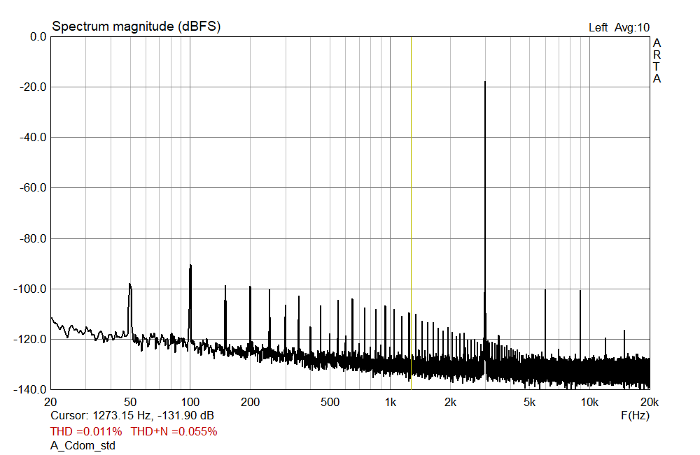

Hi Per
1. And most important: Very interesting thread!
2. Some time ago you published a composite VAS including a third T3. In your example, T3 acts at the same time as the buffer for T2 and also as a "current splitter" by T3's VBE paralleled by the 330 ohm resistor. In your example, this might set the IC for T2 as some 0.7/330=2.1mA. I first saw this option in D.Self's power amplifier book, and then tried it in a Yamaha AX590 VAS modification. But that lead to some oscillation, so I discarded it again. My first question then: Do you still use this theoretically elegant modification, e.g. is it successfully long-term stable/safe in your Rotel mod's?
3. Did you try to include improved CM's in your modifications? I am especially interested in the EFA current mirror as published in Samuel Groner's 2011 comments on Self's designs. I have not tried this one out, and I am wondering why I am not able to find any implemented and working examples of such avariant when searching by Google. Does this EFA CM variant come along with serious drawbacks in practice?
4. Did you try to include a output-stage including Miller Cdom variant? I did this in a Yamaha AX592 and it works fine. In this mod, the Cdom of 100pF is split into two serial 220pF, and the midpoint is connected to the power device's emitters resistors's common connection point by a 1k4 resistor. Result: See the two Arta graphs.
5. By which criteria did you choose the different emitter degeneration's resistors values of the IPS, CM and the VAS? E.g. is there a "sweet spot" to do so? Depending on the Ic's of the IPS, the CM and the VAS I arbitrarily chose to set them for a compromise 1:10 ratio of re/R_degen. I am shure there must be better criteria than this rather irrational magic of decimal values ...
I hope not to bother you too much with these questions!
Forget this one and sorry for it ... I somehow missed your post #509 relating to this precise question.
